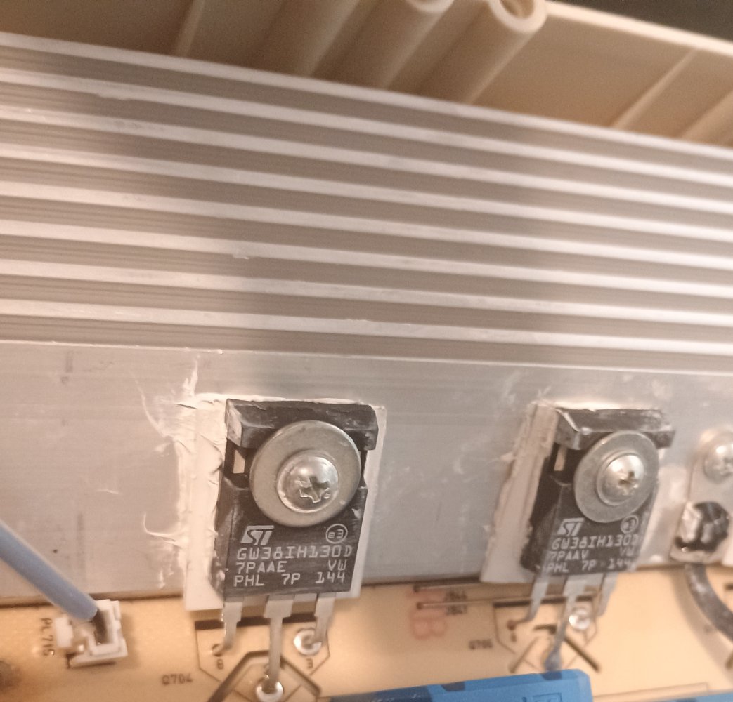

Daughter switched the induction hob on last right and the dedicated 32A RCBO tripped.
I reset the RCBO but the hob is dead. Pressing the power on button and nothing though the mains supply is there.

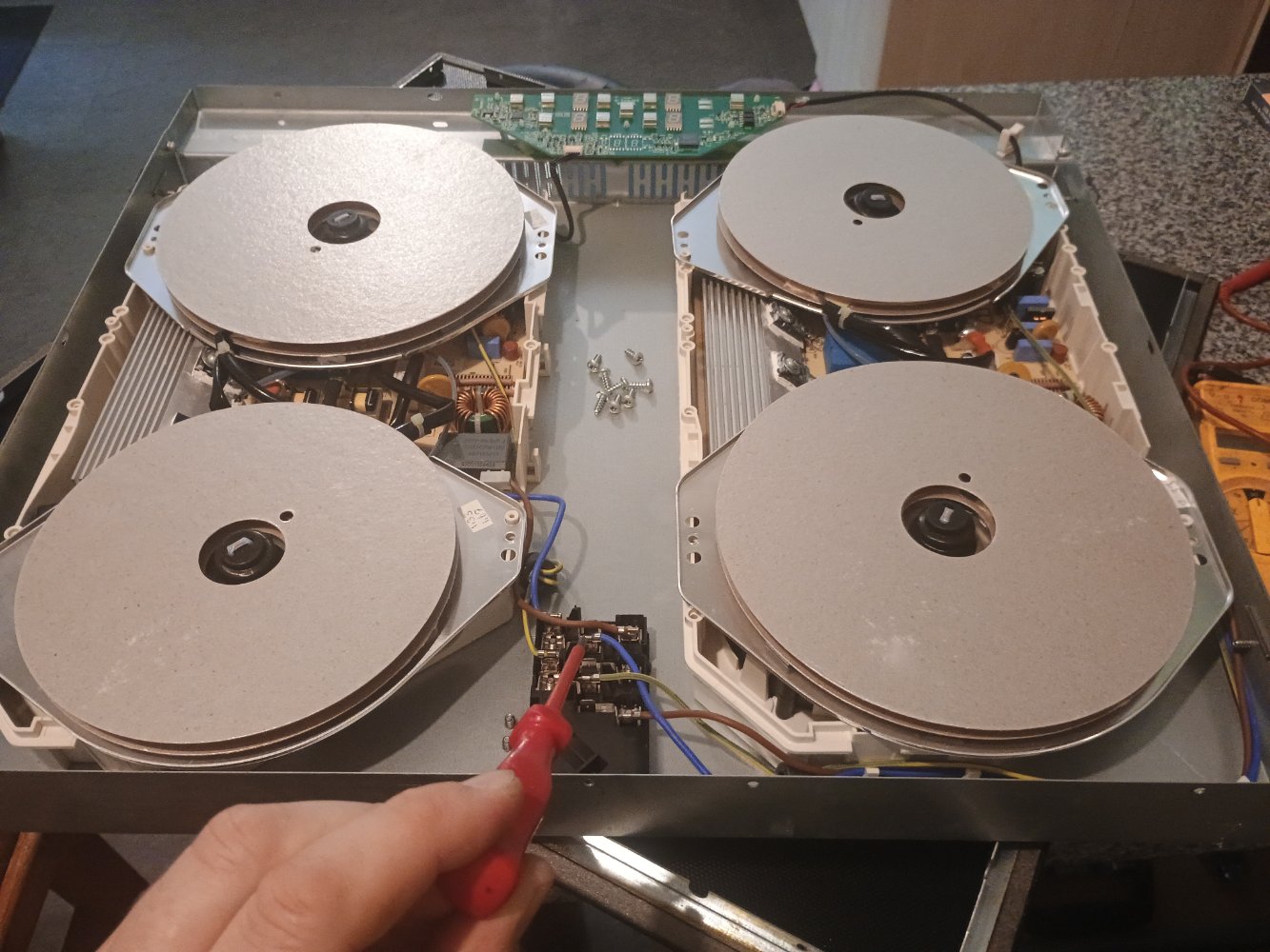

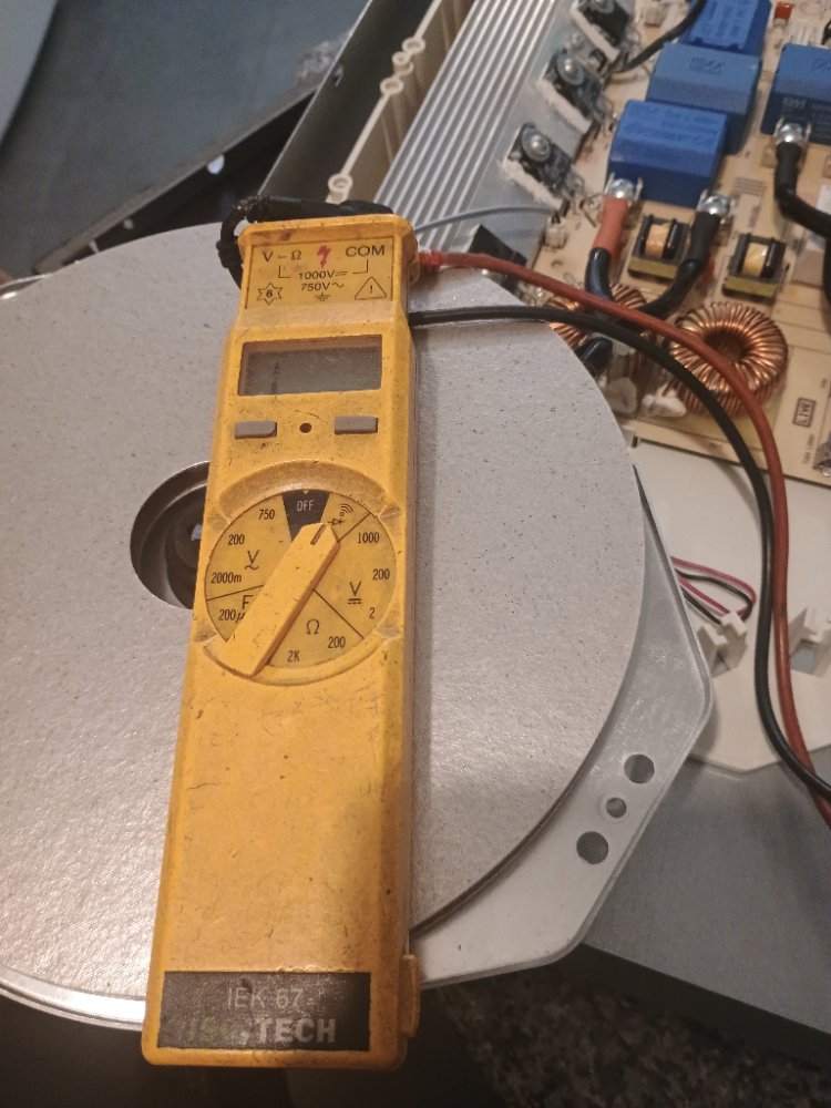

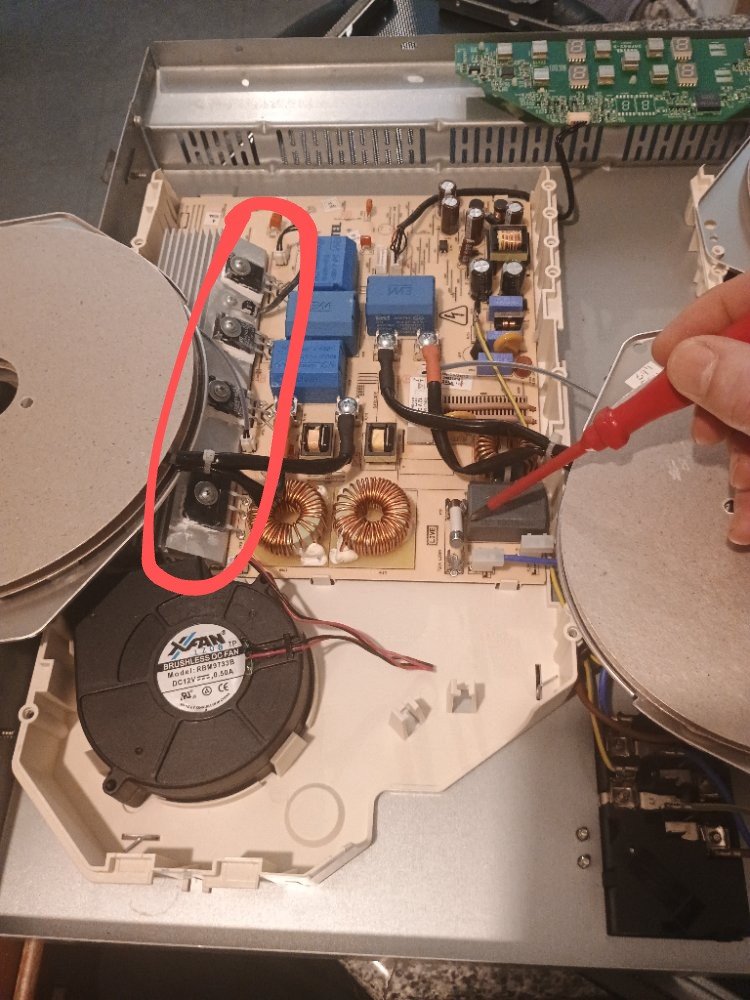

Whipped it out and started to take it apart. Mains comes in and splits to two induction plates either side:

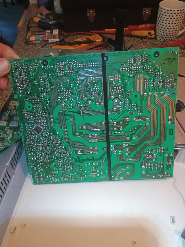

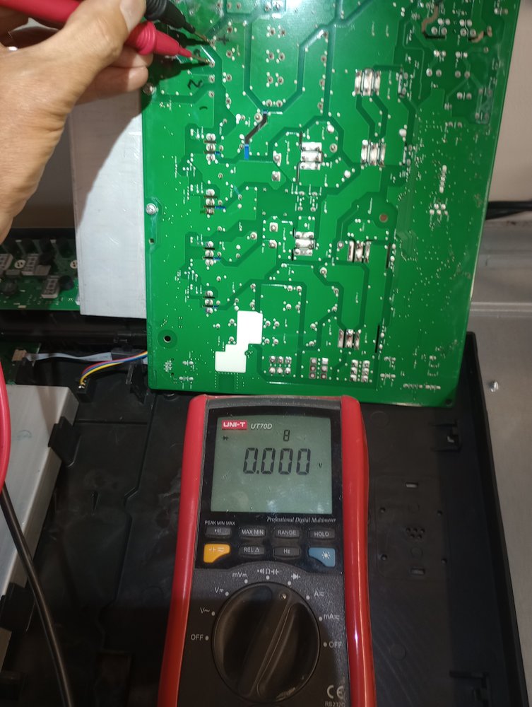

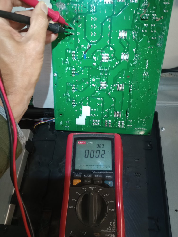

Control PCB does the same, appears to control two + two:

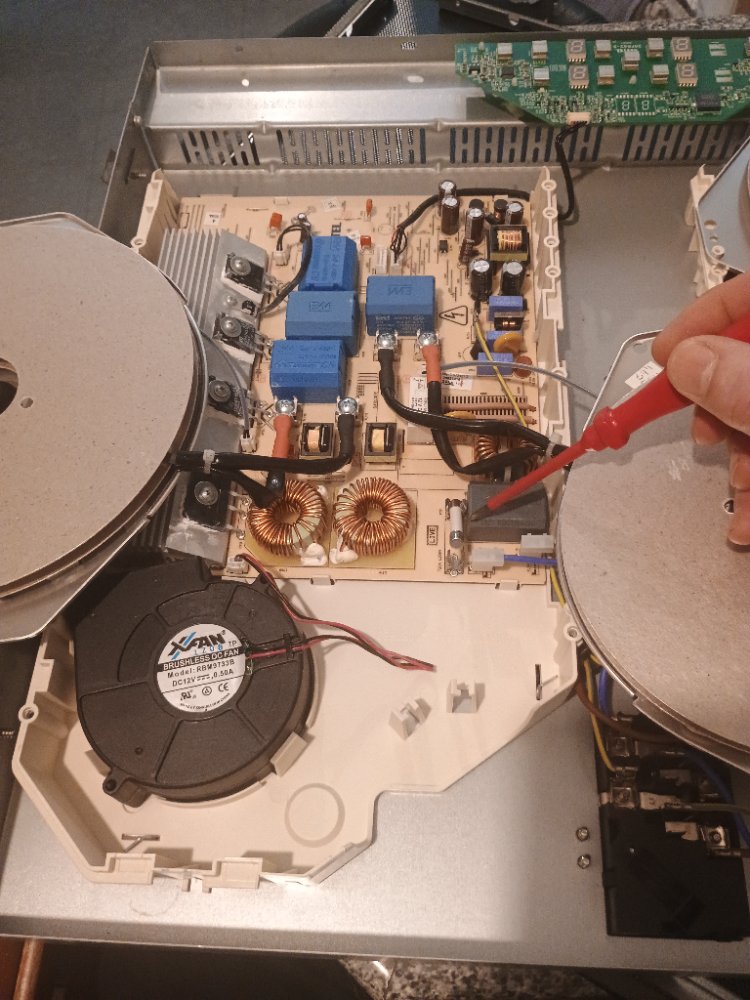

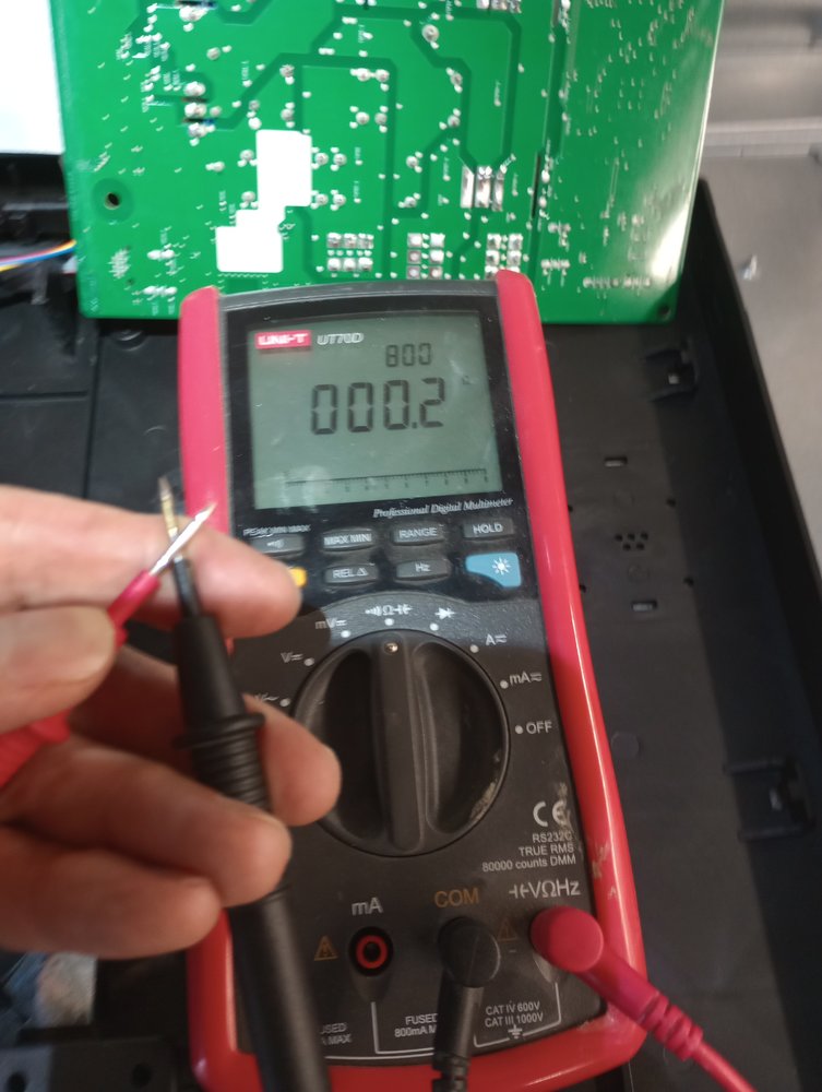

First thing I've found, 20A fuse one side has blown:
Any pointers?
