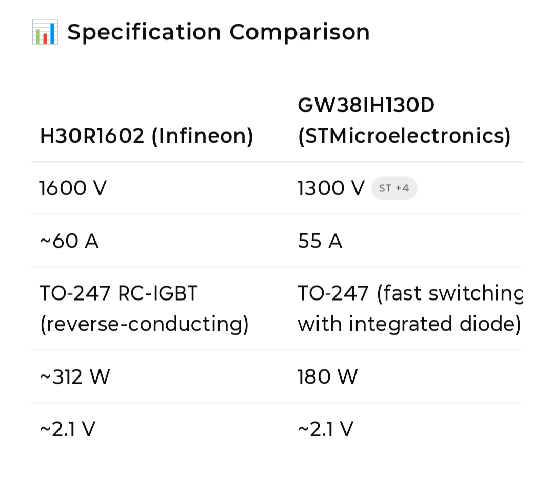

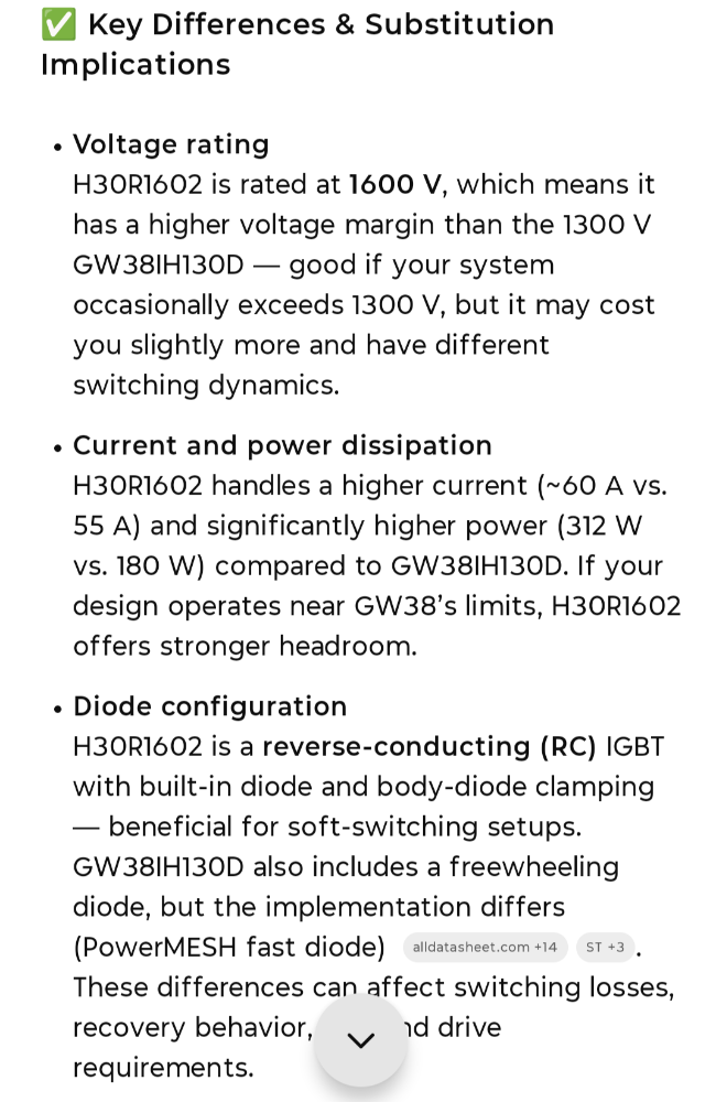

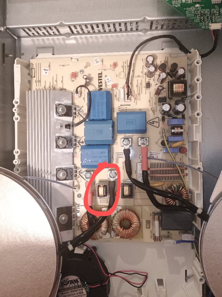

Just the GW number matters, the others are for date code and manufacturing site etc.

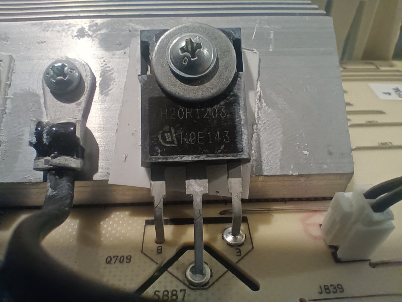

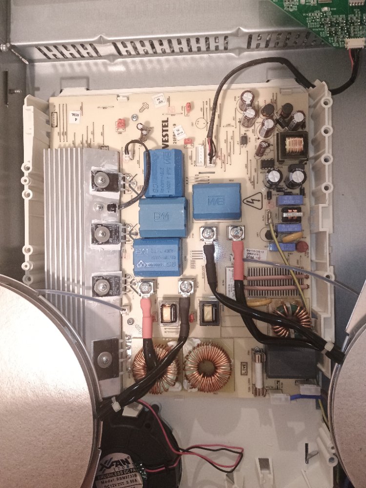

These big parts going into thick copper can be a pain to desolder. I just cut off the old parts leaving the leads in the PCB then trimmed the new parts and soldered onto the old leads.
would think standard as is got a fan to keep the temp down where the components areHigh temperature solder used originally d'you think?

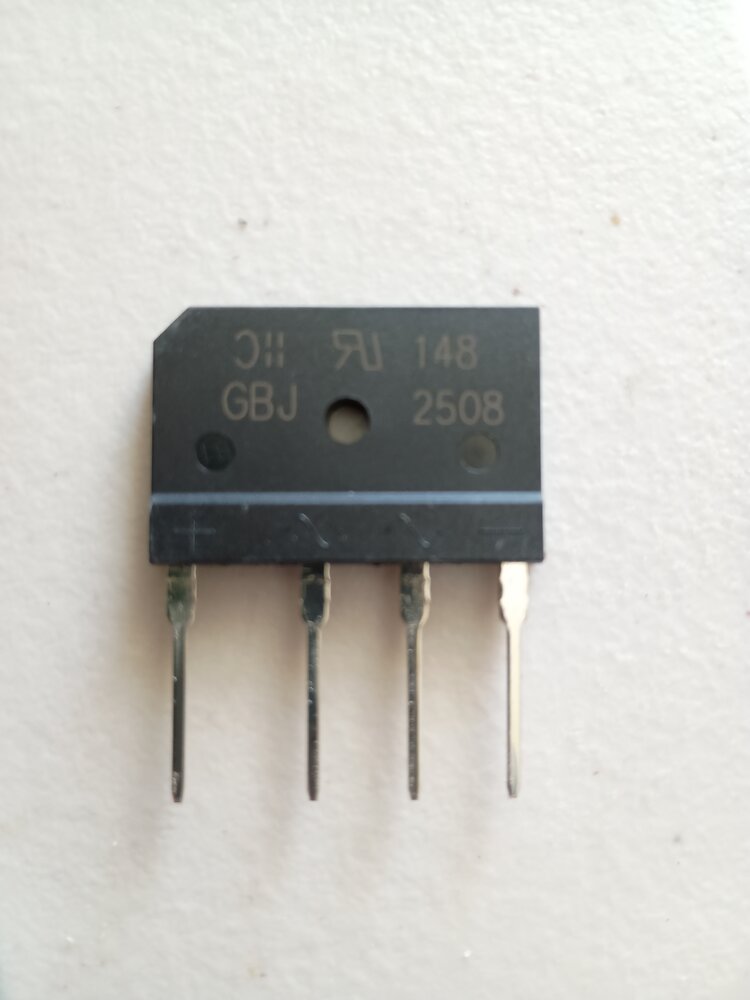

Ps, sent off the bridge rectifier to you today.
Much as I understand your desire to fix this, and the learning in the process, you would get your dinner cooked probably more quickly if you went to screwfix and spent £149.99, on a new one!Cheers, top man![]()
And if he buys one he won't be able to go to the pub for his tea every night for the next 6 weeks either.If I have to buy one it'll be a £400 ish Bosch jobbie to match the other appliances.
I've got a few spares for the regulator. Let me know your address and I'll stick one one the post

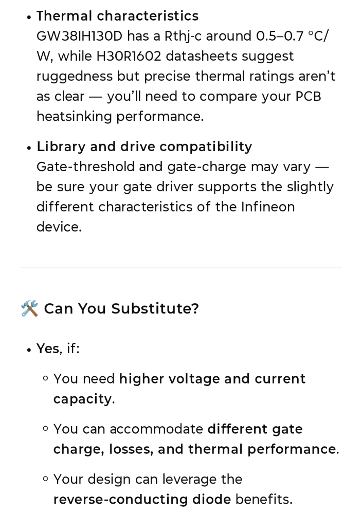

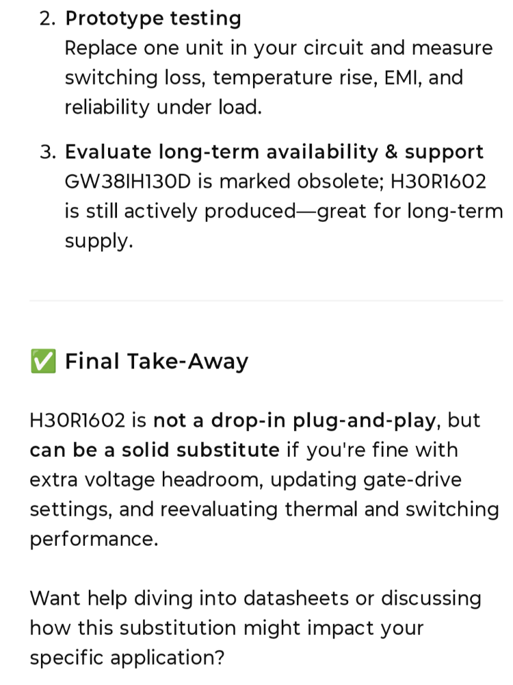

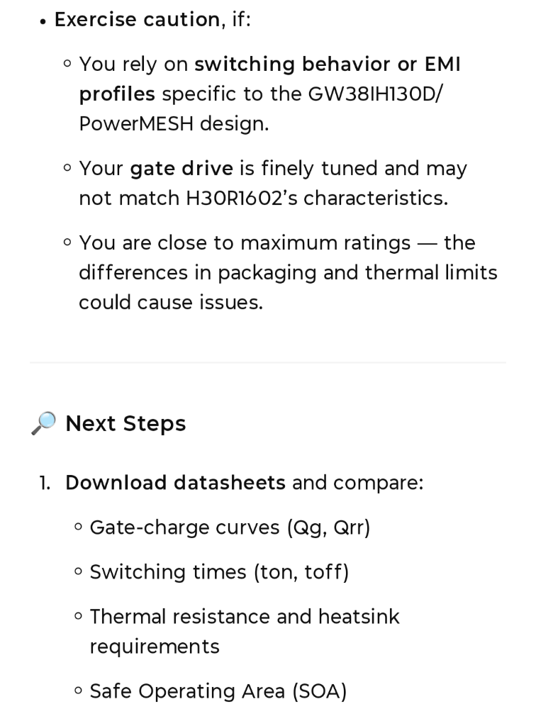

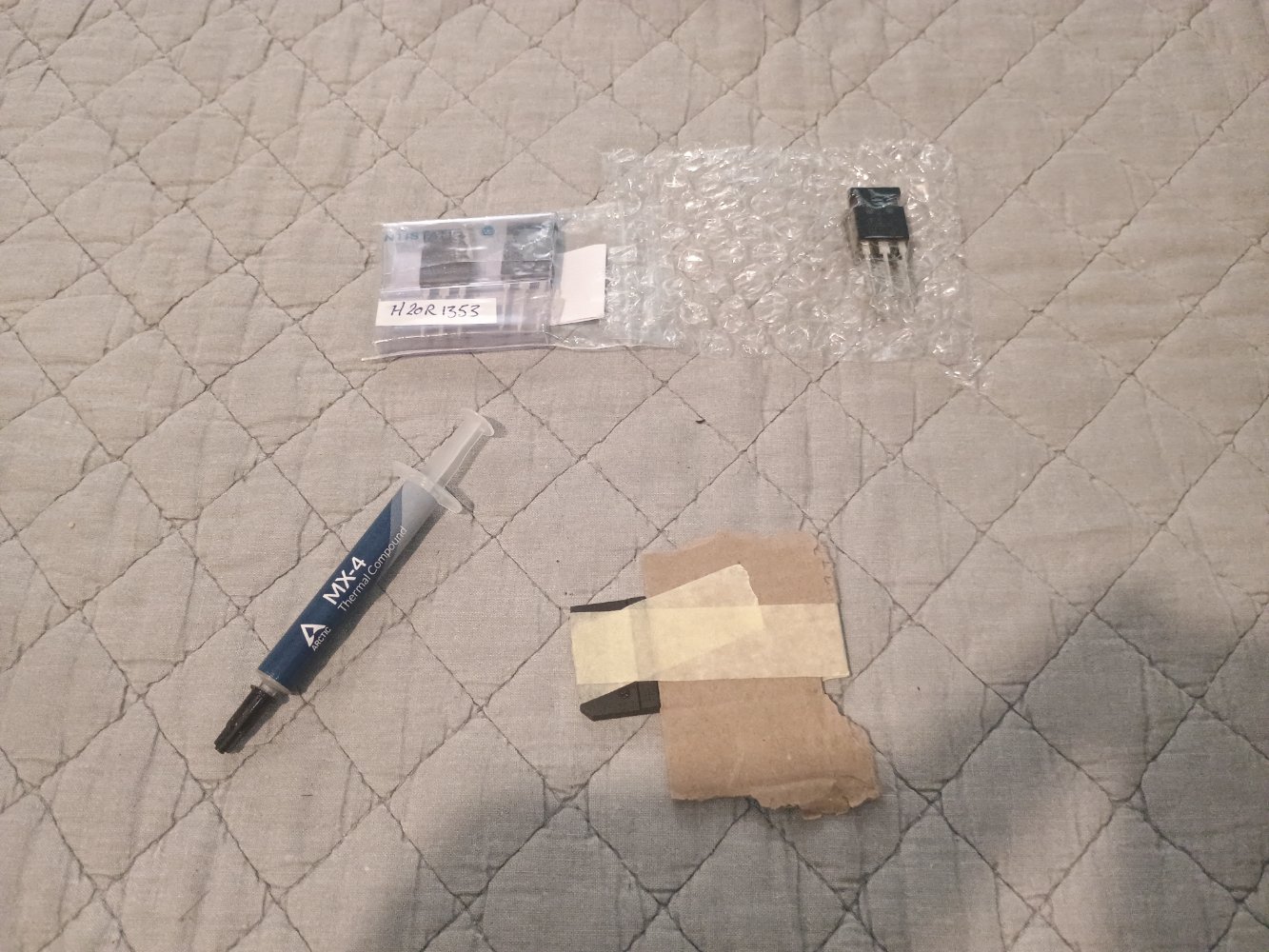

Messaged the guy where I got one of the others components:Nothing to do with meRight all parts here, well the regulator (thanks @Robotstar5 ) and 3 IGBTs.
Just replace those and see what happens?
I presume cpu thermal paste is ok to use?
