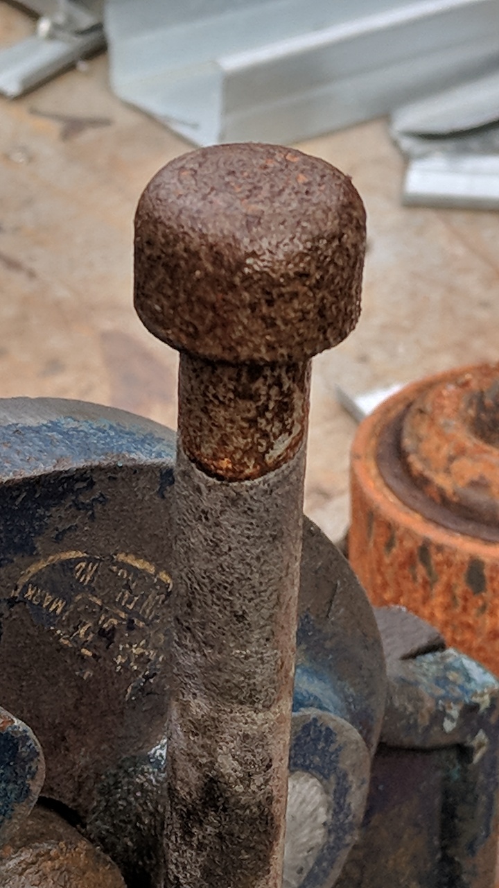

Martensite is a phase state for hardenable (typically high carbon) steel. It is generally above red hot before steels enter that phase before you "quench" the material (often in oil depending on the grade) which locks in or freezes the crystalline structure. It is not a surface only process, case hardening is something else.
You can brush oil (or ideally wax) onto hot steel to give you a robust coating but not red hot and it's not martensite.

I think we had whale oil for hardening at school, slower quench to reduce cracking from memory.
If you were at school in the 1850's I guess you could though it might have been a tad risky even then - what with it being highly flammable!

I was told that oil was also used due to it not steaming & bubbling as water does, so it provides consistent cooling across the full surface. Pretty much related to what Wallace suggested, as in it potentially prevents cracking, distortion etc.
Had a look at the dark oil the Toolroom use for heat treatment and asked what it was, whale oil!

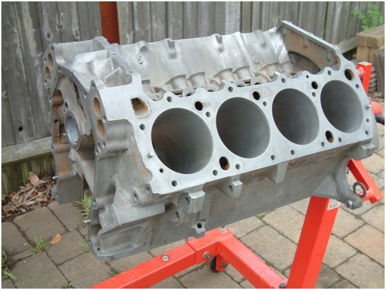

Ah.... but I'm sure there's a sticker somewhere on the BMW which says "Munich"
That block looks great. Why are we blessed with suxs small boring engine's here
