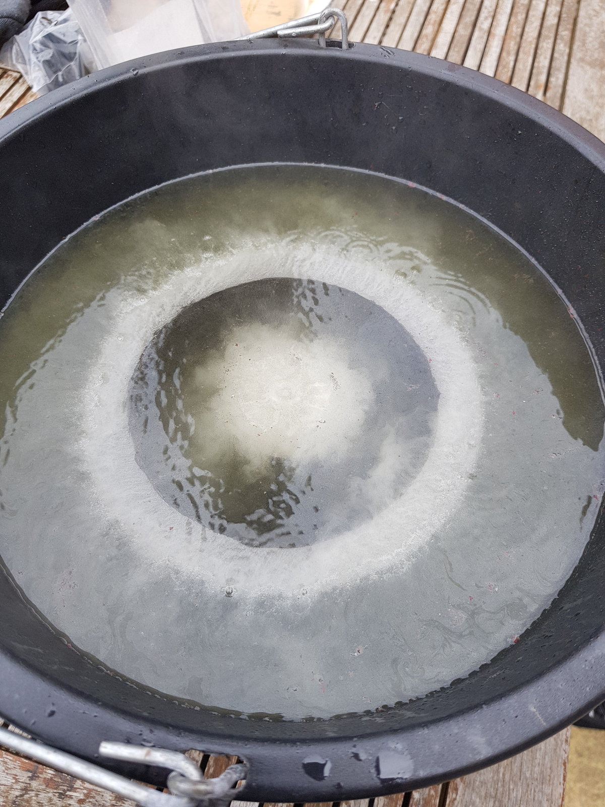

I did check it every couple of minutes . Cleaned it up well with no visible damage .I did have visions of pulling it out to find half of it desolvedThat's a helluva reaction I hope you didn't leave that in there long.

Bought the 25kg bulk as it was cheaper per kilo than the smaller quantities so I can replace cheaply. I will try mixing in the same ratio as the Deox-C used previously in the tank to try a comparison.I would guesstimate that at room temperature, 5-10kgs in 50gallon is a saturated solution.
