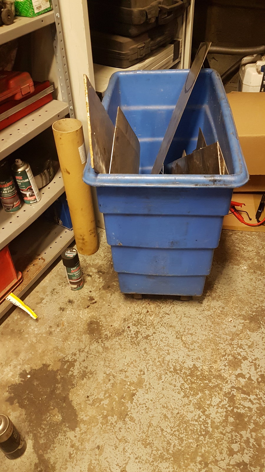

I would guesstimate that at room temperature, 5-10kgs in 50gallon is a saturated solution.
Something for adding to the "Things that bug you" thread.

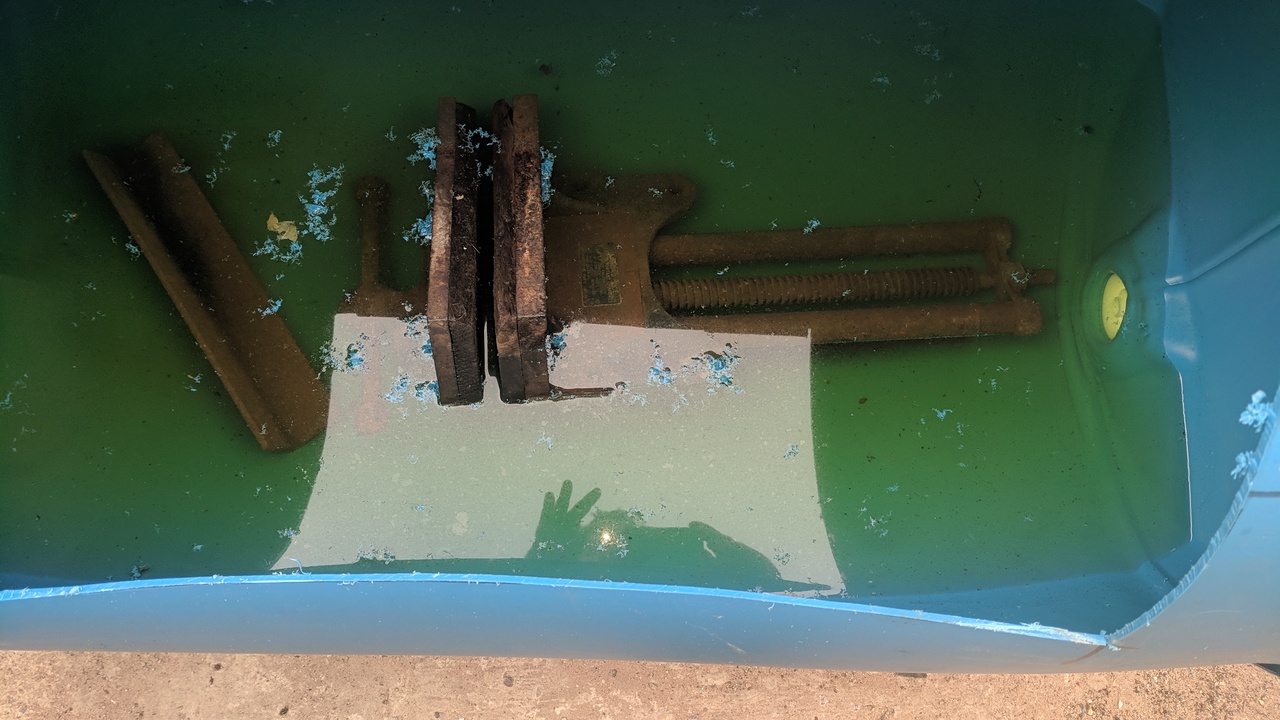

24hrs in.
]Not that there's a hurry, but how does the process compare to, say, electrolysis? I've never tried the citric acid method [stop sniggering at the back!![]()
You want it fully immersed to prevent any wash lines. You'll never shift those once they appear.

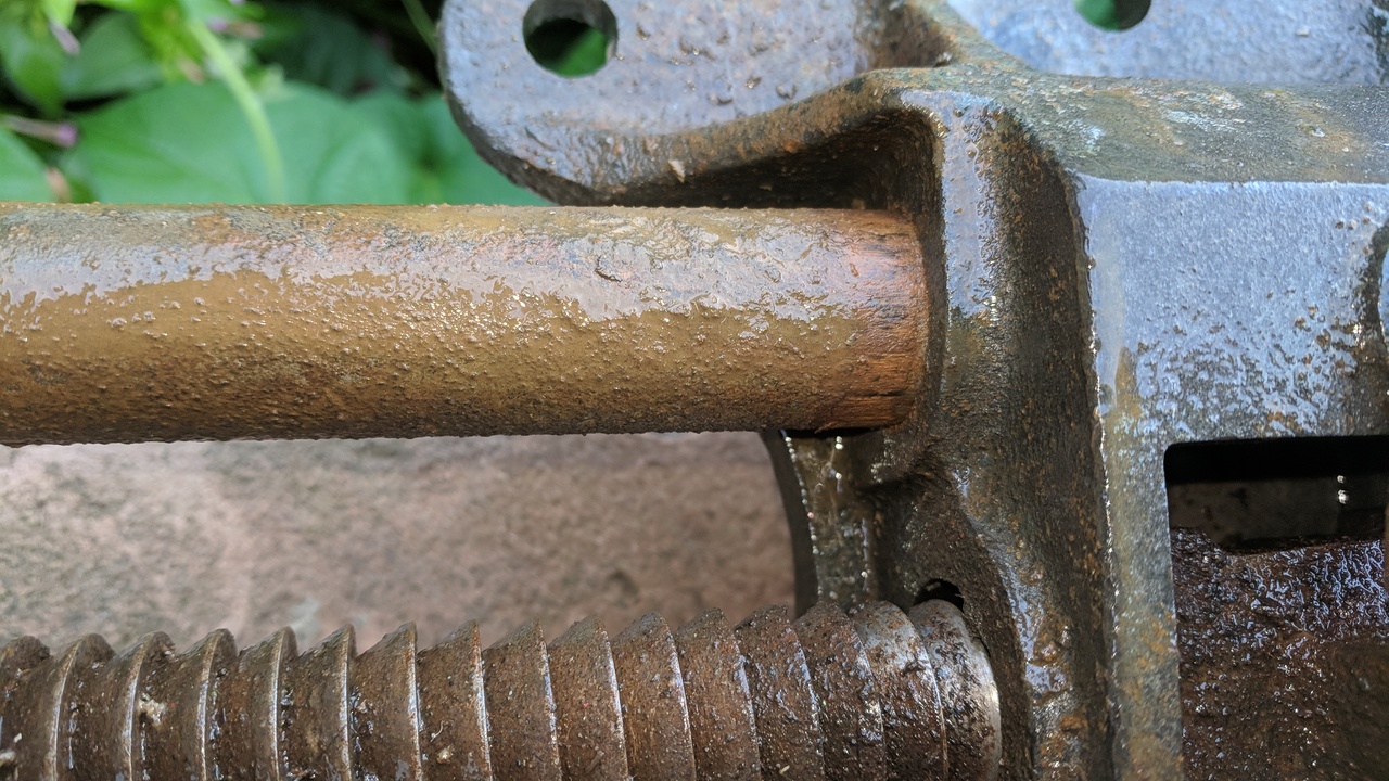

72 hours in and the slide is free. you can see about 6mm of movement on the slide in the pic.I would guesstimate that at room temperature, 5-10kgs in 50gallon is a saturated solution.

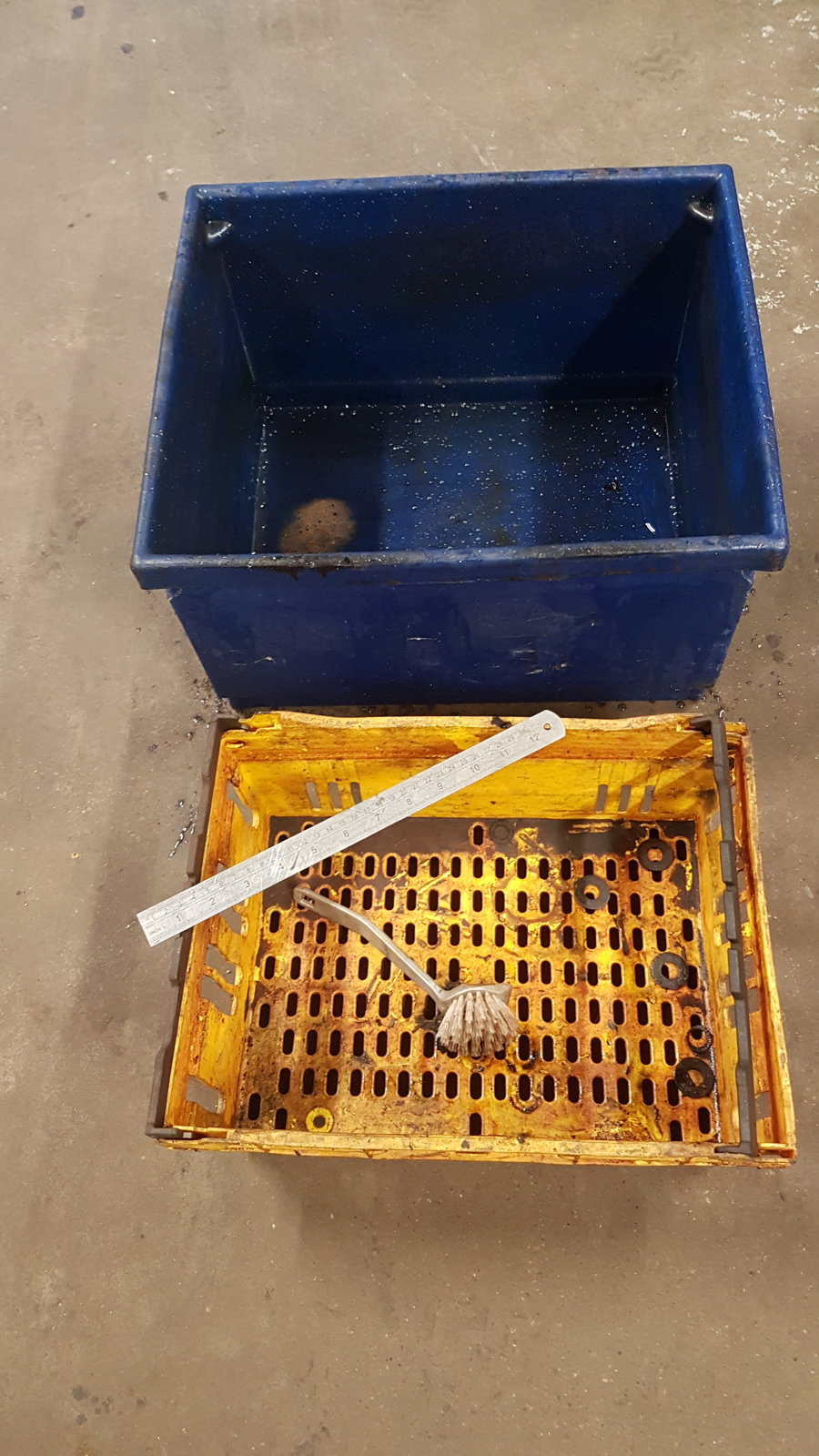

25kg on order for my 50 gallon tank.![]()
According to my calculations, not a bad guesstimate (sorry MattH).
