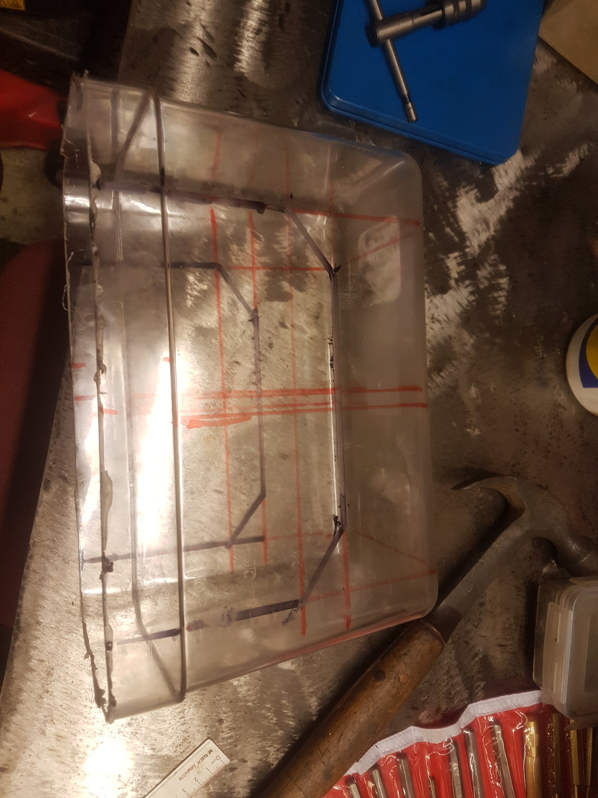

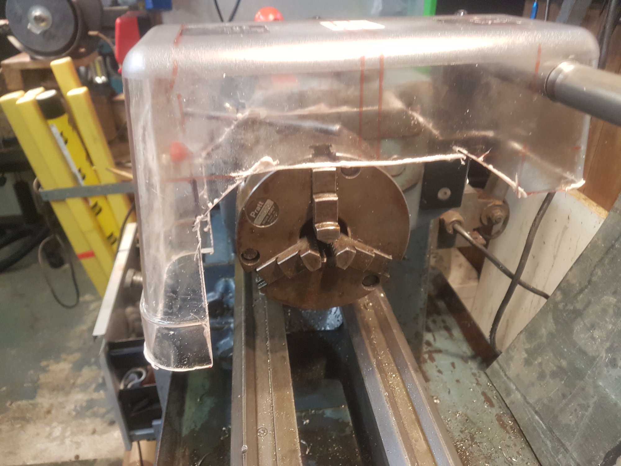

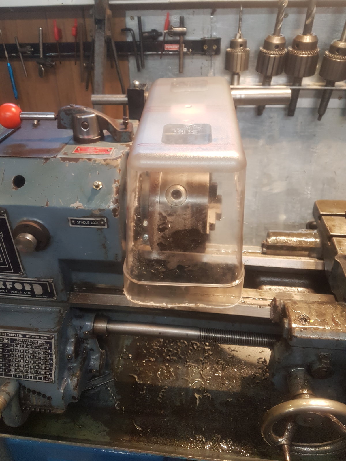

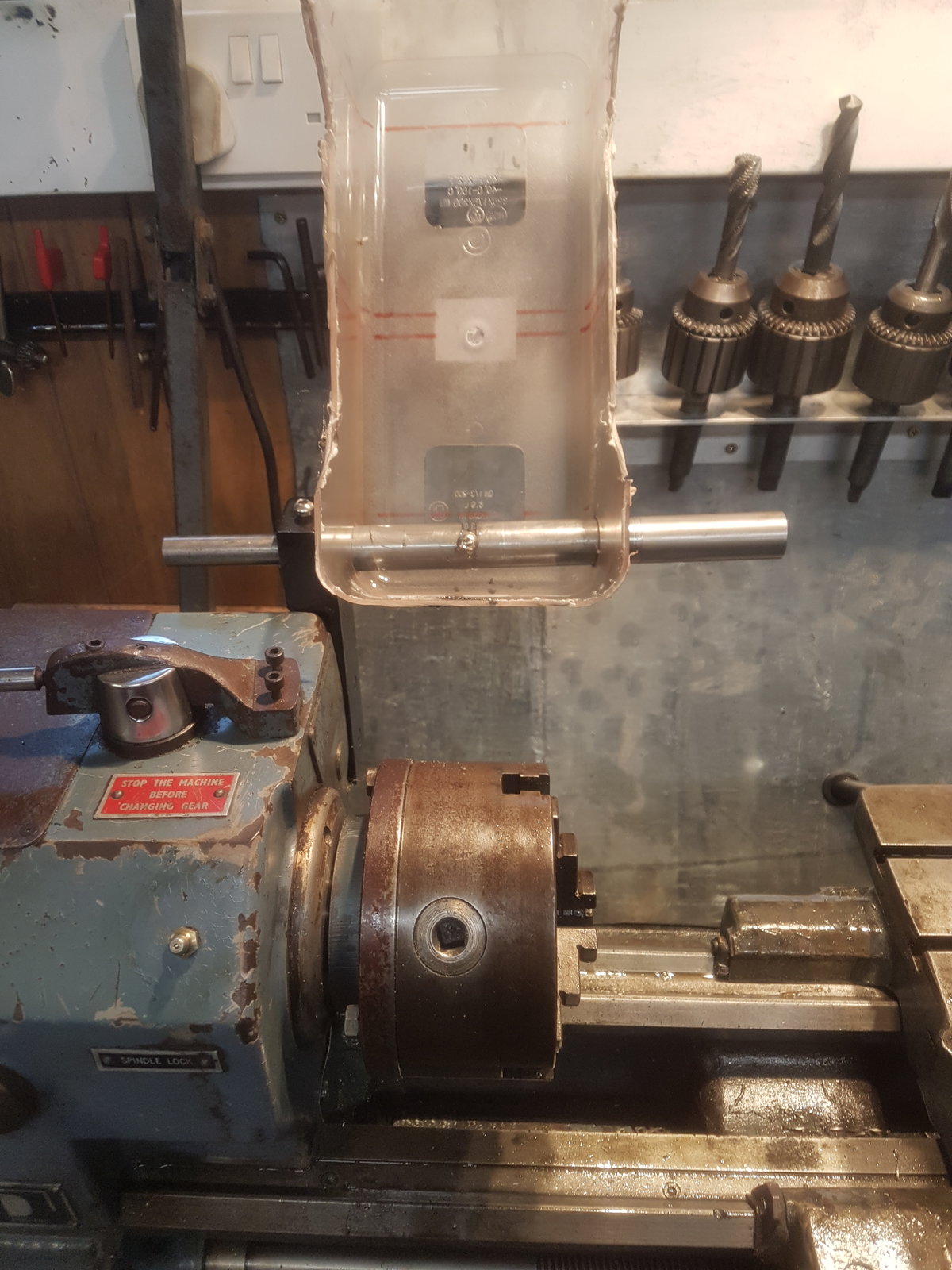

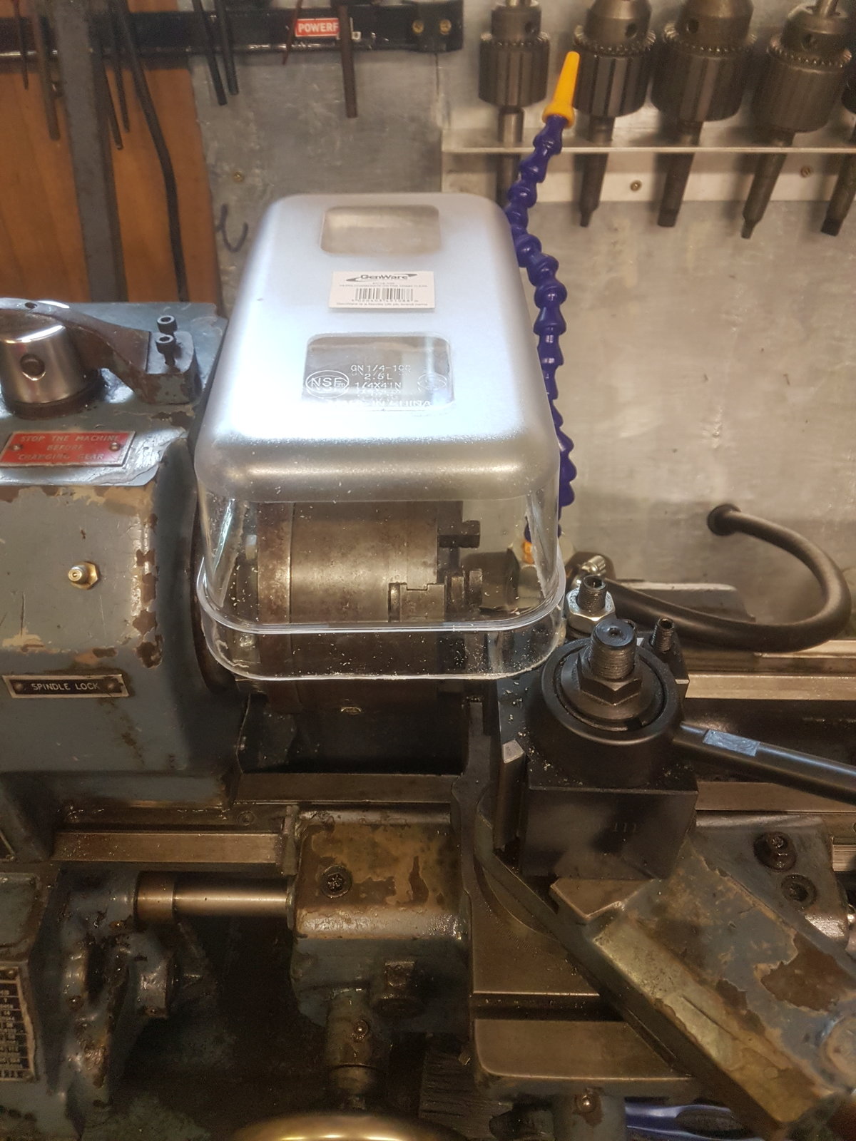

Can't see that being the case though, maybe just the way things are?A couple of things I would make different.Does this need to be slightly bigger just playing with sizes right now. View attachment 196587 View attachment 196588
Depends on your point of view.lucky you mate! my head stock just has a hollow through it about 15mm diameter i think

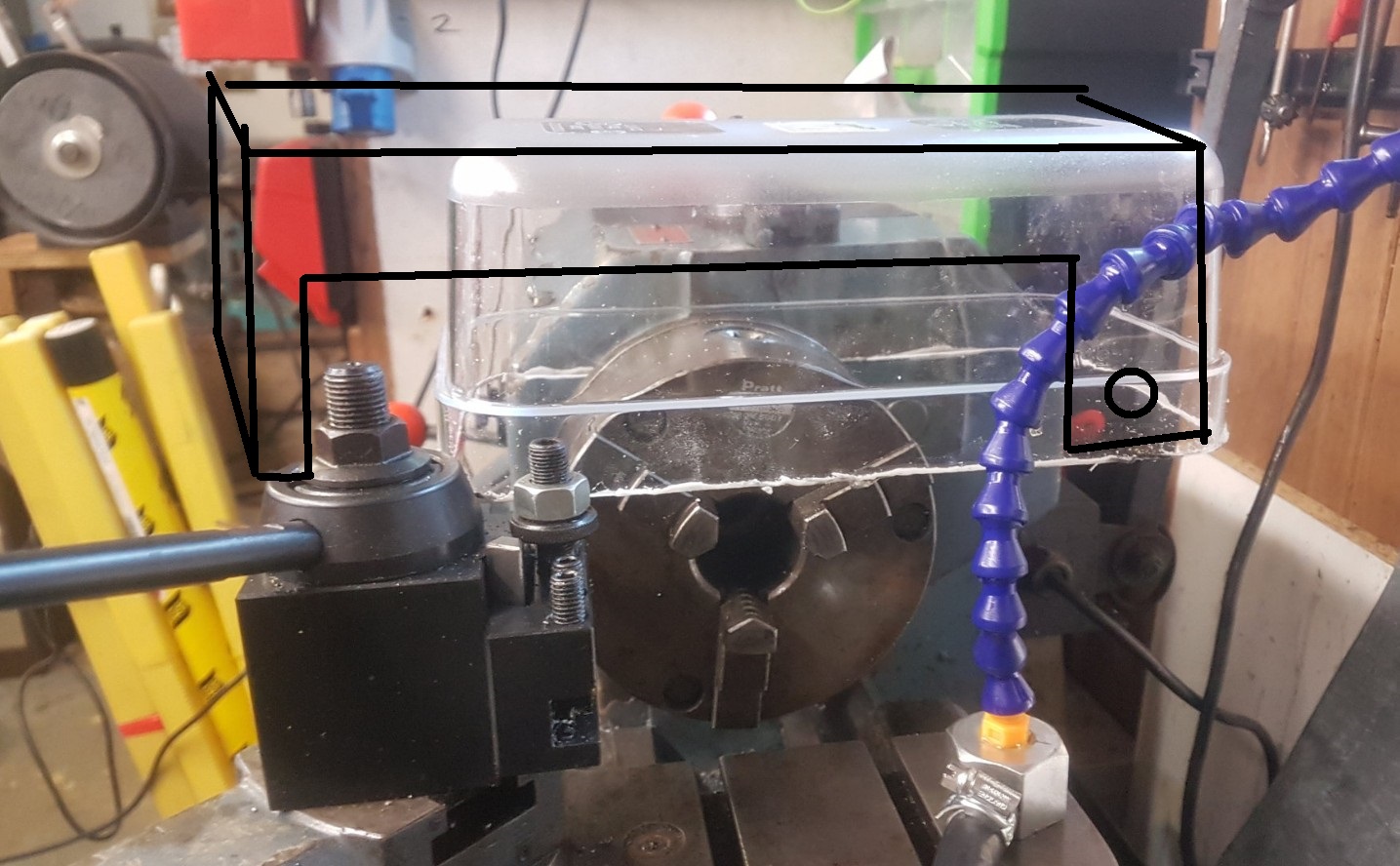

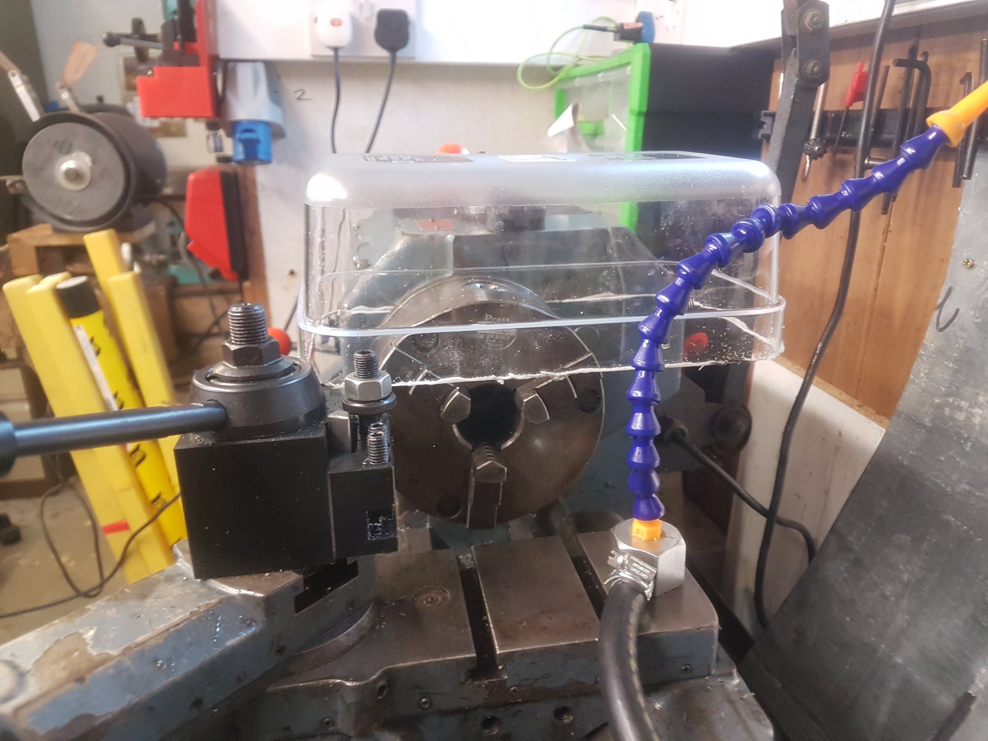

That is all do able at the momentA couple of things I would make different.
1. I would have the edge that is facing you come out as far as possible, in other words just inside the edge of the tray.
2. I would cut away the front so that it is not obscuring the chuck.
Similar to this very bad paint drawing.

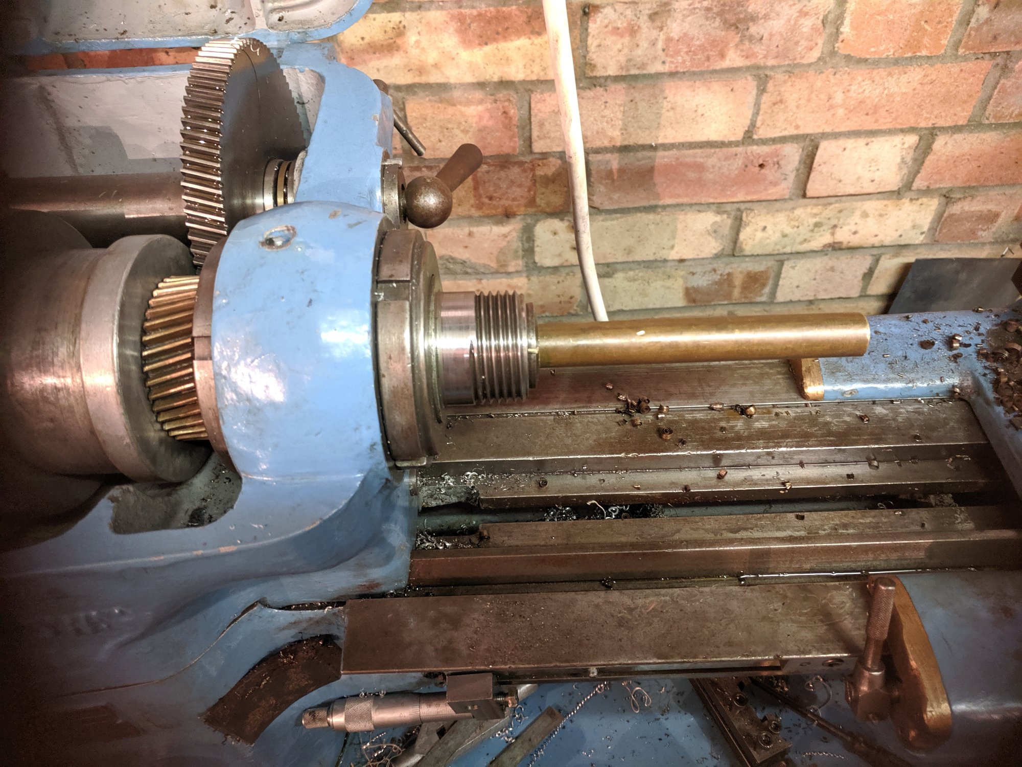

A inch down the spindle ain't bad at all mine is a bit less.than thatDepends on your point of view.
You can pass bigger stock through your headstock.
Consider myself lucky.
Spindle takes collets directly giving me full bedway
Also get an inch down the spindle.View attachment 196738
Is that the Boxford spindle seadog.20mm and MT3
Had a quick look the other day when Lee said 15mm. Sure it would have had a taper.Sure is![]()
