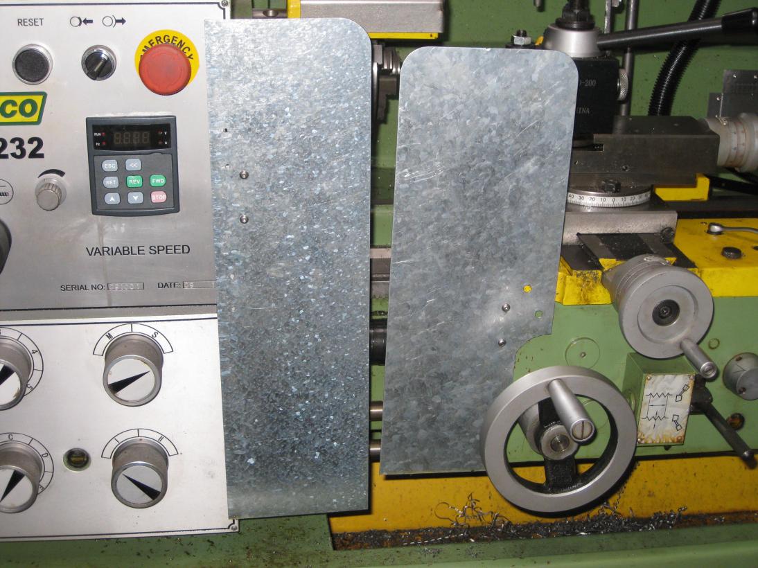

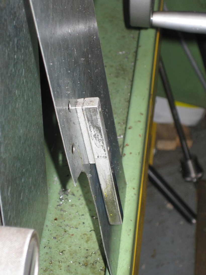

Thanks @Laurie Tedcastle I like that idea especially the sliding extension too. So the guard has a piece on the rear that slots into the box section attached to the apron does it.@123hotchef
pair of quick & dirty guards I fitted to my lathe to avoid coolant splashing. Left fixed to the headstock, right to the apron.

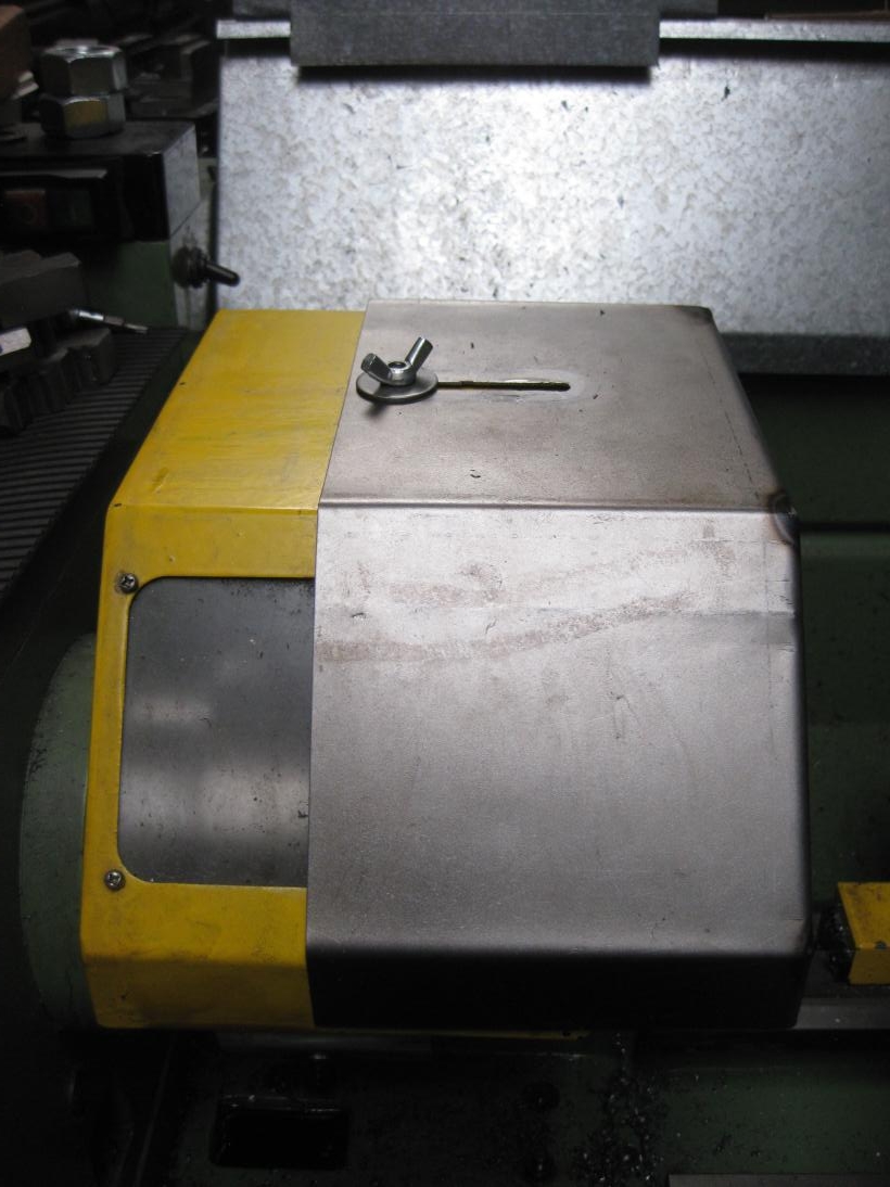

When working closer to the headstock, the RH one slides inside the LH:

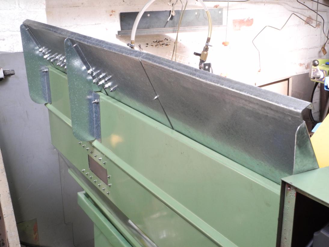

The guards are easily removed when not needed. Bracket on the apron:

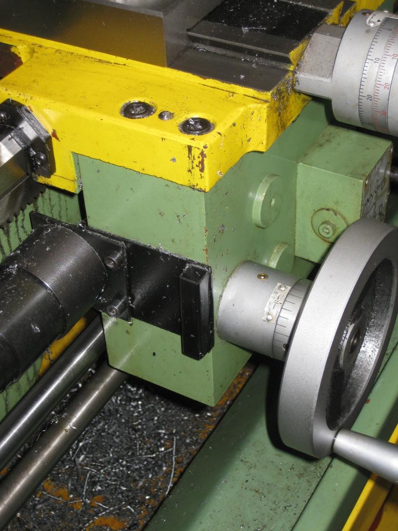

Reverse side of the apron guard:

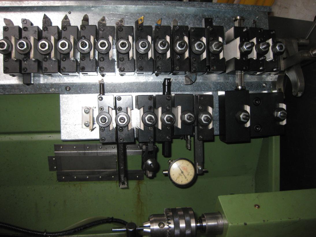

Also have a and adjustable extension of the chuck guard:
Laurie
How did u fit the box section that the guard slides into on to the apronThey are domed head hex drive screws (not rivets) fixing the steel sheet to the peg which slots into the socket. Same for the headstock one, just didn't bother to photo it. The guards mostly stay in place, but are lifted off when tapping, changing chucks, etc.
Design was the quickest/easiest I could come up with at the time. Would really have liked a big sliding guard like we had on the Herbert turret lathes, but it would have been mega amount of work. If your not familiar with the Herbert lathes have a look at the sliding guard on Hood's Computurn thread.
I also had to extend the rear splash guard vertically to prevent cutting oil getting sprayed over the back of the lathe.
