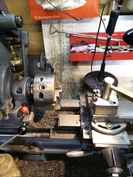

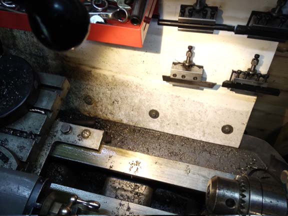

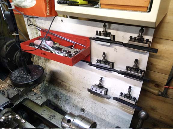

Is your wall wood covered and lathe against it? If so just screw the piece of alloy to it and have the bottom going into the drip trap.
Four holes drilled at the required height to match the 'upturn' on the drip tray, penny washer either side and tightened just enough to slip over the edge.....

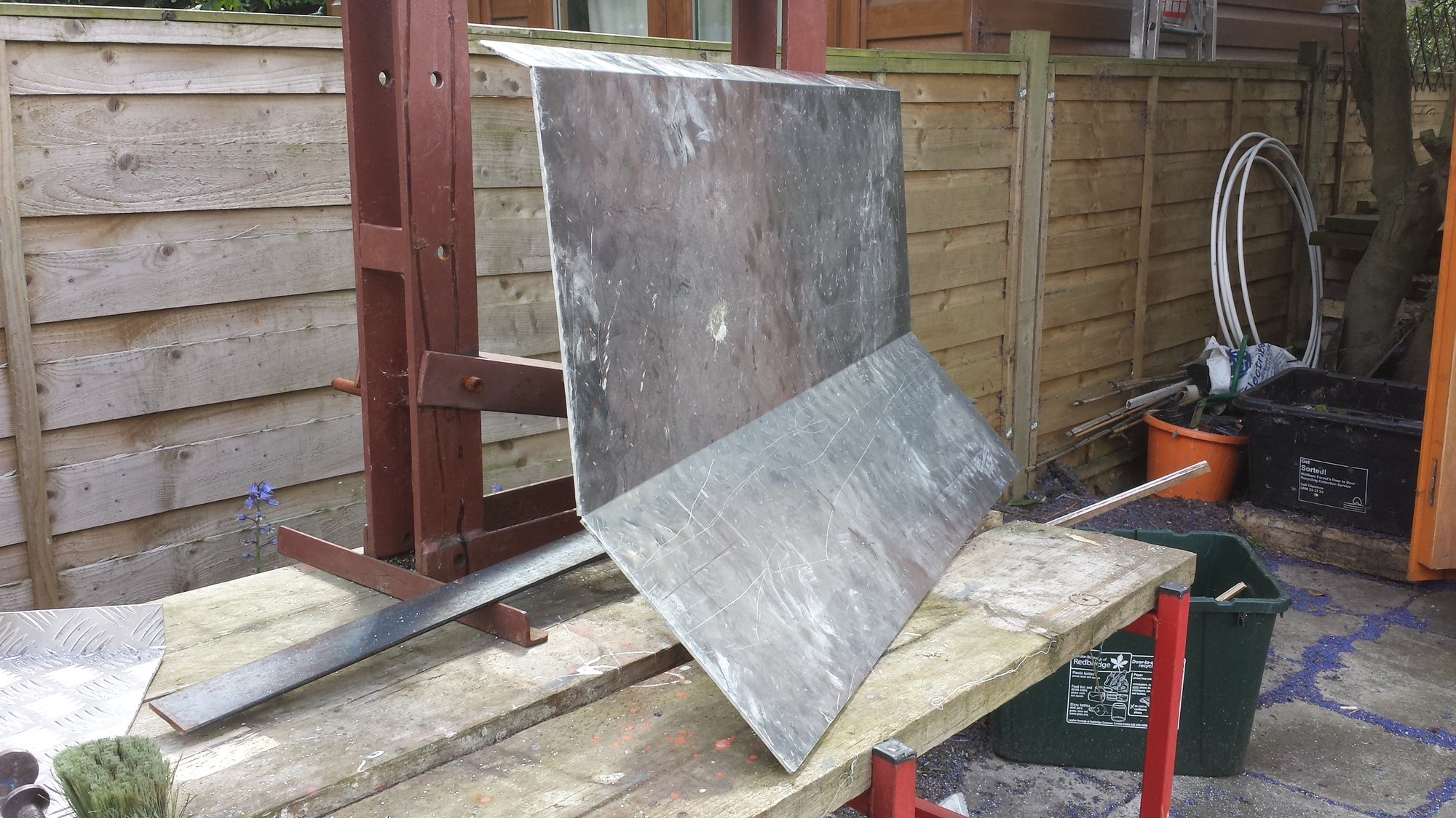

Ok I will steal the side on the machine at work.Backsplashes are nothing more than a sheet of metal with the edge folded to keep them from flexing. I made one from a cable tray lid. If you're going to use a timber wall with a lip to divert the chips/coolant into the tray, make sure you give the wall a good coat of gloss paint first then the mess will wipe off, otherwise it'll soak into the wood and turn it soggy. Also the white background will improve the lighting a lot.
put a fold on the left to keep the crud from going behind the headstock too

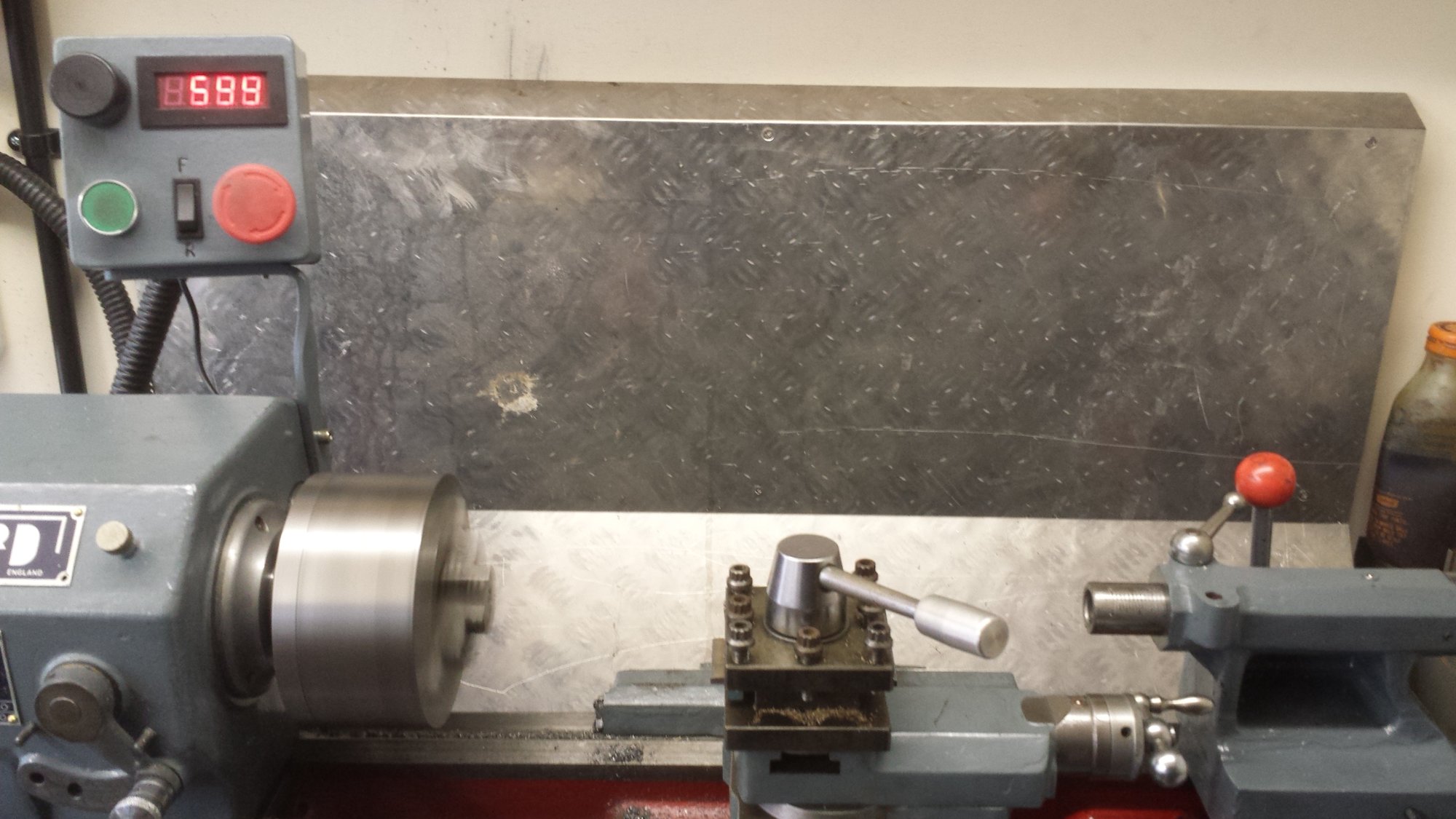

looks great my only issue is bending it nicely!My splashback.
A piece of 5mm chequer plate I picked up at the scrappy. Fixed to the wall. It allows full travel for my taper attachment, too.
