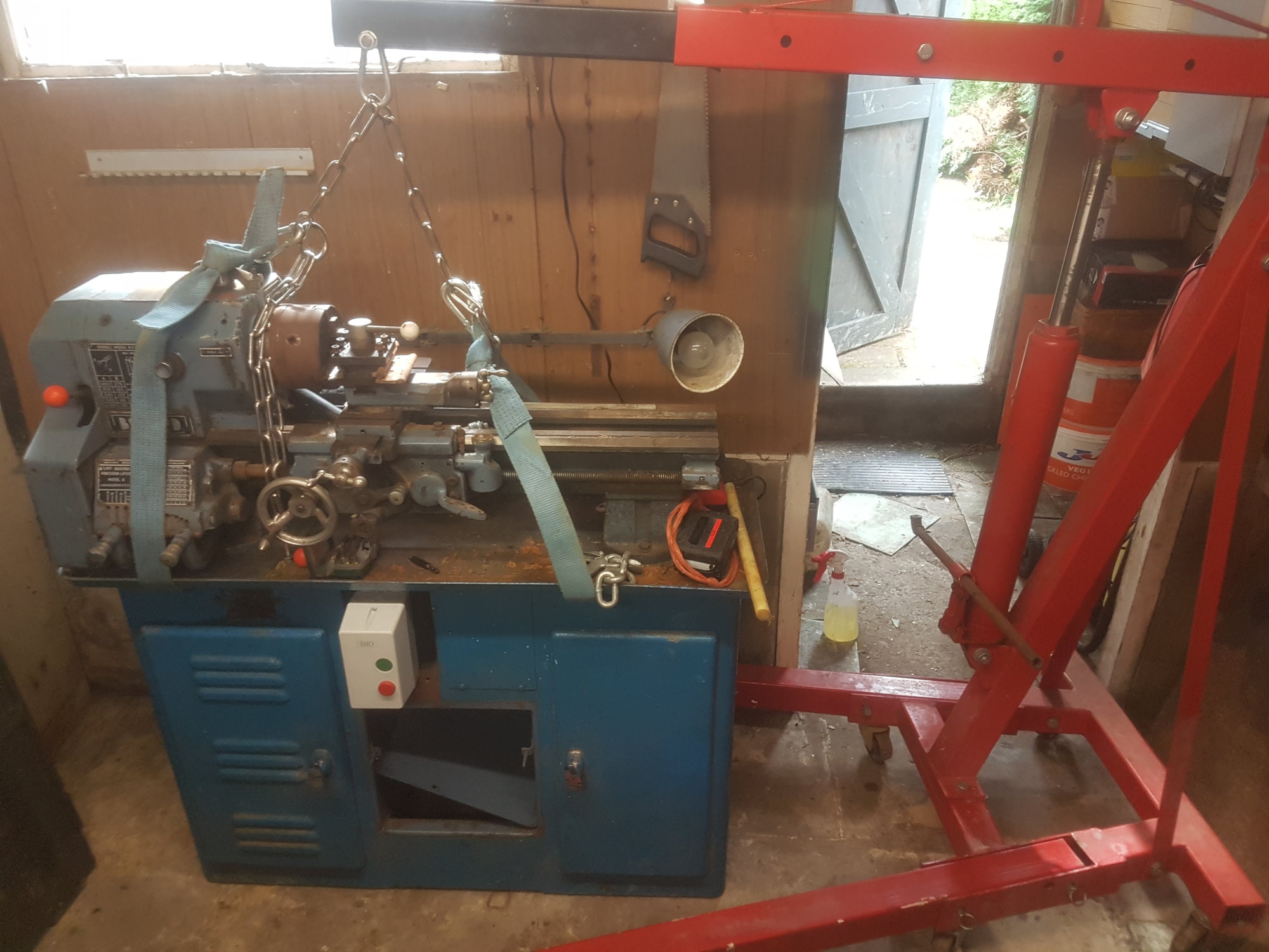

A few hairy moments   but hey it is nearly ready to be cleaned up and put to use

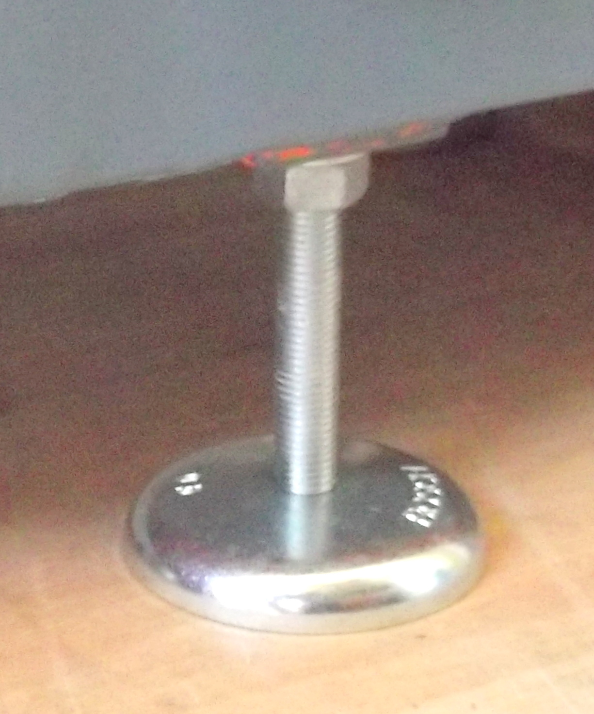

			ill take a closer look inside i didnt see any feet it sits on the cabinetDon’t bolt it, it should have levelling feet
Nice idea it may be a bit low actually but it might wobble if I make it a foot higher on feet lolThat is correct. However, you may find it's a bit low so worthwhile buying or making some levelling feet.

Don’t bolt it, it should have leveling feet

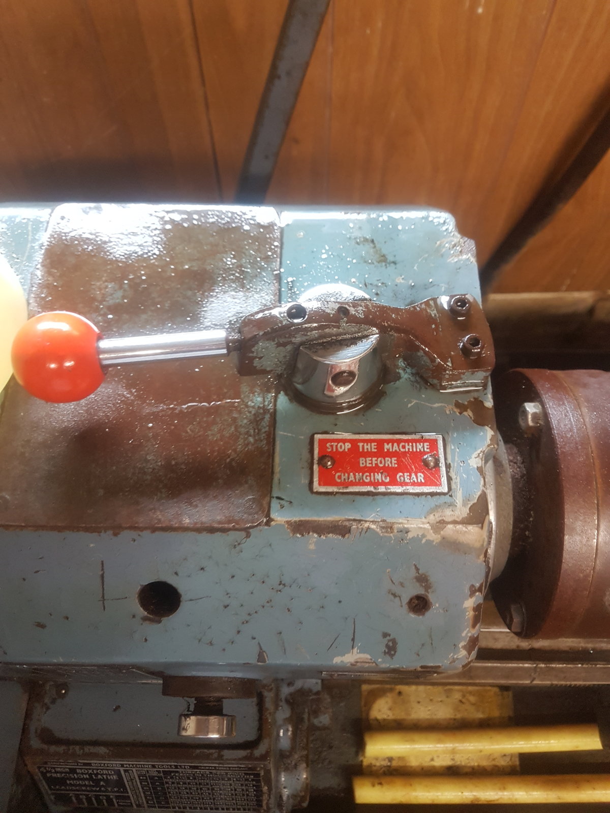

Oh and is this lever suppose to move

Yes it is; it's the backgear change lever. The idea of the screws is that one of them passes through the headstock casting, locking the lever in place and actuating a microswitch inside; unscrewing it then drops out the main motor contactor as a safety feature so little Johnny can't crash the spindle gears with it running. It should still work as long as the interlocks haven't been bypassed.
Undo the screws, press down on the knob and the lever should tilt and then turn through a short arc (20 degrees or so) which slides the backgear in or out. Help it along by turning the chuck by hand, you'll soon get the feel for it as the lever won't drop into place if the teeth don't mesh properly. Retighten the screws (usually only needs one of them doing up for each position) until you hear the microswitch click and you're away.
