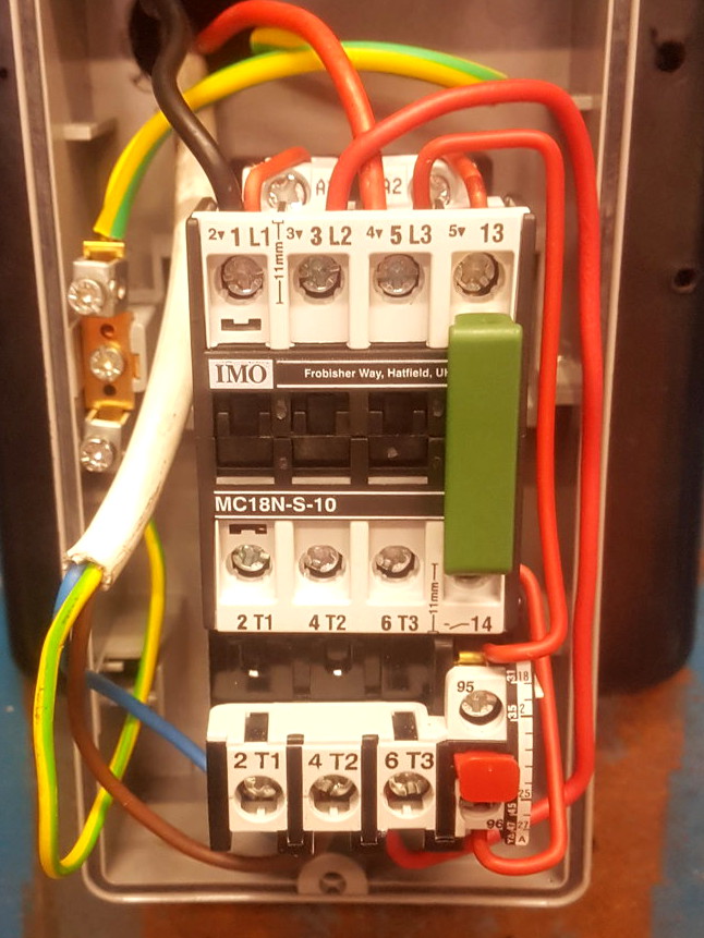

Wouldn't be trying again till I'd checked every connection myself. My current lathe project was wired well excluding the earth motor earth was connected to the starter. Mains earth was connected to the isolator. Nothing linking the two.I'll see what I can do. Thought I nailed it with the back gear micro switch. But no it ran for 3 or 4 seconds then cut off. Then after 30 seconds or so back to 2 seconds

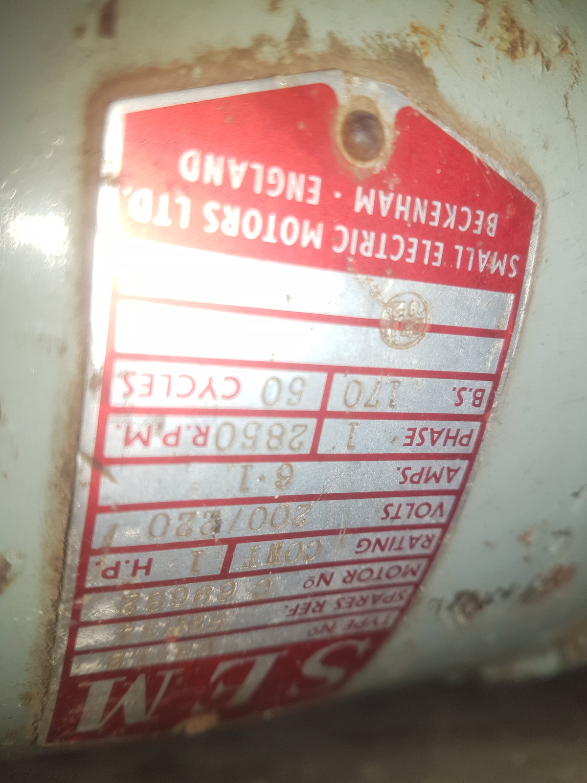

What's written on it?
I don't have 3 phase at home. I know there are converters. Let's get it up and running first. What is the over load for and what does it do apart from turn it on and off. What do I need to check.I'd get rid of that for a nice 1450rpm motor - or a 3 phase.
Anyway, back to your problem. Someone mentioned the overload and I think you should look there first.
Ah thanks Pete I wondered what that was for I thought it was seconds or something for start up. I will give that a try later and report back. So you would not be swapping the old capacitor thenIf you look at he bottom right there's a load of numbers and what looks like a pointer that seems to indicate that the overload is set to about it's lowest setting, near the number 18. If you find out how to adjust that upwards it will carry more current before it drops out. Might cure your problem.
