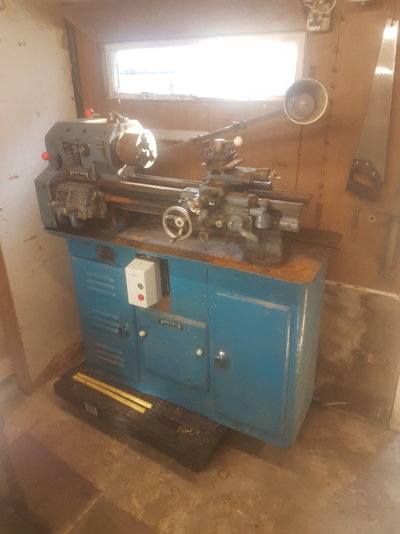

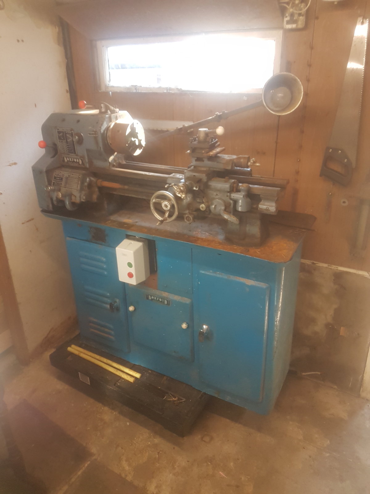

Nice one hotchefIt's in just need to get it off of the dolley
