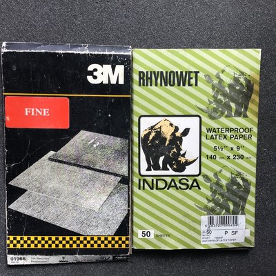

thankyouIirc, I started with 800, then went 1200 > 1500 > 2500 > 5000 - finishing off with Farecla G3 on a 2" wool pad in the DA.
dont have a mop,doing it by hand, the polisher I have I let some one borrow..we all know how that goes..
could order some more wet an dry I geuss ,finer that is if need be
Well that's a safer way at least if you manage to melt the lenses doing it by hand I can find a job for you once all this is over!
Another little tip - alter direction at the end of every pass i.e. across once, up and down once, then alternate thereafter
I have been using circular motion
that would be excellent. pm on the wayI can put a couple of sheets each of fine and superfine in the post on Monday if you can wait for them. I think they’re 1500 and 2000 grit.
Alternating straight lines is the recommended way afaik.
OOPs oposite to what ive been doing !! used the farclera g3 and luckily i am semi ambidextrous but now must admit my arms arm done in , got most of the cloudiness gone , need to go finer now and preferably get my polisher back, no chance of that for the forseeable futuare though..
