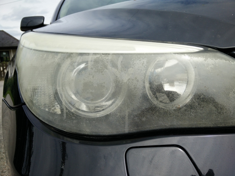

my mitsi l200 has those plastic headlight covers, previous owner has painted/sprayed a tint on them, how do I get it off ? trued solvol autosol ,no use , any ideas ? thanks guys
Da and wet and dry then just normal polish.
If really fussed the clear lacquer is probably naffed already so may need repainting.

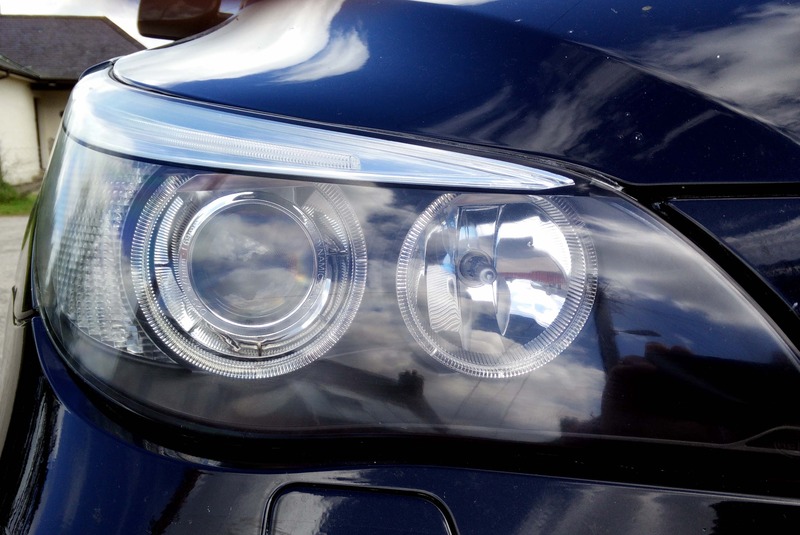

Aye, wet & dry - I did the lights on th ee60 [heart in mouth time , because to replace the unit from BMW is c £1100 ] and got them from this....
to this at the finish
That was about 3 years ago and they're just starting to need a maintenance polish and relacquer now. I aim to get them redone come the better weather.
