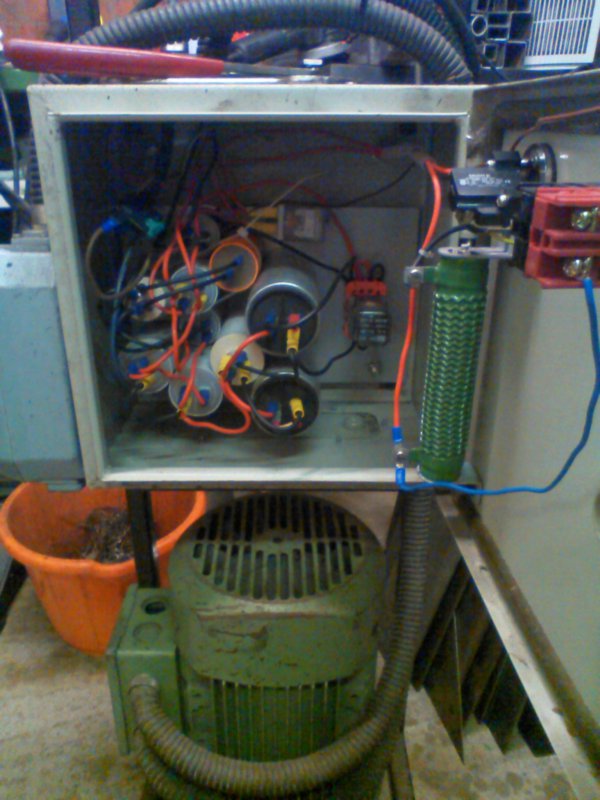

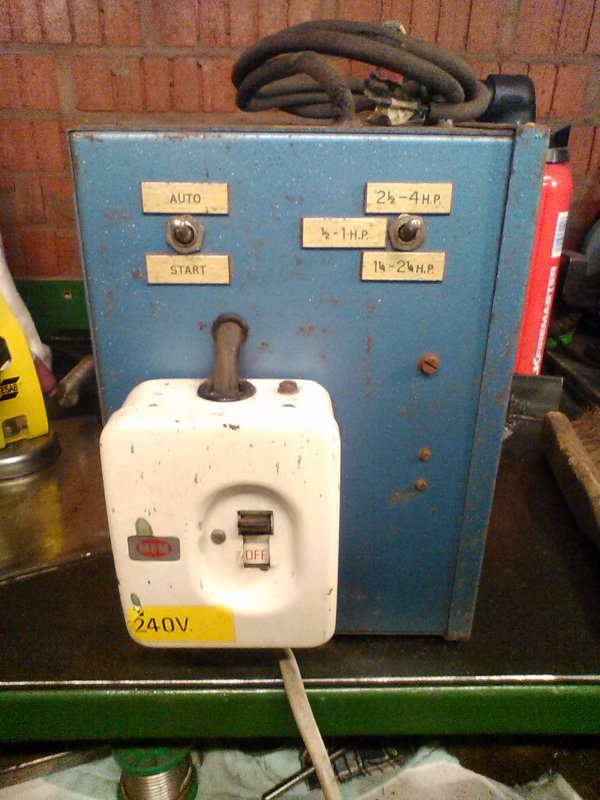

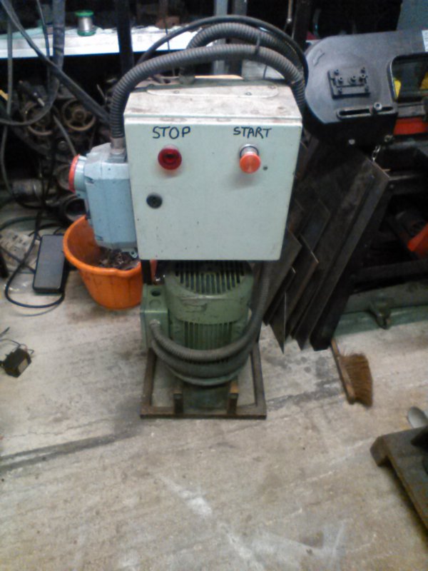

Nothing to stop Maker running additional kit from a VFD. My VFD runs a lathe, mill, iron worker, shaper and pillar drill. I use a static converter to run my universal woodworking machine but only because it has 7.5hp electric motors and the limit on my VFD is 4hp.When I looked at this the best option was a rotary, btw the mill might not be the only machine you get, lathe, drill, big belt sander![]()
