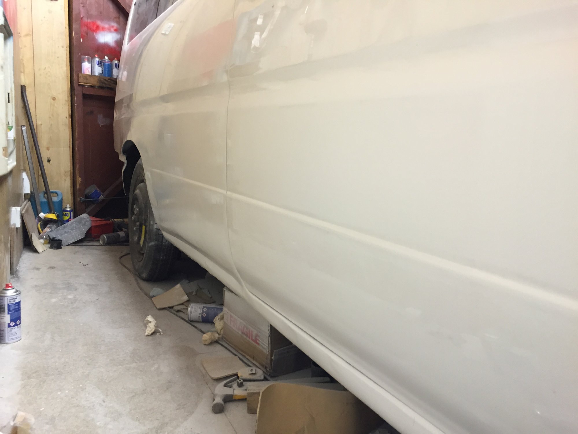

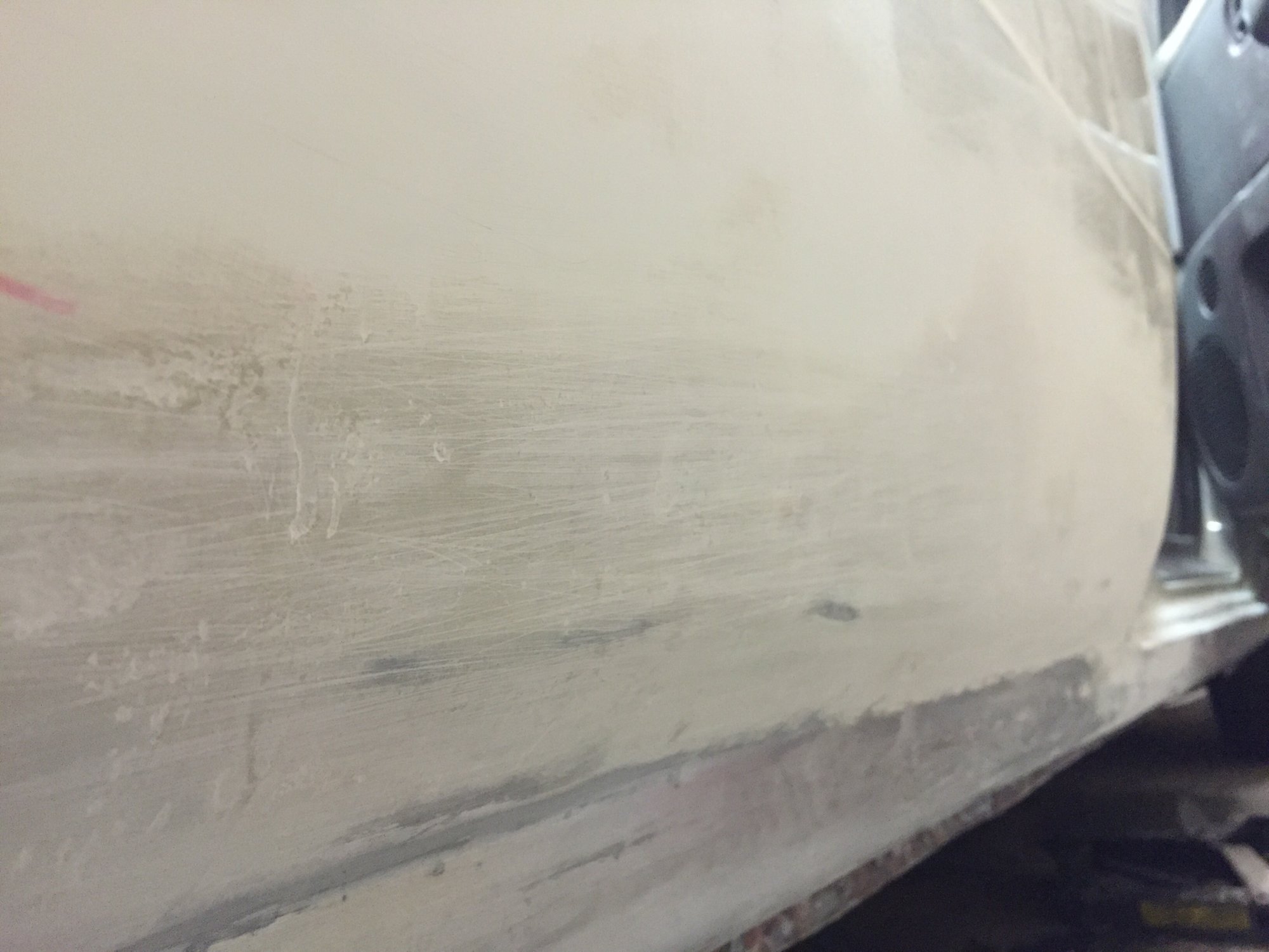

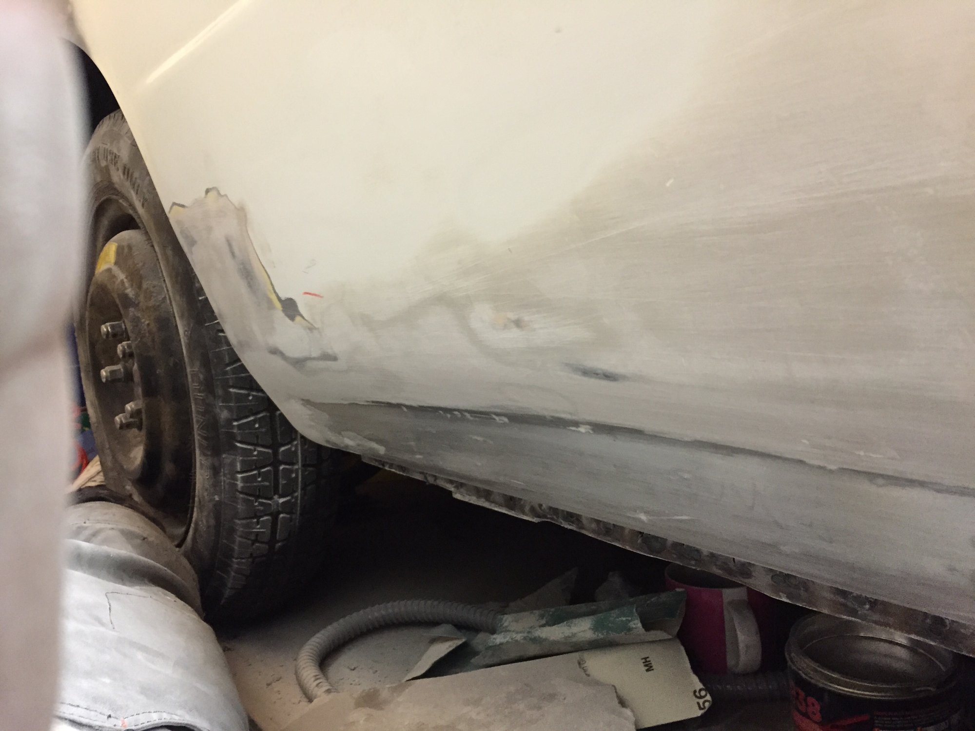

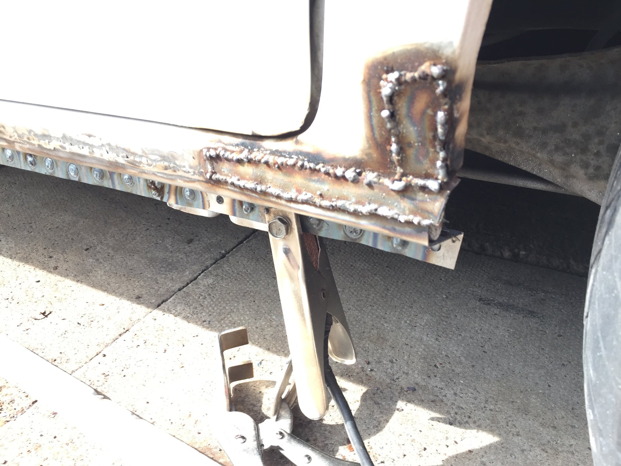

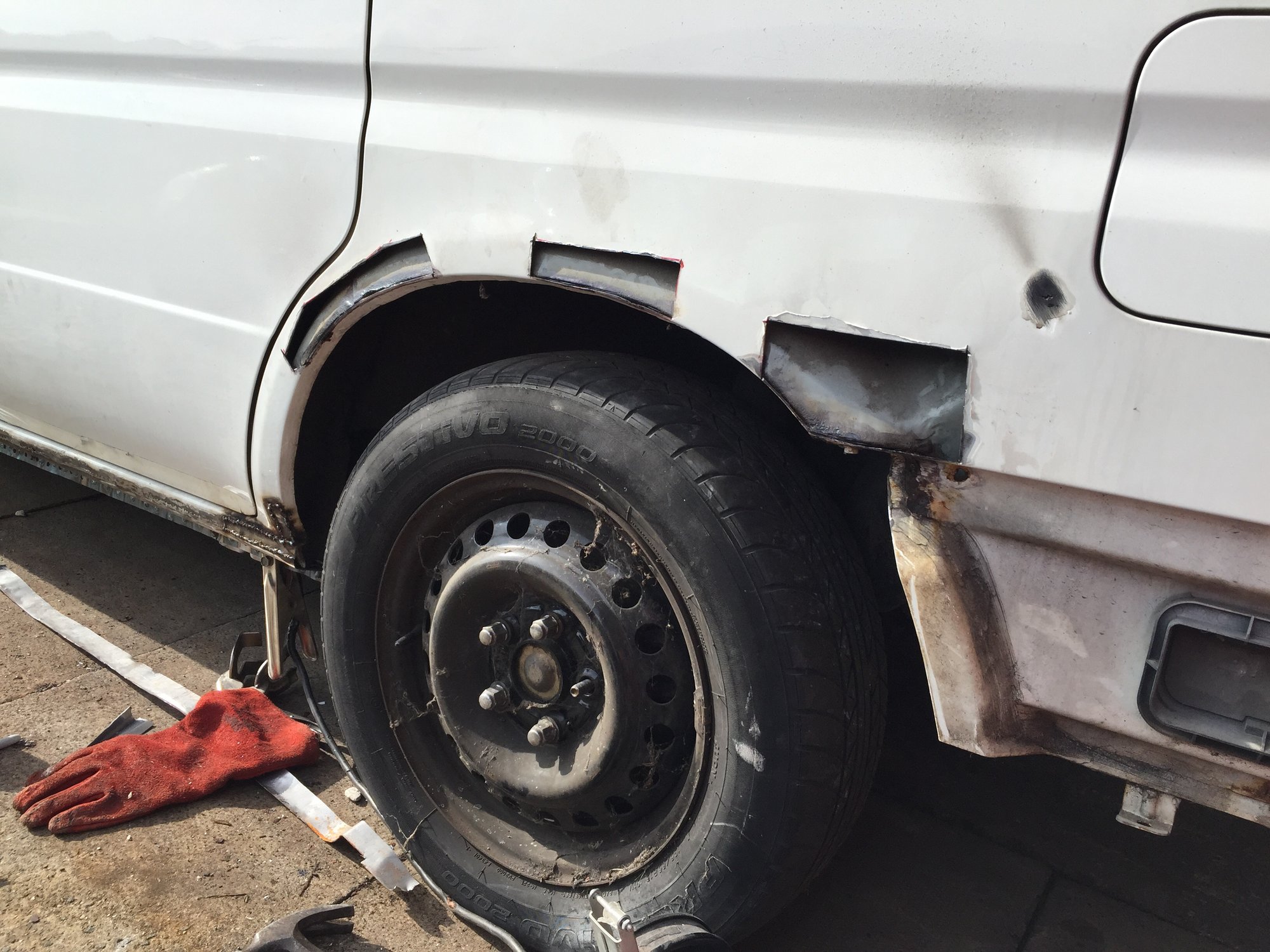

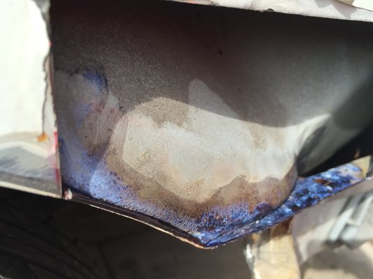

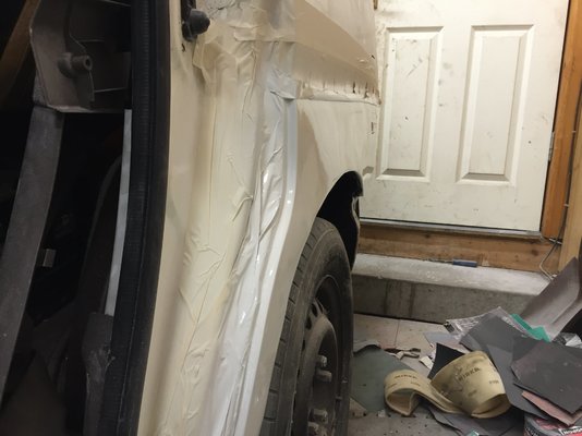

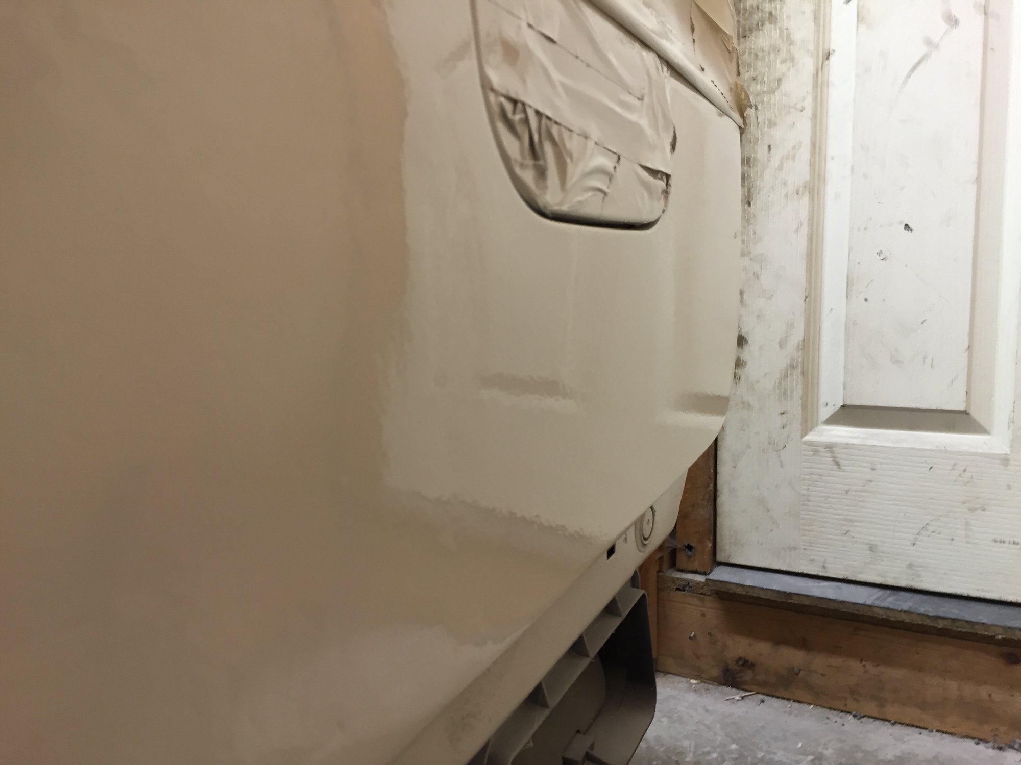

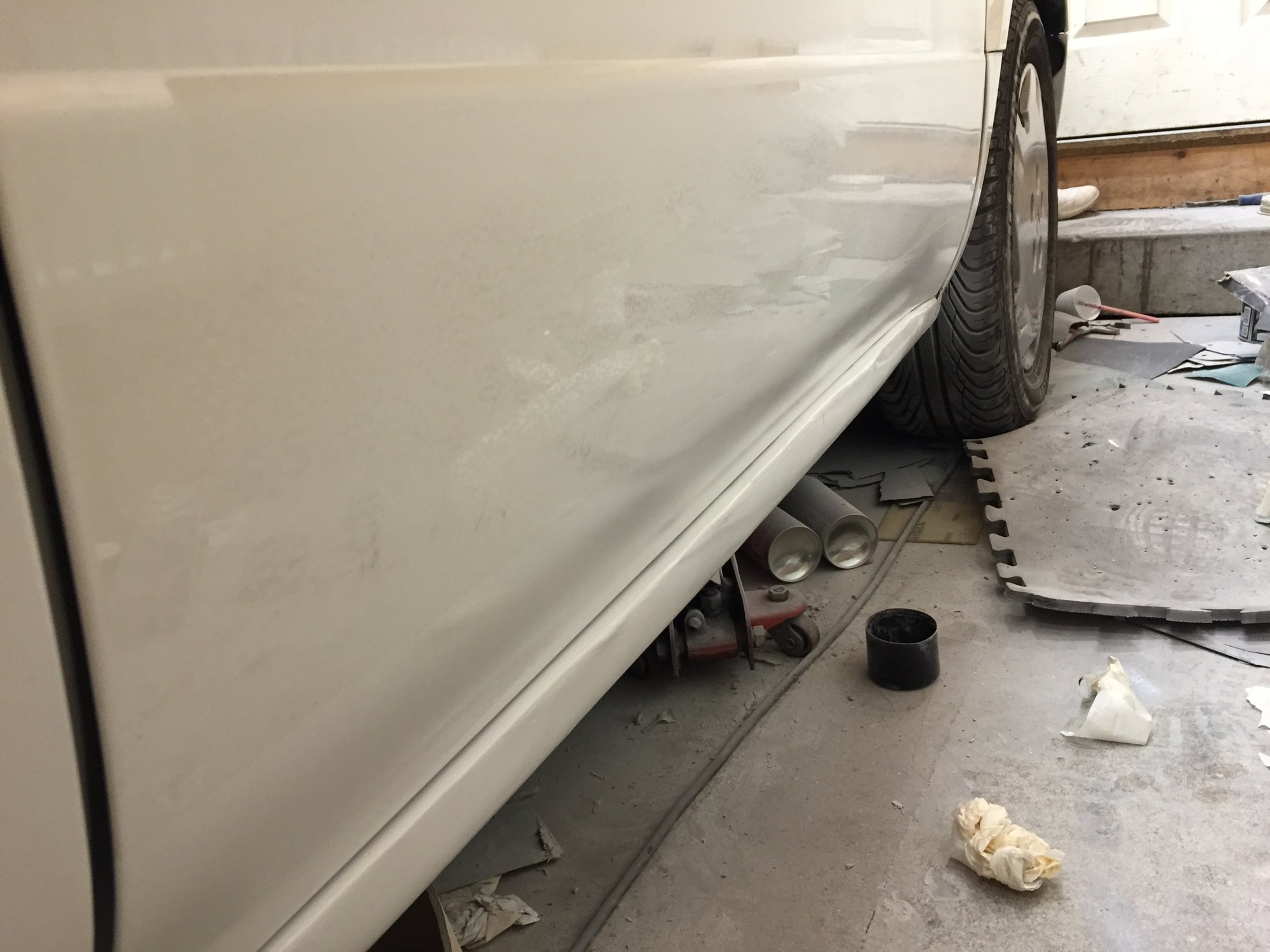

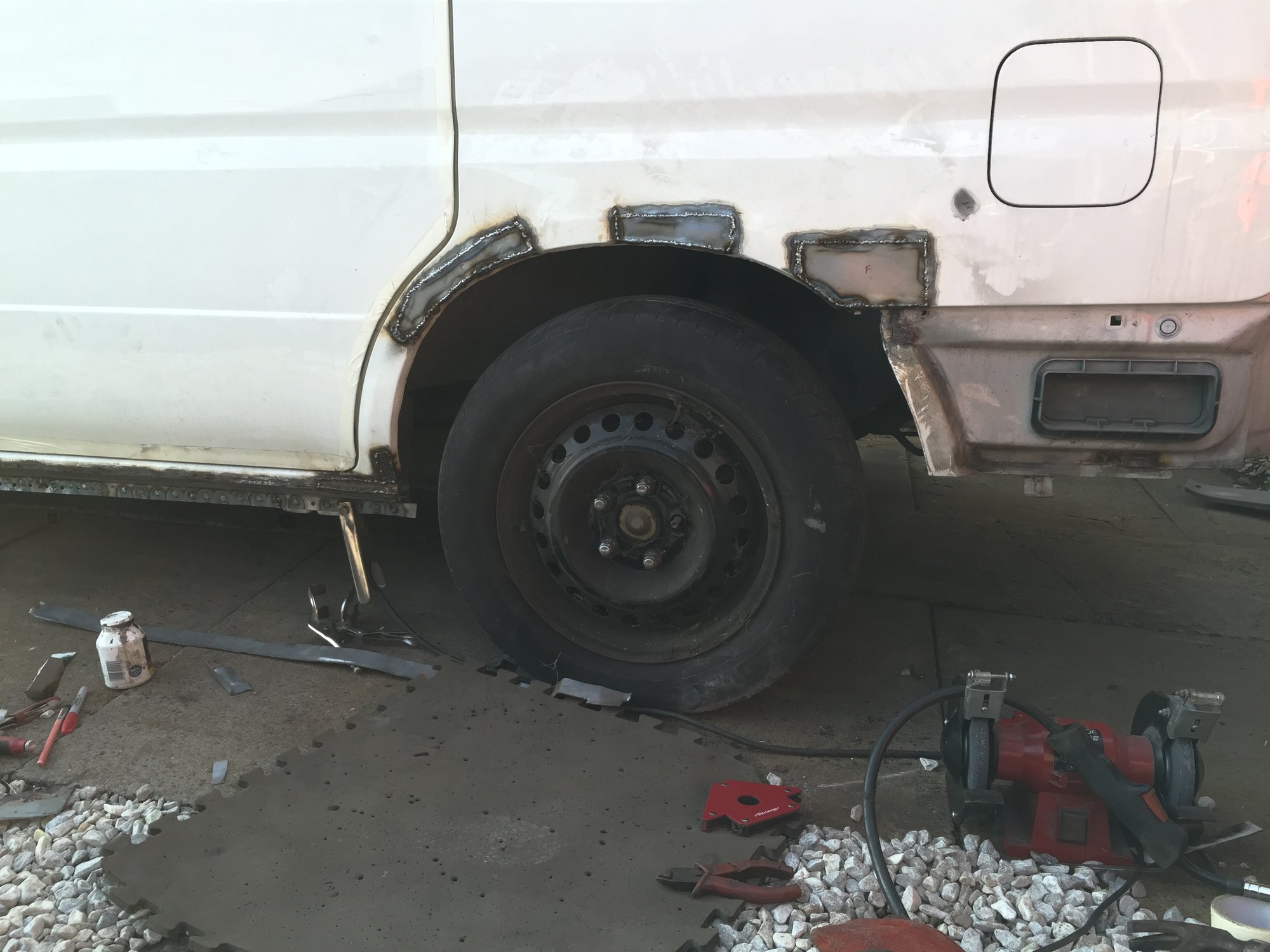

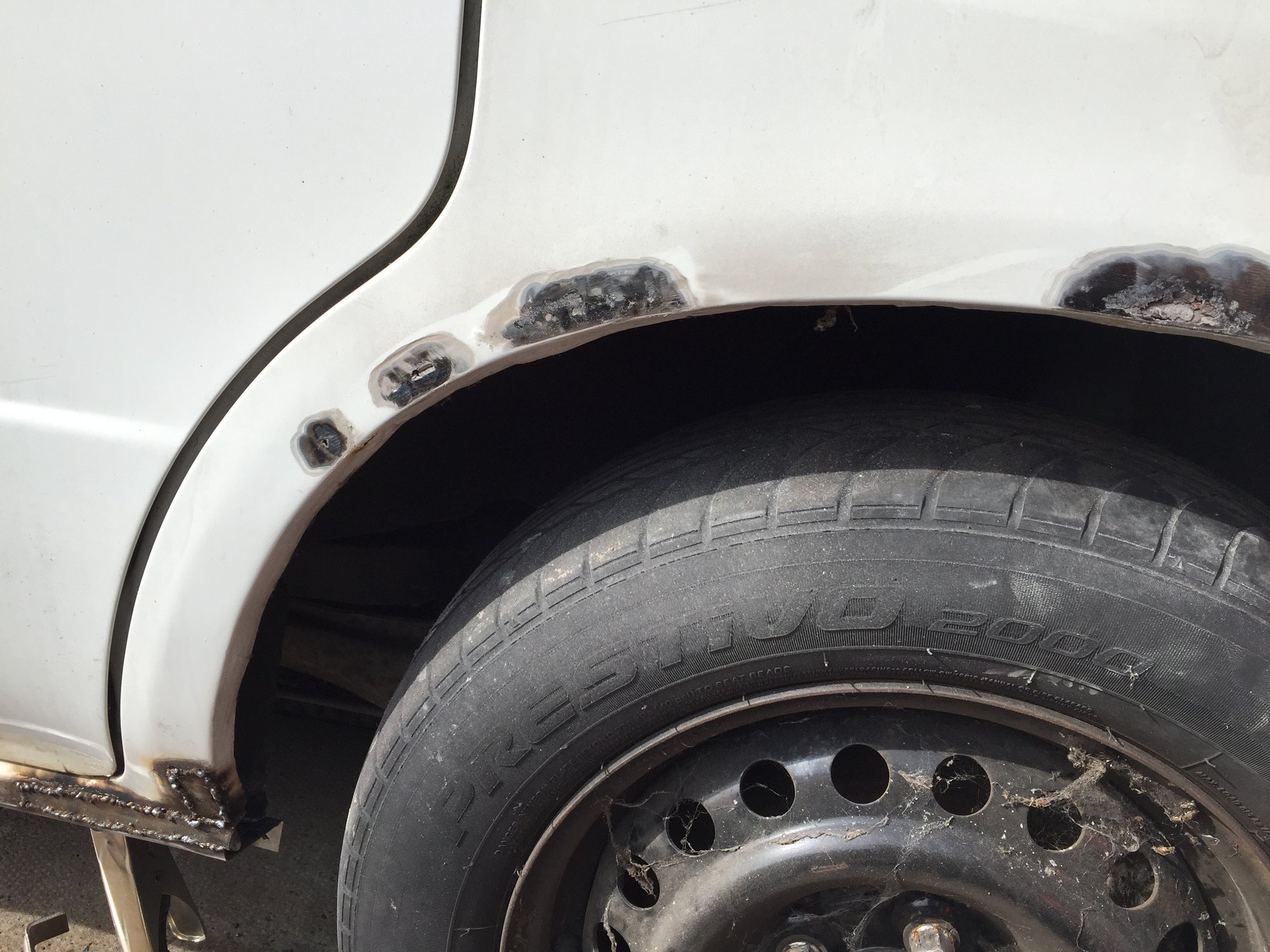

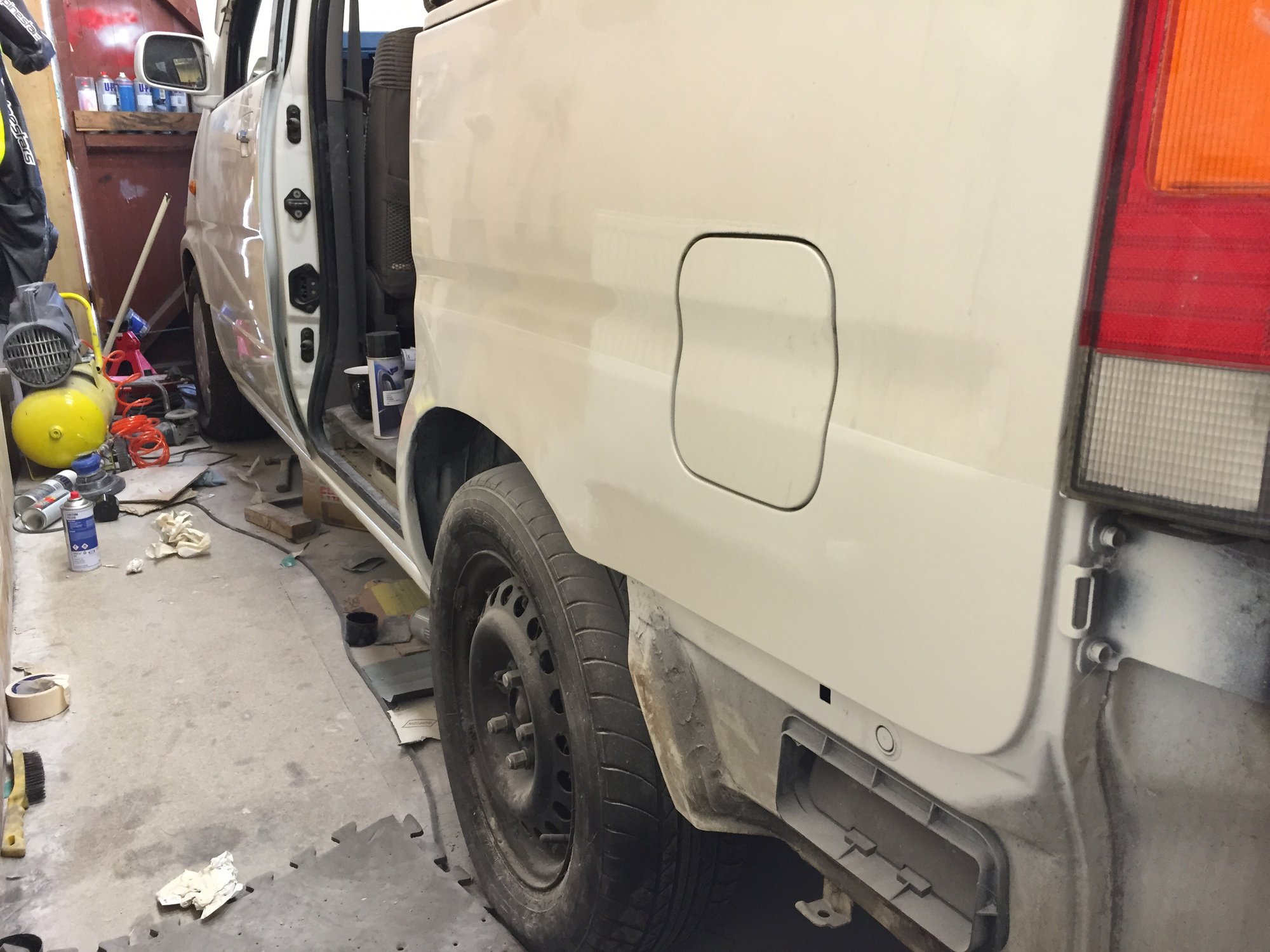

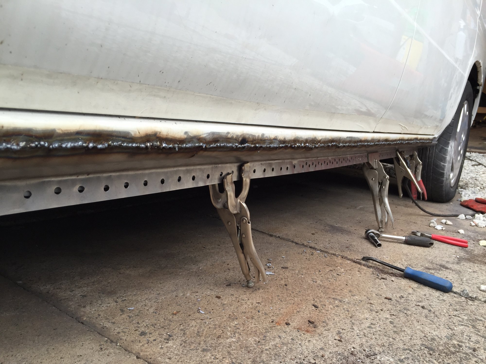

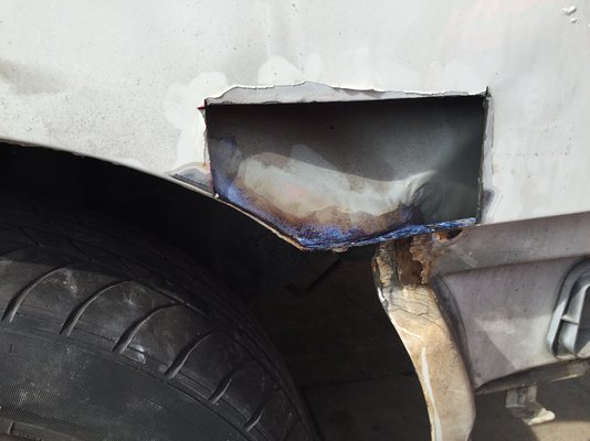

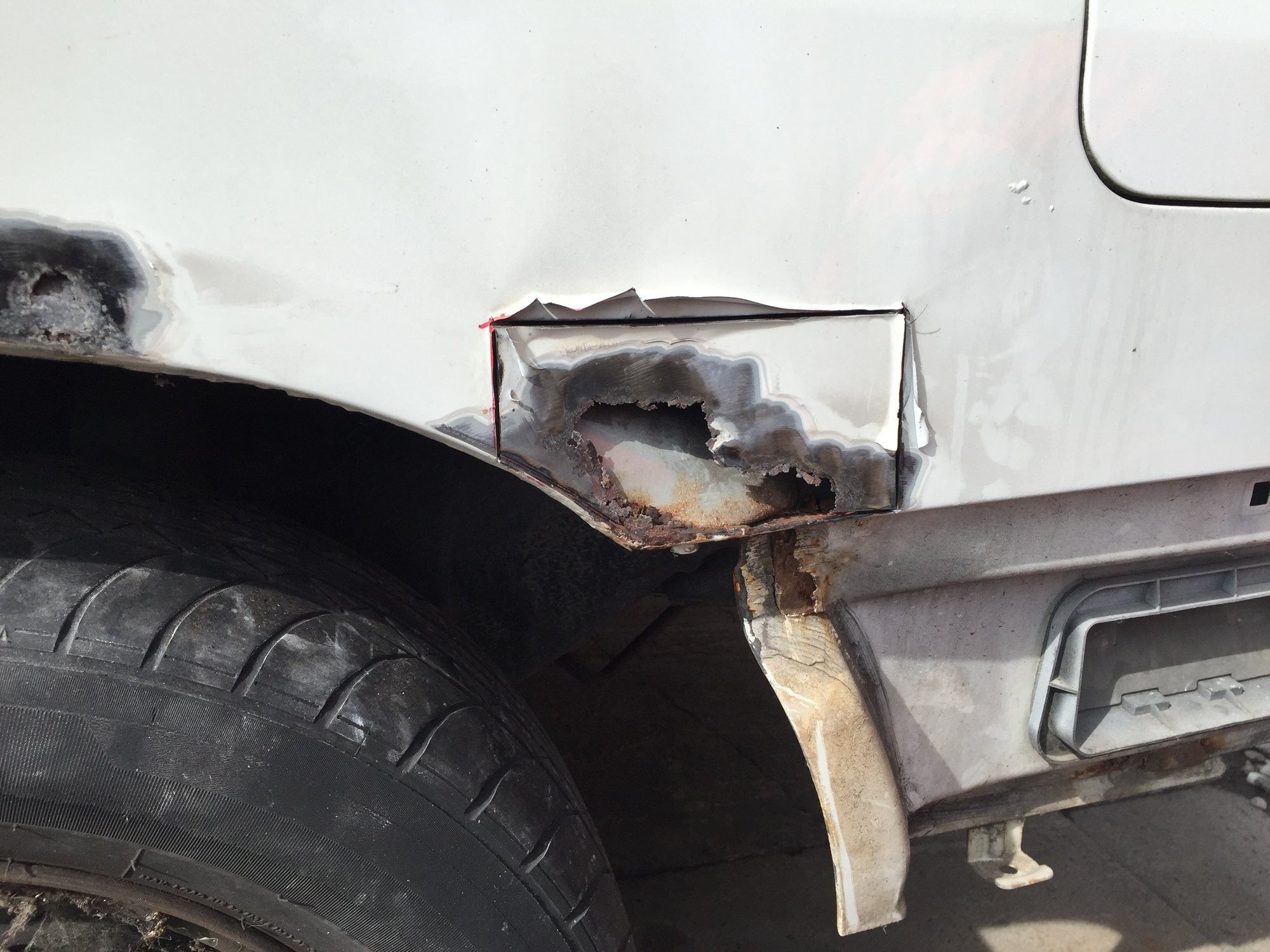

Doing a great job...I suspect that rear arch will be paper thin steel and a bit difficult to weld. After repair you might want to wax the inside of the arches too (thats what I did on my MR2). Are your inner arches OK....usually if there has been water in the arch it seems to run down the entire seam and rot out the bottoms of the arches on the inside...worth giving them a good prod with a screw driver to make sure they are OK.

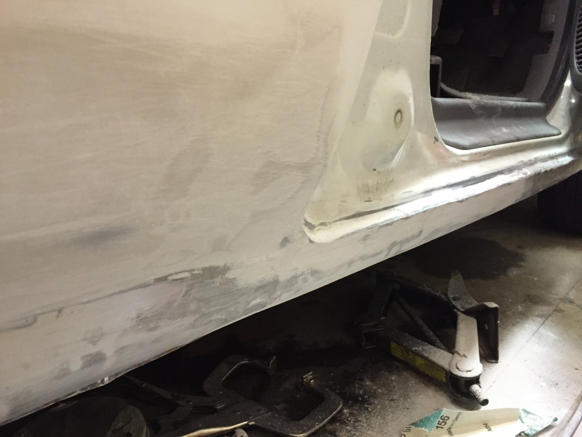

Those sills do look great
