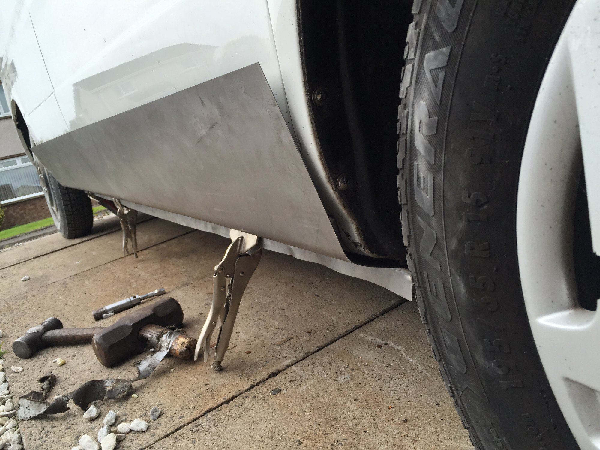

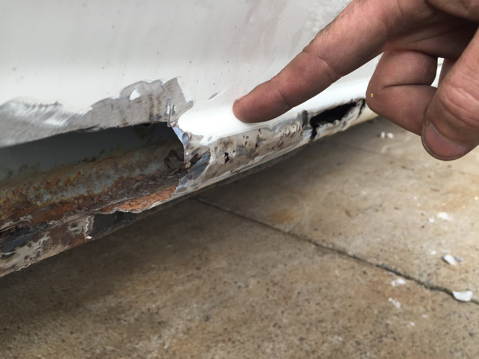

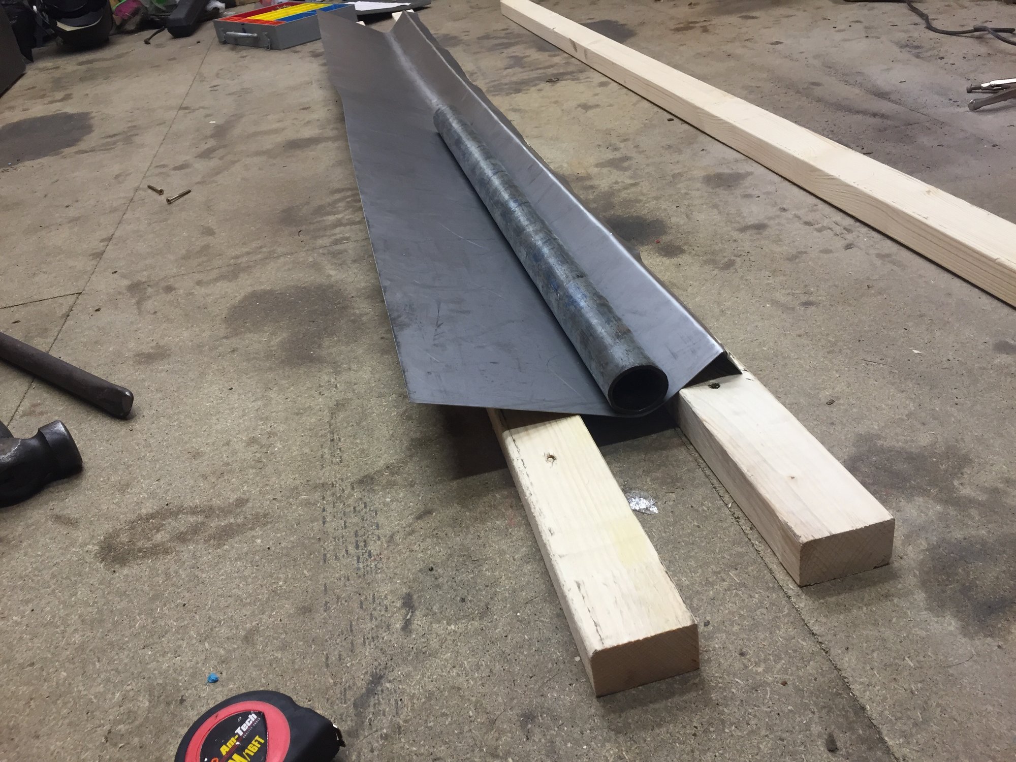

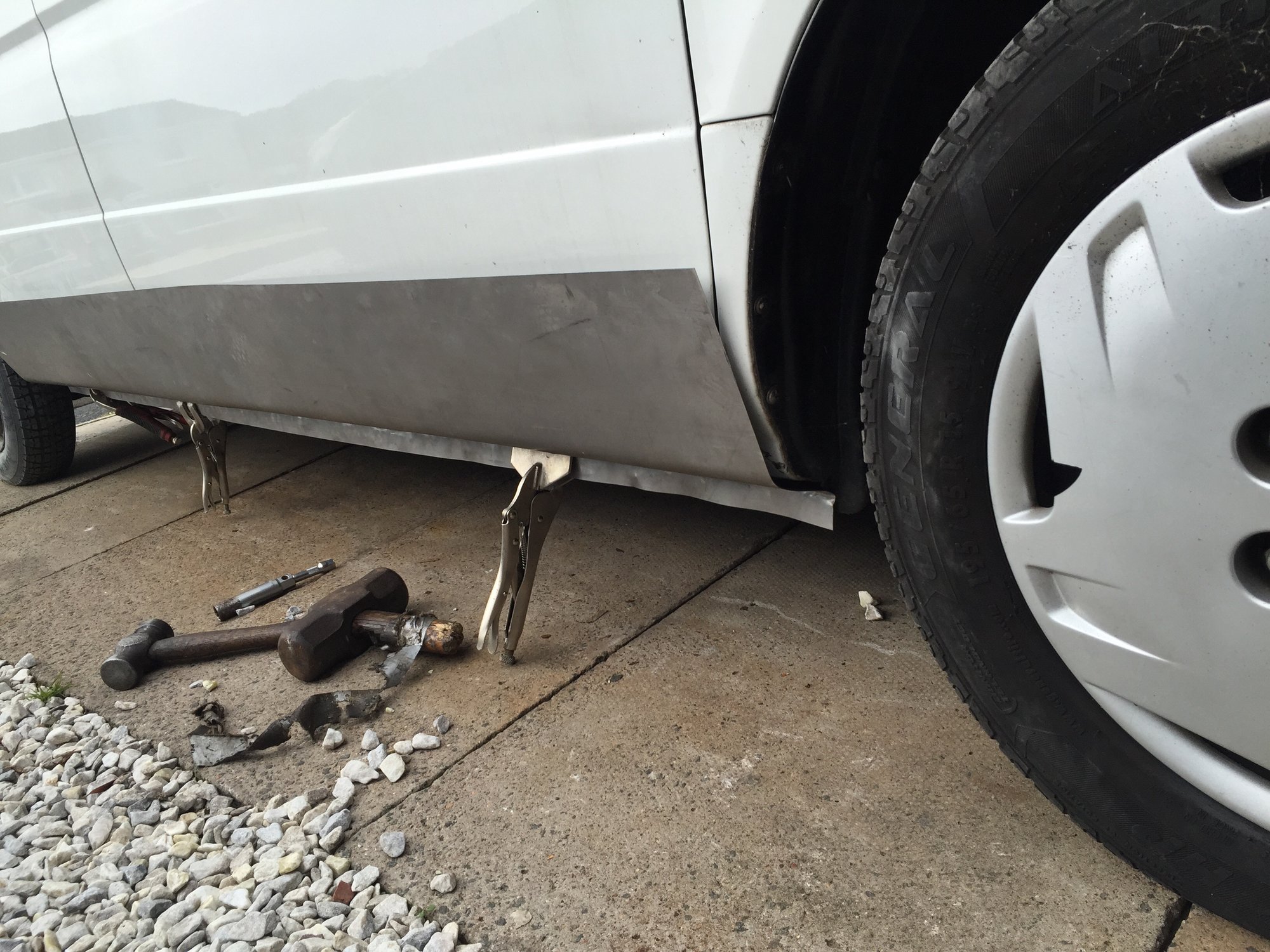

If you are replacing 2 whole sills and originality isnt a big problem then just finding some sills with the right width/ depth roughly would be a hell of a lot easier than fabing up some from scratch. As long as both sides match then the actual profile of the originals isn't a big deal
