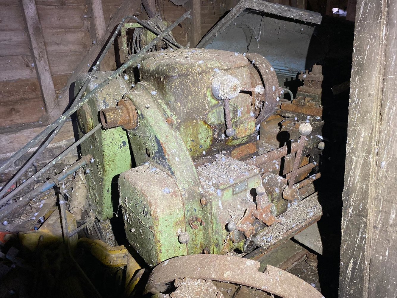

A bigger lathe has been on the list for years and didnt really want a 'project' but I know it will sit there for 10 years and be scrap if I dont have itRich coming from me, and my slow.... buys.
Remember to let me know about that ColchesterA bigger lathe has been on the list for years and didnt really want a 'project' but I know it will sit there for 10 years and be scrap if I dont have it
Sods law 2 would come up at the same time a Colchester and this but this one will be a doddle to move its sat next to a forklift and my mate is fitting a 2 ton hiab to his trailer this week![]()
good idea ive used citric paste before works a treatGet it bought. £100 is a bargain. Gear easy enough to get made for not too much money. That gear only runs the power feed and screw cutting. Not the spindle.
I’d be half tempted to scrape the rust off as Pete said then make a citric acid paste, let that work in then hit it with brass wire brush and finally wire wool.

and twice as rustyI’m half thinking about this swift and it’s twice the price!View attachment 285700
The bird crap will be more tenacious than the rustand twice as rusty![]()
