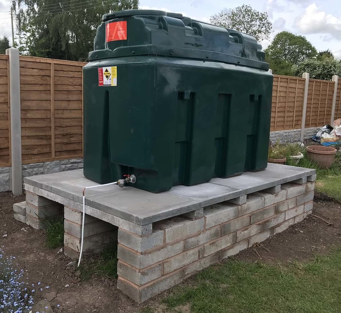

bad design 4 above and on this one below

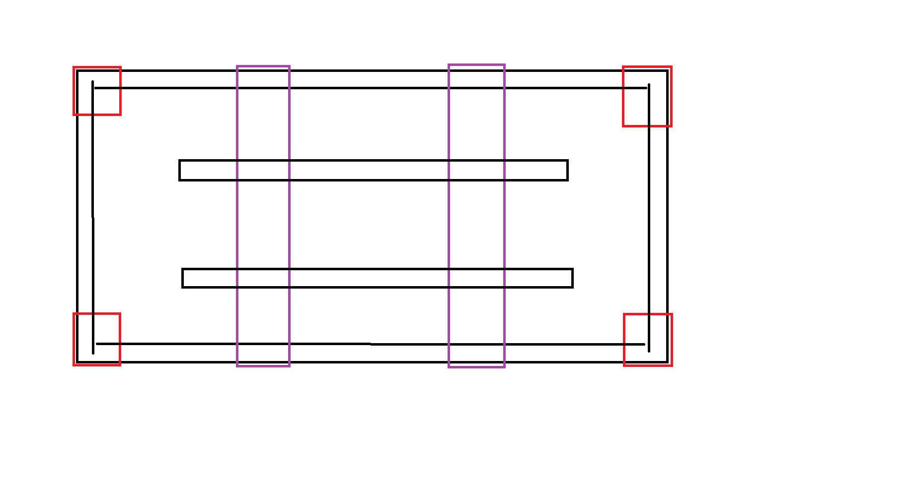

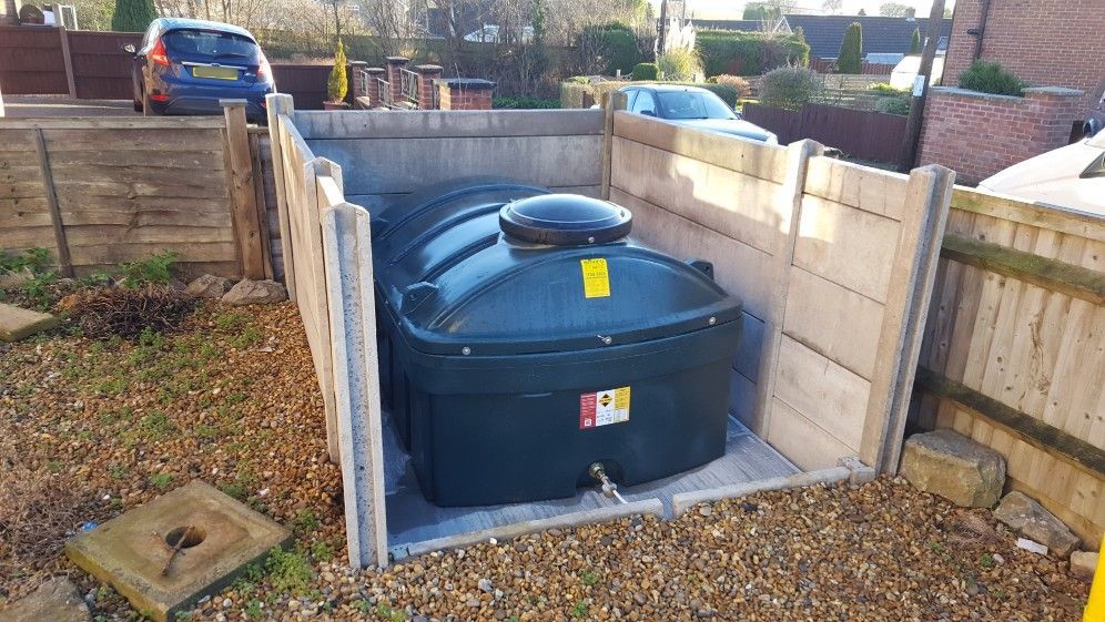

now for containment its better to have a concrete base with a sump area one to get rid of water another if the tank busts it becomes a catchment
either build concrete walls and have it metal framed above so it looks like a building but its more tamper proof against thiefs
and the other containment type is to use simple concrete barge boards fence panels
