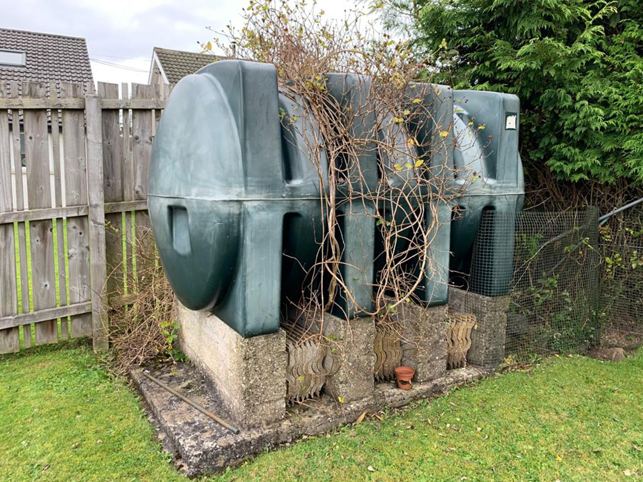

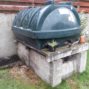

Dry packing with sharp sand & Cement will create a load bearing gap fill but that original support couldn't be much worse if someone designed it to be.
For a temporary measure I'd get some 130mm 7n blocks build a spine wall down the middle and a pier each end then dry pack it. That would take out the wobble and support the tank bottom.

I often order over 3000 litres at a time and only pay the 5% VAT rate (all domestic but 3 boiler systems on the farm) - (I usually use Boilerjuice for ordering)If it was me I would drain it down into another tank bought cheap from marketplace then stick some lintles under it.

Just had a quick look, found the following:The requirements for double skinned / bunded tanks comes from DEFRA as far back as 2001 and was intended that all installations were upgraded by 2005. Interestingly, the requirements are retrospective. If anyone wants a copy of the Guidance Notes For The Control Of Pollution (Oil Storage) (England) Regulation 2001 it's downloadable from the DEFRA website.
Think I would be inclined to leave the tank as is and put all my efforts into procuring a new compliant set-up.
https://assets.publishing.service.g...data/file/69255/pb5765-oil-storage-011101.pdfThe Regulations exempt any premises:
• used wholly or mainly as a private dwelling for domestic heating purposes, if the storage capacity of the container is of 3,500 litres or less.
Since the tank is single skinned and has a capacity of over 2500 litres then Part J of the Building Regulations applies and this is basically the same as the DEFRA guidance. Also contains limitations on position of the tank with regard to combustible buildings. looking at the original photo there is a building right next to it.Just had a quick look, found the following:
And that’s retrospective then?Since the tank is single skinned and has a capacity of over 2500 litres then Part J of the Building Regulations applies and this is basically the same as the DEFRA guidance. Also contains limitations on position of the tank with regard to combustible buildings. looking at the original photo there is a building right next to it.

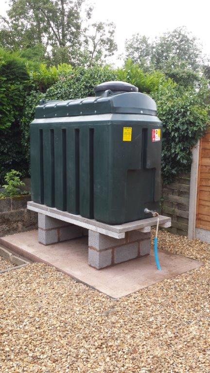

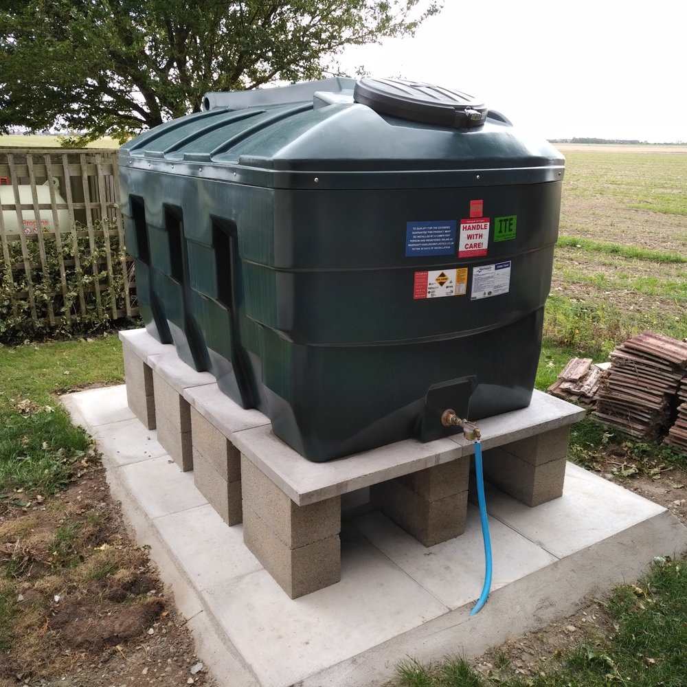

I've been skimming this thread as I need to build a support for a 1000 ltr (not the more usual 1200ltr) tank here. (Plastic, bunded)
I looked through doc j, expecting to find guidence on pillars etc but didn't find it. I'm sure I've found the required spec on slabs (if they're on the floor) before so I'm not sure if I'm just looking in the wrong place.
My plan (as it's what I have and it seemed right) was to do there pillars (the tank is 8 foot long) of 7n blocks on their face, and lay 4 2x3 (could be 3x4, I can't recall) pre stressed lintles over the top, and then a layer of 2 foot wide pavers - the ones that are about 44mm thick.
Does that sound adequate?

Why do you need to elevate the tank ?
One sat on the floor on a slab set can't fall lower. See the photo's in my earlier posts. Lots of farmers use battery fuel pumps to fill their tractors etc as it's cleaner & rarely ever has leaks .
