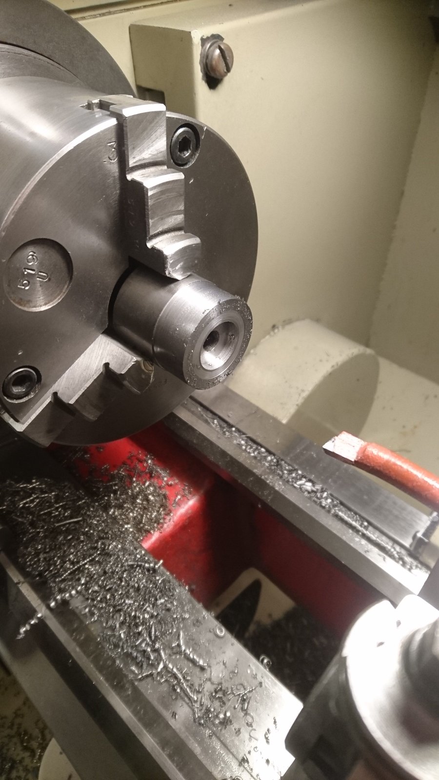

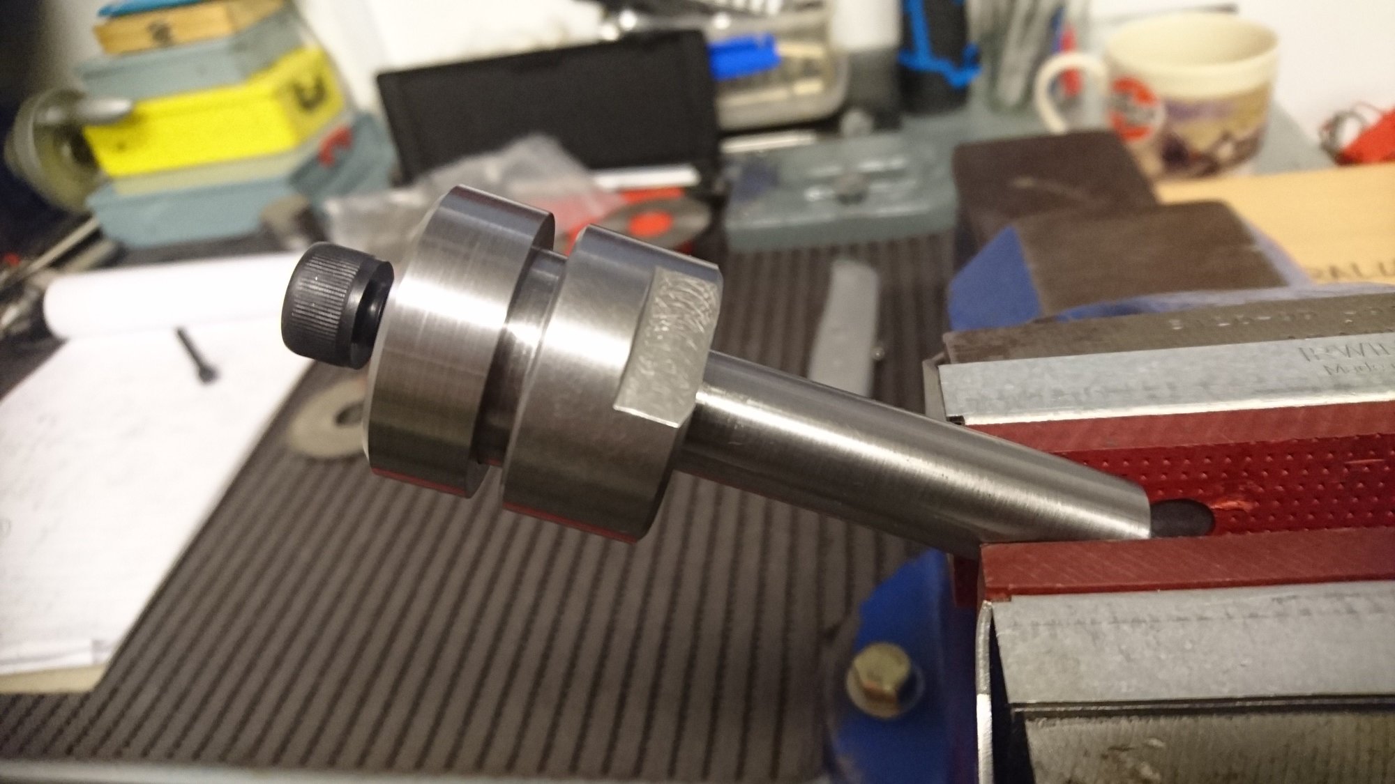

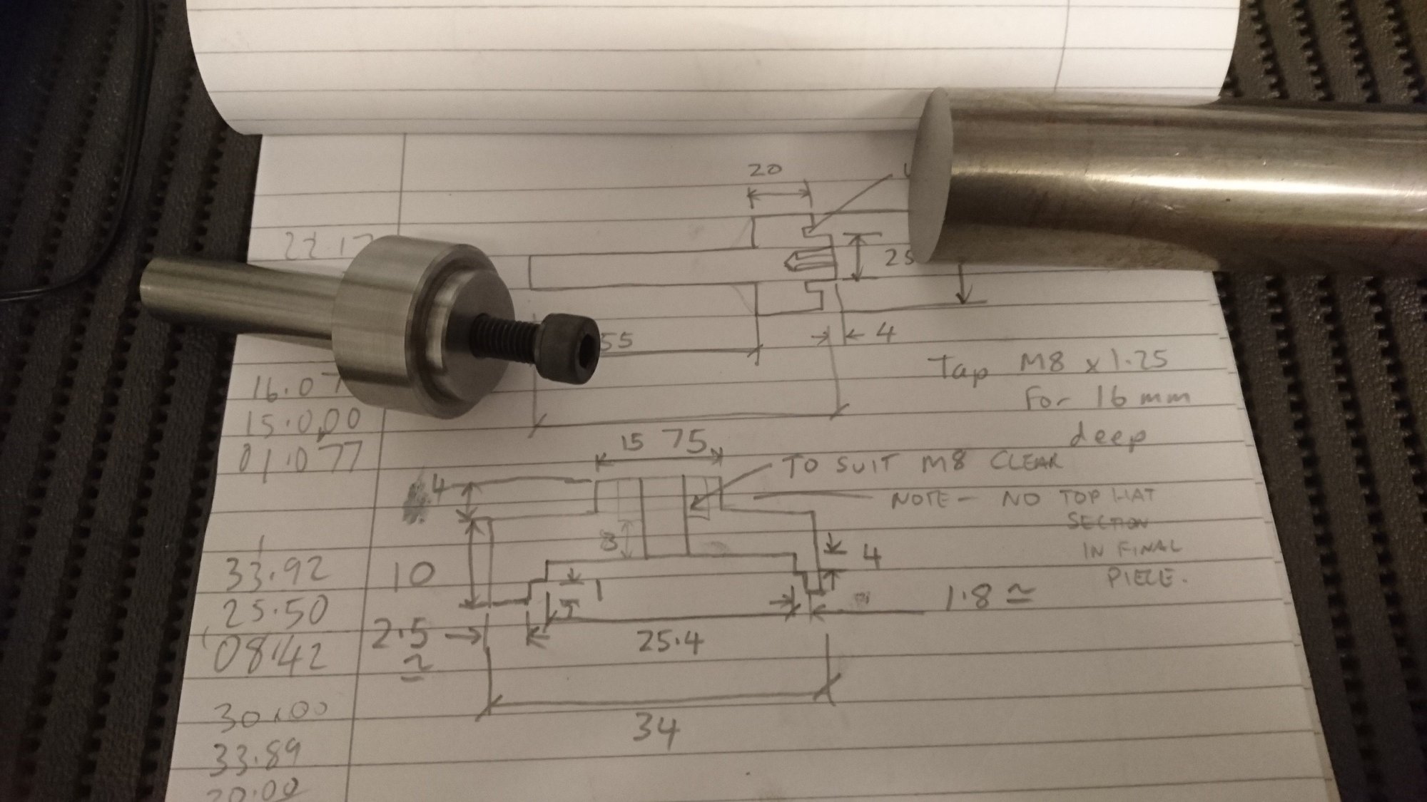

I'm going to give my workshop a good tidy out this evening in preparation for getting stuck back in. I left off starting down the road of making new change wheel retaining nuts for the feed gearbox.

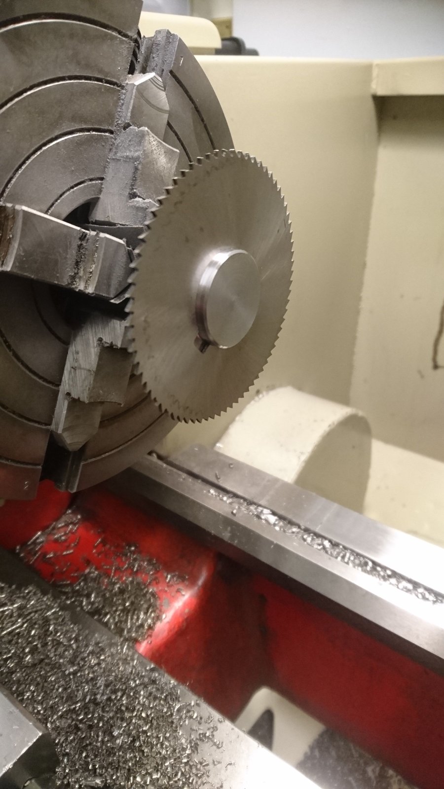

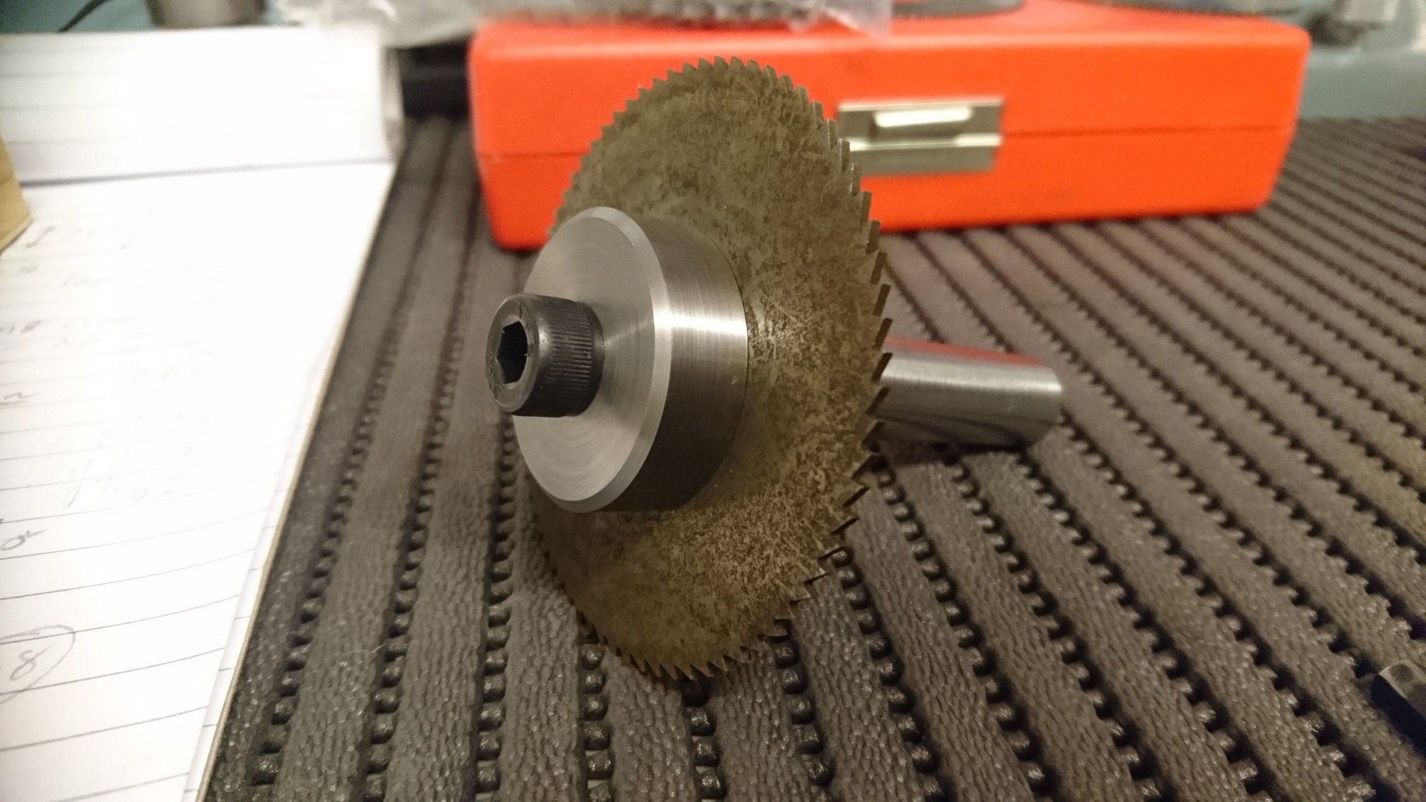

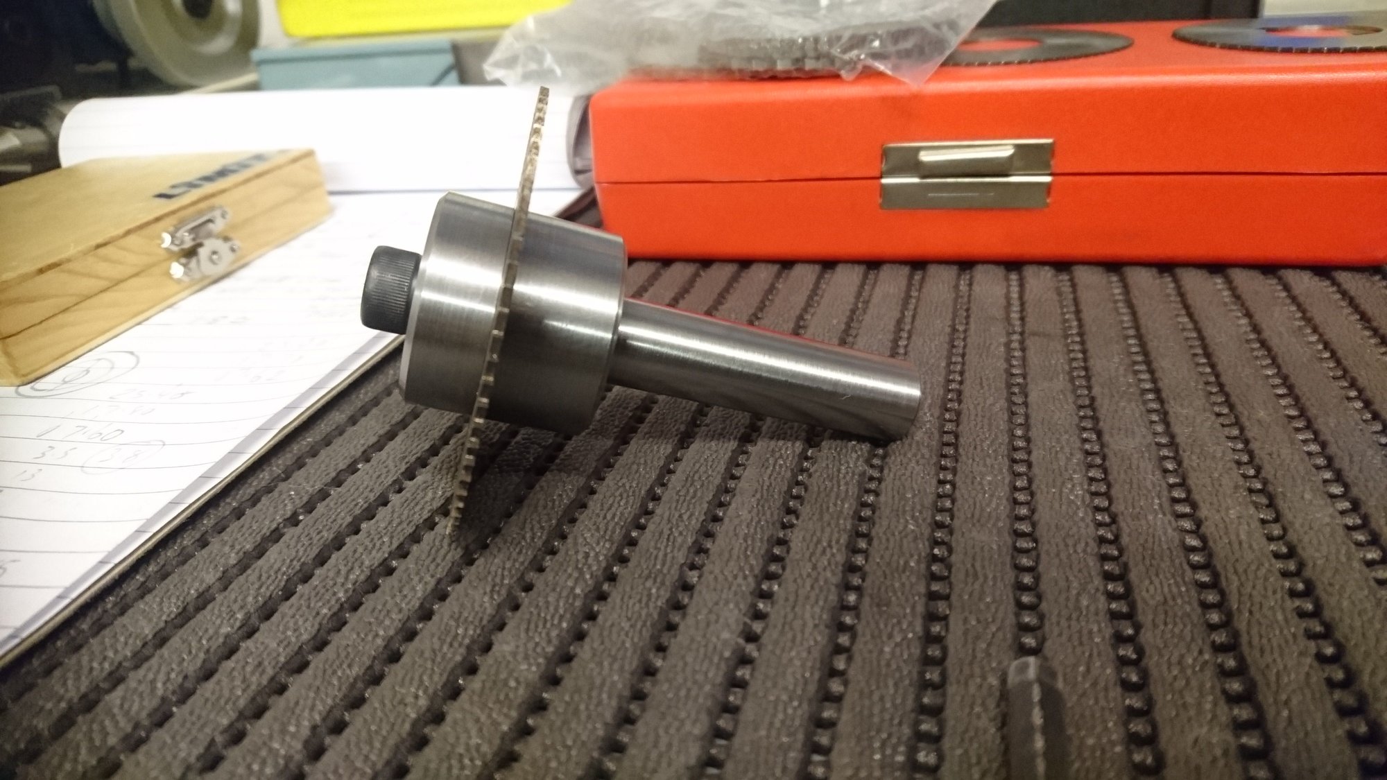

I think I will be making a slitting saw arbor first though, so I can cut the slots in the nuts. I've had a bunch of slitting saws for years with no arbor for them, so now is the time.
