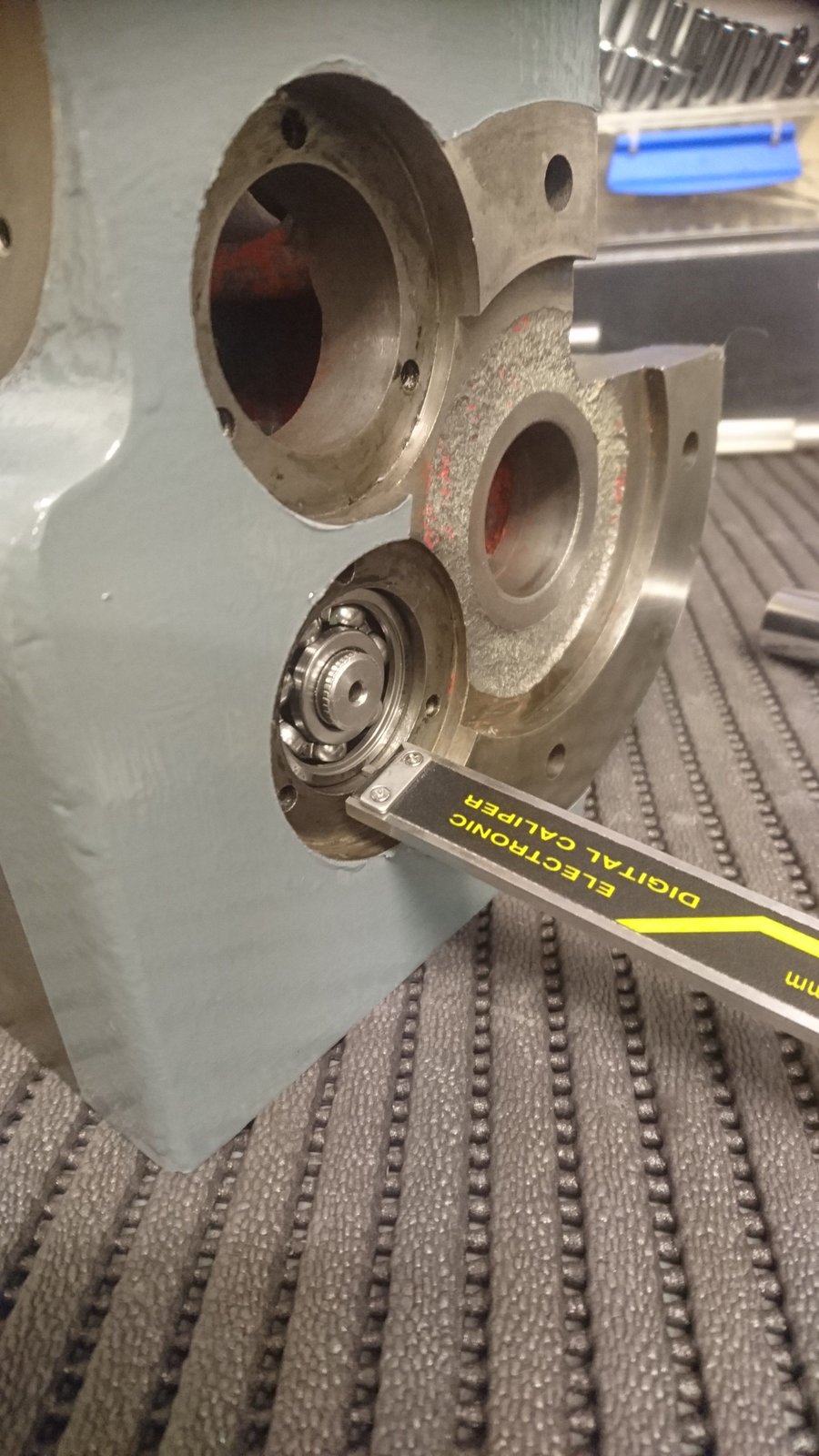

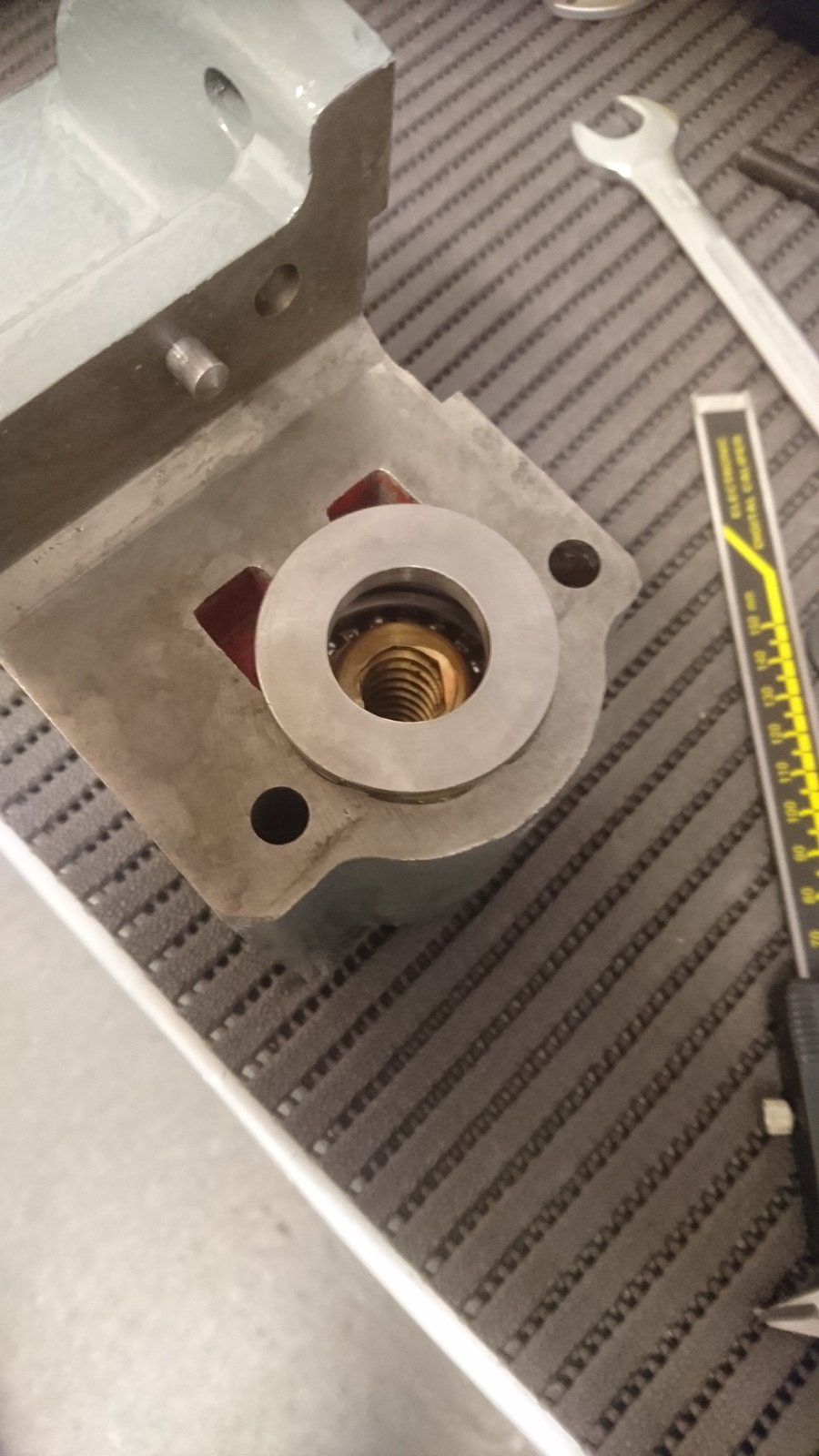

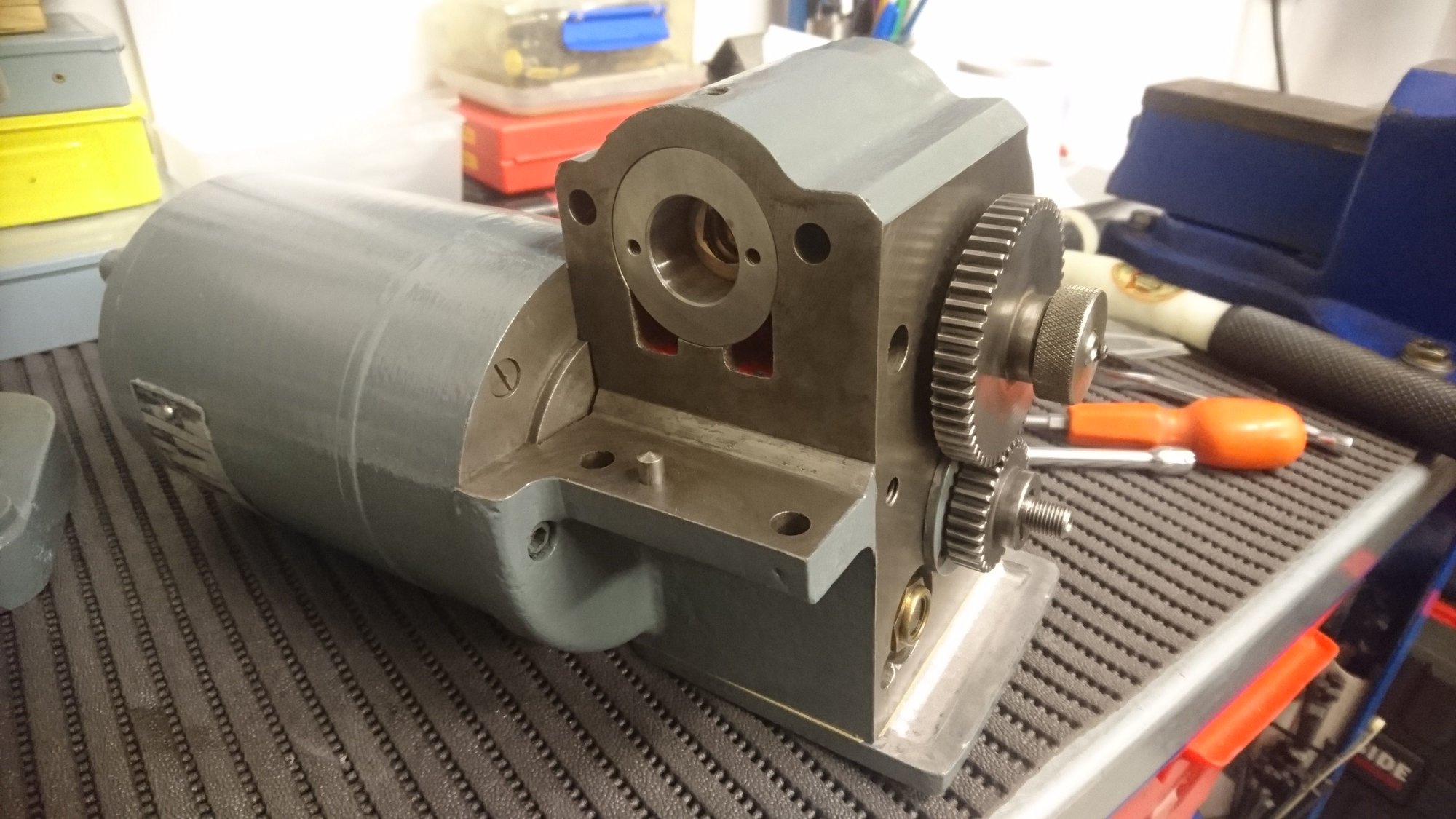

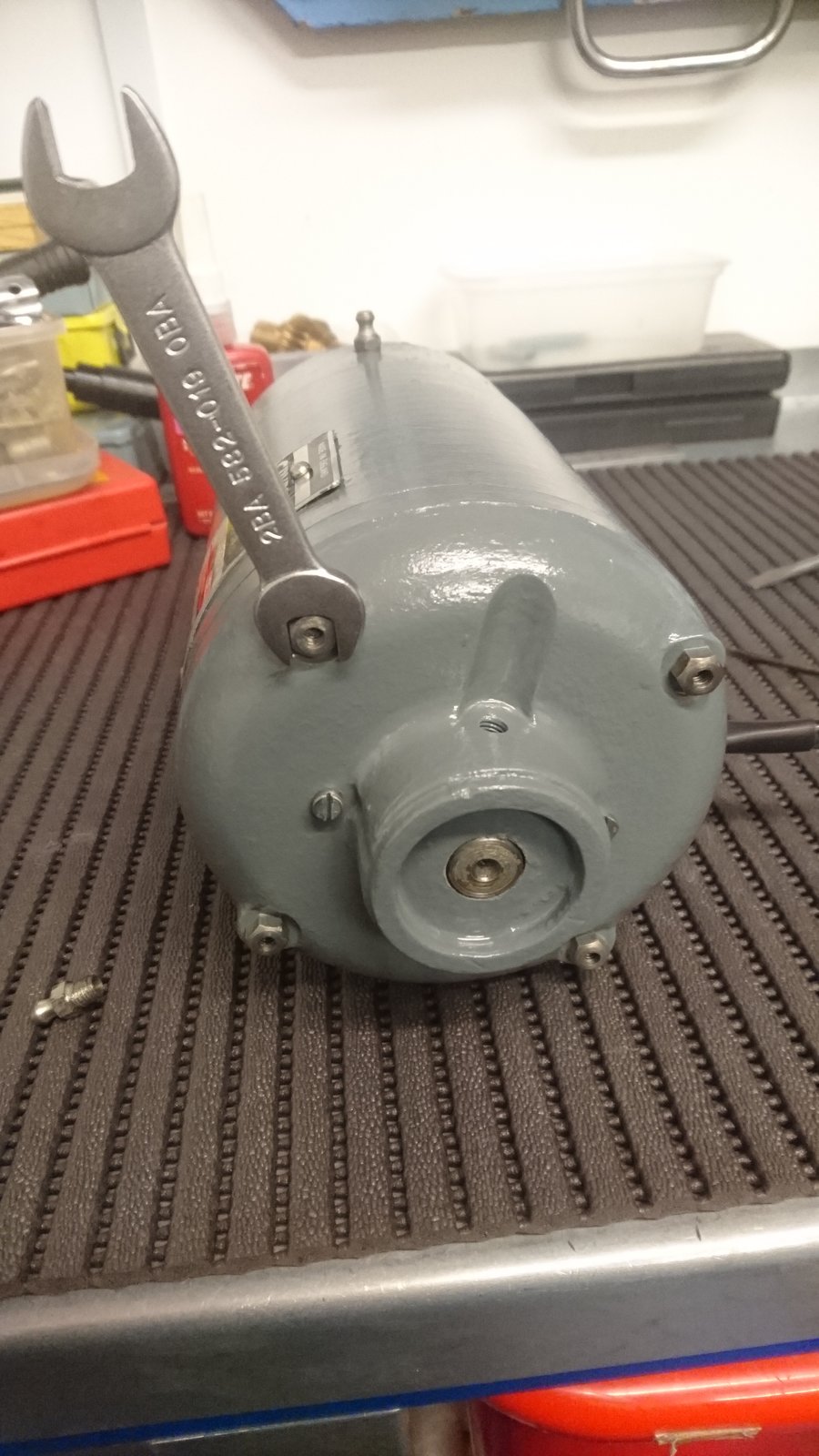

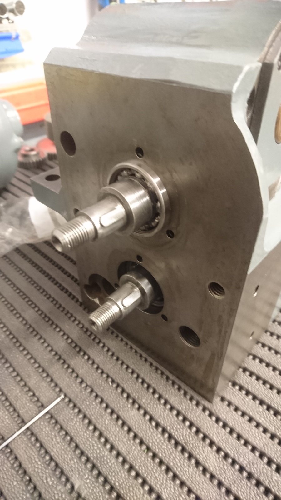

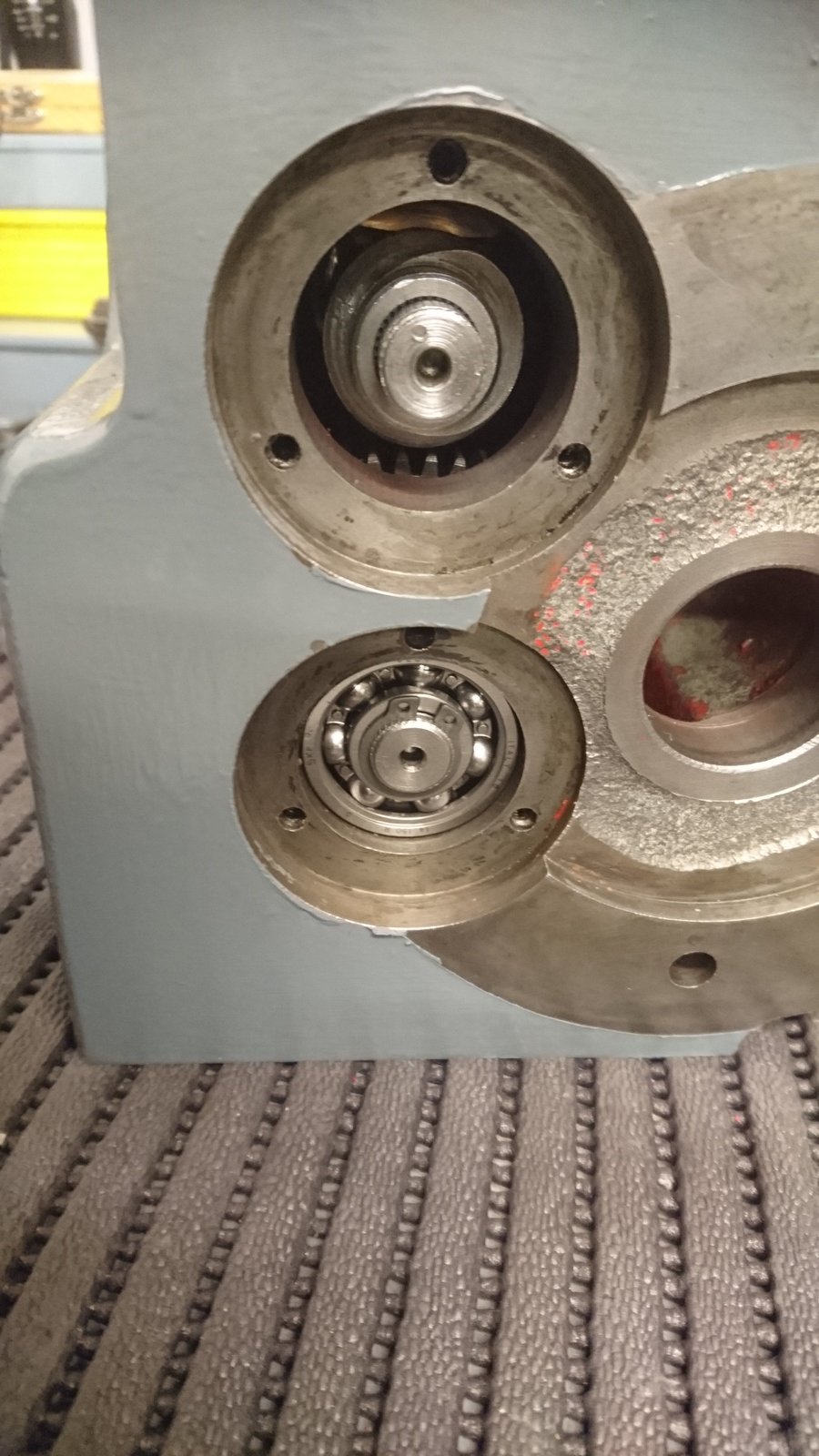

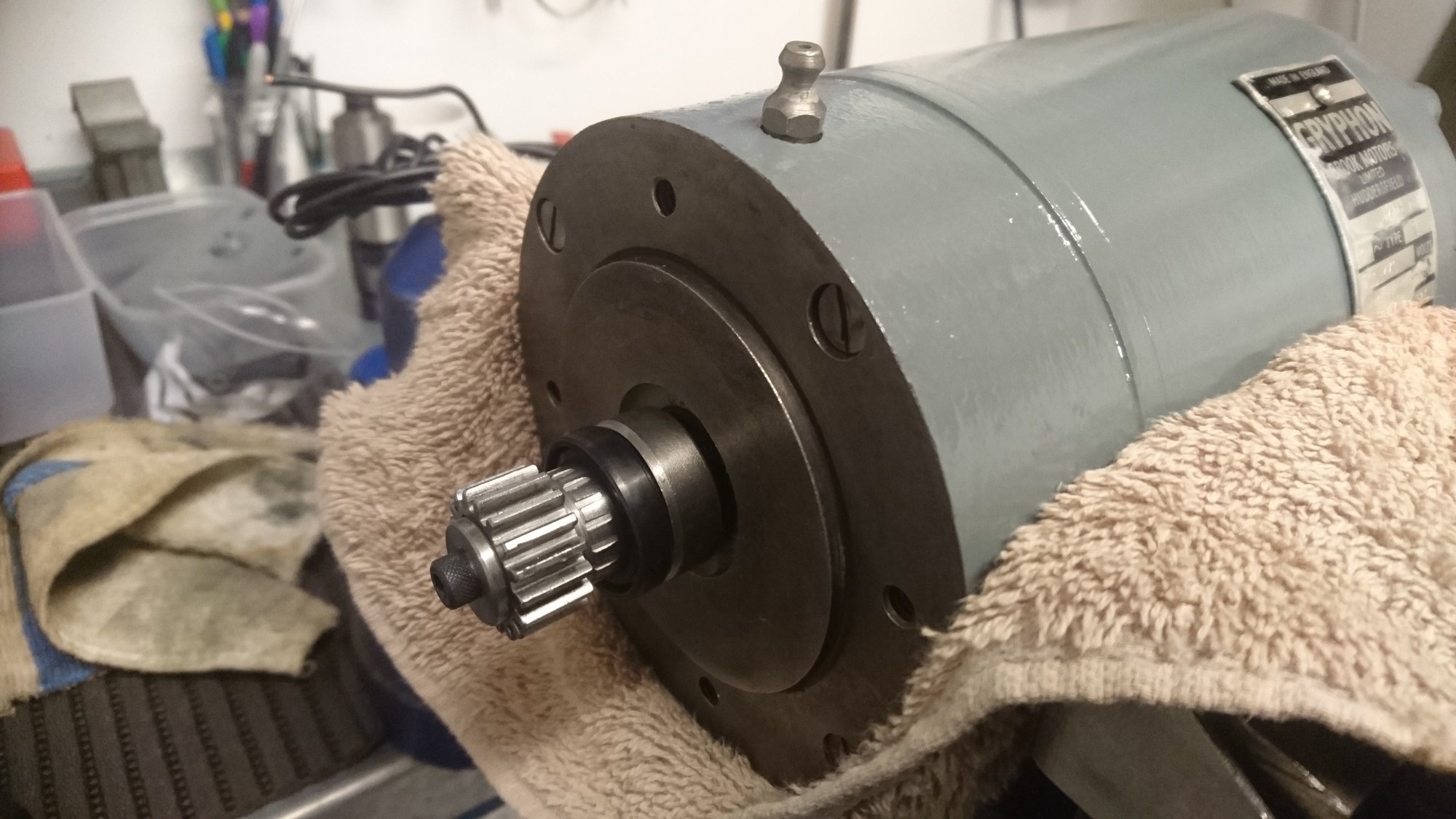

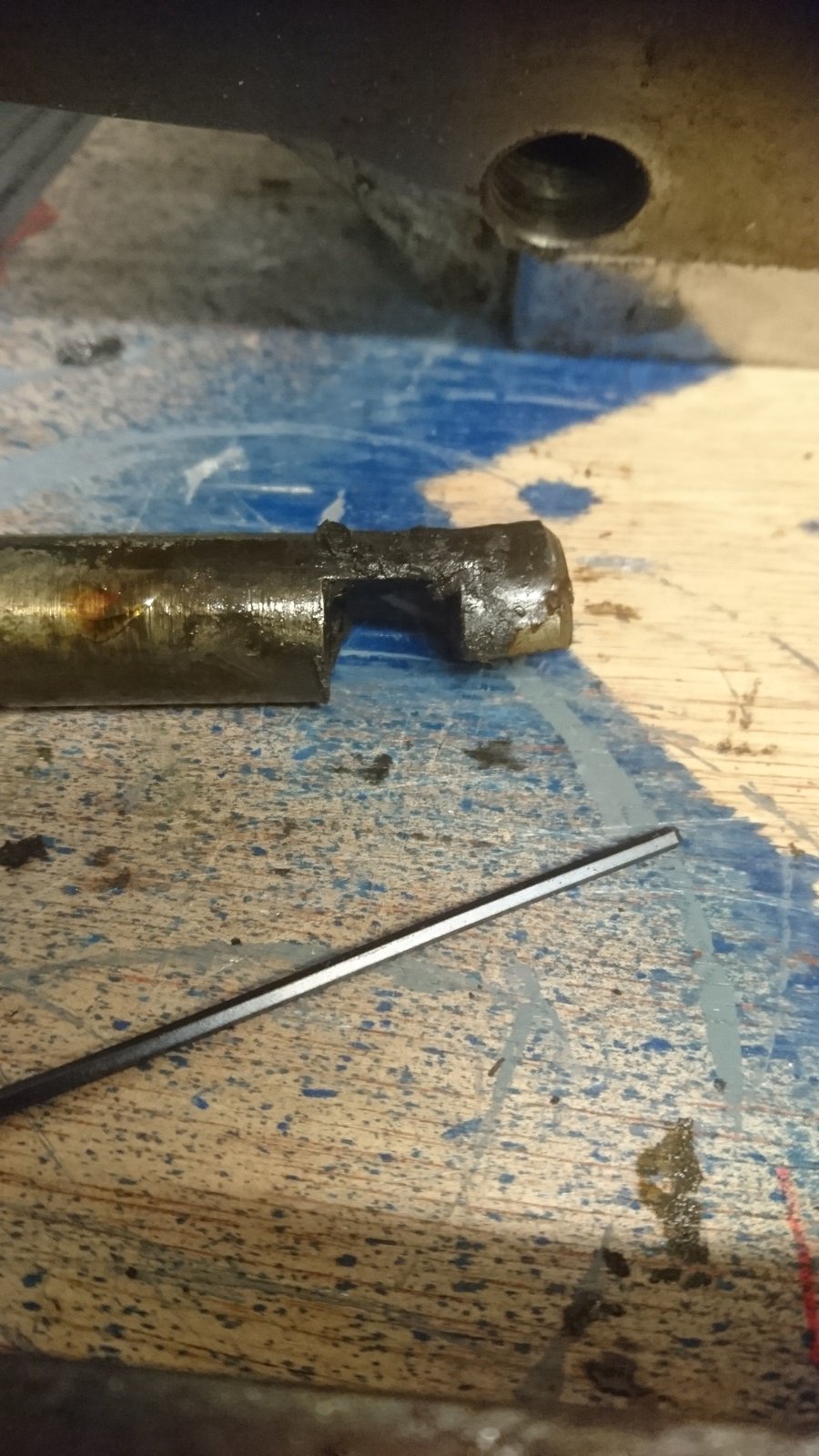

I have now completely reassembled the Gryphon motor apart from installing the front shaft seal.
I put a small amount of Loctite 222 on the 4BA screws that secure the rear bearing retainer.

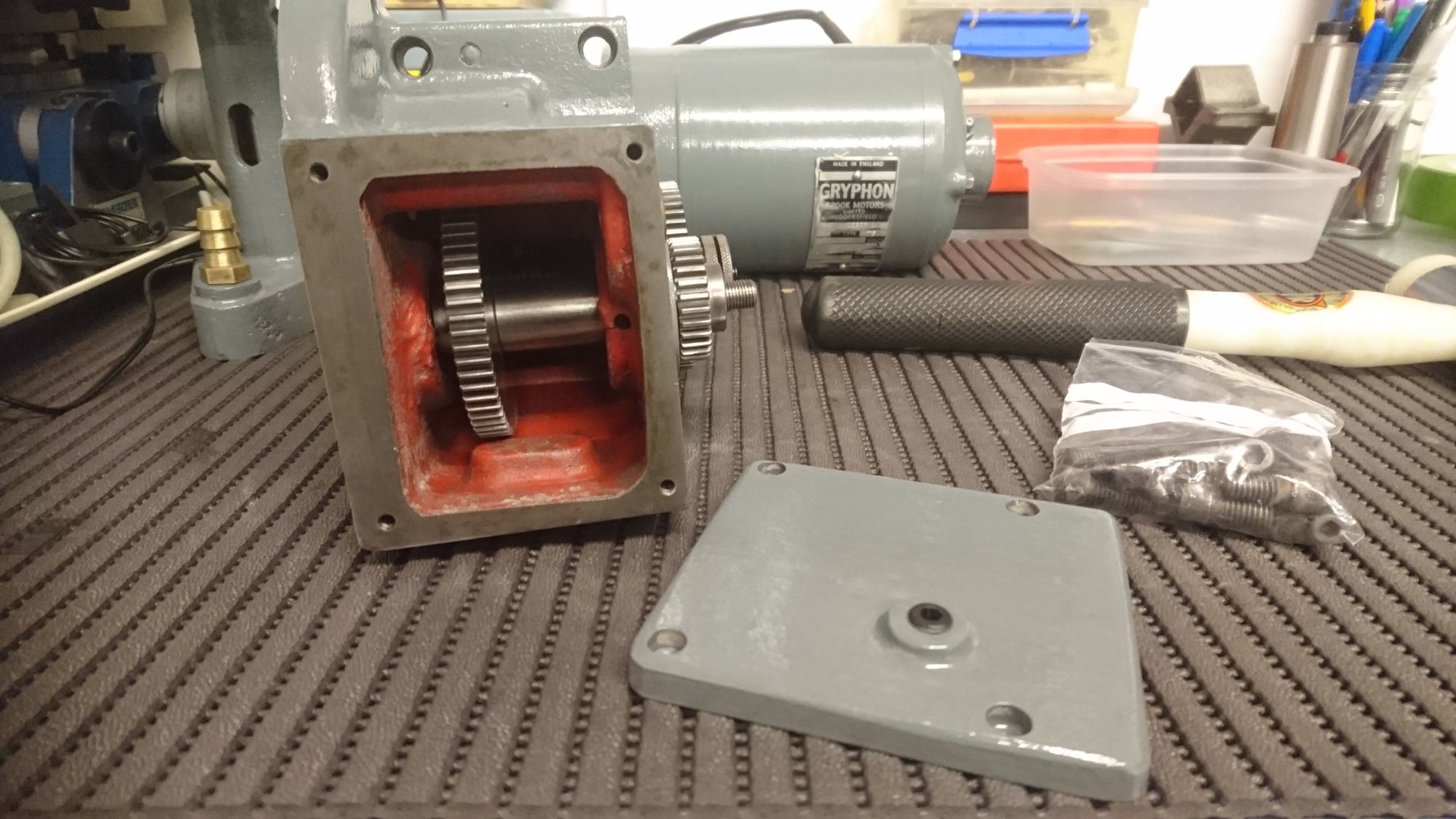

It should be fairly easy to pass the front seal over the shaft and into the recess shown here.
