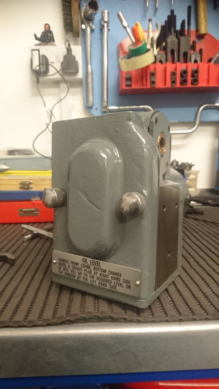

My original plan was a hollow draw bar but as the INT30 on the harrison is only M12 it wasnt an attractive proposition, hence the Schaublin style one. With an M16 drawbar I'd go the hollow bar bar route.

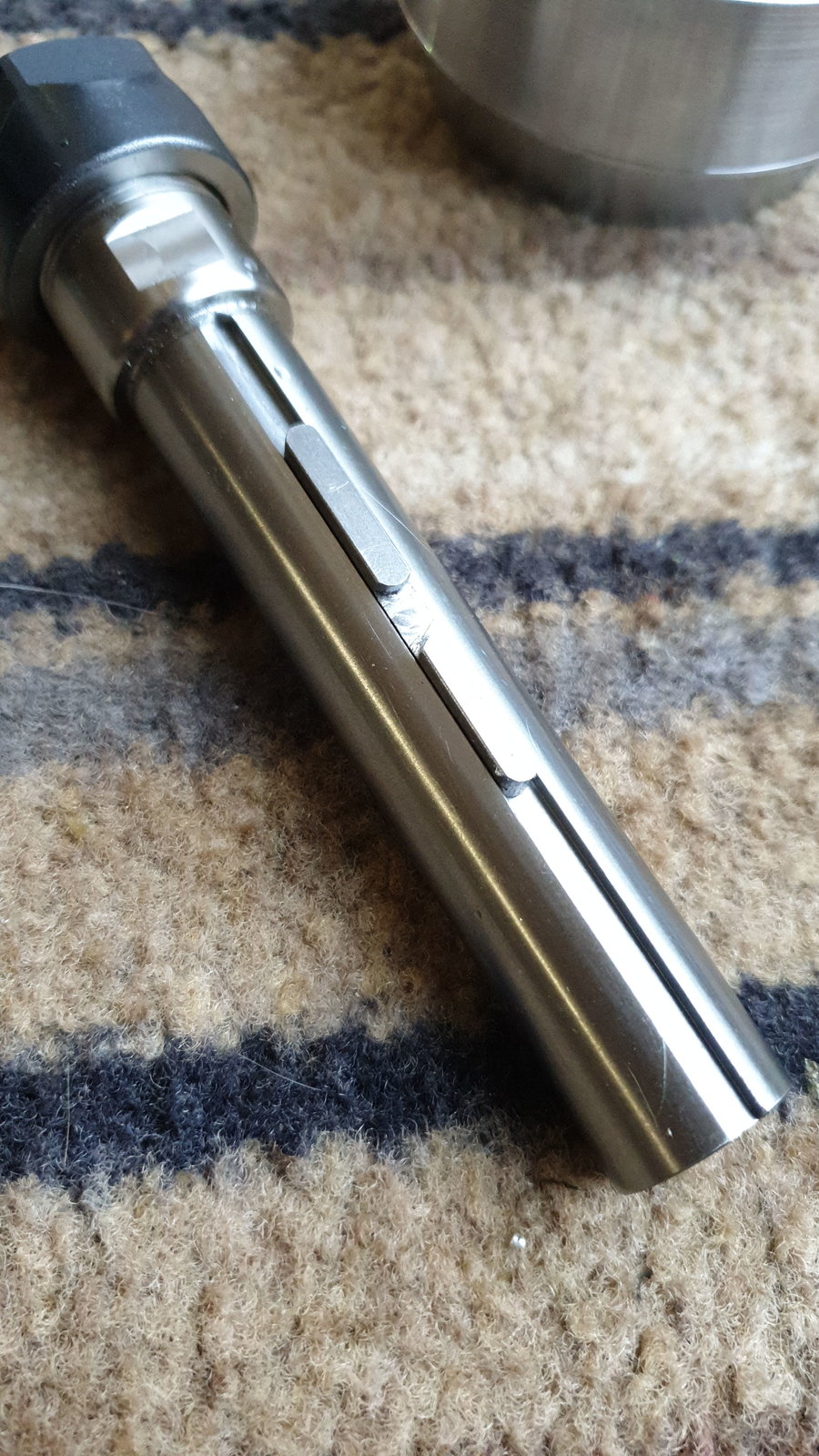

Yes I milled a 4mm keyway the full length of the straight shank and there's a corresponding one In the sleeve of the face plate
I still need to shorten the straight shank by an inch as there isnt enough height in the INT30 taper to accept it as is
