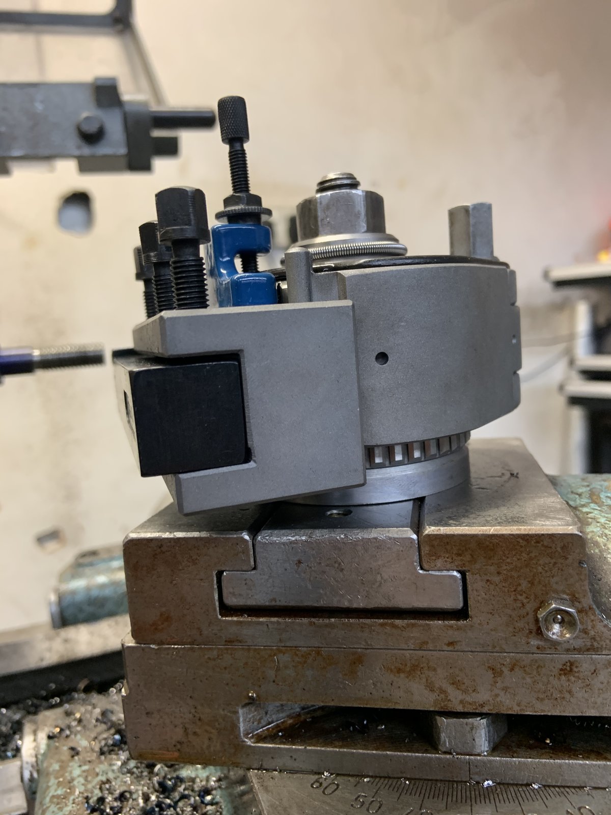

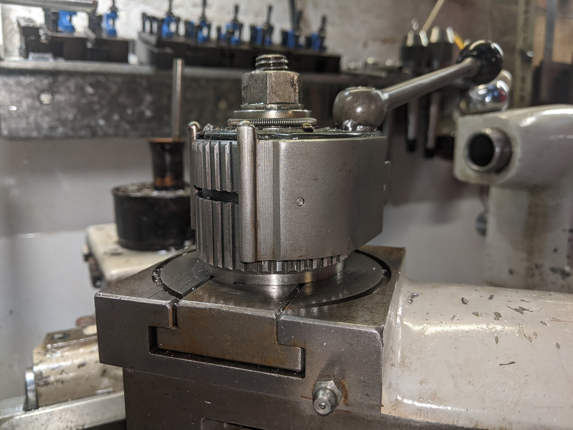

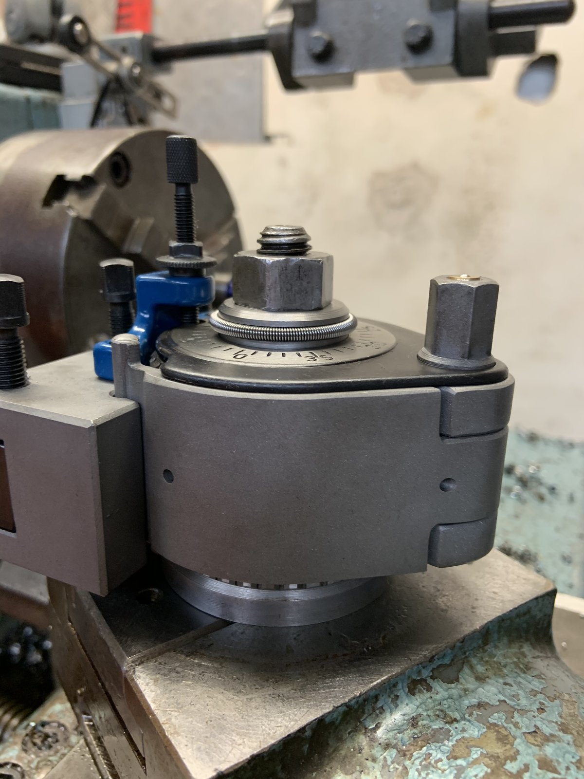

I’m sure the A is rigid enough, even on a riser block for your machine, and mine. Good luck.

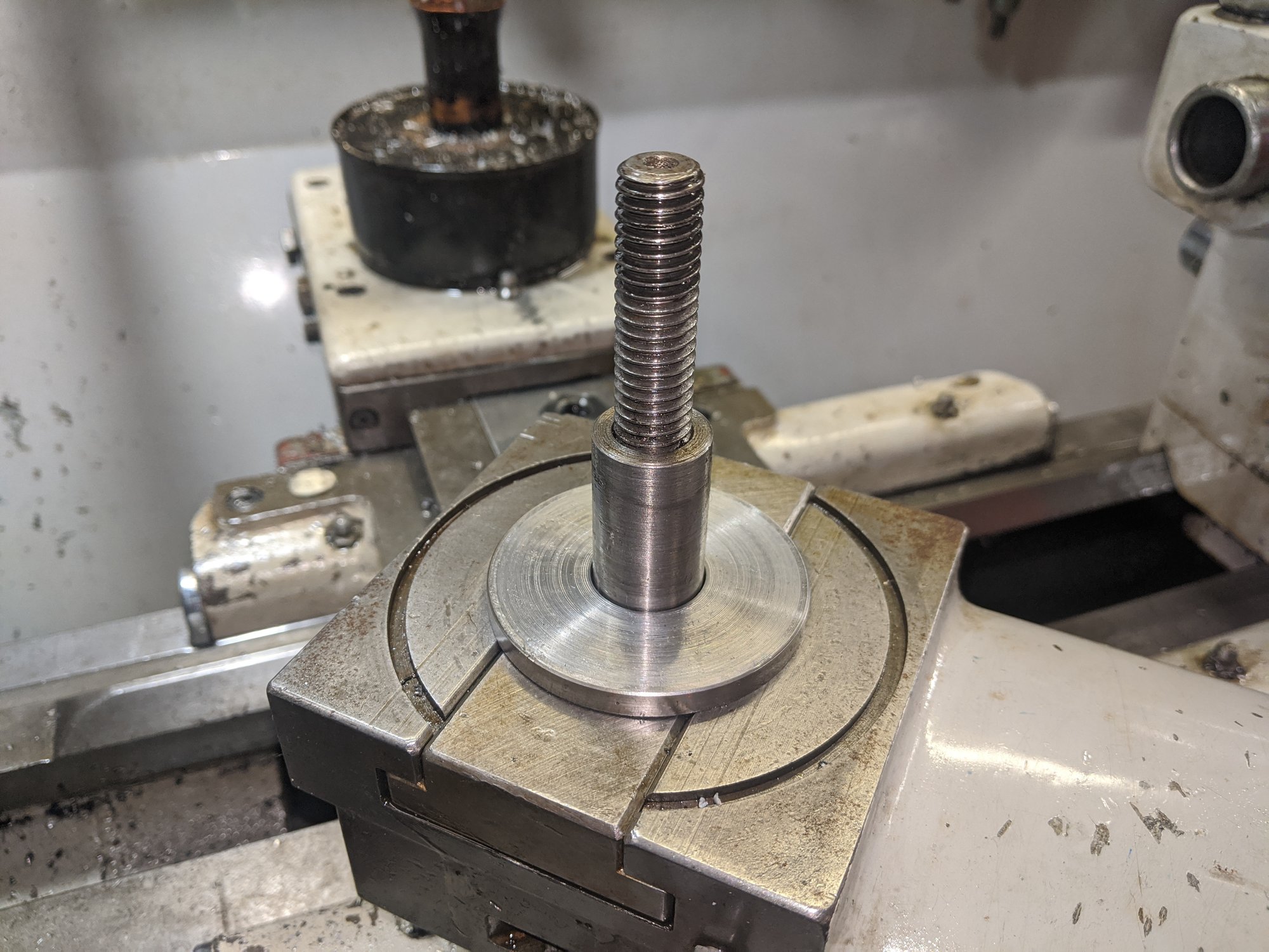

Nowt wrong with thatHere you are, just a simple riser and a centre bush, riser is 5mm.
View attachment 232759 View attachment 232760

I’ve basically done what you’ve got here today to get me by with my existing t-piece and imperial stud.Here you are, just a simple riser and a centre bush, riser is 5mm.
Should be i machined it flat on the lathe. I’ll blue it up tomorrow see if I’m getting good contact.@Brad93
Nope just the plain nut that was on it originally. With its chewed up corners and all.
Are you making good contact with the riser? If it's rocking slightly that might cause it to loosen.
