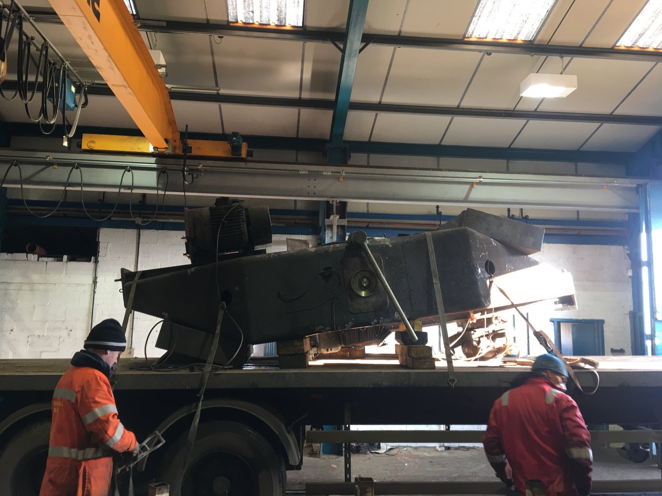

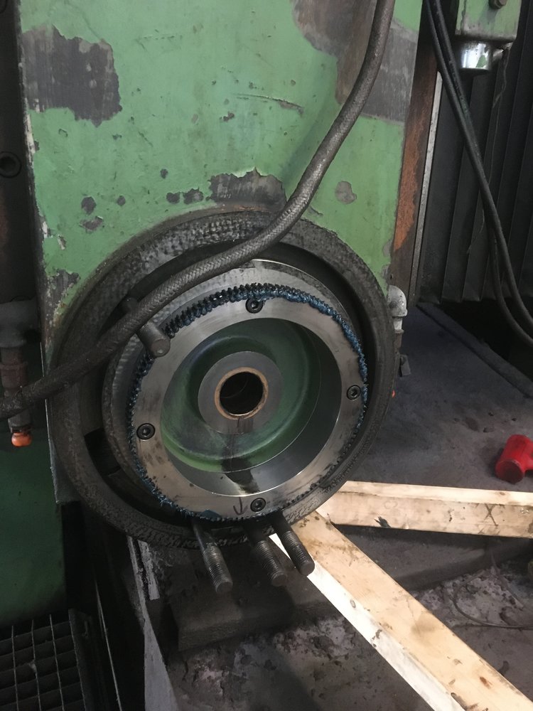

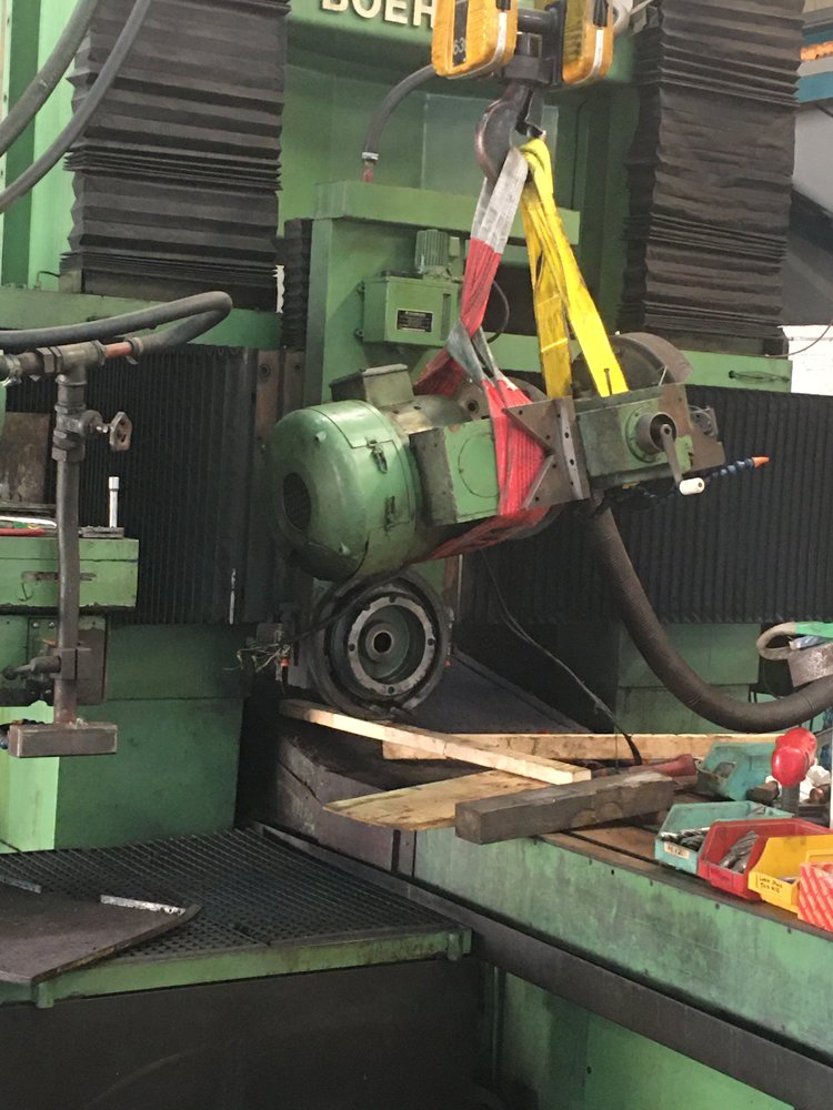

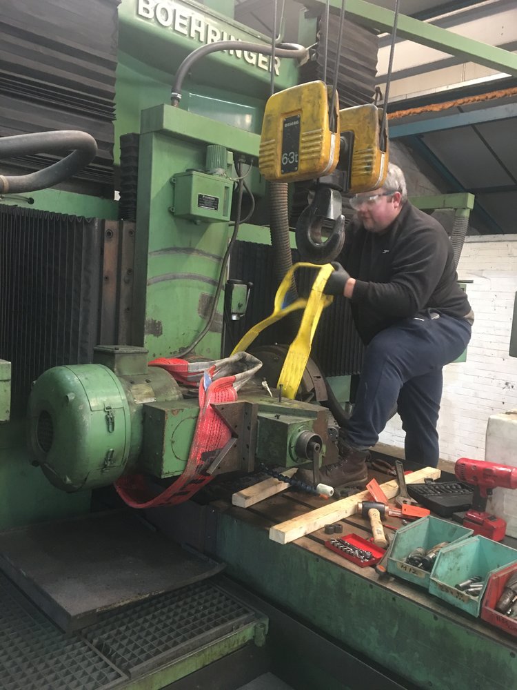

Calling @8ob with his HIAB lorry...From the limited look around the machine and studying the photos i think we have to start by pulling the electrics out, so control console removed, separate control cabinet disconnected, labelling as we go, then remove all the way covers/concertina bellows, support the grinding heads with slings, unwire them, drop them off, then remove/uncouple motors for the beam traverse and raise, then supporting the beam either from above or more likely (without the crane) below, remove or uncouple the leadscrews.
The problem is we don't have a big van to move any serious amount of kit or bulky items. It's all very short notice on the auctioneers part. A week to remove, auction finished on thursday.
