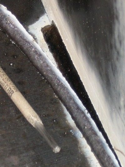

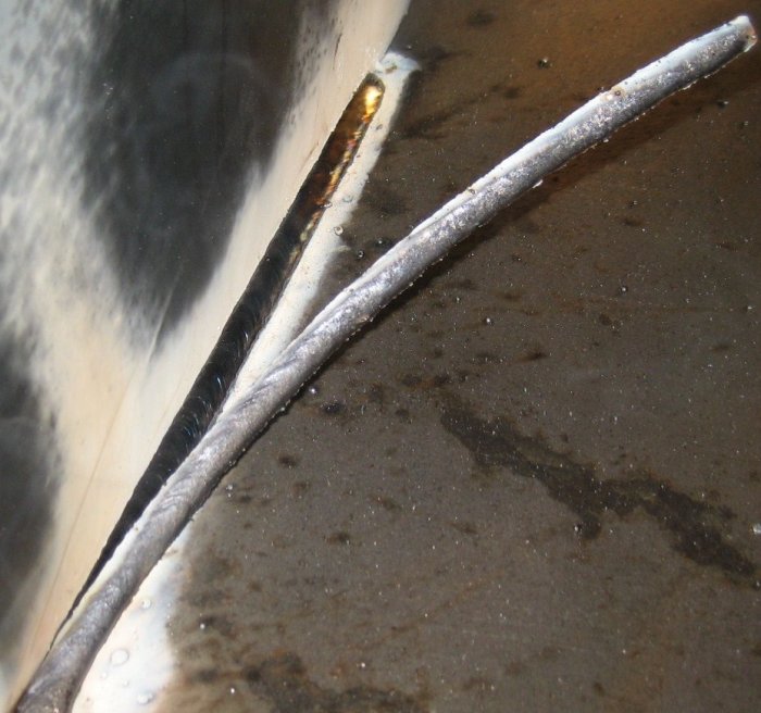

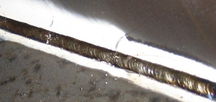

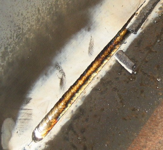

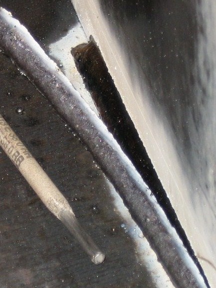

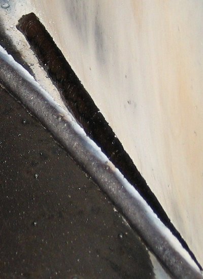

puddles those roots are realy coming together good,,flange what gap is on the picture with the bullets?and how you getting on with 7018s...im doing a lot of work tig rooting and fill,cap with 18s at the minute so il try post some pics.
fnc
i havn,t caught much from puddles lately but i know from other sites he has posted some great looking welds.good to hear you are keeping busy, things here have slowed down a bit. i explained to the lads here when i first visited i have always been, lets say vague around rods etc. if a low hi root has been required in the past i have welded with the rods supplied for the said job or test. now through reading these boards i have a better understanding of what i have used in the past, i know from the feel that i have welded with 7018 before, on various jobs.while im at it , anyone familiar with philips kv5 is it 7018? just like busa i find 7016 a better option on roots and funny enough ,the one i have most experience with is filarc, i think i posted a pic before. as mentioned the thicker flux gives you the impression your not getting far enough into the root face with 7018 it takes a bit of getting used to
. that gap on the bullets was 4mm jay, would you let the guy who tacked it near the rootface

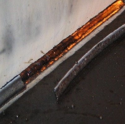

. get those pics up. f/j

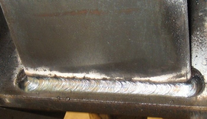

heres some flat plate work from recently, 4mm 150 amps. f/j
