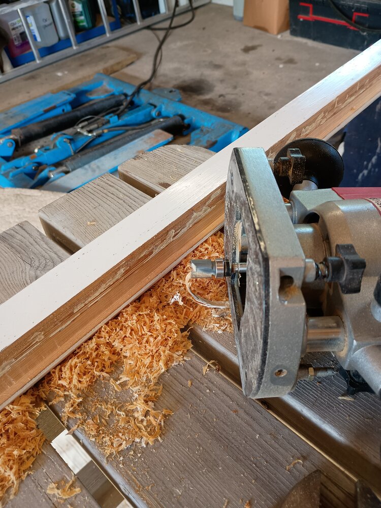

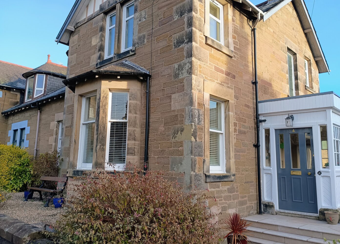

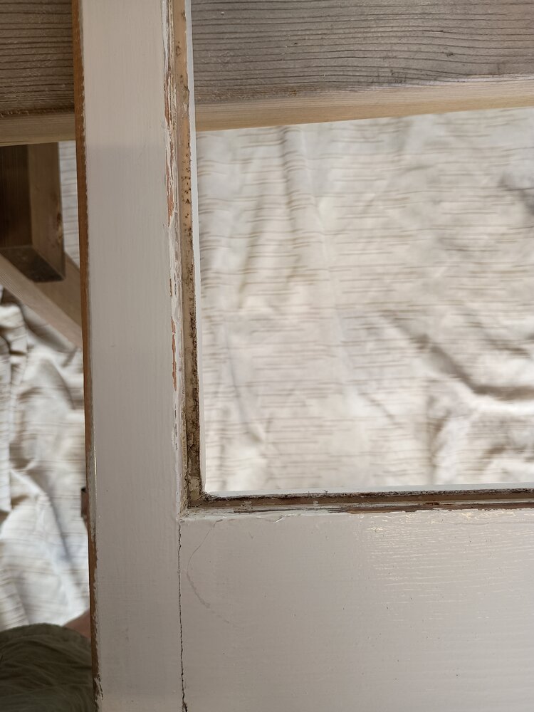

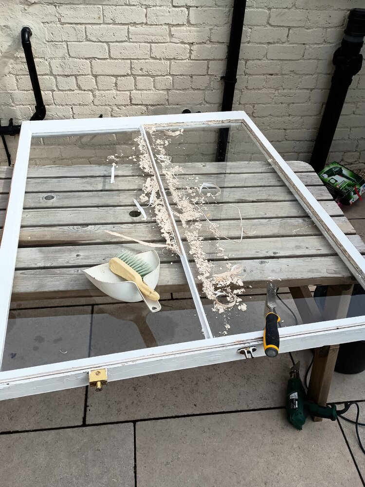

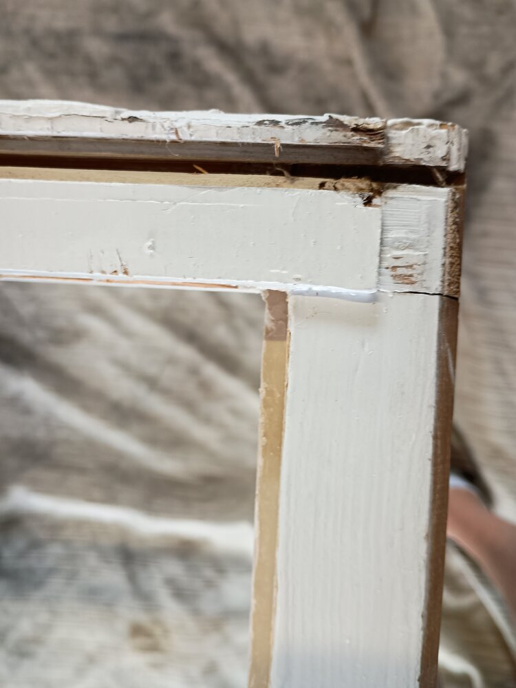

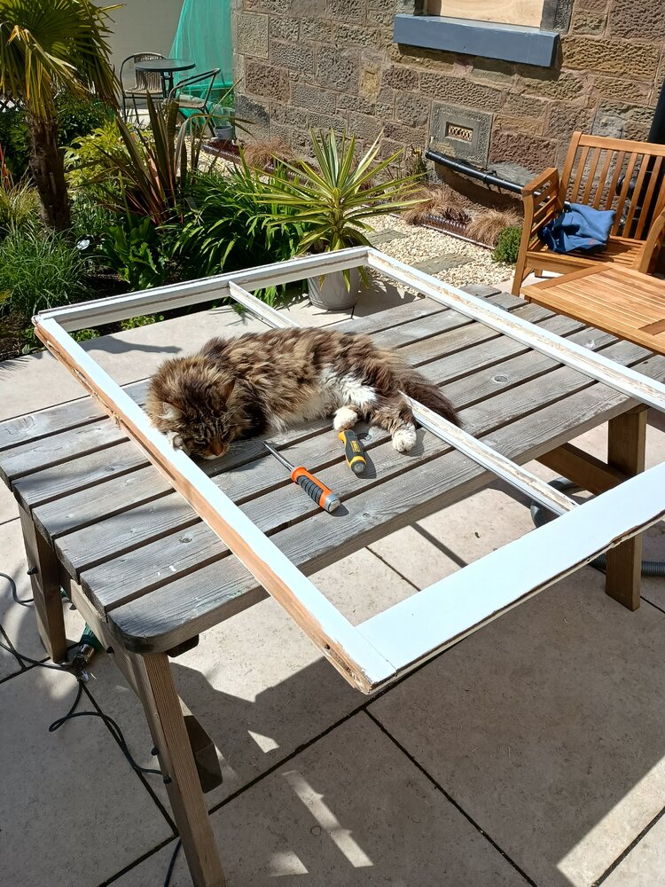

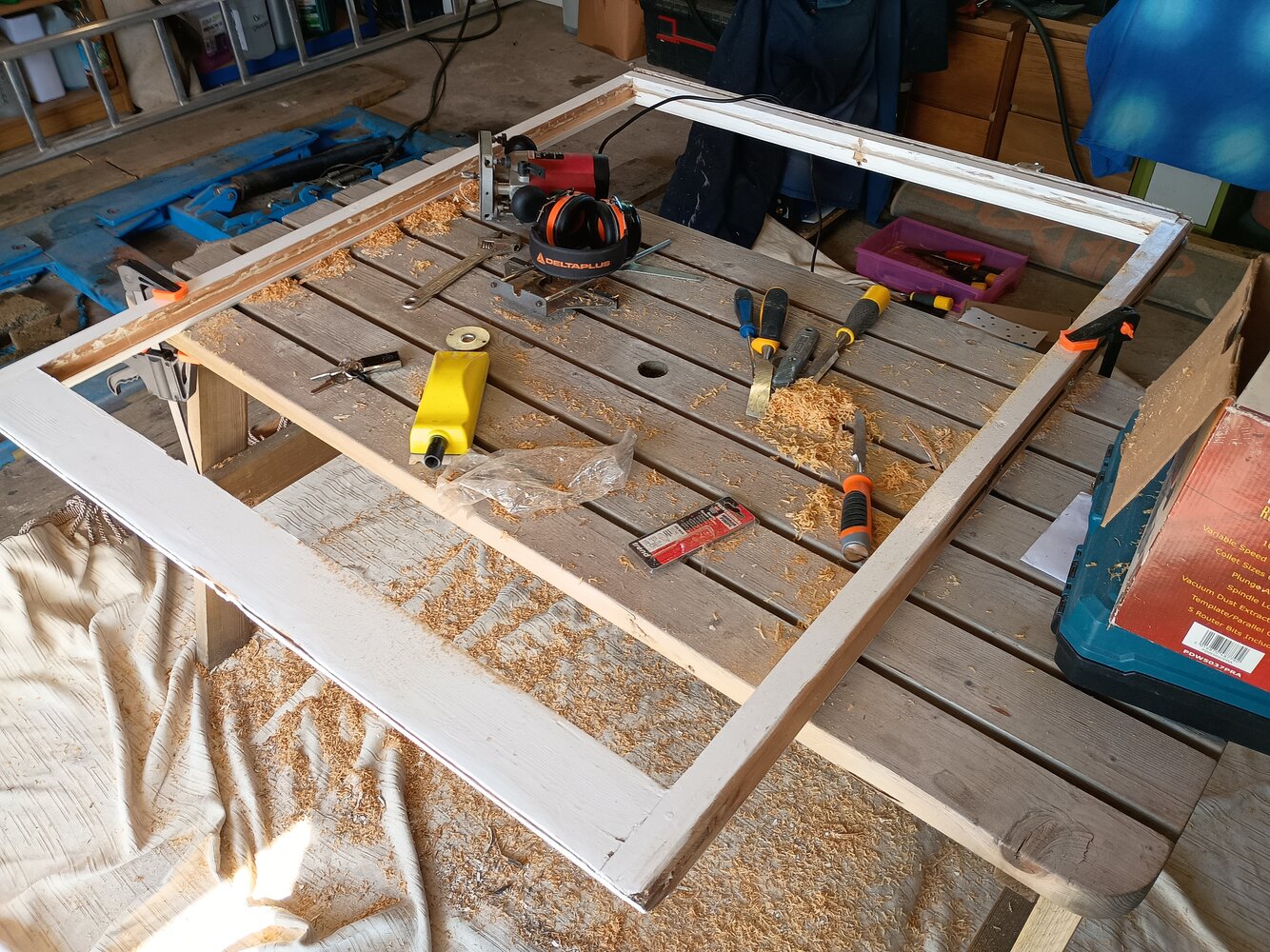

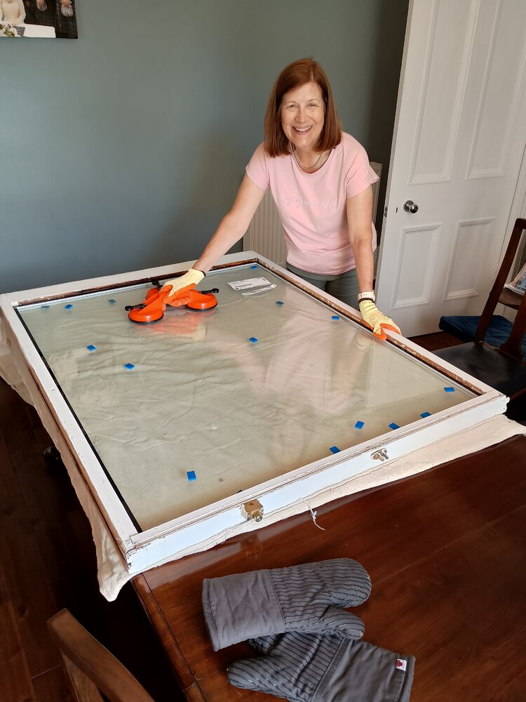

Here we go, I've ordered two sealed units to try out on the first window. There are 8 in total on the ground floor to renovate and convert. The last person to paint the windows was an imbecile, over painted right on to the stone work so that needs sorting out and repointing too. On top of that the draught proofing also needs fixing as it's also been over painted. So once again I'm starting on a project without a clue, no change there. I expect the first one will be a learning experience.
First I raked out the old pointing and stripped the paint off the frame and wall.
Painted.
Pointed
Painted.
Pointed
