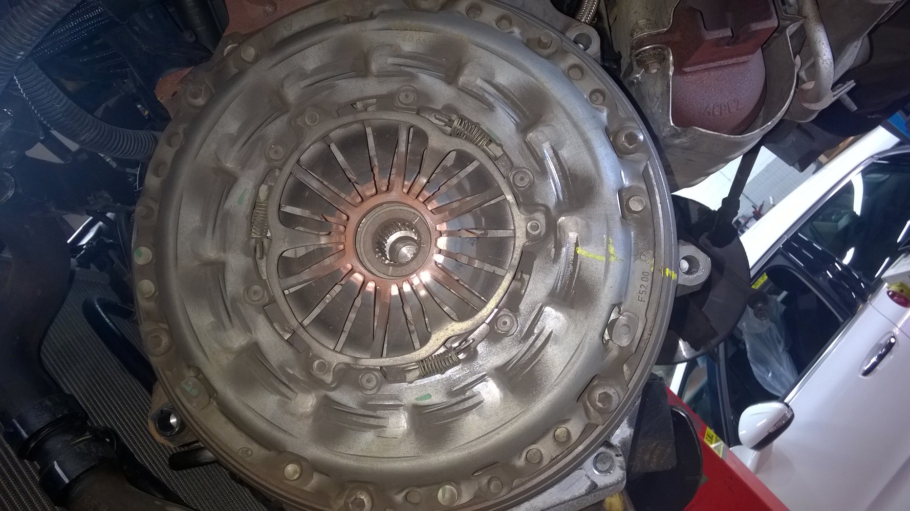

Not judder but we had similar on Mrs79’s motocross bike front brake. She had put braided stainless hose on, same bore, braid supposed to restrict expansion so better braking etc etc.wasnt sure wether to post or not
i went to the car earlier in the week to move it into a place i can strip it , hyd clutch pedal was on the floor , i swapped a spare hose over that i had and rebled it , tried it again , id say the judder is half or better , almost at a level where you could believe a bit of use might settle it
so i havent stripped it further , ive ordered a new hyd line and will see how it feels with that
not really sure how /why that exaggerated the judder
yeah i used to want all that on the cars , then had a braided brake line burst on the mot rolllers , when you think about braided ones look great until the day they fail , at least you can spot a perished rubber one and maybe it will bulge before failing , i wont run em nowNot judder but we had similar on Mrs79’s motocross bike front brake. She had put braided stainless hose on, same bore, braid supposed to restrict expansion so better braking etc etc.
Could not get a decent brake on it.
Gave up. Refitted old KTM ones. Good as new. Still no idea why.
Posted because you’re not the only one!!
Inside the master cylinder dust cover or the slavebeen back to the car and the pedal has gone soggy again ...so must want some hyd parts too , nothing appears to be leaking though
Might be restricting flow back from the slave, so releasing the clutch slower than ideal?wasnt sure wether to post or not
yes this one did from new , struggled to get oem style ones over the years so its had braided , managed to get a oem style one, might be slightly bigger diameter , need to look at that todayDidn't some cars have a coiled hard line for tthe clutch hydraulics to reduce judder.
