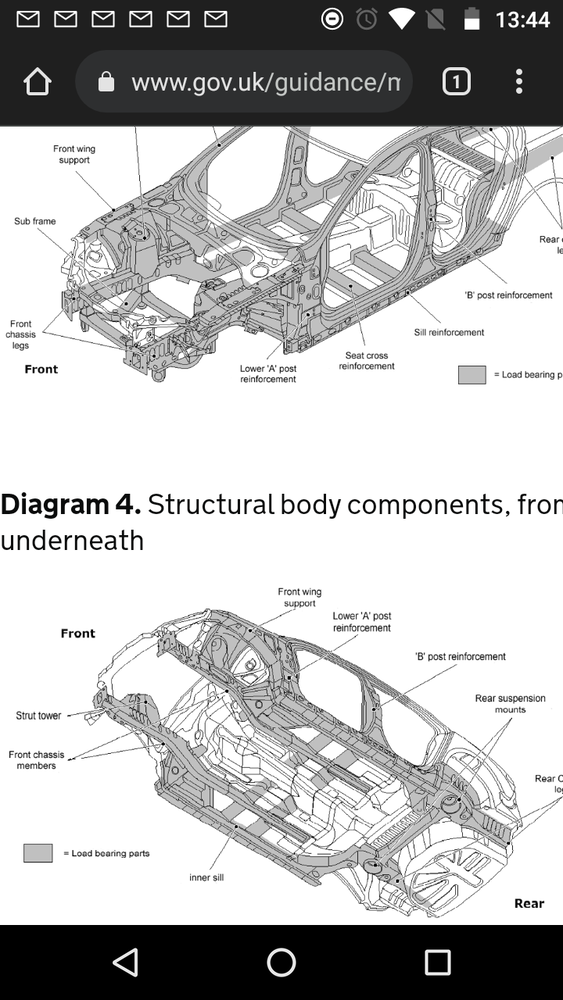

The thicker the steel is, the easier and more forgiving it is, BUT that is not the same as making a good structural weld.
