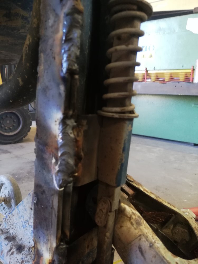

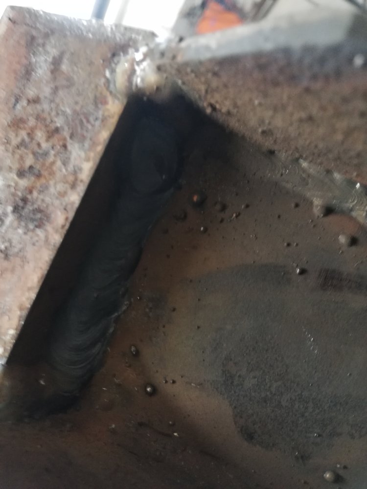

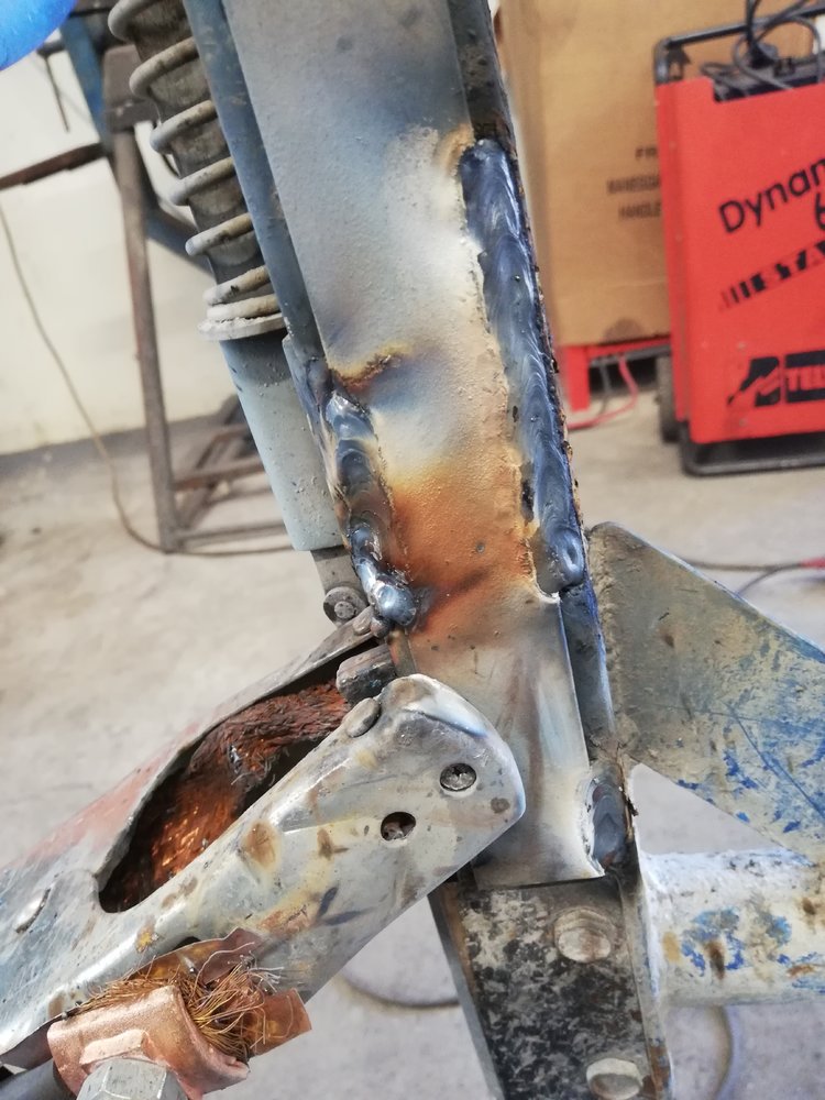

Burnt up , with no undercut , strange ripple patternAnd how's the Mig welding looking ?
Yes you are right it should be in either short circuit or spray transfer dependant upon material thickness and joint geometryBurnt up , with no undercut , strange ripple pattern
I believe because I was experimenting various things all together.
Like torch tip to work distance variations,torch angles ,travel speeds.
I believe it should Go in spray or short circuit

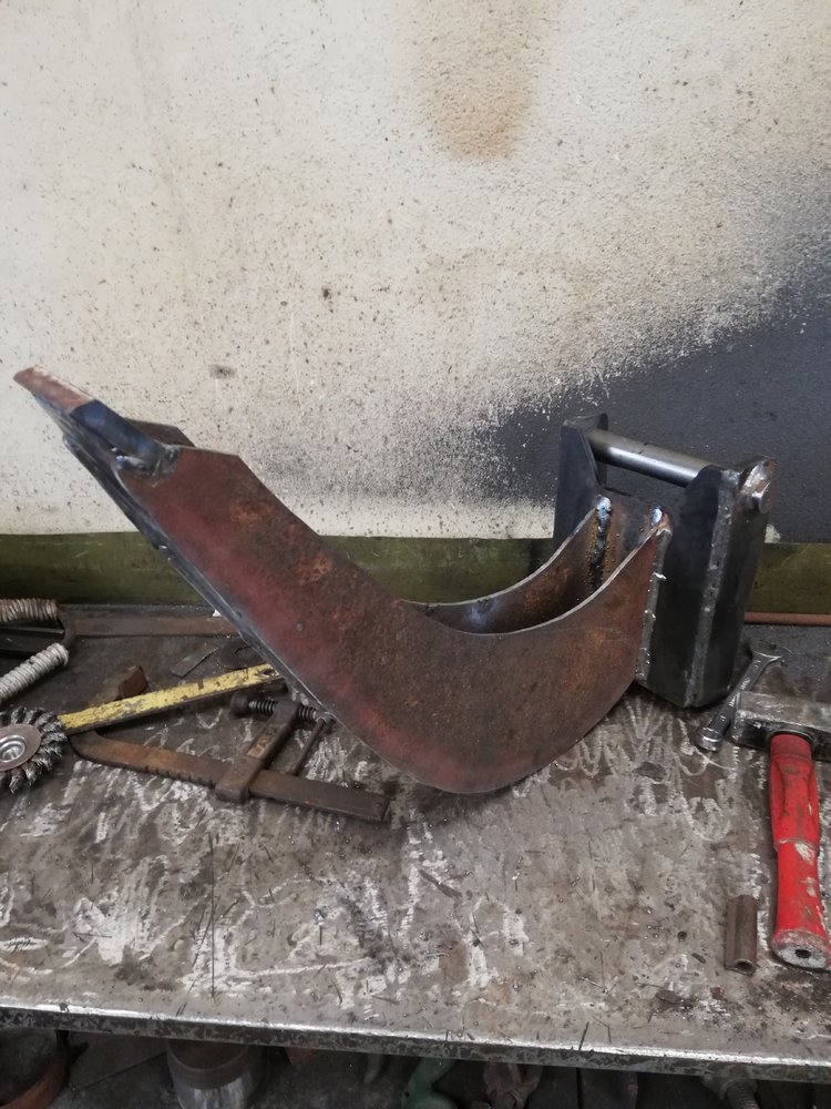

Yes - grind off all the paint and crap first. The rule on steel pretty much is: First you grind, then you weld.The bucket ones are horizontal fillet welds
The ones on the concrete mixer are vertical downhill on thin rusty painted covered in concrete and zinc steel
Any advice to make them better?
only use one handHand held welding shields are for mugs! That's the first thing you need to change.
MIG puts down so much metal so fast that you need both hands to keep the torch steady.
