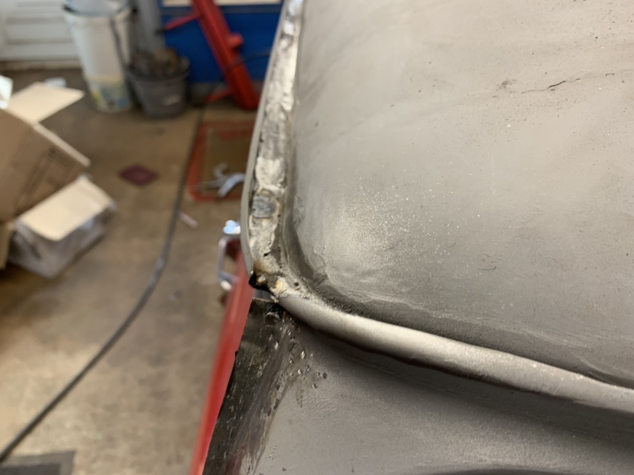

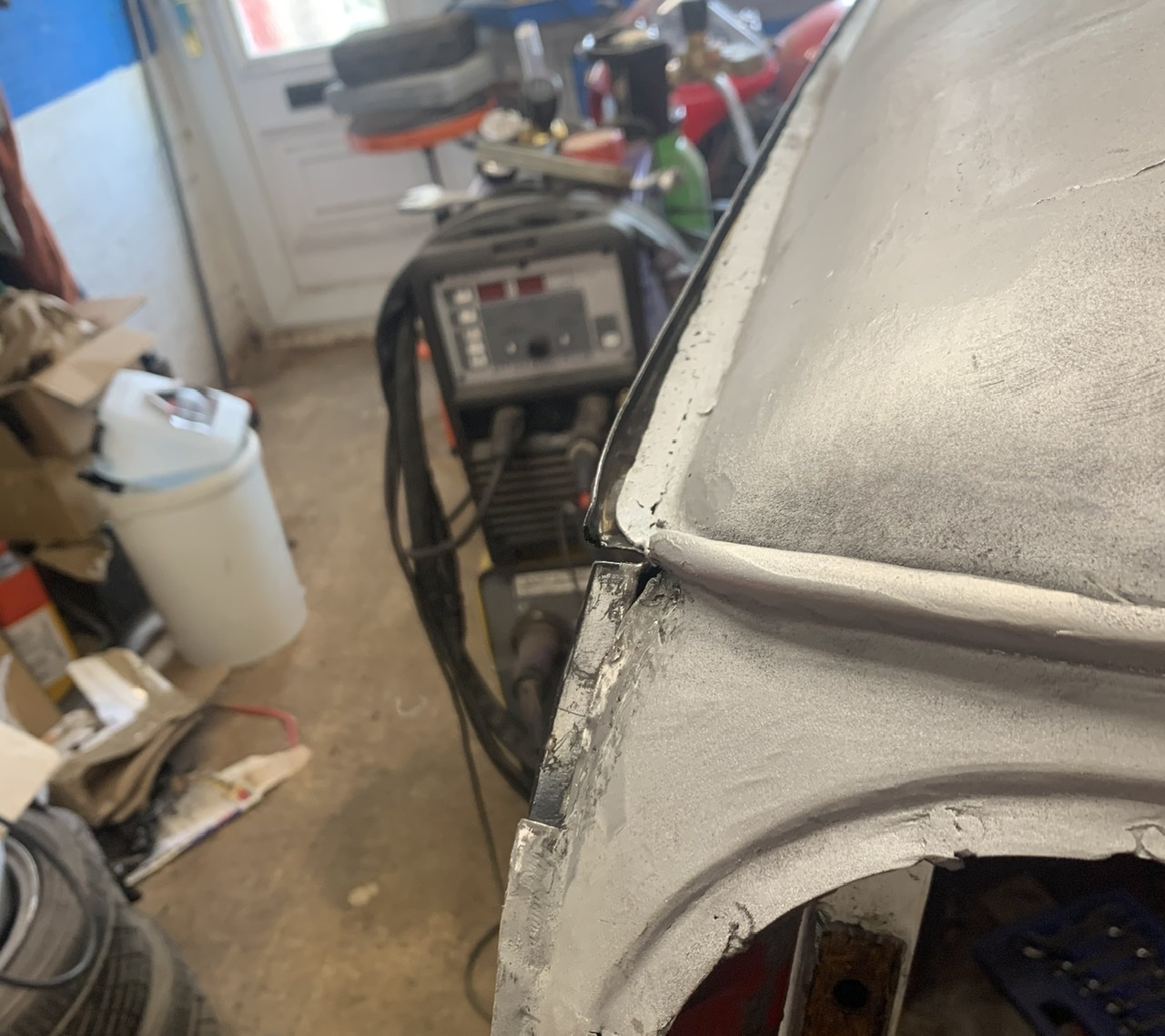

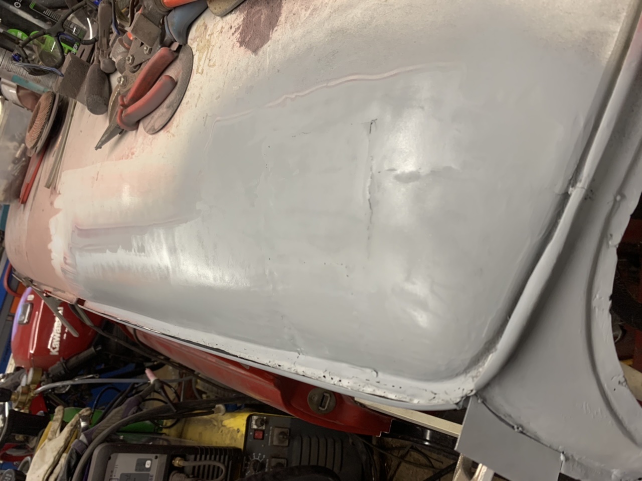

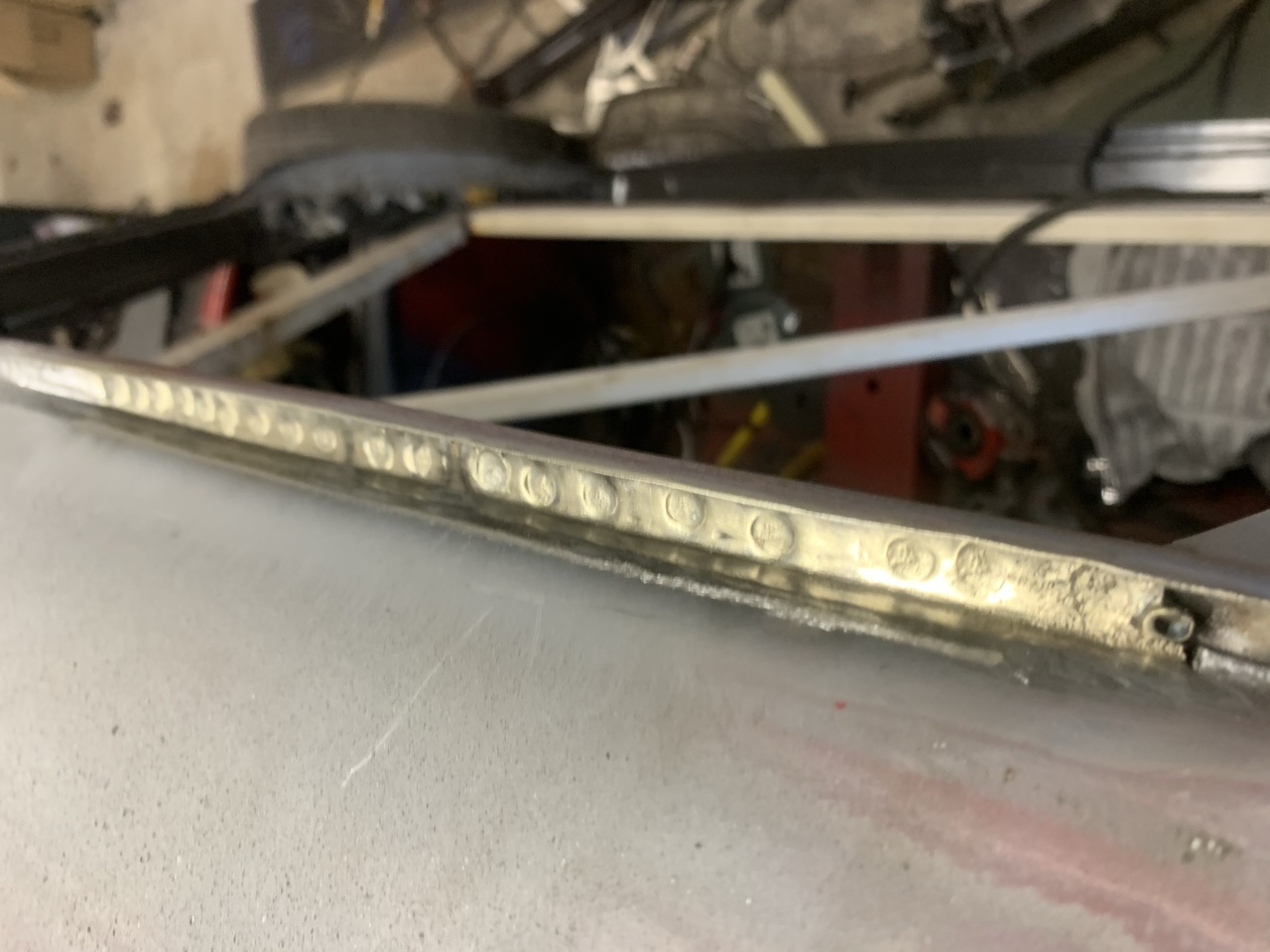

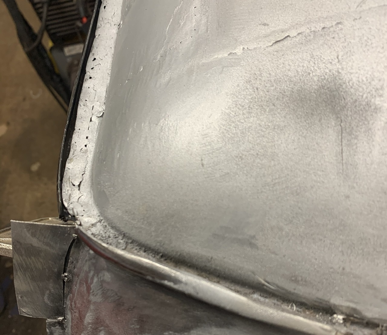

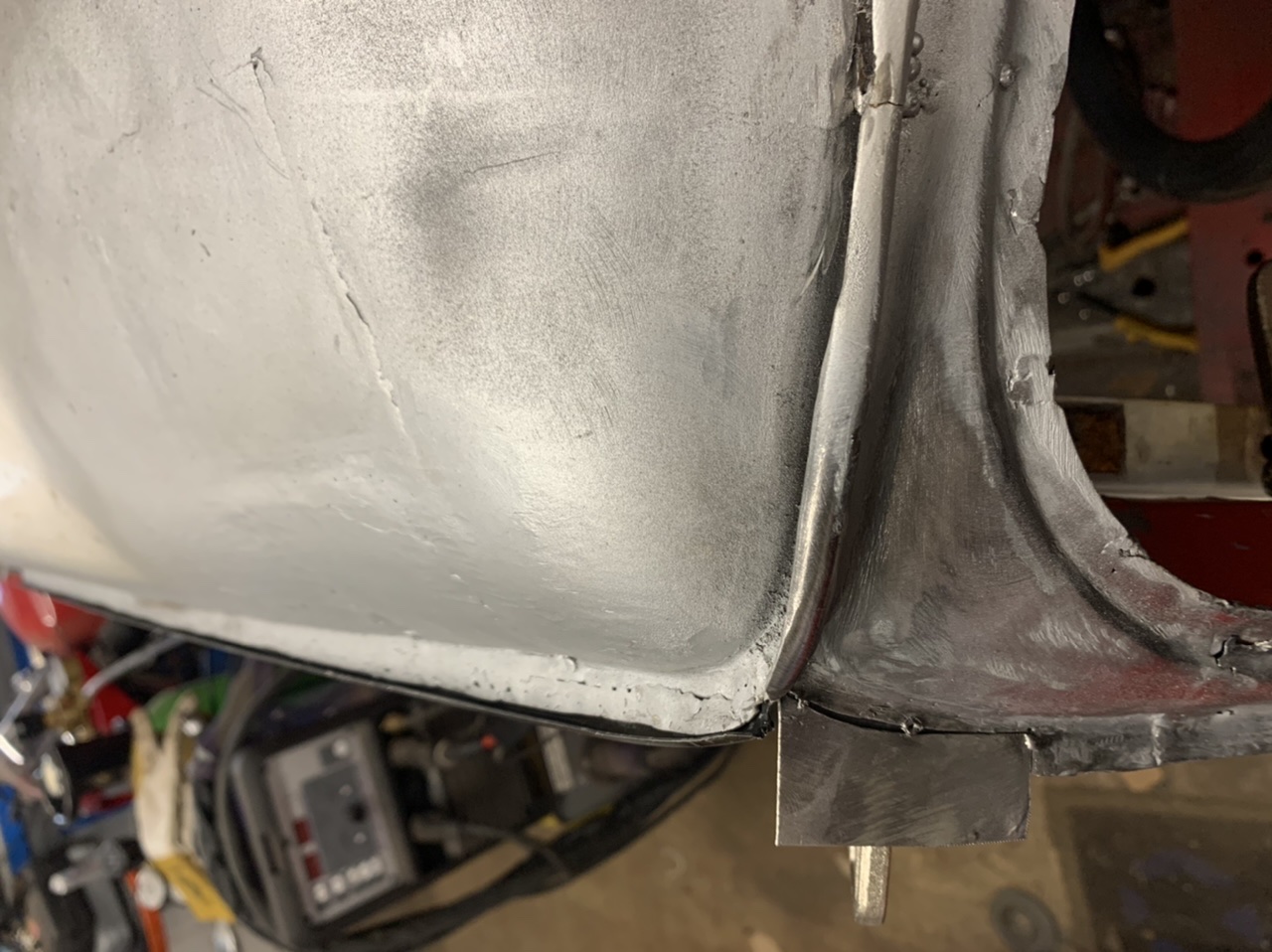

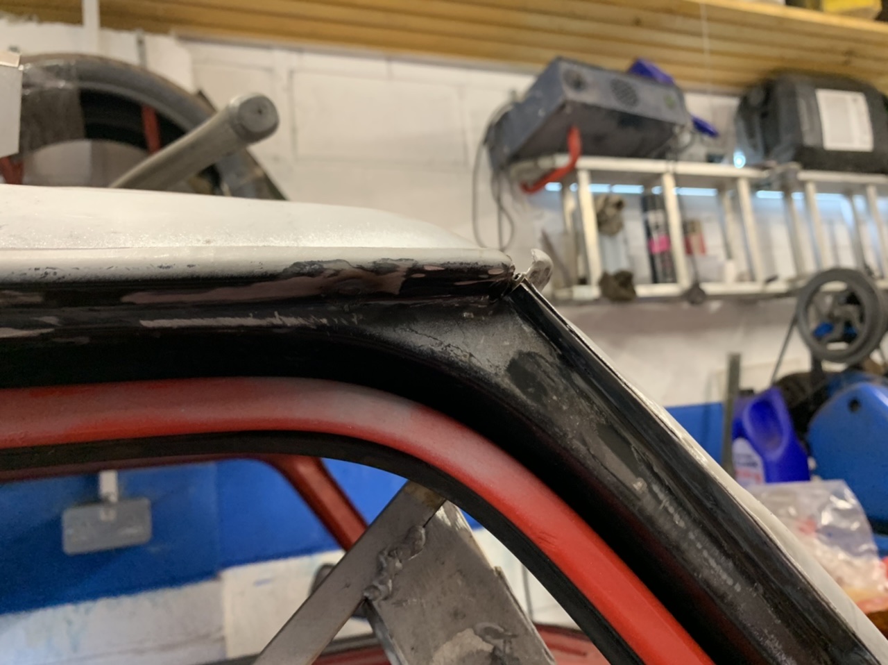

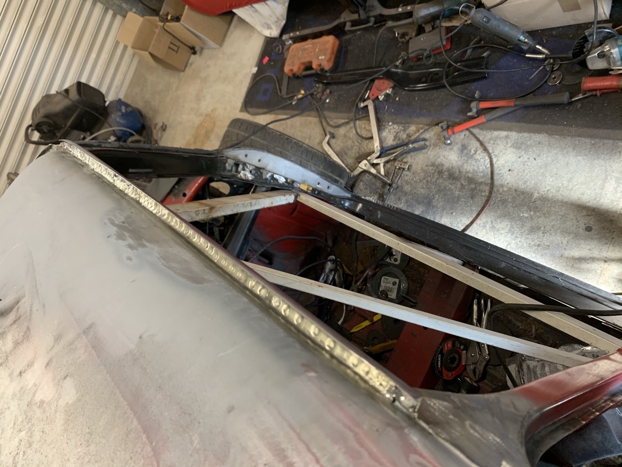

Looks like the shape of the roof repair is not quite right from the pic. It seems to come in a little rather than a smooth curve.
It's one of the reasons why I don't replace bits of the roof skin as filler work will be a nightmare once the gutter is in place. I would normally replace the whole skin.
