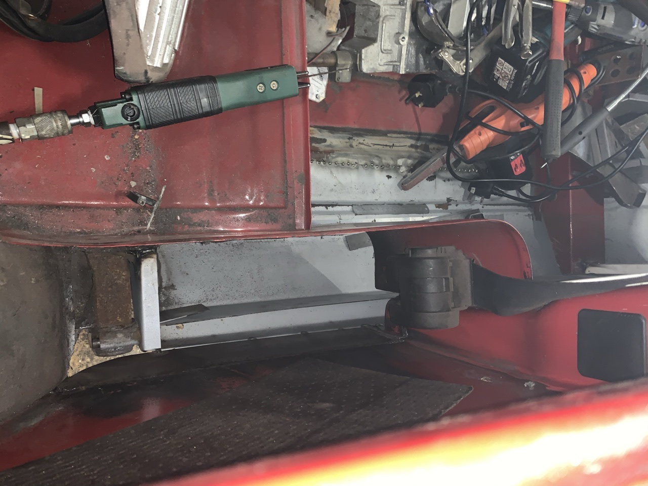

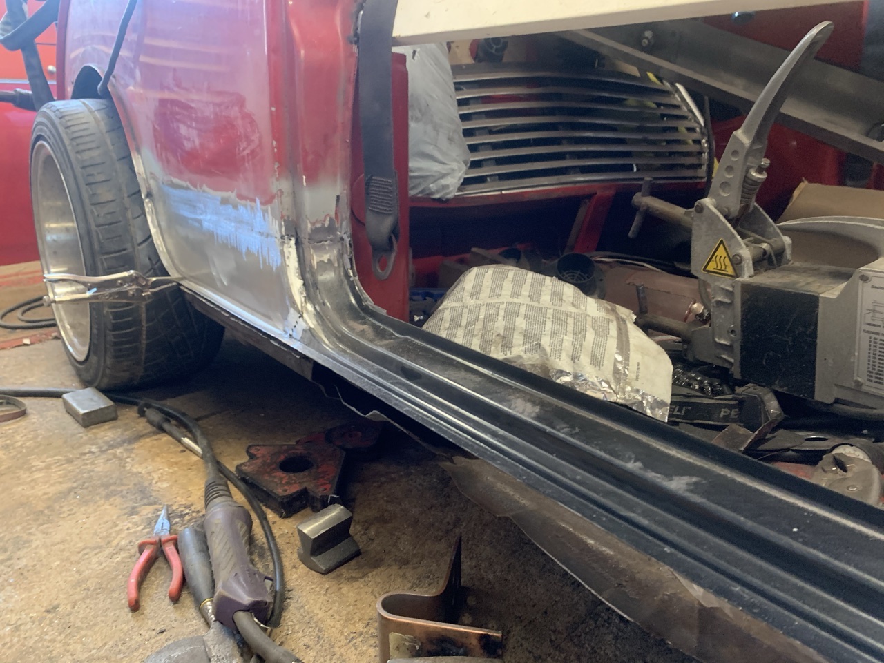

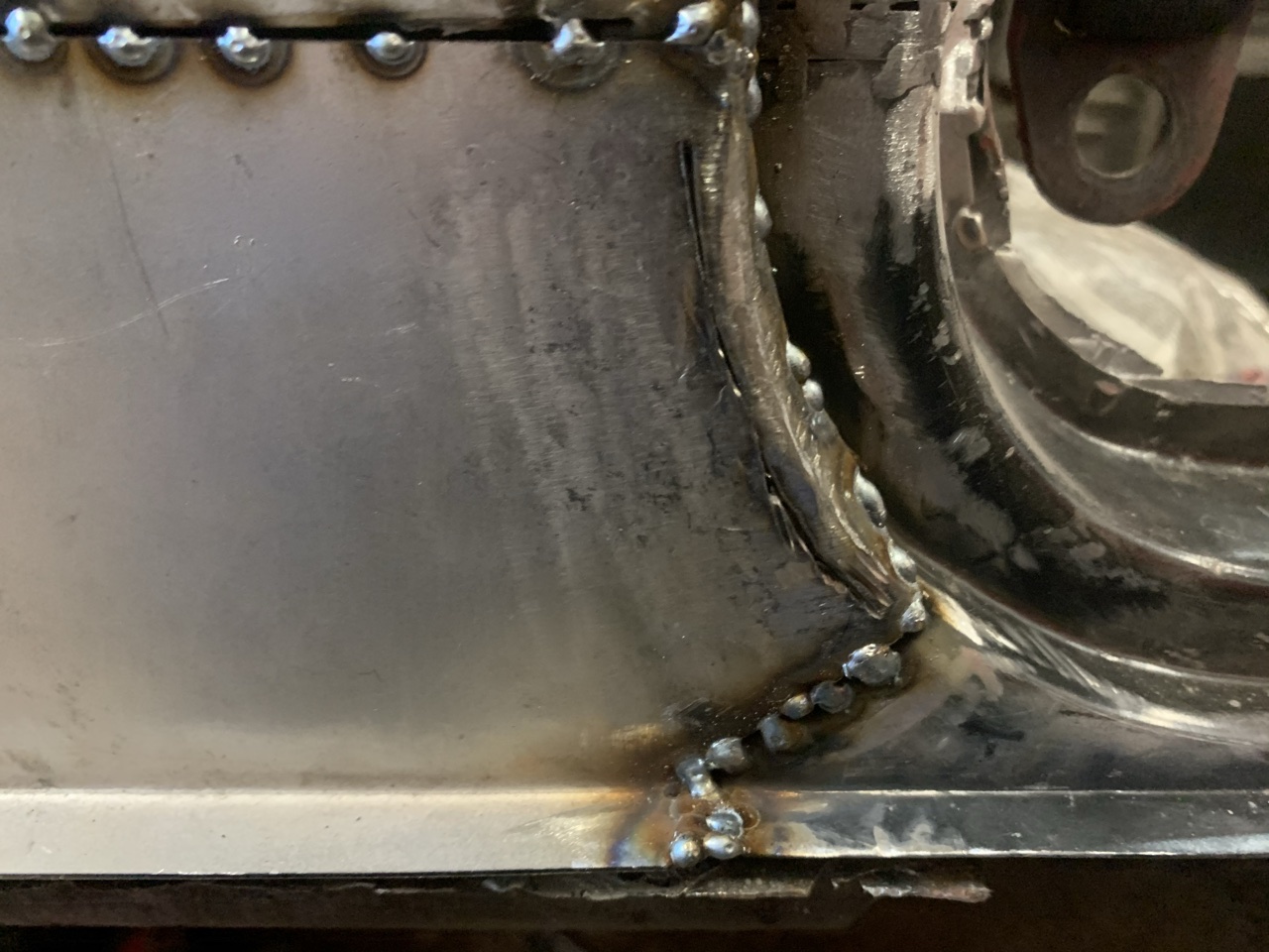

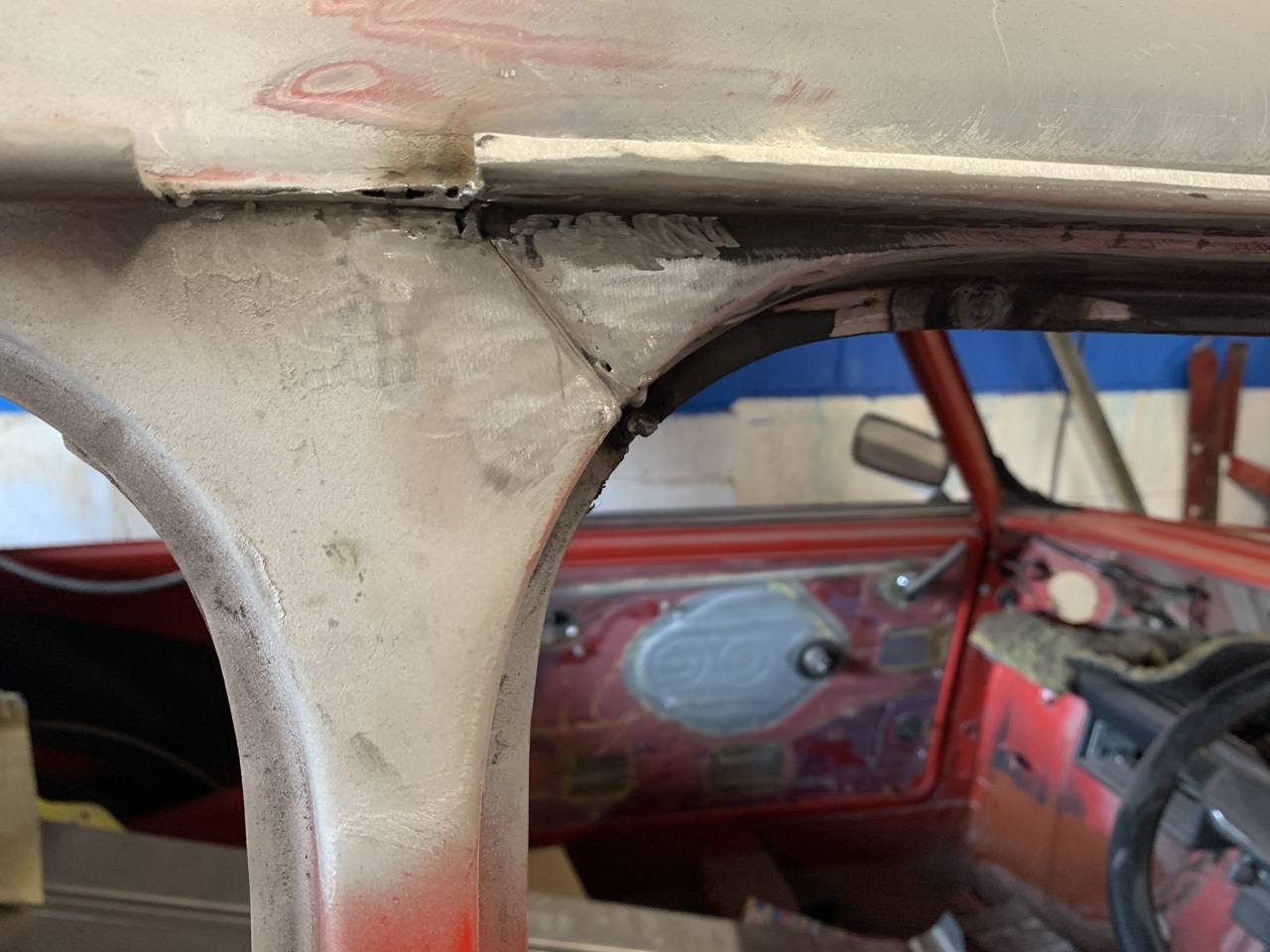

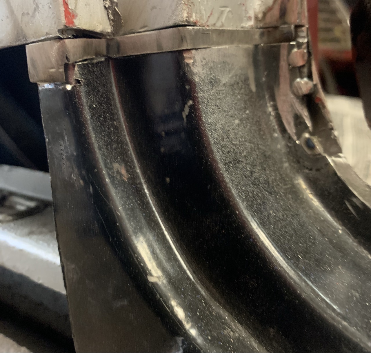

Cut a piece to take up the gap in the lower B-pillar before welding it in. Got my rear arch to door repair welded in and dressed back, had an issue when shaping the lip around the curve where there was too much metal to made a relief cut and beat the excess into the void then welded it up.
View attachment 252557 View attachment 252558
View attachment 252564 View attachment 252565

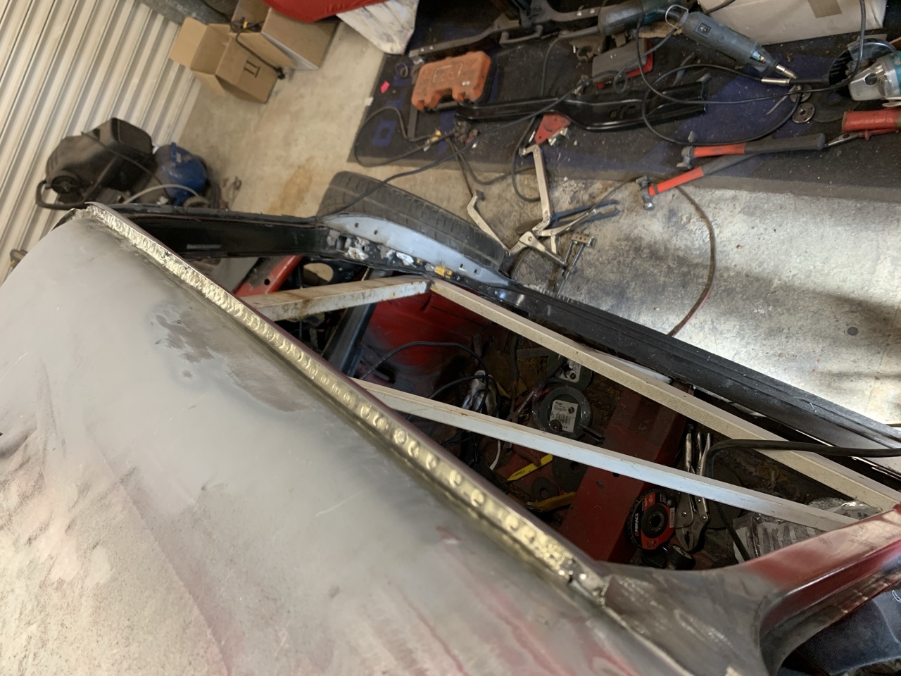

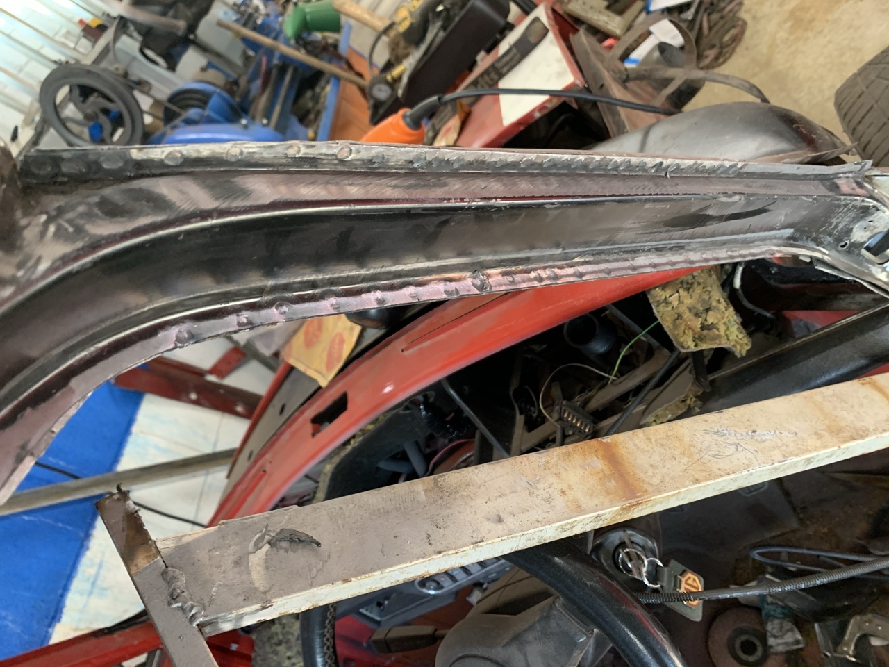

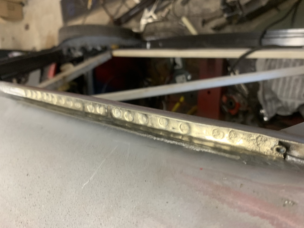

Made a start spot welding the roof gutter and tidied a few welds up. Distortion is minimal. May have gone overboard on the spots though
View attachment 252560 View attachment 252562 View attachment 252563

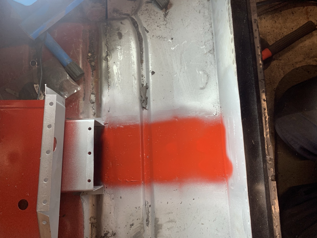

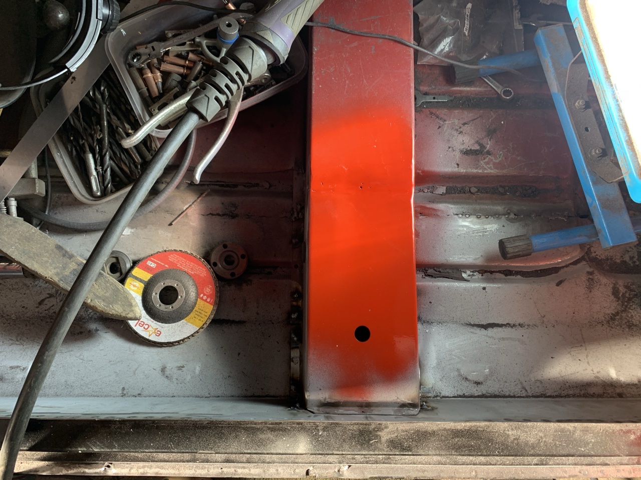

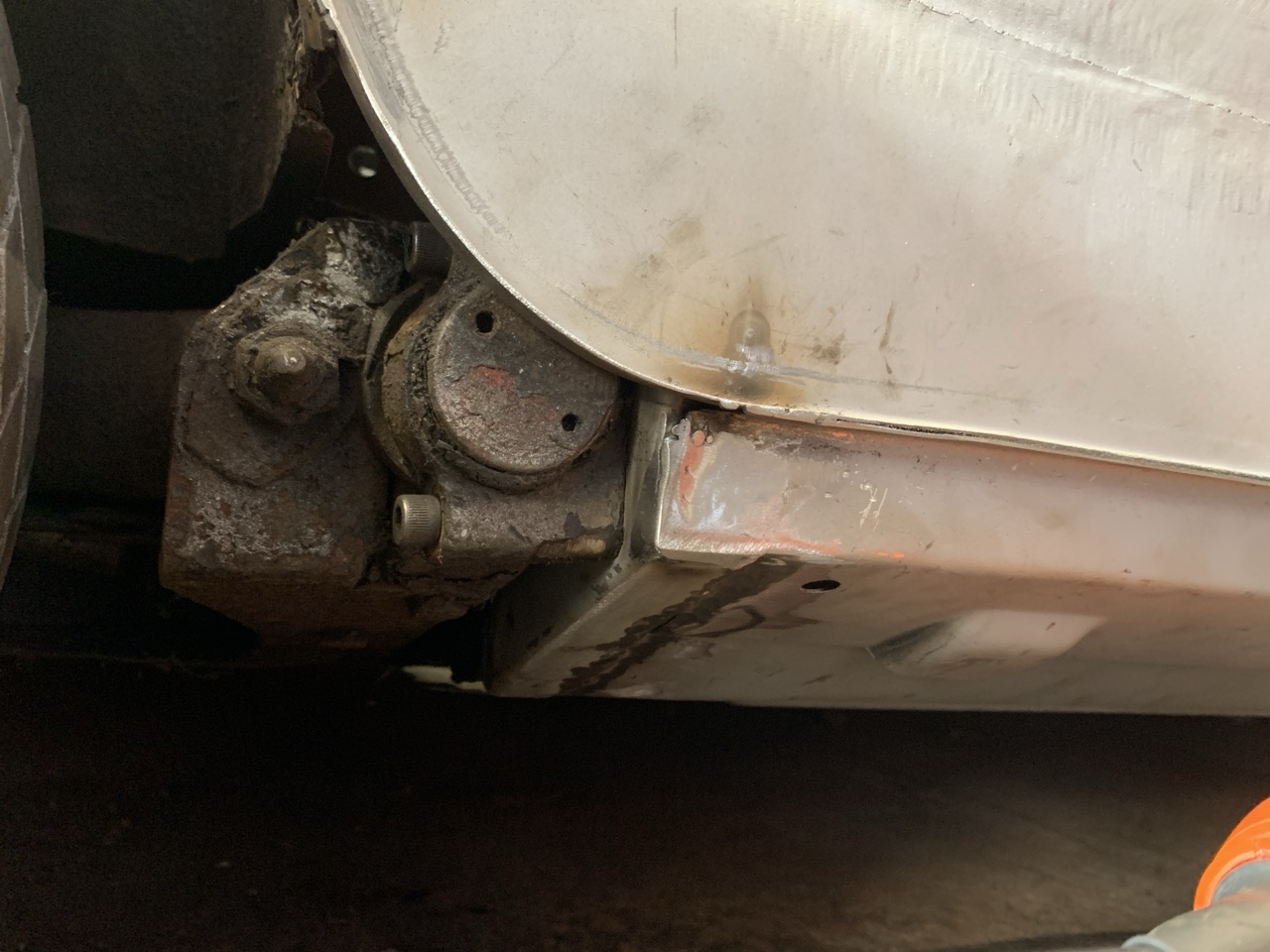

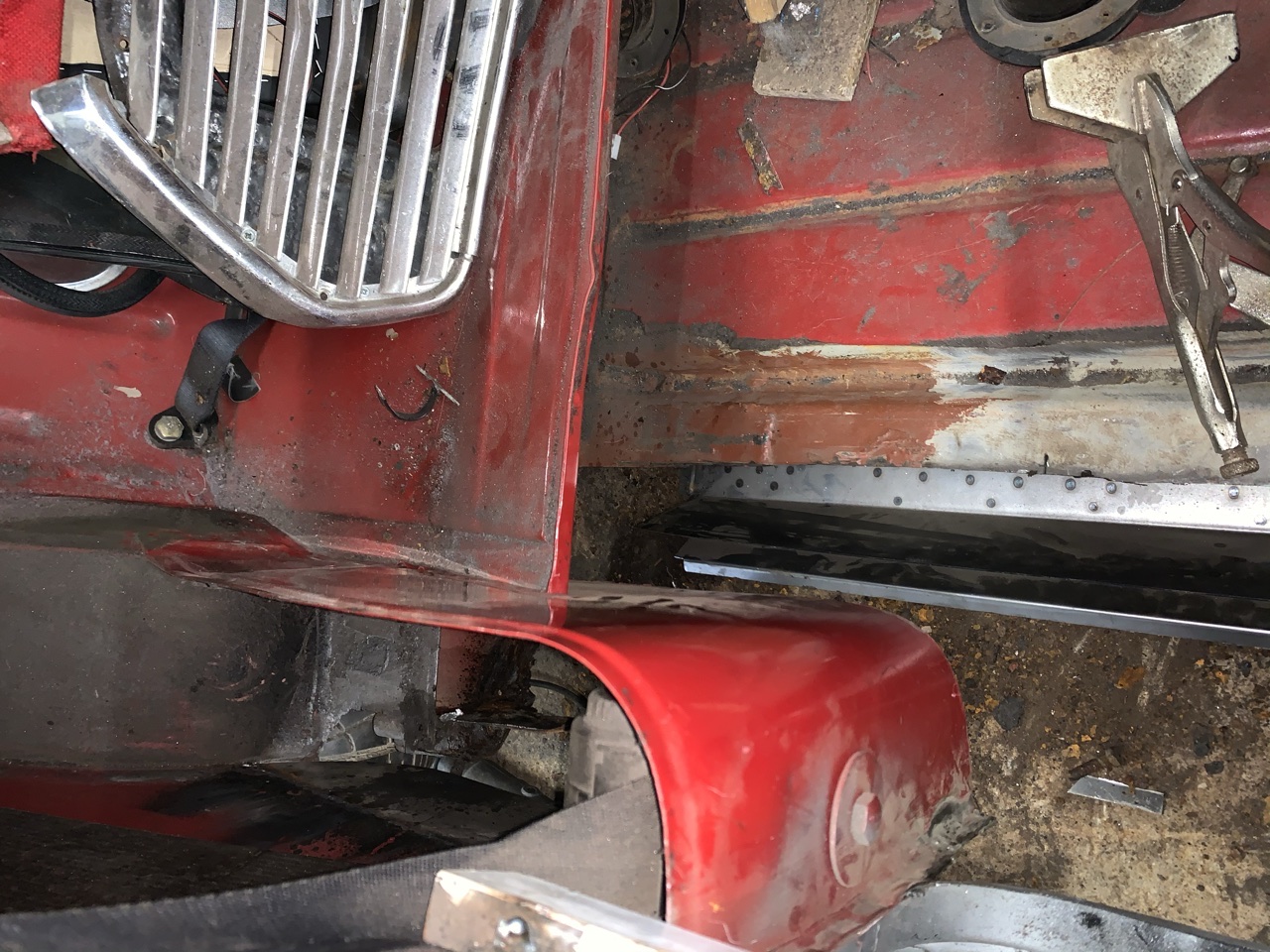

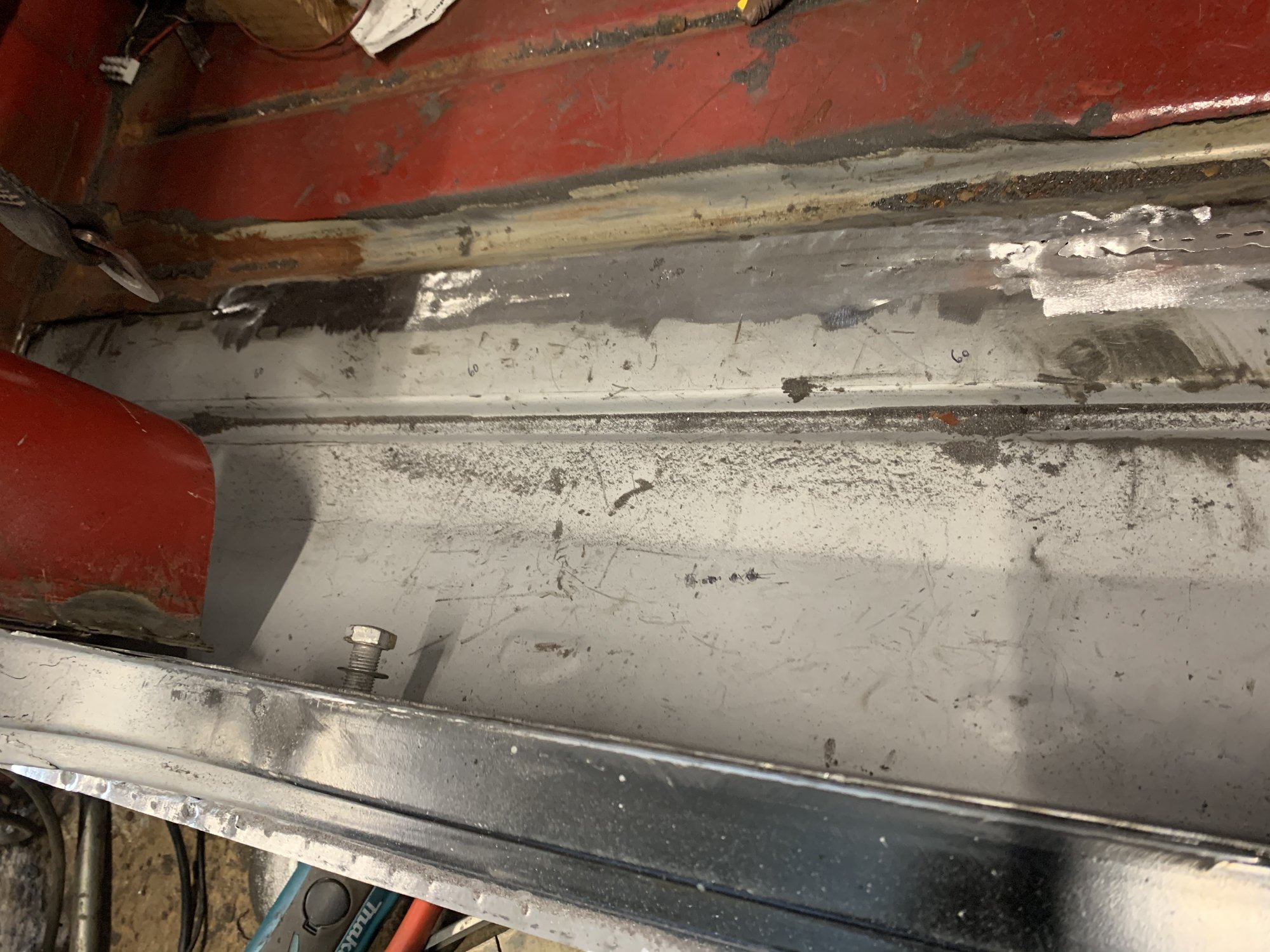

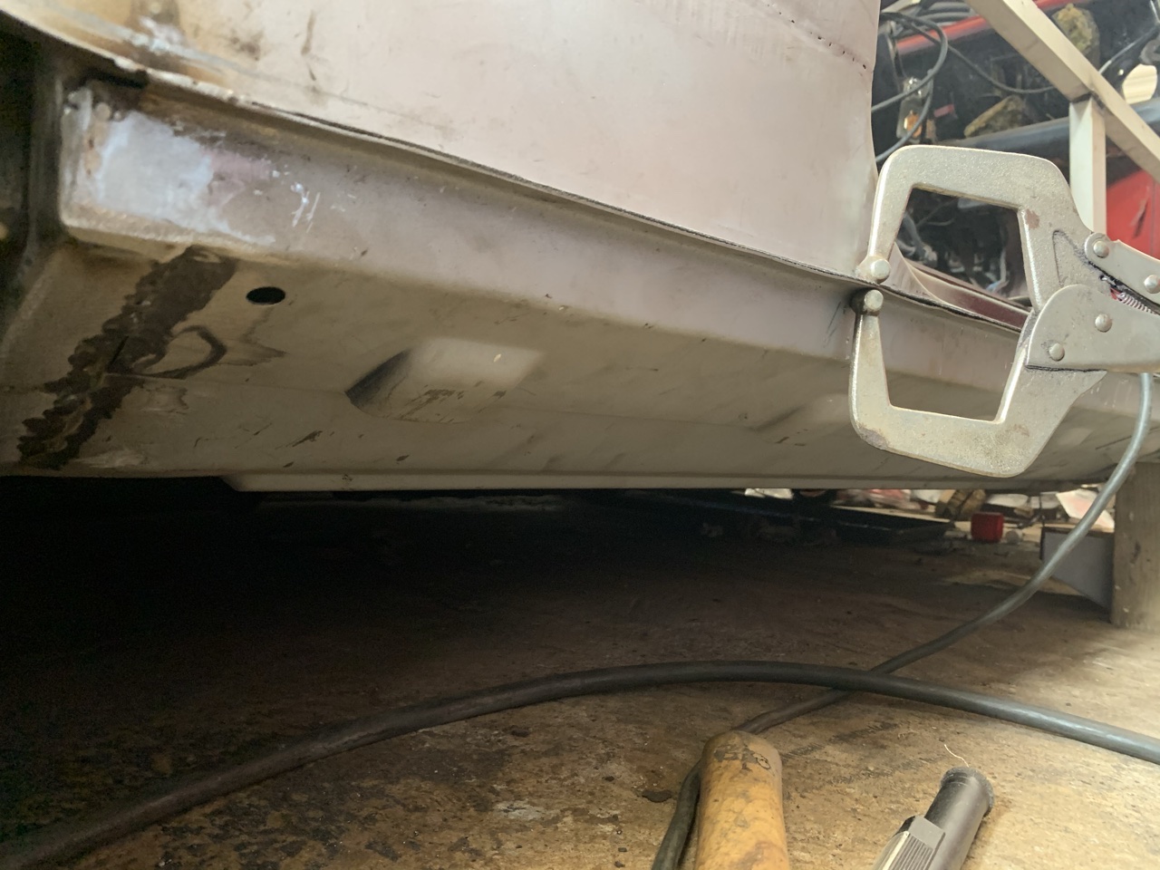

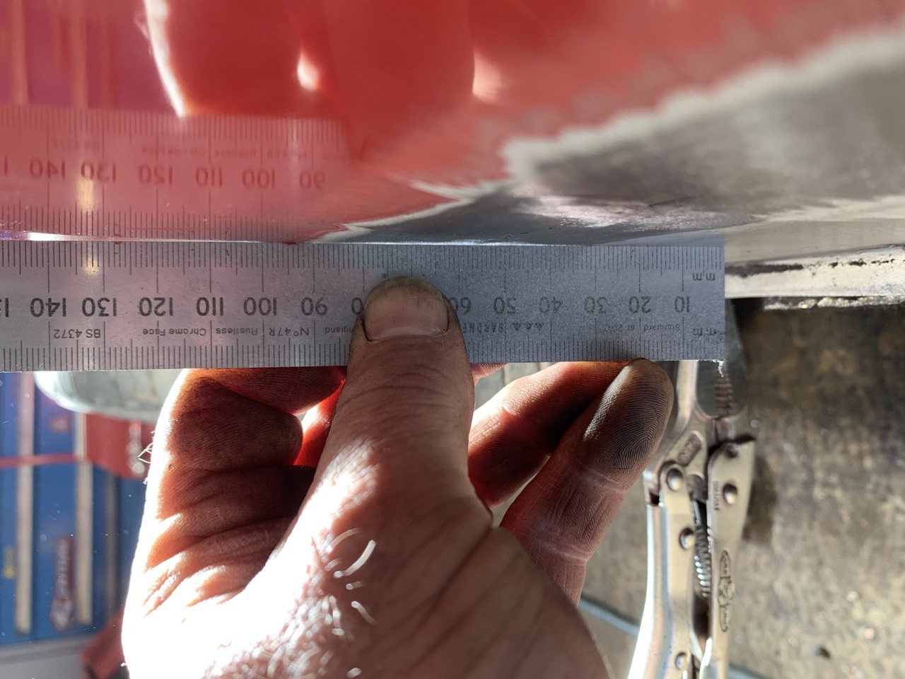

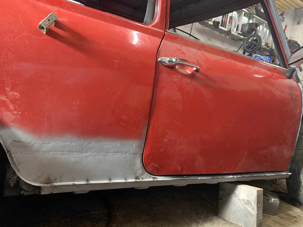

Door will need reskinning...Removed the subframe bolts of which both of them snapped! Cut the subframe mount panel out with various tools in the confined space under the seat pan. Then I trimmed down the part, pushed the cut bolts thru the new repair panel and copied the shape then cut and welded in place but only after positioning it with the subframe bolts through the mount.
Next a few spot welds all on the doorstep to check the fit of the door (door skin is shot so it looks worse than it is).

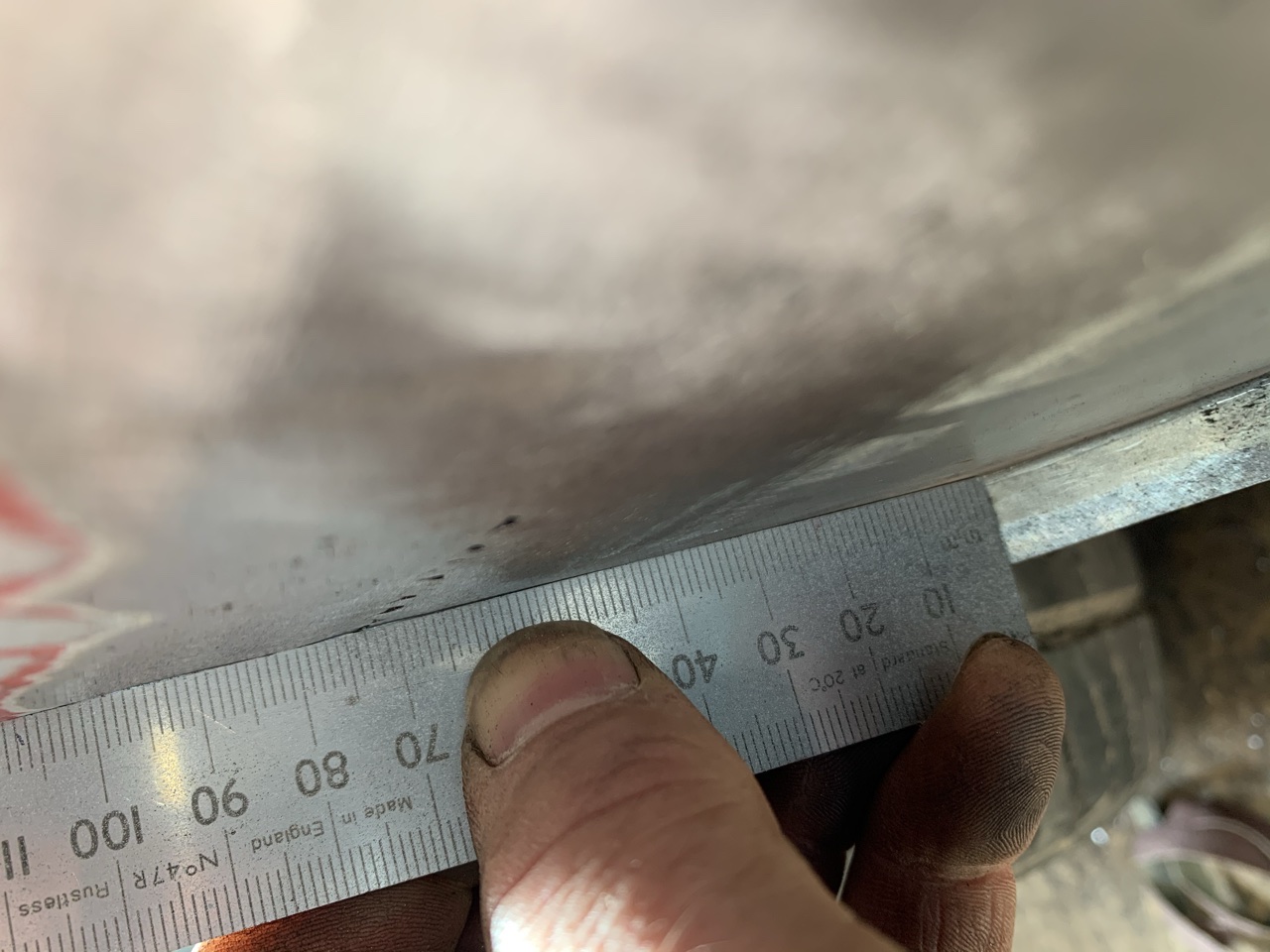

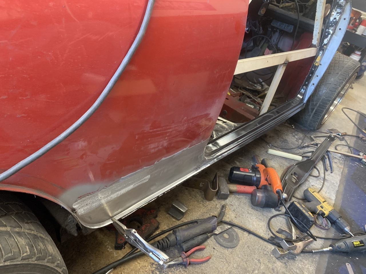

Then I marked a point 60mm in from the inboard edge of the sill with a steel rule and transferred that mark back 60mm on top of the floor, held my breath and cut out with a grinder at 45 degrees Fitzee style, this allowed me then to cut a wooden wedge 140mm high and block up the inboard end of the sill and spot weld along its length. Not finished yet but not too much to do on the sill itself and the integrity of the shell is almost as it should be.
View attachment 256278 View attachment 256279 View attachment 256280
