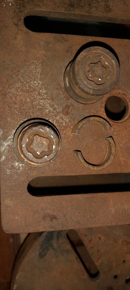

Got it off quite easily actually, managed to prise apart the spinning collar that was really soft metal, once that was off I just hammered on a 19mm socket and it undid no mither, got a couple of new nuts from GSF.

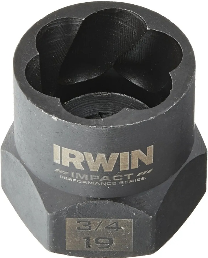

By the sounds of it, they did try a decent quality removal tool, which if it didn't shift them, then it's going to take a bit/lot of effort to shift them.
I've not had to deal with them for a long time, but I'm sure @premmington has shared his techniques before.
Those sets are not great and very slow work in a dremel, better in a die grinder, however I dont think any of them are small enough to get access that will actually work.
I think my approach would be stick a 6mm pilot drill the bolt and then a small holesaw, or even, might be quickest to drill the head off and extract the rest with a pipe wrench after the wheel is free.

As the spinny bit is off, Id suggest grinding a small flat and knocking it round with a cold chisel.
