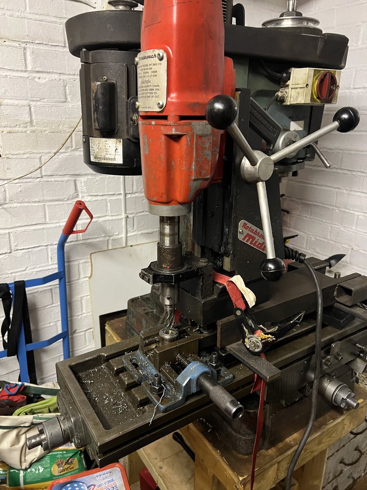

Maybe time to weld a nut on
20mm x 10mm bit of bright mild steel bar - 312 MMA rod - dig in hard at 120amps AC or DC - real short arc - beat end of the bar with a 4lb lump hammer while it is hot - big adjustable or stillsons on end of bar - and it will be out.
