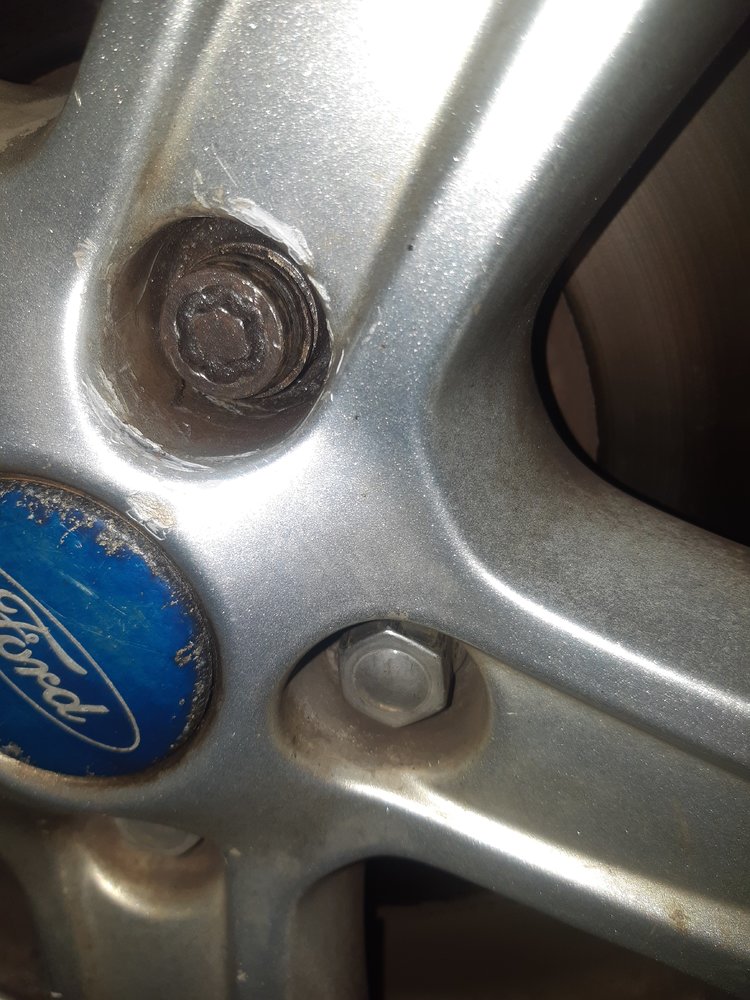

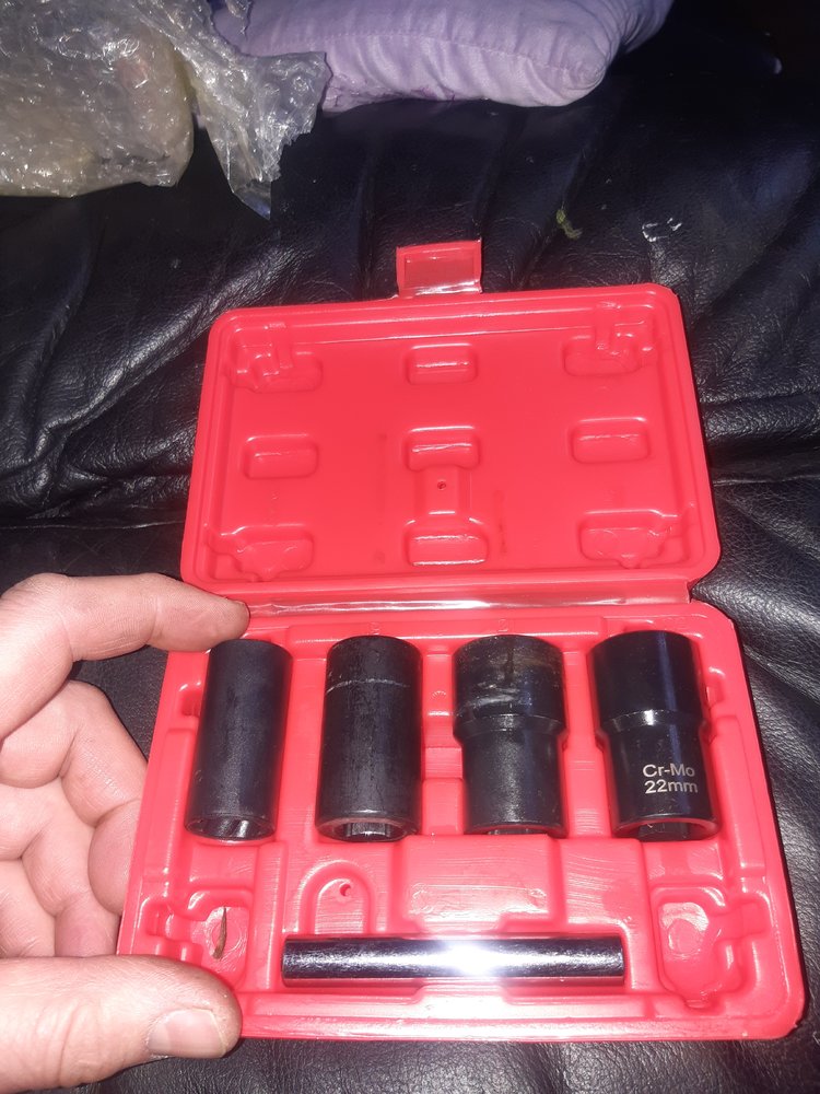

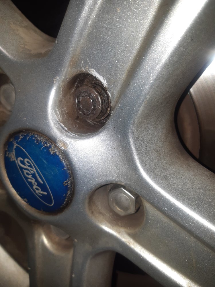

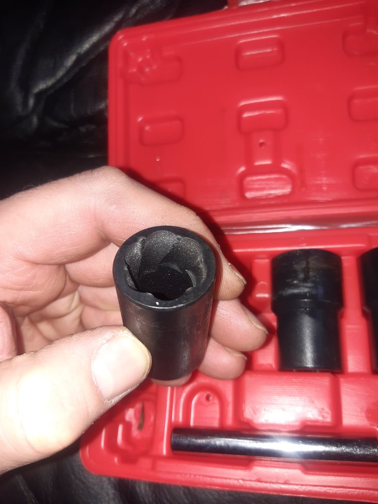

Please get a photo, Im interested to see that, perhaps the flutes were too soft?Plus I knackered my 19mm Irwin so need another one of these!
Wont be easy to heat the nut - except you have oxy! so it will. I would instead heat a slightly undersized tube or the 18mm socket bright red and knock it on. It will form it and shrink when cooled down.
