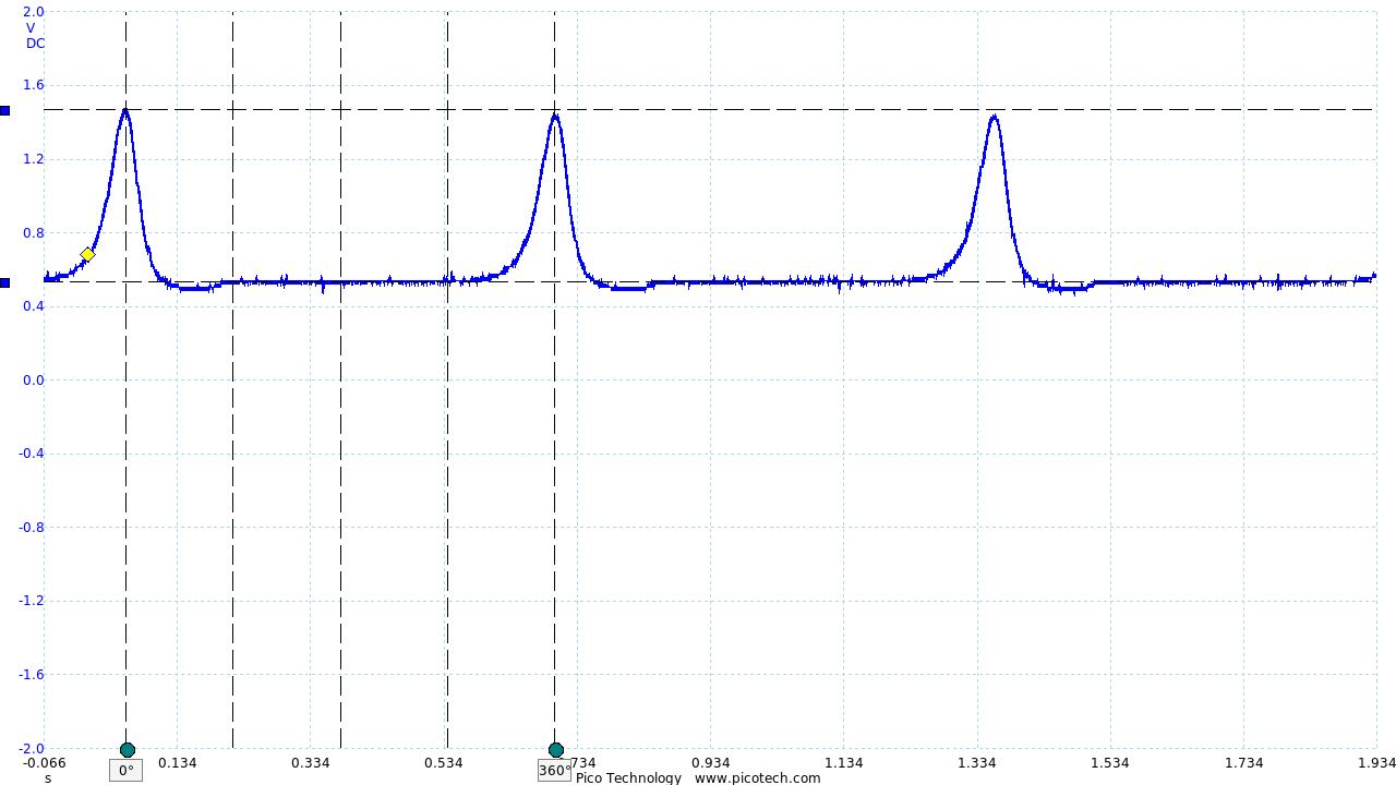

That had occurred to me, but just pulled the EGR and then the intake manifold off and it is all clear all the way back to the filter.
It would run a little on ES but nothing like it did a month back.That leaves compression and exhaust.
Disconnected the EGR exhaust outlet intake and I am getting exhaust gases coming out of that for the 1 cylinder that is firing, did not burst into life so I think that rules out exhaust.

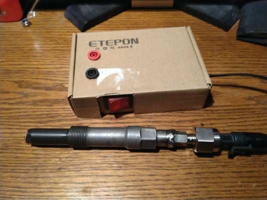

Now I am thinking that all that starting and misfiring running with no fuel at all being passed has done the cylinder sealing no favours. Don't have a diesel compression tester so might have borrow or invent!
