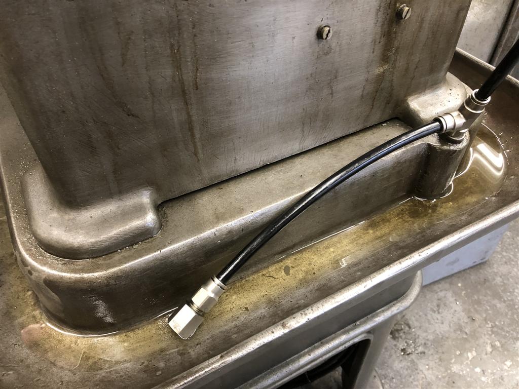

Did a bit of work on my gear hobber. First was a belt guard for the cutting oil pump. This is driven off the main motor and is a gear pump that sends oil from the reservoir up to the hob which then drains back down from the tray into the reservoir. It's about 60 or 70 years old and tends to...
