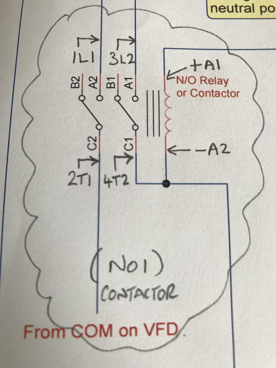

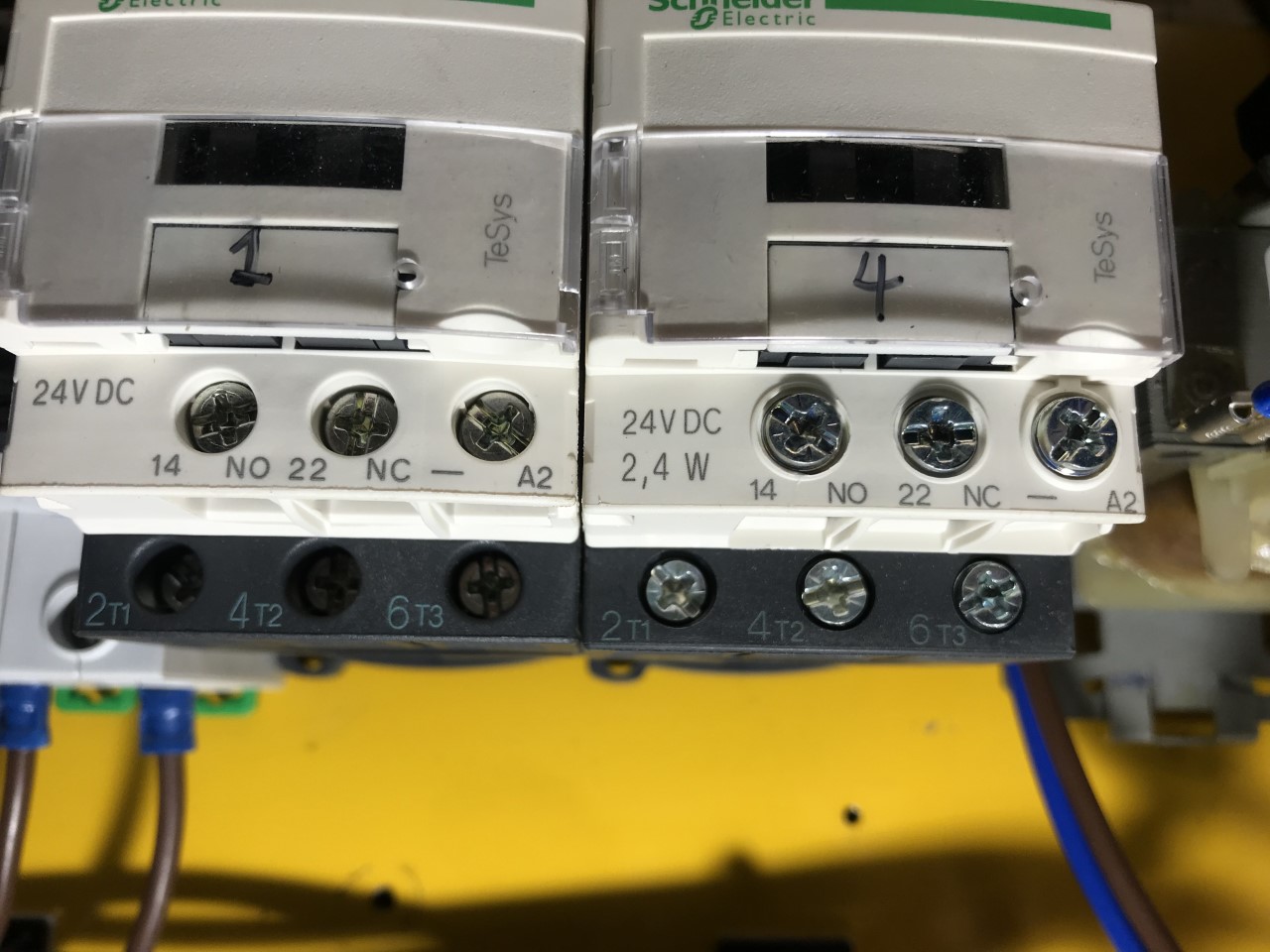

I initially looked at that circuit, but did things slightly different. The circuit diagram uses 24V AC for control. I decided to go with 24V DC, as that is the control voltage of my Schneider VFD, and I intend to also use it to power LED lighting.Yes, you got it.
I'm trying to replicate what Paul in Wiltshire has done, which is based on the circuit diagram i have posted. I do spot differences though.
Think chimp with a 6' adjustable doing electronics, thats me, but i'm willing to learn.
I've got 80% of the stuff ordered, thats a start, i could just do with @Paul in Wiltshire posting a front on shot and we'll be a bit closer!
I think the circuit diagram above assumes the suds motor is single phase, this one is 3 phase. So that could be a little hurdle.

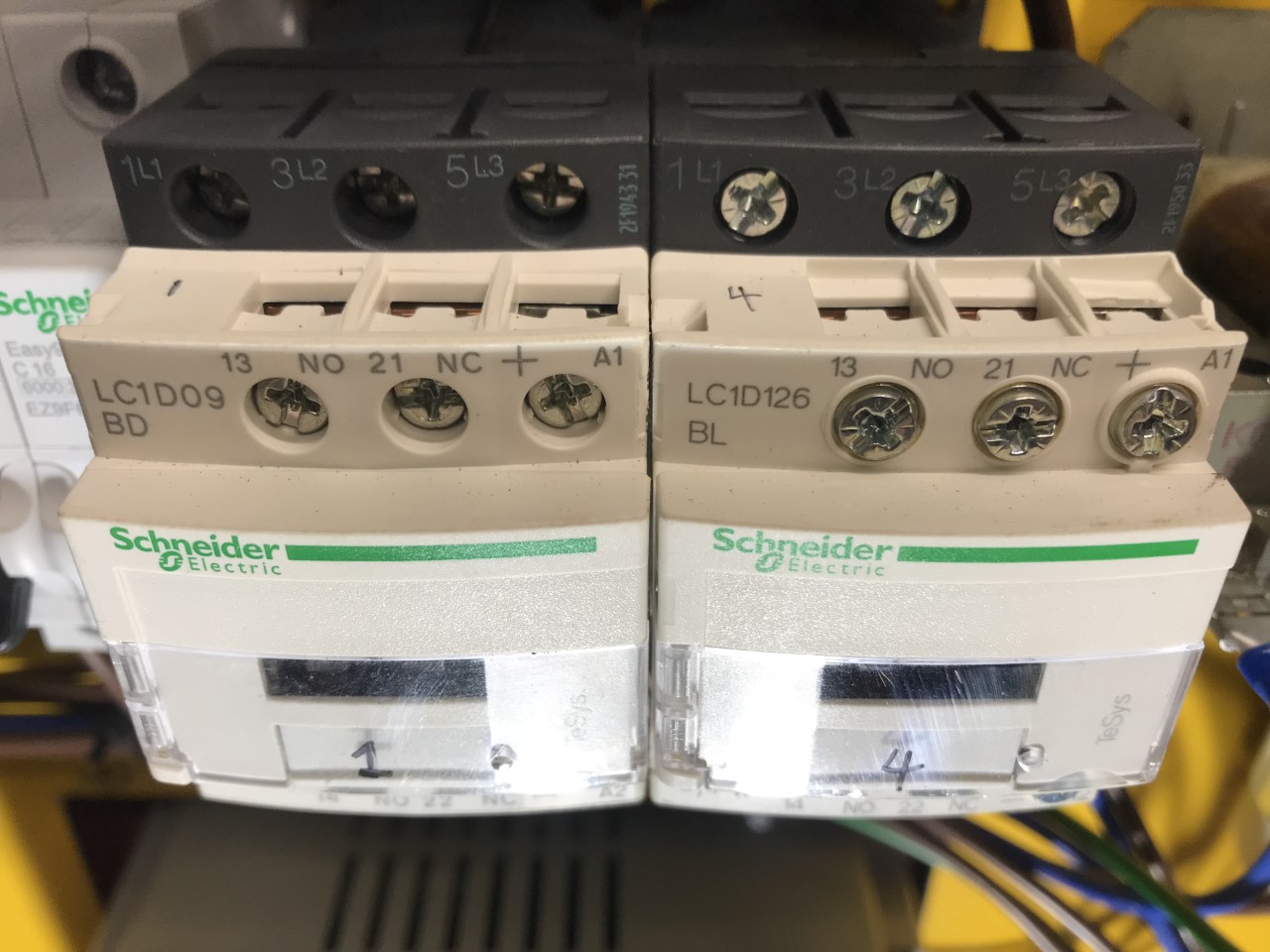

On the DIN rail I have (from left to right) :
1 Amp MCB for the power to the DRO and 24V DC powersupply.
16 Amp type C MCB feeding the inverter and suds pump
24V DC contactor, this isolates the supply to the inverter, suds pump and the 24V supply. This is latched from the 24V supply, with a reset button on the top of the lathe. If you hit the emergency stop, or there is a power cut, this contactor will unlatch. Meaning power is cut to the inverter and the control signal goes to 0V immediately, initiating a fast stop on the inverter. (As the inverter will continue for a few seconds after a power cut).
24V DC switching power supply, with its own protection. Provides the 24V for control of VFD and to energise the contactor. It will also power some LED tape I intend to fit.
Behind the Perspex cover is the original Klocker Moeller isolation switch, which cuts all power to the panel and stops you opening the door unless it is off.

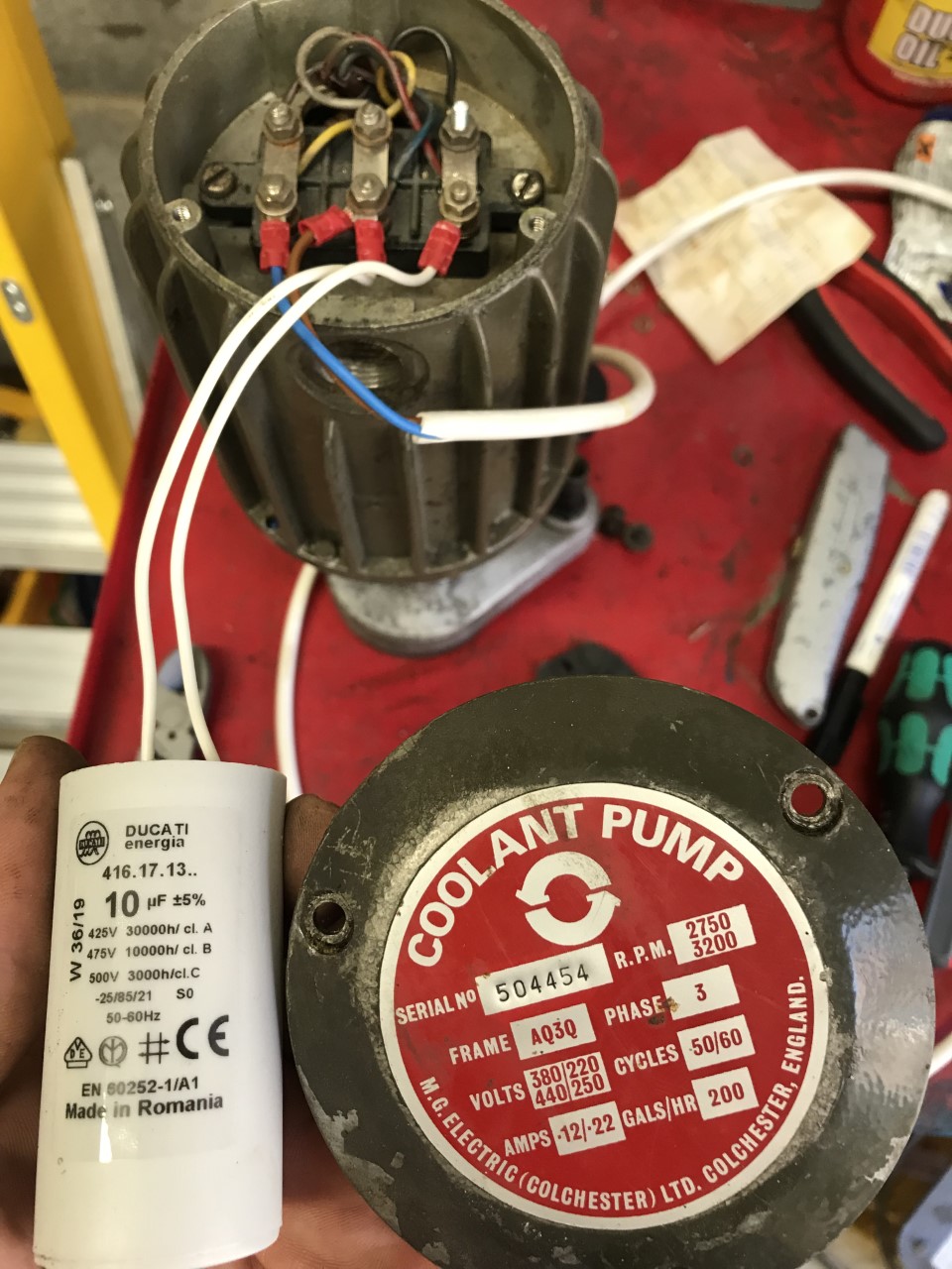

The suds pump does not have a start capacitor or delay relay, all I have is the one old turquoise coloured capacitor to create the third phase for the suds pump.
The microswitches take a 24V DC supply via the brake switch and provide a forward/reverse signal to the VFD, hitting the brake will lead to a coast stop. The change gear cover microswitch provides 24V to one of the VFD inputs via a contactor terminal. If that is cut the VFD performs a fast stop. This all requires a bit of VFD programming to get the behaviour that you want.

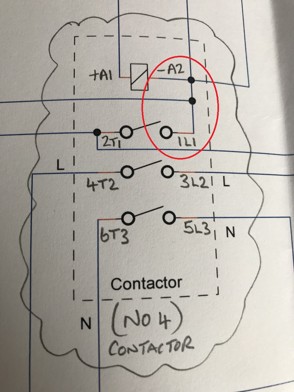

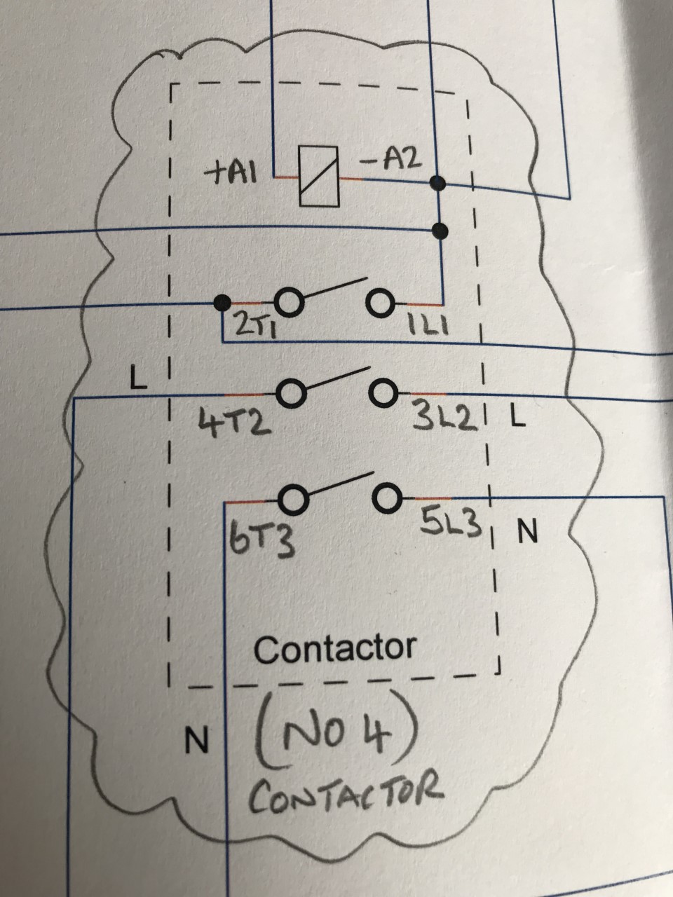

) but looking at it now on a PC I'd say for contactor 4 the left hand connections should be the "L" terminals and the right hand ones "T" (Left hand being "Incoming" or supply side, right hand going out to the components).
