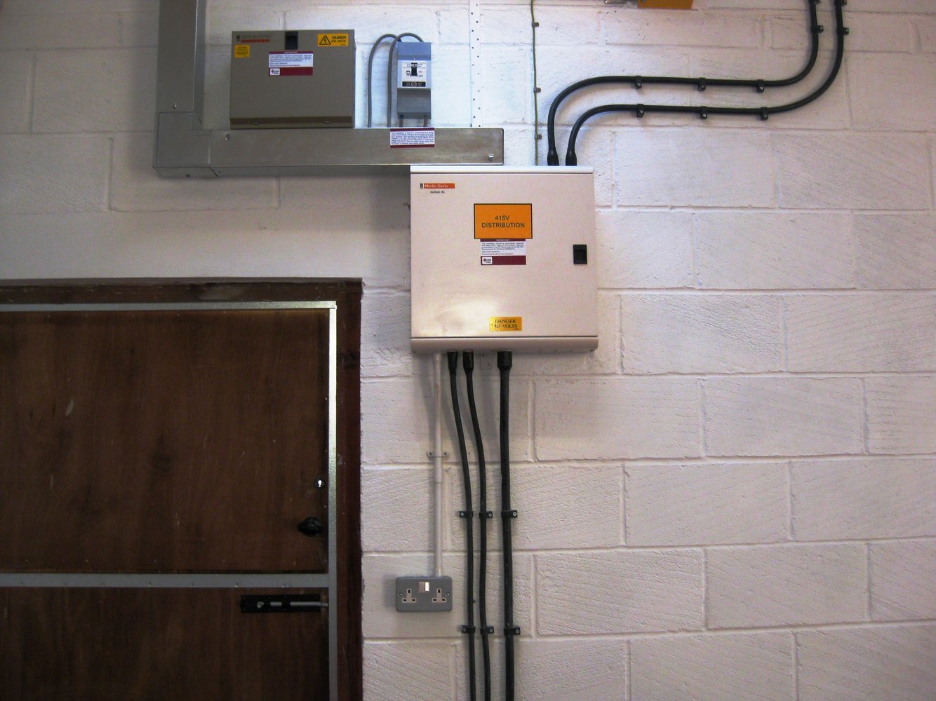

Did a favour for the the local butcher, he built his own shop and did the plumbing and electrics, he says to me the Mrs keeps getting a tingling feeling off the sausage machine what did think it could be?
I stick the earth loop impedance tester on the set up and no earth! worked back to the consumer unit he had fitted and sure enough no main earth! easy fix but could have ended badly
