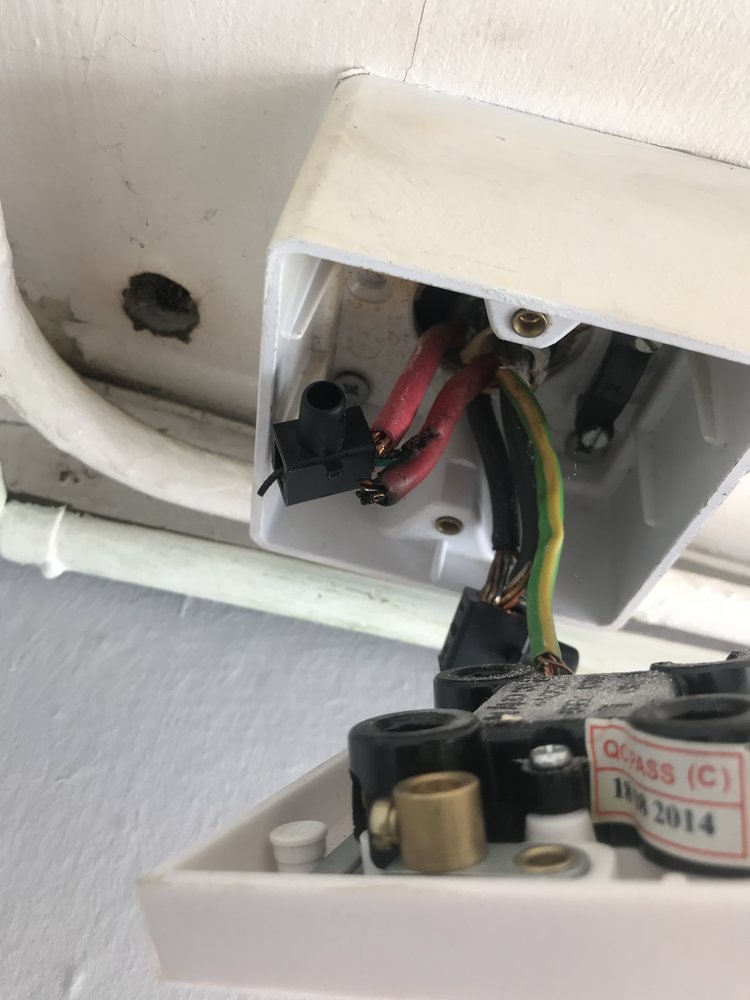

the job im on at the mo is interesting to say the least. testing the wiring and found the 3d floor extension ringmain is fed of spur socket on the landing
it gets better . took the floorboards up to disconect the spur socket and found it was conected to the shower cable with a jointbox along with another spur wired in 1.0mm cable to a jointbox then wired in 1.5mm flex to a socket
theres a list as long as my arm on the faults that have to be rectified
spent a week on the job just altering wiring and fixing faults and a stack of time on the 3 big extensions 234 hours up to now
another 4 days to finish it probs if im lucky
