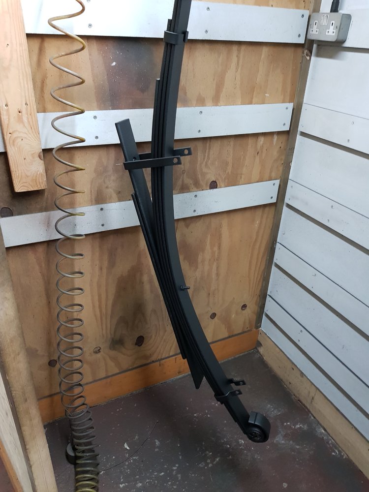

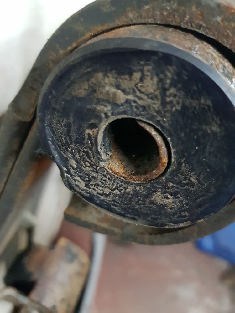

I think its the angle of the photo the rubber is good and the other side bush is like new dont know why this one wore throughDepends on what you want really, that hole looks oveled unless its just the pic making it look it, i would bung a new set on there if poss,
On Series Land Rovers I have seen it happen when the shackle bolts have been fully done up with the suspension hanging down (full droop) (on axle stands).I think its the angle of the photo the rubber is good and the other side bush is like new dont know why this one wore through
I get that if its a bonded bush as then its constantly being twisted more than it should but these appear to be split bushes so the metal part is free to revolve in fact on my friends land cruiser pickup they have grease nipplesOn Series Land Rovers I have seen it happen when the shackle bolts have been fully done up with the suspension hanging down (full droop) (on axle stands).
Rather than the shackle bolts being fully done up once the weight of the vehicle is back on its wheels and the suspension has been bounced a few times to settle it.
Means that there are allsorts of things being pre-loaded when the vehicle is at its normal ride height.
Also get the rubber part tearing.
I'd change the bush while you've got the leaf spring out, but its your car.
