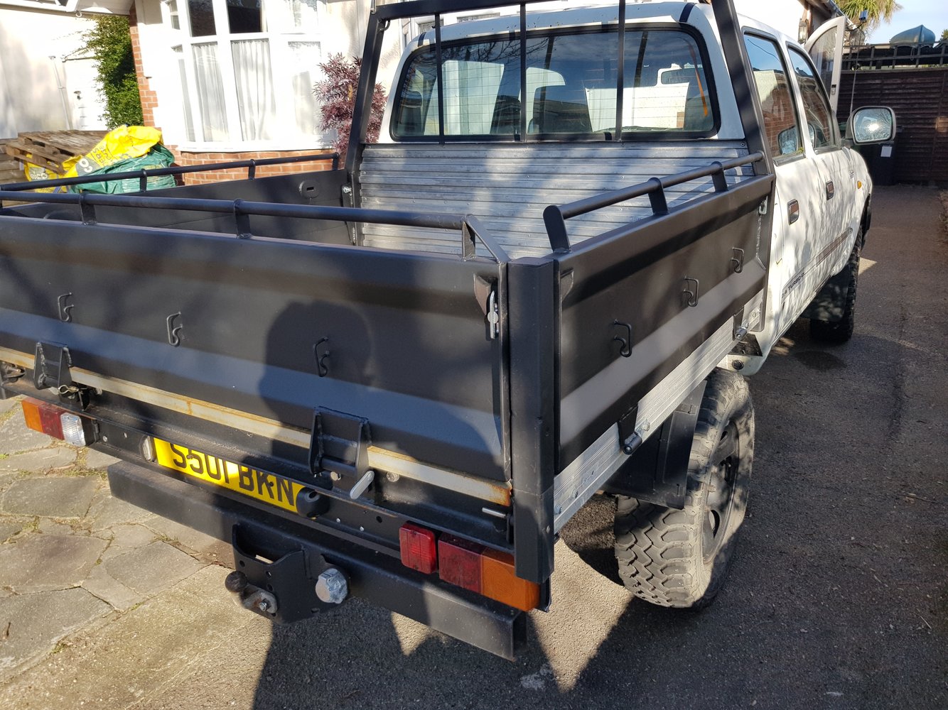

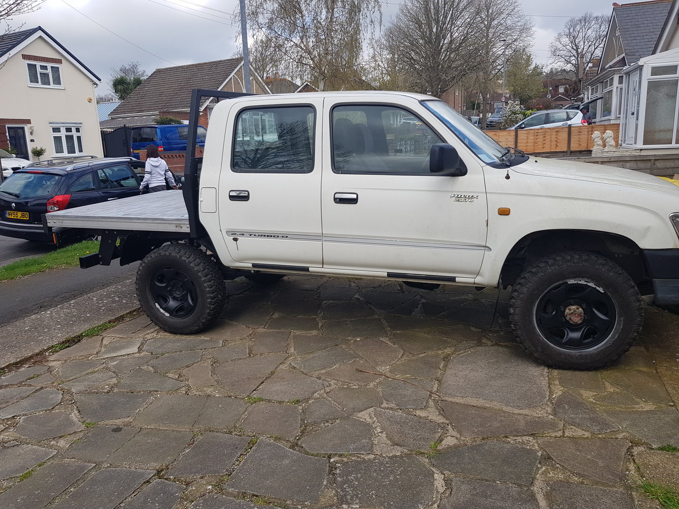

dont think you will have anything maor some howCheers , got the side to make yet but already its a lot more practical for me. MOT on friday though![]()

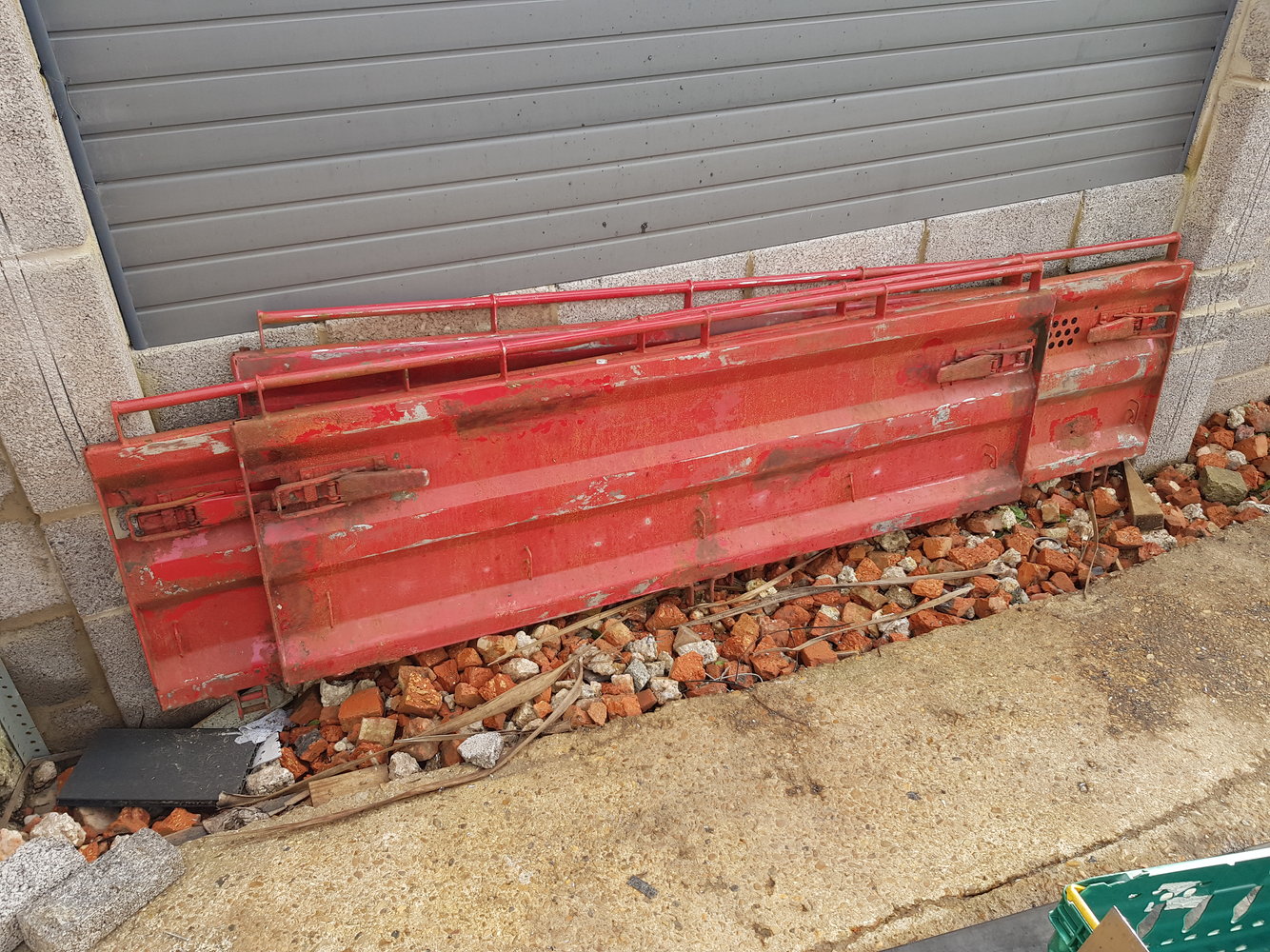

Oh you've done a brilliant job - perhapds just another 12" and a small hiab. at rhe back of the cab..almost there just got bed sides to make but I need it on the road would have made moving my new milling machine easier

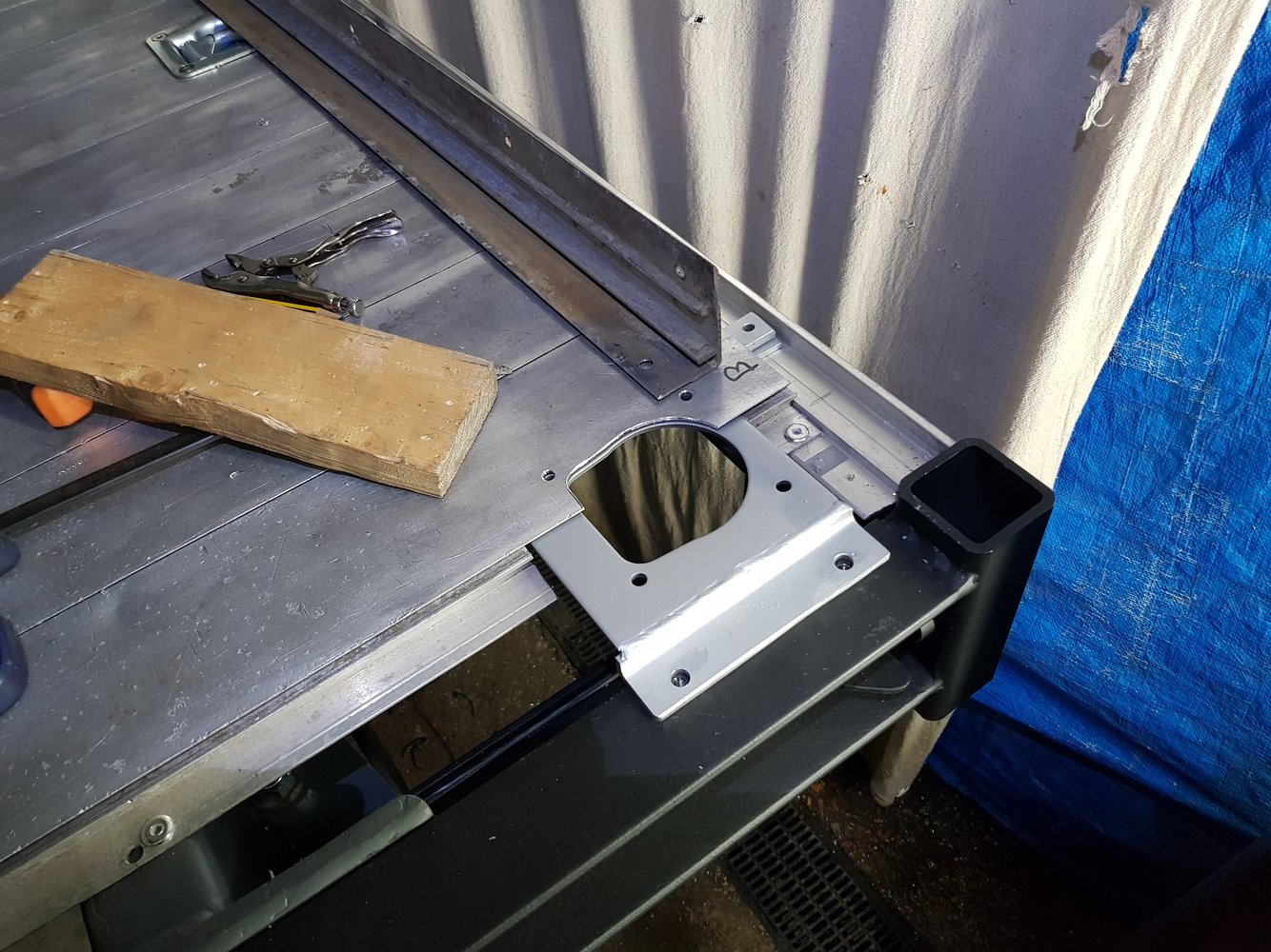

View attachment 444173View attachment 444174

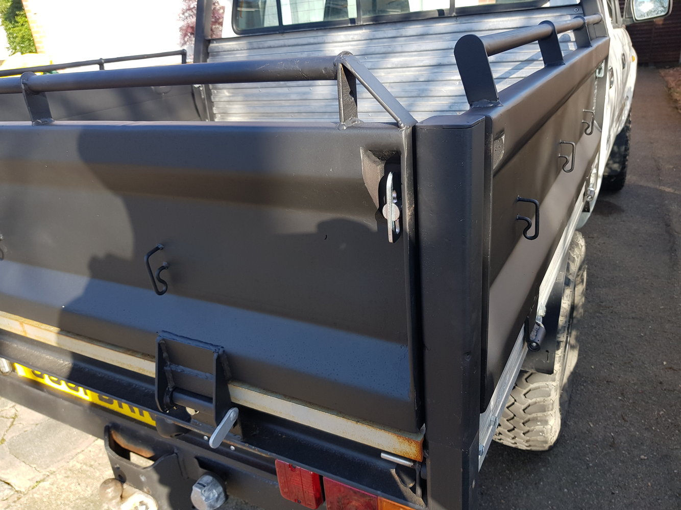

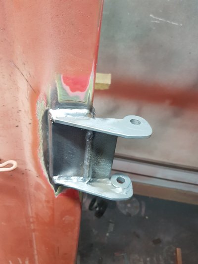

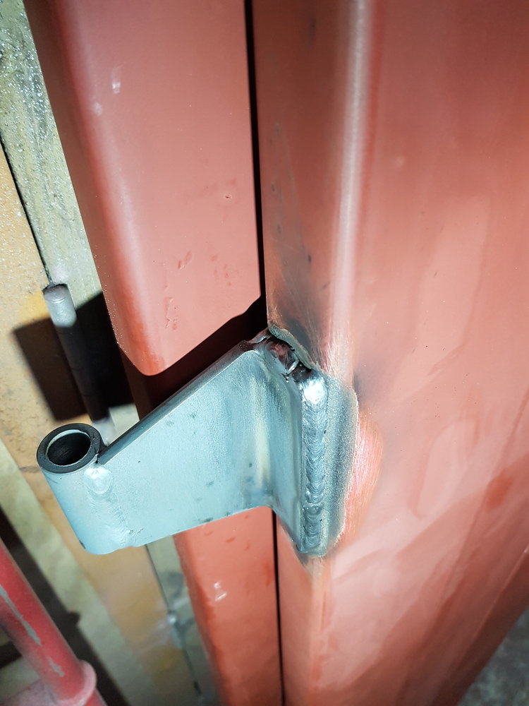

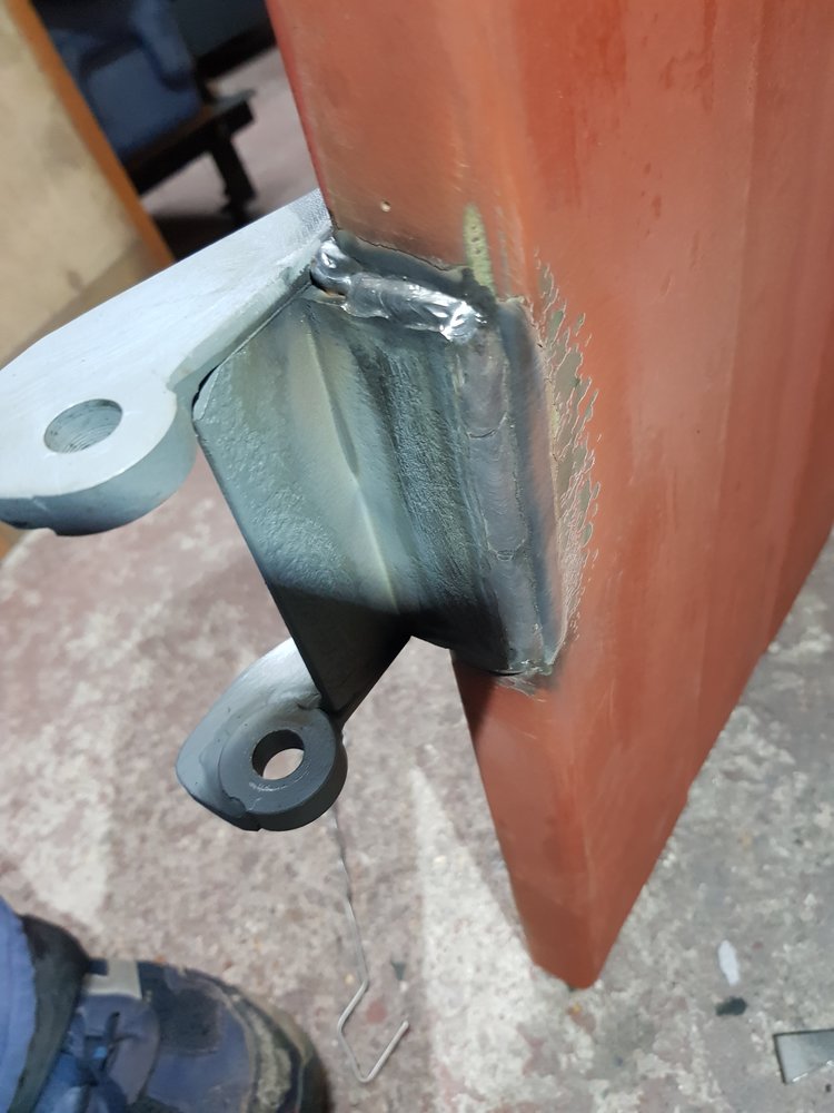

mounts for the load eyes modified so they either bolt to side rails or crossmembers
View attachment 444176View attachment 444175
I think the proportions look right any longer look silly shorter not much use
Cheers it came out looking better than id hoped I have seen some naff looking ones either too wide or low. I wanted full suspension travel but as low as possibleOh you've done a brilliant job - perhapds just another 12" and a small hiab. at rhe back of the cab..![]()

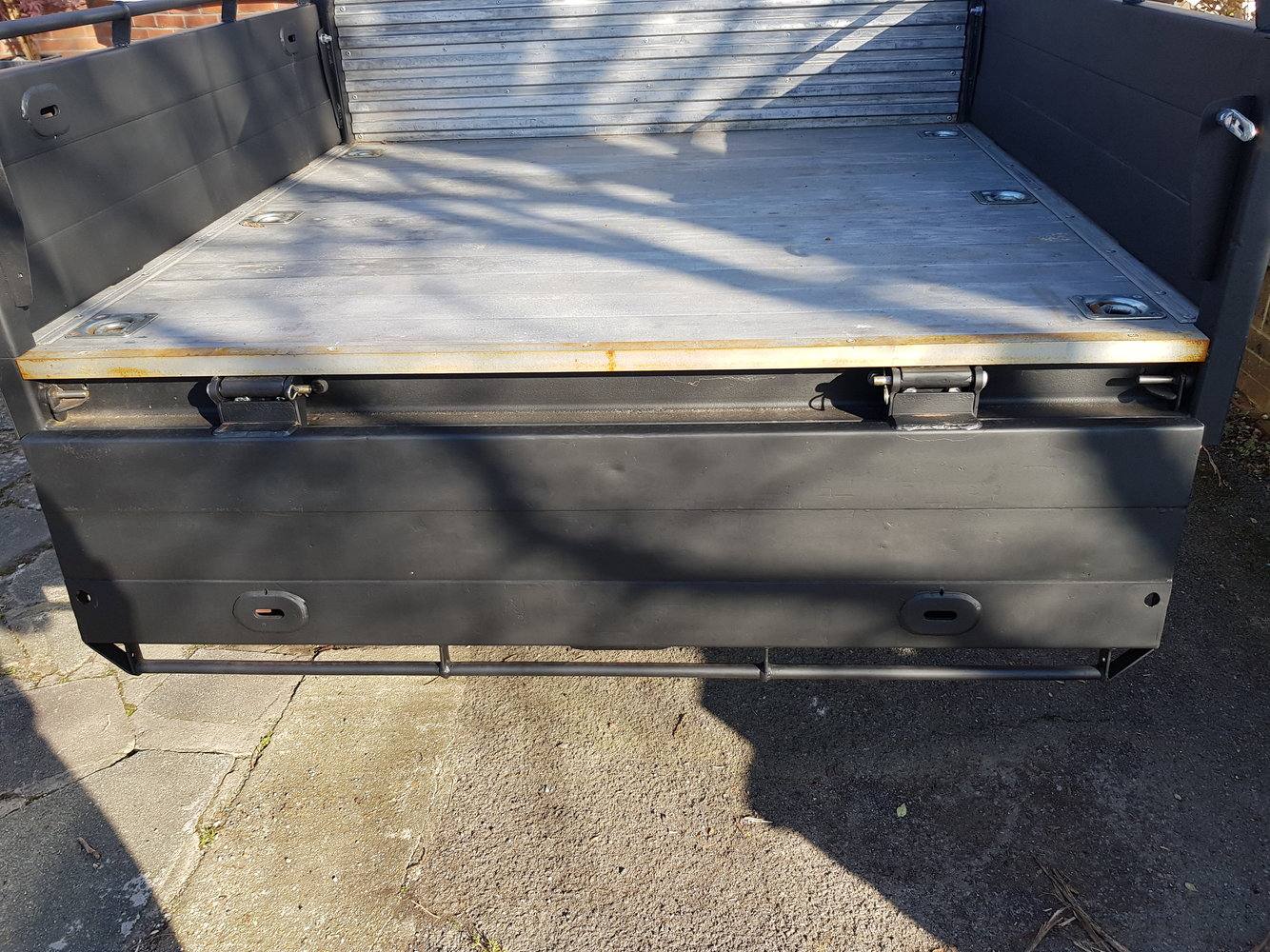

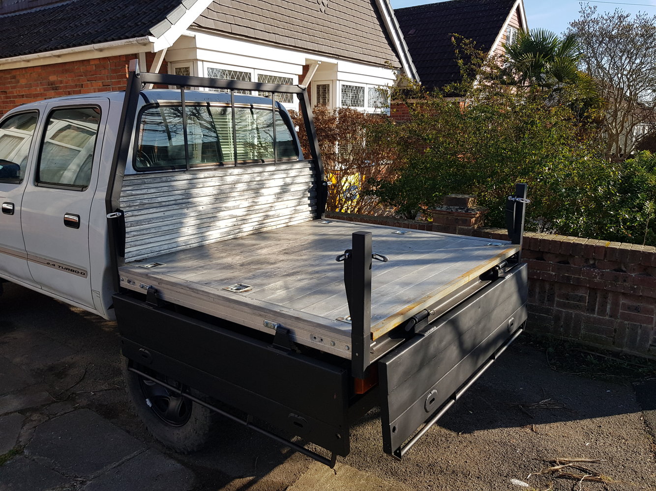

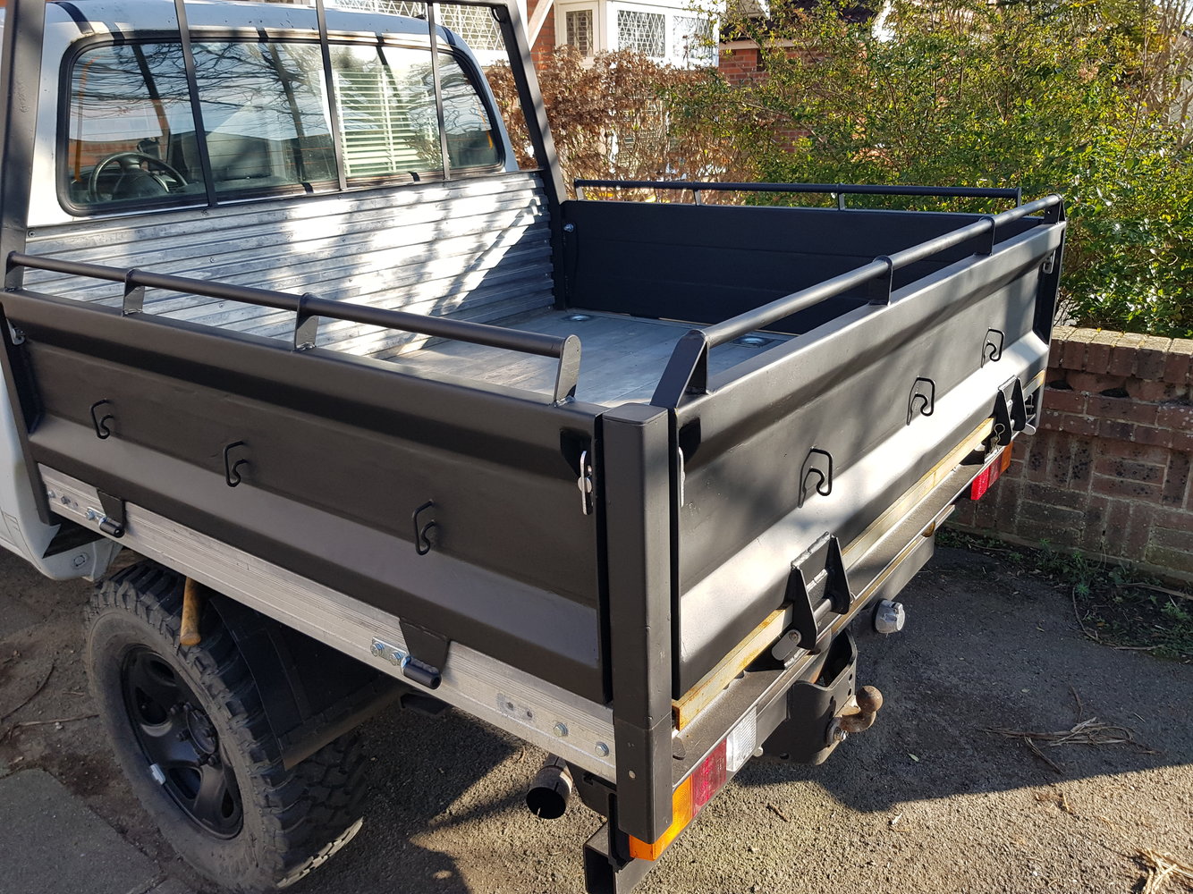

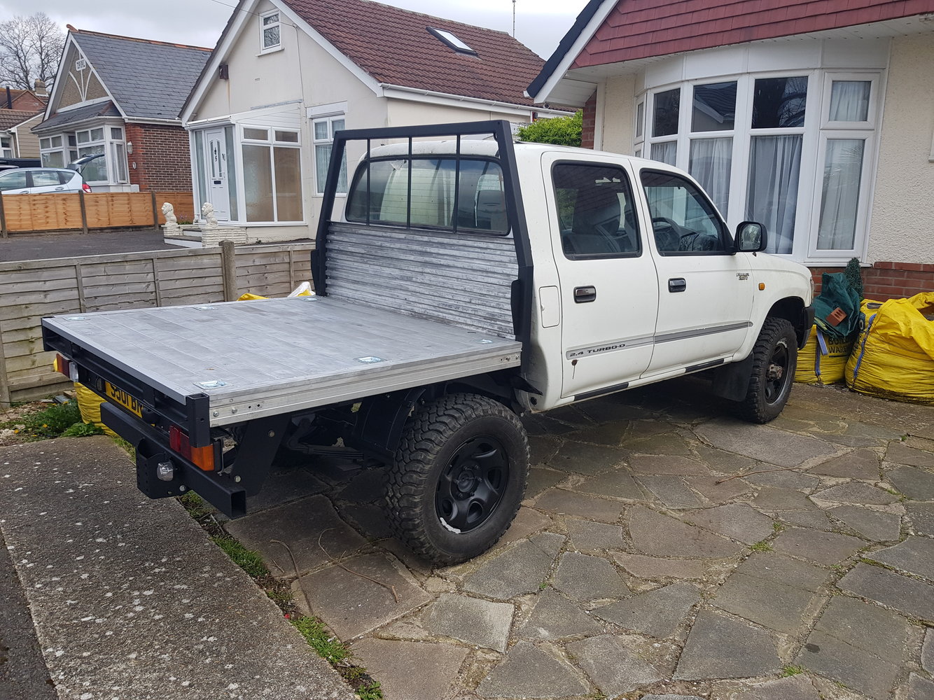

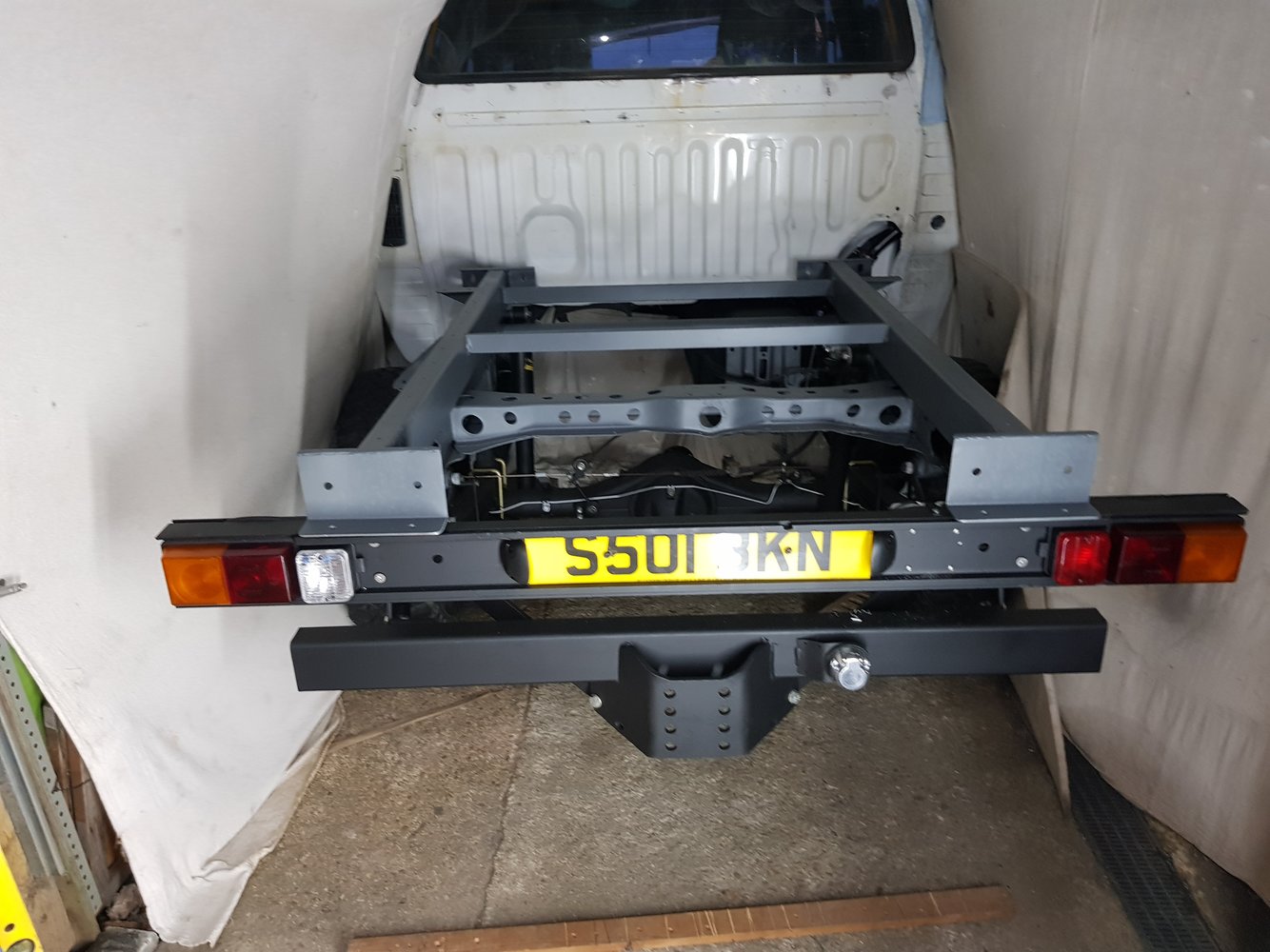

superb workAnd finally done
Quite happy with the result much more practical than before and soi many more place to tie stuff done, so trick with the original body
View attachment 486971View attachment 486972View attachment 486974View attachment 486975View attachment 486976 View attachment 486973
Under tray lockers next for ratchet straps?soi many more place to tie stuff done, so trick with the original body

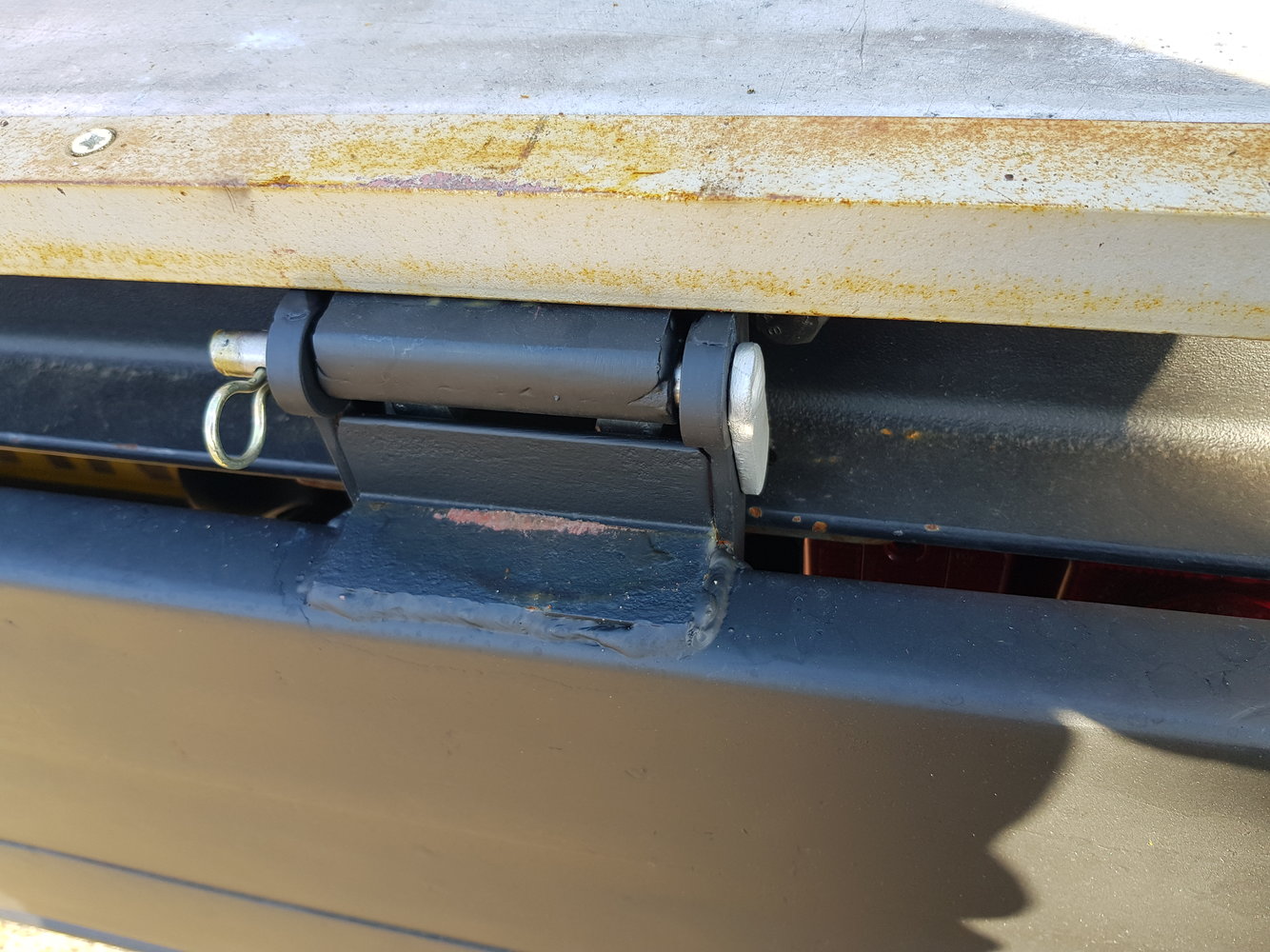

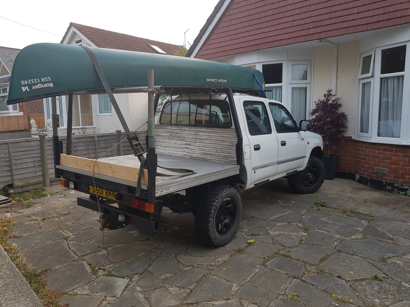

theres a captive pin that slides across the back and they pull out easy, i wanted a flat back too as can be useful. Also the caps on the top pull out and i milled some short scaffold poles dowd that slide in so i can carry my Canadian canoe on top@dieselsamurai how are those corner posts held on / can they be removed quickly?

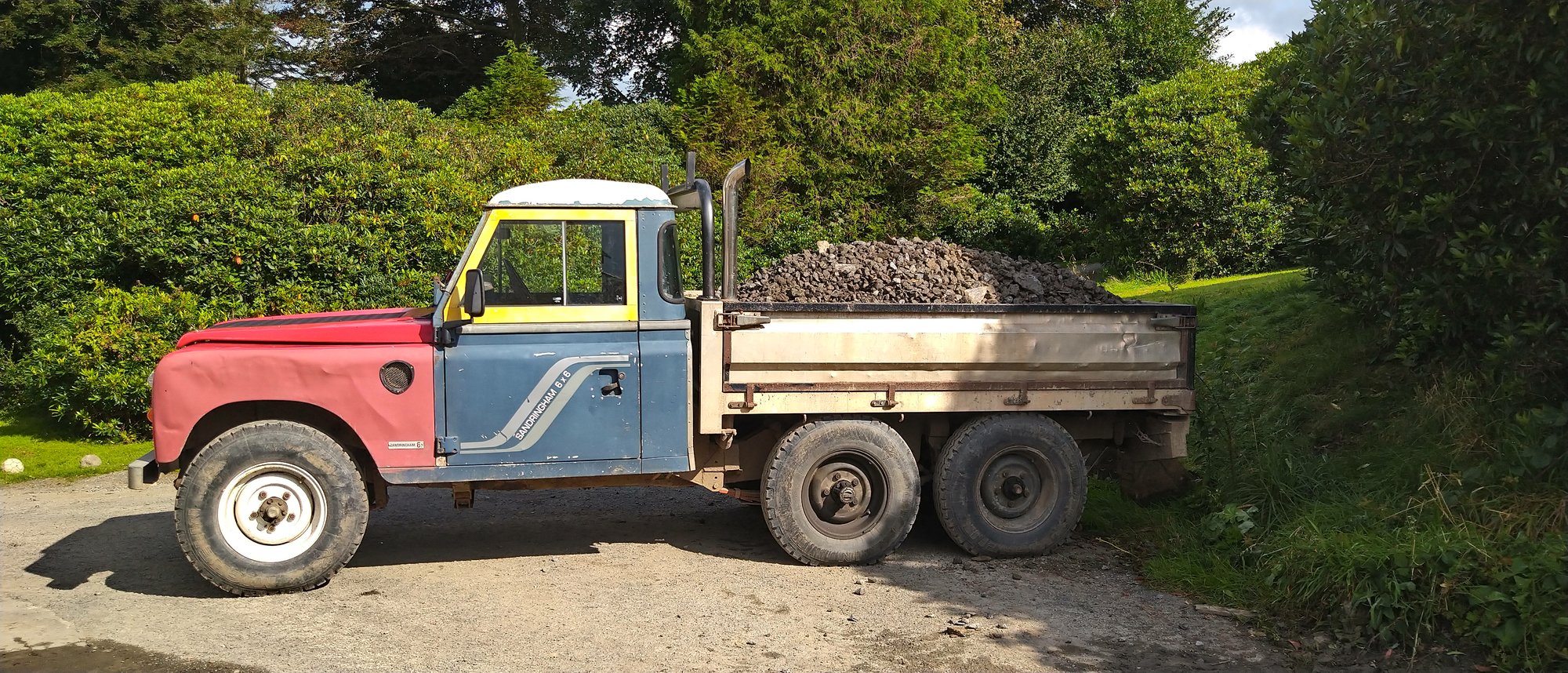

The bed on my 6x6 the corner posts drop into some angle and then the sides and tailgate have an over centre catch which clamps everything down far better than the Ifor Williams style.

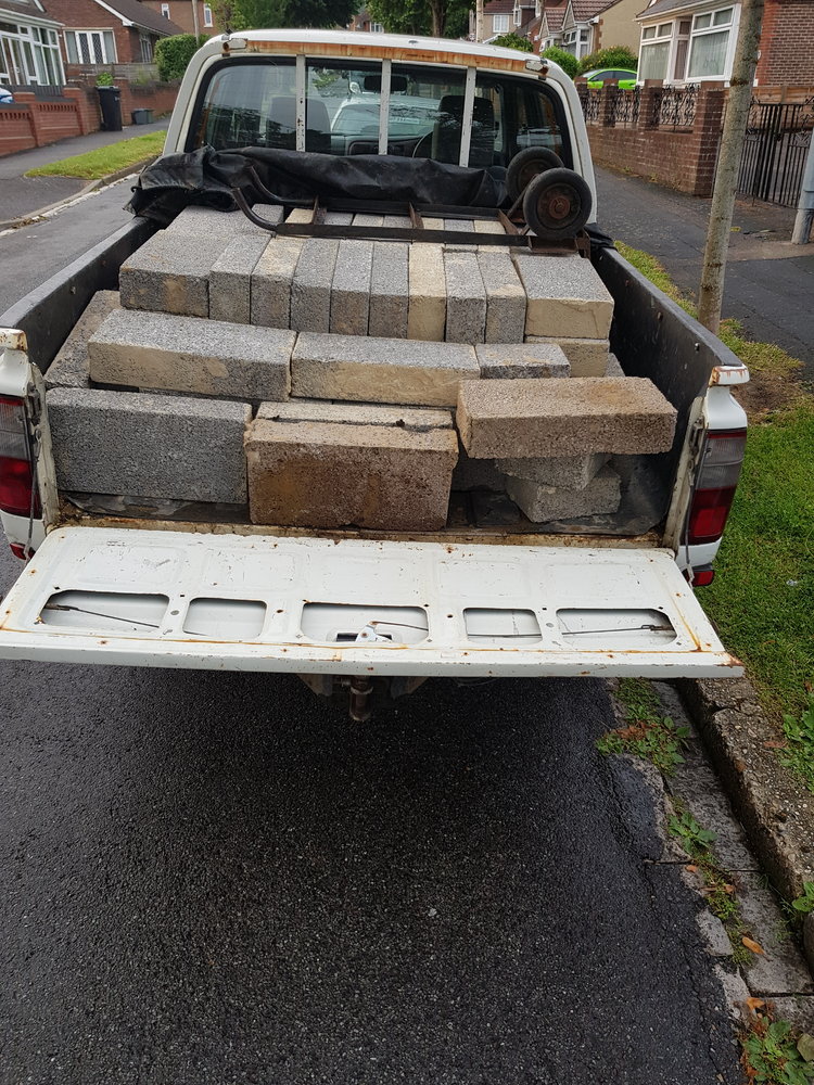

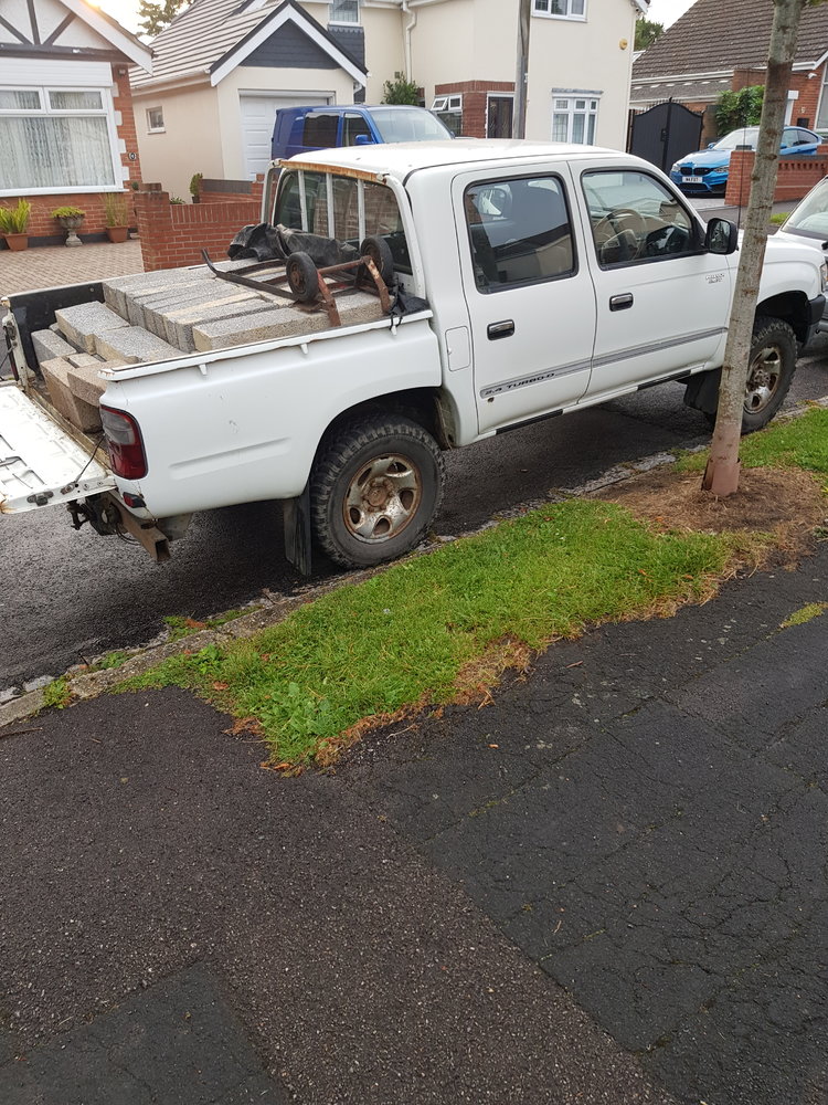

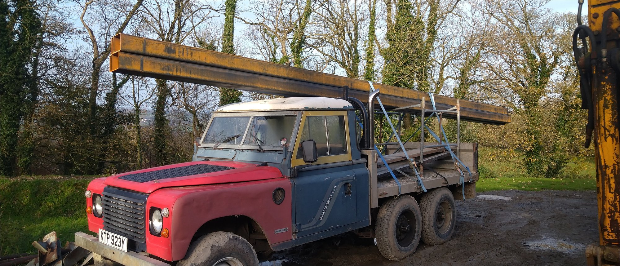

Pickups are prone to snapping, now I know why!Ah interesting , how about 1 1/2 tonnes of concrete blocks i miscalculated but she took it like a champ steering was very light
wasnt on the bumpstops
View attachment 486995View attachment 486996
I was referring to the scaffold tower...Ah interesting , how about 1 1/2 tonnes of concrete blocks i miscalculated but she took it like a champ steering was very light![]()
Thats a light load compared to how they get abused in other countries , they are rated for 1ton I wouldnt do it again as that was before i welded the chassis which is how this thread startedPickups are prone to snapping, now I know why!
So what class Mot is that ? My Chevy K30 is just under 3 ton empty so effectively can only carry 1/2 ton but is a 1 1/2 ton truck the rear axle is rated for 7500lbs but is class 7 MOT and i never put over 1/2 ton in itI was referring to the scaffold tower...
A Bridgeport on the back means there's actually some suspension. Think this was circa 3.5t - she's rated for 2t on the back. Wasn't on the bump stops...
Who knows?So what class Mot is that ? My Chevy K30 is just under 3 ton empty so effectively can only carry 1/2 ton but is a 1 1/2 ton truck the rear axle is rated for 7500lbs but is class 7 MOT and i never put over 1/2 ton in it
that must weigh over 1 1/2 ton empty
It's played for 4t (3950kg) gross vehicle weight, 4t trailer so 7950kg GTW. The V5 has been downgraded to 3500kg GVW so falls into Class 7 I think. That's what it's been tested under but being 1983 build it can qualify as tax and possibly MOT exempt now.
