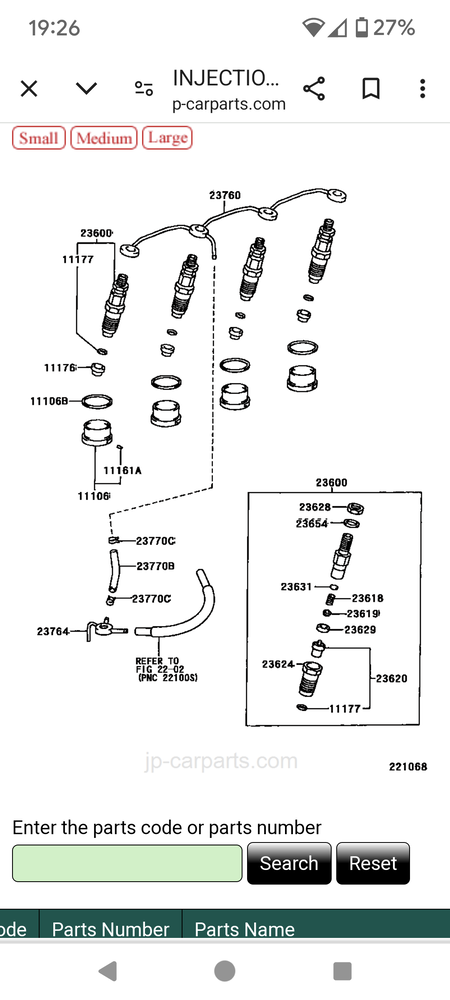

Nothing in the head other than the litte heatsheld washers so I've fitted them without. A Google search suggests some had them and some didn't depending on age.Normally come with a washer and a heat shield, have a dig about in the head.

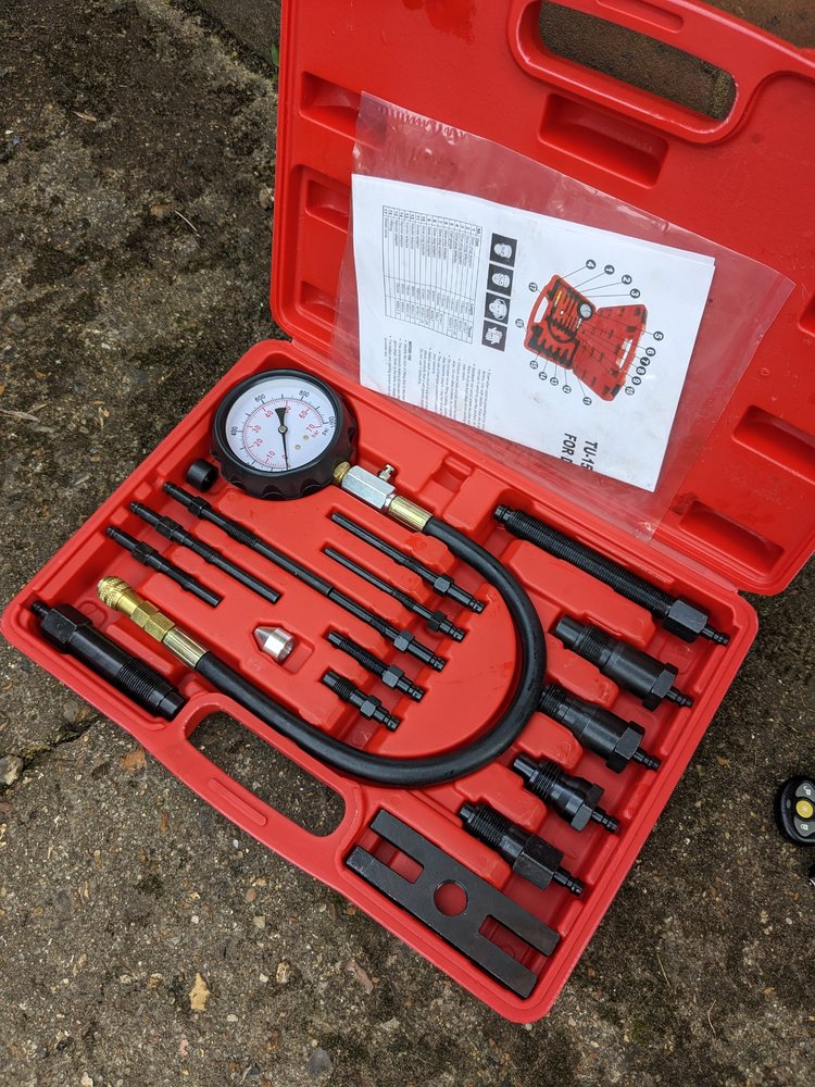

Had an episode like that myself recently.Yes. Go on. now snap a couple of glowplugs off in order to test the compression. Then you will be happy
I have one of those kits, and I have never found that any of the supplied dummy injectors fit anything !
They are brand new glow plugs, I only fitted them on Sunday with a tiny smear of copper slip on the threads.Yes. Go on. now snap a couple of glowplugs off in order to test the compression. Then you will be happy
