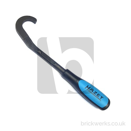

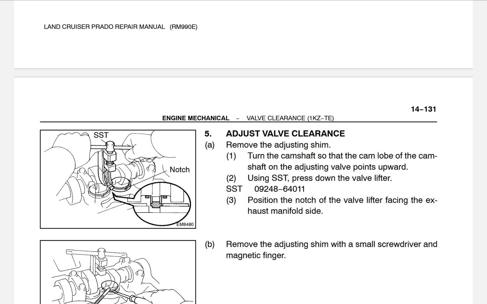

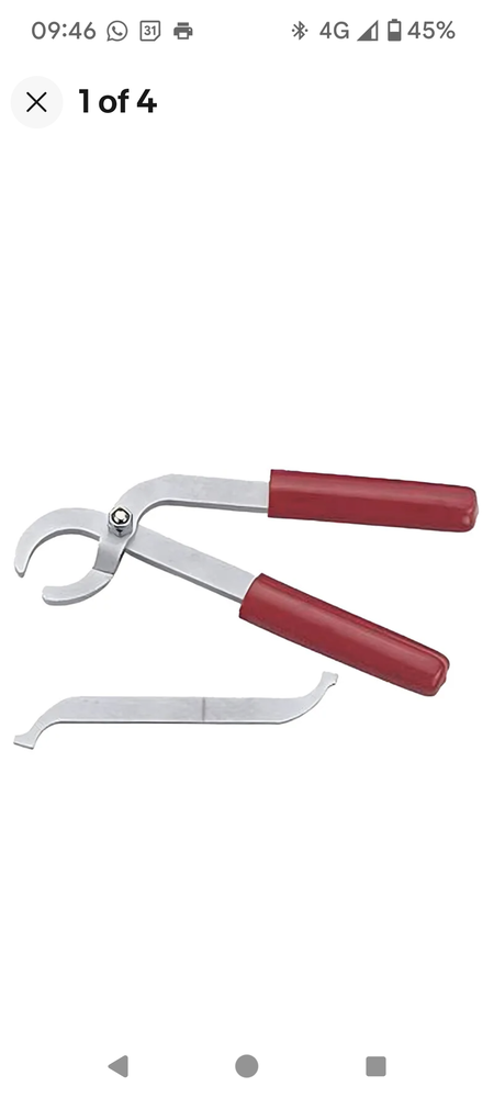

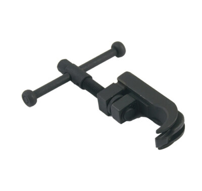

The plier type tool is just to lift the shim out of the follower, a small pick type tool and an extendable type magnet tool will work . I have a VW/ Audi tool somewhere that might do the job ? If I can find it your welcome to borrow it , along with the tools to lower the followers that may or may not work on yourI need a shim removal tool like this View attachment 439542
Or this
For the weekend, does anyone know where I might get one?![]()
09248-64011 Genuine Toyota VALVE CLEARANCE ADJUSTING TOOL 0924864011 OEM | eBay
Find many great new & used options and get the best deals for 09248-64011 Genuine Toyota VALVE CLEARANCE ADJUSTING TOOL 0924864011 OEM at the best online prices at eBay! Free delivery for many products.www.ebay.co.uk

Thanks for the offer!The plier type tool is just to lift the shim out of the follower, a small pick type tool and an extendable type magnet tool will work . I have a VW/ Audi tool somewhere that might do the job ? If I can find it your welcome to borrow it , along with the tools to lower the followers that may or may not work on your View attachment 439588
I've ordered one of the knock off copies of the genuine Toyota tool, let's see it it fits...

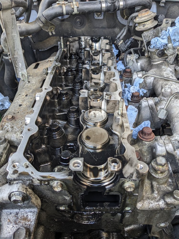

I suppose with the injectors out I can just poke a screwdriver down the hole to check where the pistons are.You need to make sure pistons are nowhere TDC before you start depressing cam followers.
Bob
Make sure the screw driver isnt one of those that pushes into a handle…..nothing worse than trying to get your end out of a hole!I suppose with the injectors out I can just poke a screwdriver down the hole to check where the pistons are.
I'd not got as far as thinking about that, thanks Bob![]()

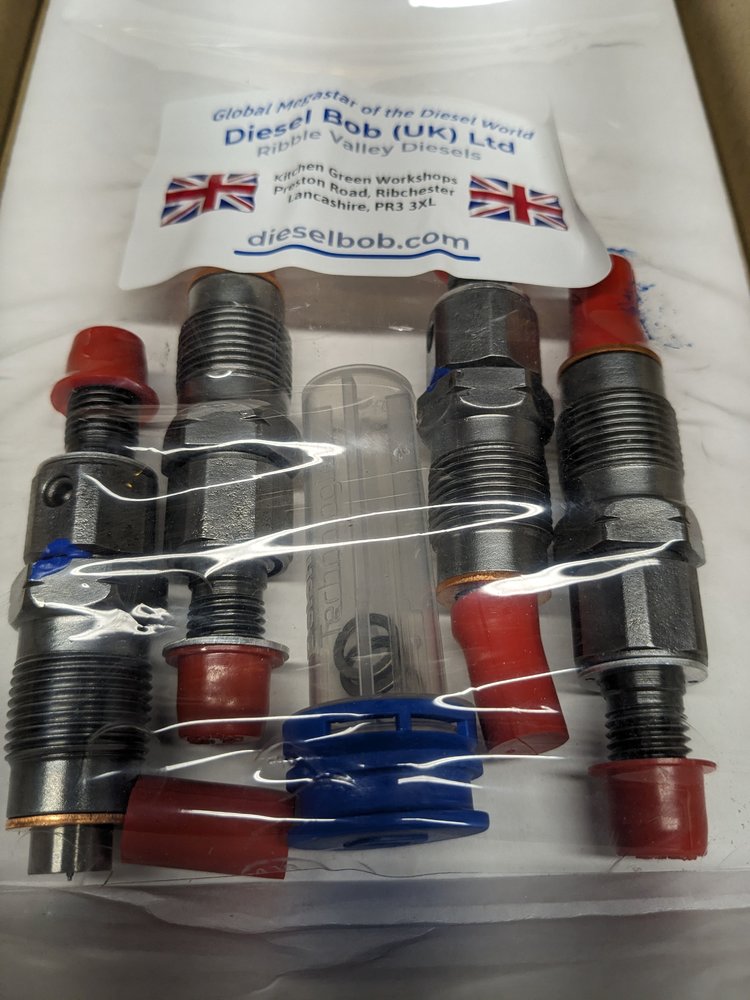

The injectors
Complete with the sealing and leak off washers but those copper ones weren't on there before and aren't on the parts microfiche.![]()
