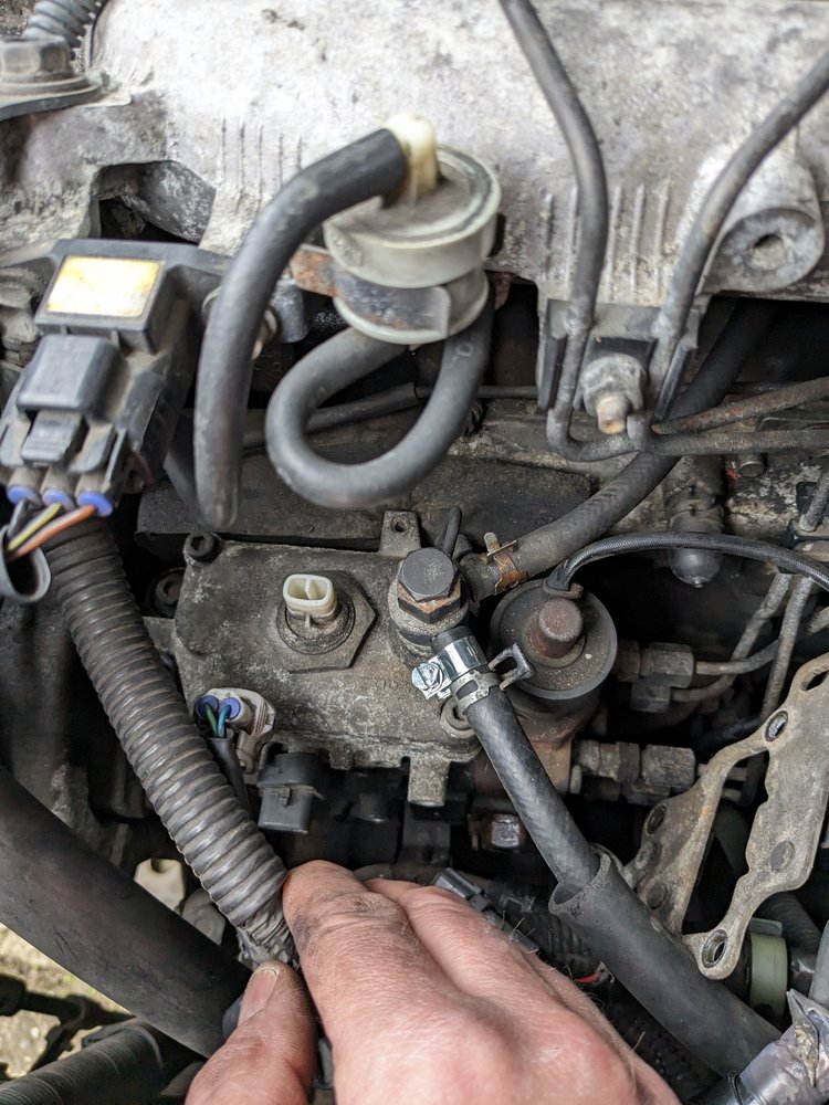

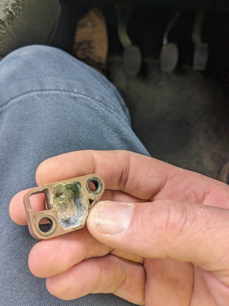

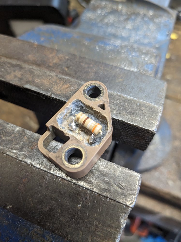

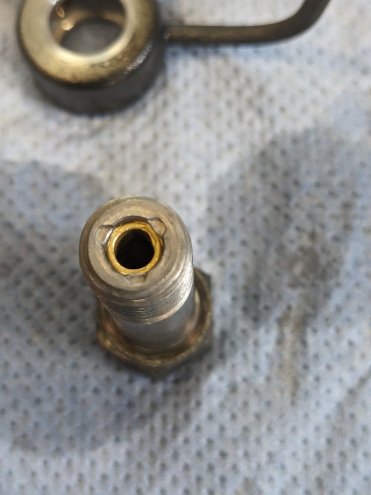

I put a length of clear tubing on the output of the filter and its running with no bubbles so I think that's ok at least.

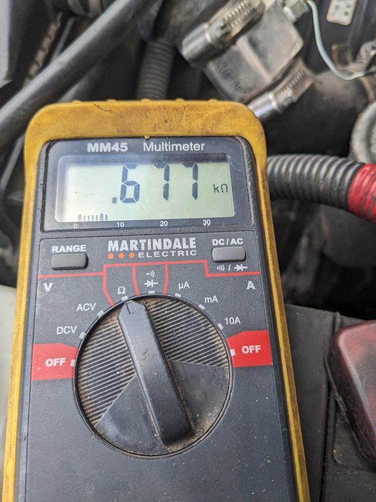

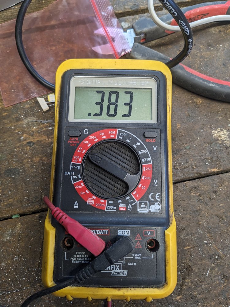

Then I tested all the sensors on the pump, I wrote the results down but have to find what the correct readings should be, it's not easy deciphering all the ****e online and finding the proper info!

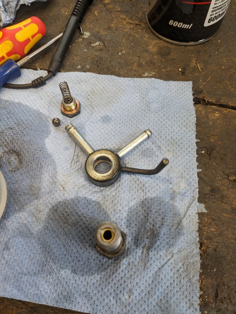

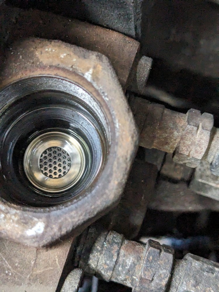

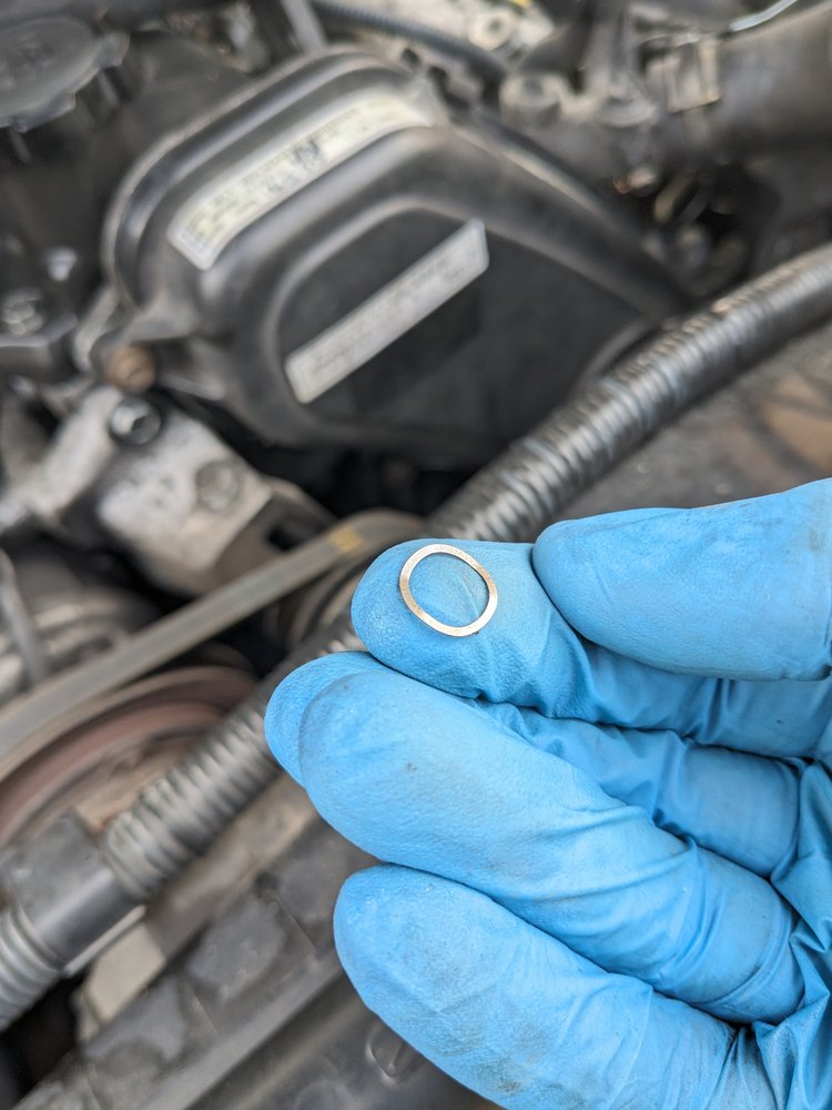

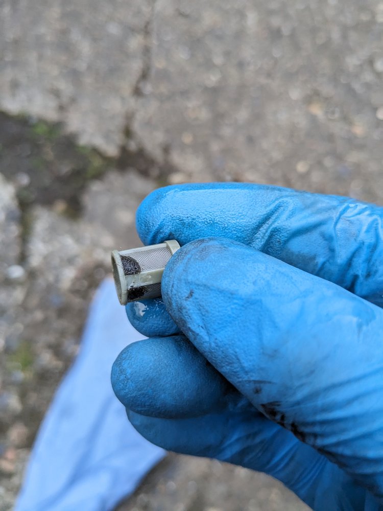

I've also found there are a couple of hidden filters in the pump that block up so that's next...
