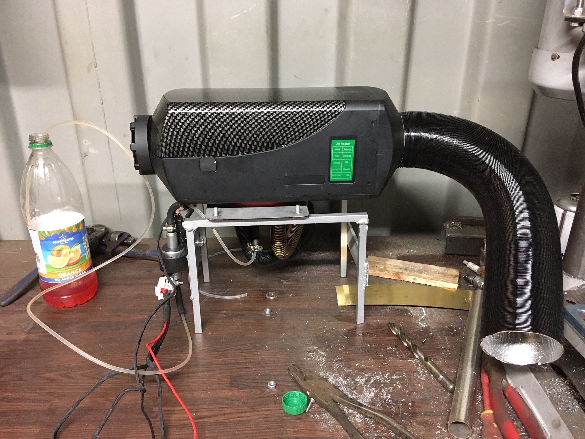

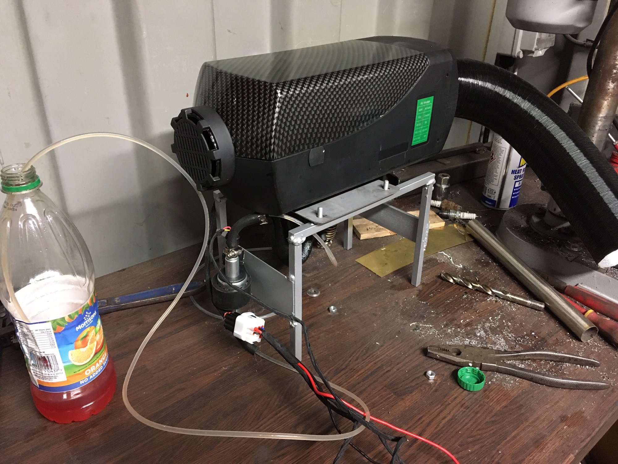

Got this running today, made a little stand for it and a couple of holes in the side of the container for the exhaust/inlet. I'd hate to see what a 2kw one was like if this is 8kw, not as hot as I was hoping but maybe I'm just expecting too much anyway, however it does pump a fair bit of heat out. At a later stage heat recovery from the exhaust could be worth looking at as there is one hell of a lot of heat exhausted outside.
Your container will suck up all the heat initially, I run mine in a wooden shed and it's great.![]()
I could be wrong but I think a lot of the supposed 8kw units are actually 5kw.
Something also rings a bell about the 8's been physically bigger than a 5 (but that could be a 5 and a 8 are the same size and both are bigger than a 2....)

No they are actually 4kw but still amazing value.they are mis quoted as 8 but they are 5s
