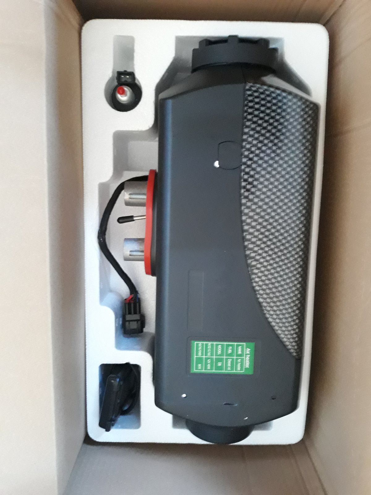

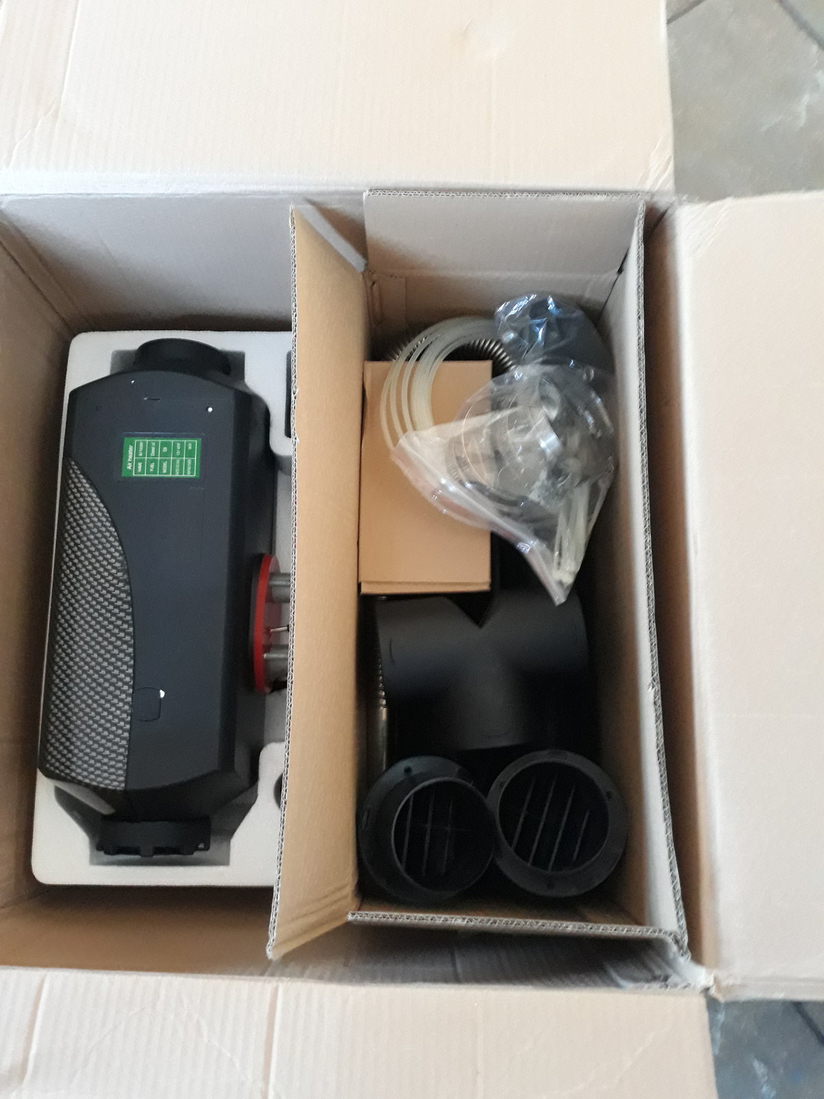

    I just thought I would post this if anyone is interested. Last week while working on the Startrie Bandsaw I got really cold so I ordered one of the Chinese Diesel heater from Aliexpress but found a supplier based in the Check Republic at a good price 108 euro delivered. Ordered on Tue 12th and delivered on Tue 19th and no worry about Customs. Got it working today just have to put the exhaust out the wall.

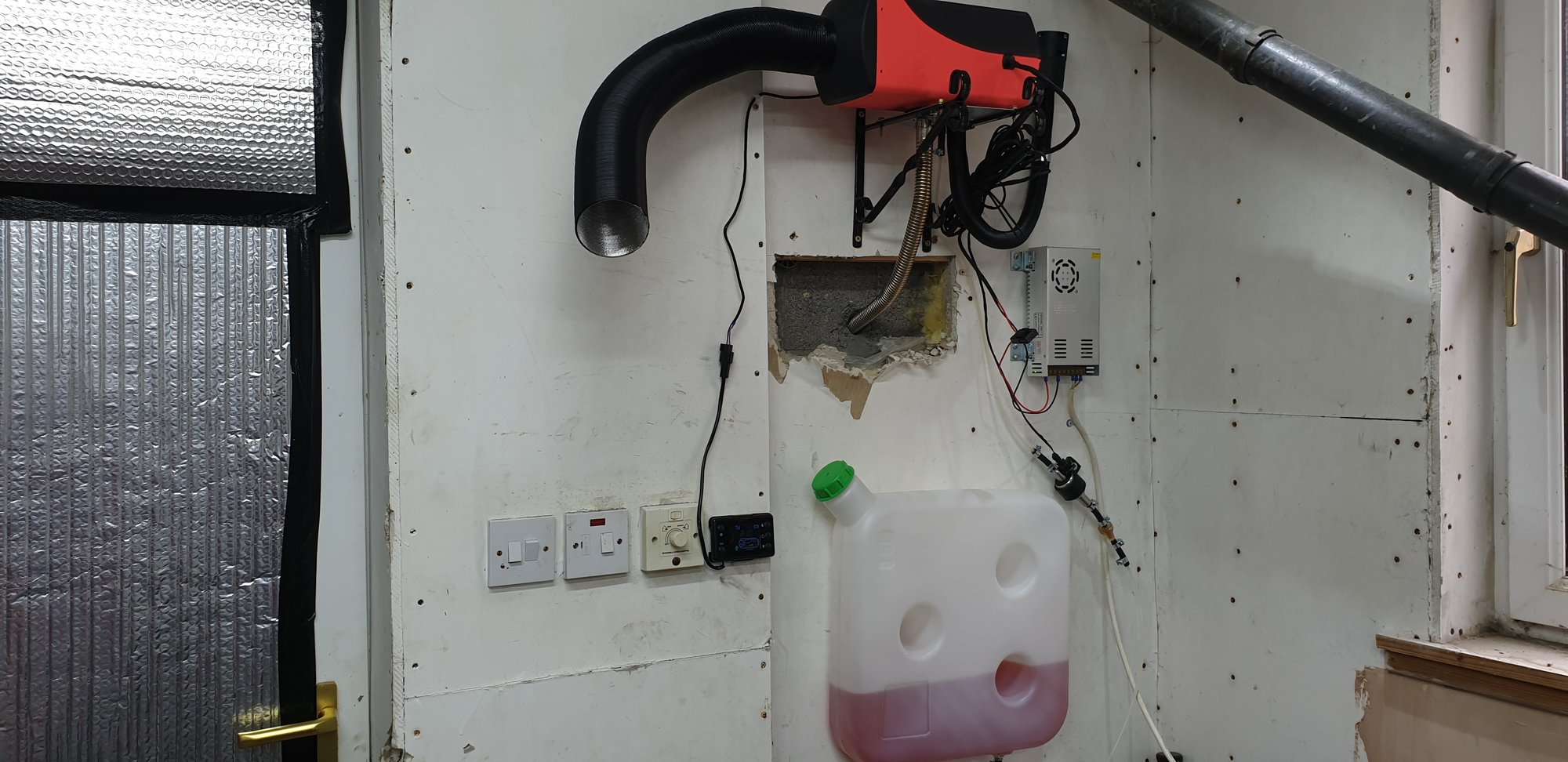

    I have the 5kw one set up and it's great this time of year, or any time. Got a very damp cold garage, run off of a 12v power supply and run on kerosene.
    Can heat it up from about 5 to 18 degrees in about an hour and a half then ticks over, I'd recommend one

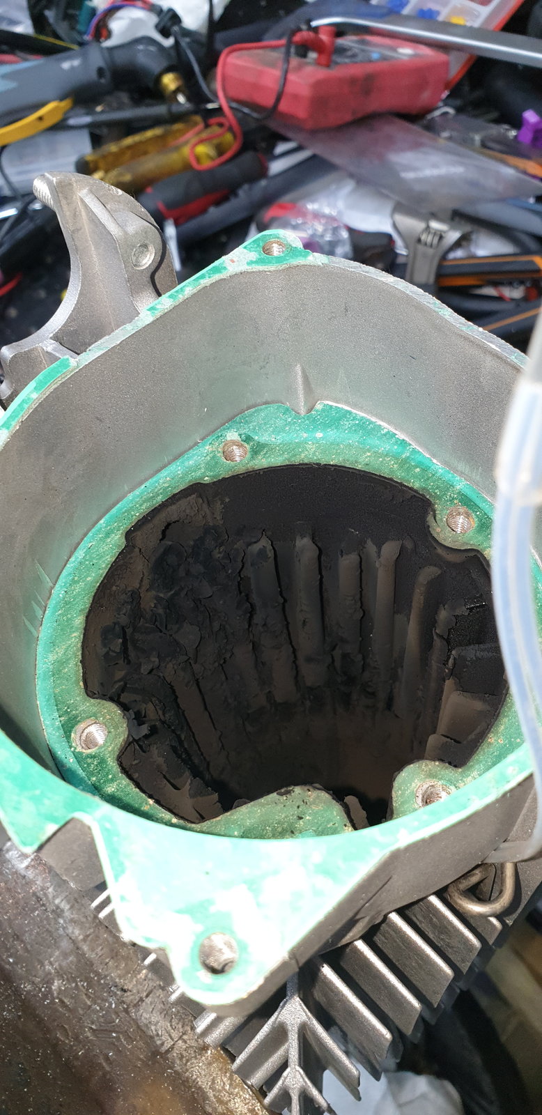

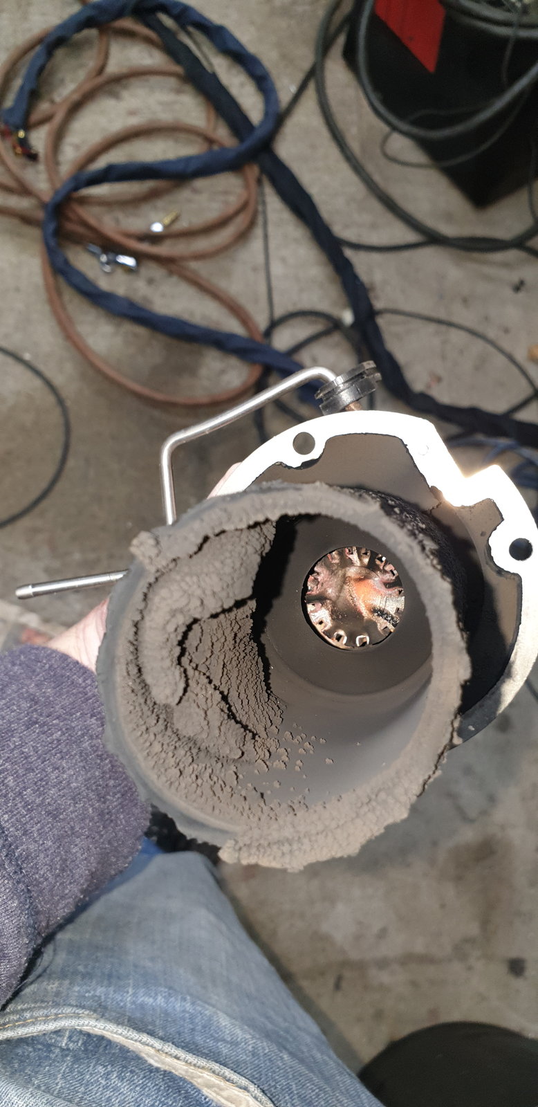

    Mine failed to fire the other week, bit odd, been fine for about a year. Cleaned it out :laughing:
    It was running a silencer and I think it got blocked, built up back to the combustion chamber. First time in a year its given me grief though, now running a straight through to outside

    is that just soot and carbon?

    Very soft soot, like anything if the exhaust gets blocked it's nowhere to go.

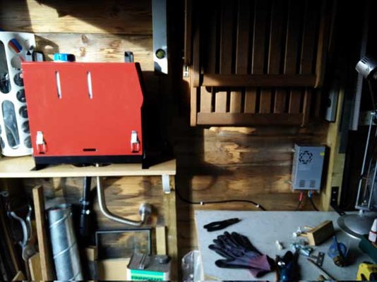

    Paraffin price(s) seem to have shot up recently - £9.99 locally for 4ltrs locally, but this seems about right for eBay prices where you have to add p & p. Luckily, I now have a source for heating oil for £4 for twice the amount. ;)
    Here's mine

    For a cheap indirect fired heater they are great, I have a draper topedo type space heater and it belted out the heat, but also moisture and fumes...
    Now it's just dry hot clean air, at the moment it's running in recirculating mode (unplugged supply hose so drawing from the garage) but have drilled through to the outside so can draw in fresh air
