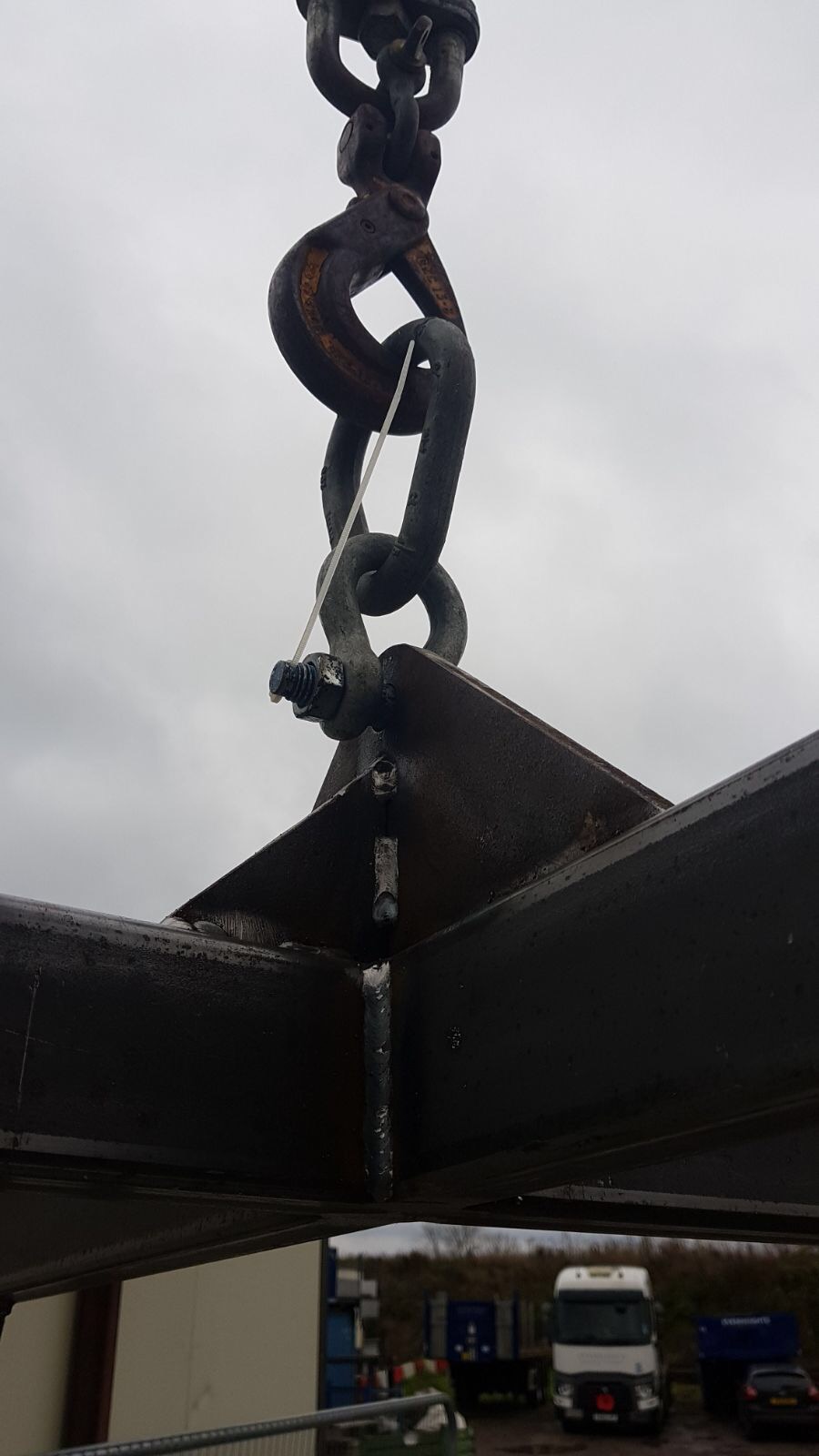

    What is this cross to be used for, how much weight is it to hold, seems fairly heavy duty.....
    My thinking, the 5 mm box has welded well, could the other bits not be say 6mm, which your machine would handle no problem.

    It’s a ton bag spreader beam for a good friend of mine. He will be testing it before use.

    I’ve sorted some bigger tips and a bigger wire. I’ll be grinding the welds off the 10mm plate and trying it again with your advice. It worked though.

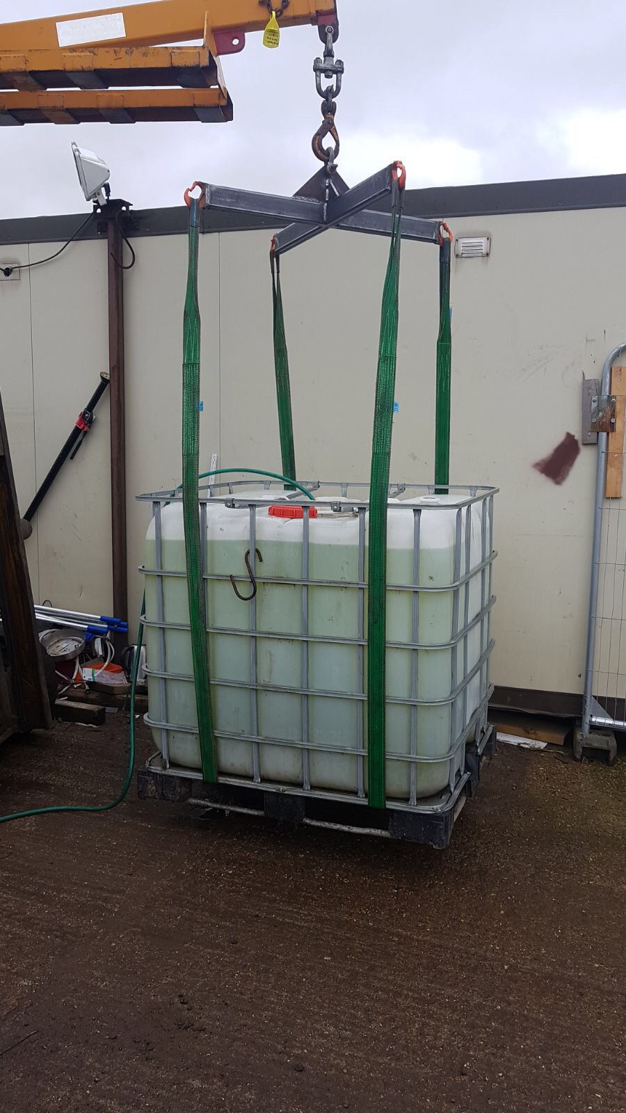

    ALso it is balanced. Just my friend has put the strops on slightly wonky. That’s over a ton in the IBC

    At the risk of being flamed that spreader needs to be at the base of that in my humble opinion. If that strops slips to the middle I would not want to be near that load. And you’re relying on the pallet sides. I thought it was for a gearbox or something.

    It’s not for that normally. My friends just doing a small test to see if anything damages but I’m going to be re welding the upper welds with the 1mm wire I have now. That iso will have barely any pull on the sides.

    After thinking about your question, I realised I’ve answered it wrong. Those strops are pinching the IBC. No way it’d slide. That’s how it should be slung if you’ve got no forks. (Obviously he does but this is to test it) :D

    It’s supporting a ton easily and if that’s all it’s going to support I would leave it as it is and keep the 1mm for next time.

    As its lifting equipment it may be an idea to load test it, maybe stack two ibc`s and pick them up together with some longer straps. I dont know whether x2 is what they use to certify but it would be a start and you could stamp it up with a swl.
