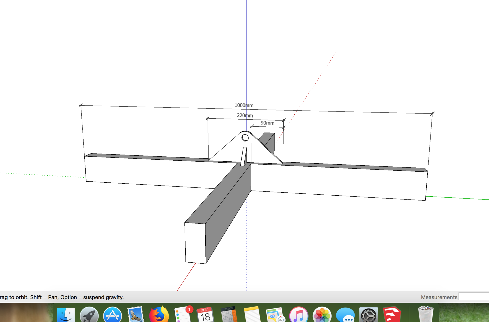

    I'll try that, Have a few long welds to do when I Cut the other bit of steel out. Thanks Steve :)

    Cambridgeshire
    Your limits are your welder. In order to achieve good strength on hefty gear like that you need a relatively hefty Mig. What is your material thickness and power available at your welder?
  3. KimB
    KimB Member
    Messages:
    1,985
    Location:
    Never Never Land
    Oh off course, it's a 220 mig, Sealey. I need to weld 10mm plate to the 5mm thick box. to do the 5mm box to the 8mm plate I was a bit cautious of it burning through. it looked like it was getting close to going and that wasn't and full power.

  5. Richard.
    Richard. Forum Supporter
    Messages:
    18,348
    Location:
    Cambridgeshire
    It’s a touch on the light side really for the 8-10mm
    You’ll be spending the whole job with it maxed out.
    KimB likes this.
  6. KimB
    KimB Member
    Messages:
    1,985
    Location:
    Never Never Land
    Yeah :( i know. Problem is, for home use, you're not gonna get much bigger with a mig. Unless I go to a proffesional set up but that can wait. Rather get tig and MMA welding first.
  7. Richard.
    Messages:
    18,348
    Location:
    Cambridgeshire
    That’s gonna be ok with 220 amps but it’s just gonna be right on the limits of your machine and supply. It looks like it’s going to be holding some weight so the welding needs to be good.
    Mma yeah that would be my preferred way to attack it. It’s got 3.2 7018 written all over it.;)
    bigegg, addjunkie and KimB like this.

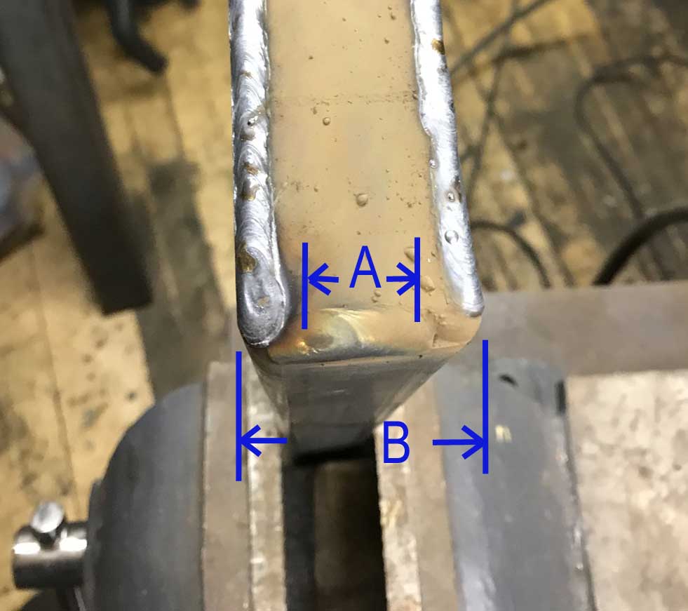

  18. Hi Kim,
    Everyones being so polite but the thread title is constructive criticism so here goes.
    Your welds look ok but you are starting too far along the joint and stoping too quickly. Welds on box should roll right round the corner.
    In Your photo that I have used as an example your wire extension has run < A > leaving an edge still showing to the right.
    You should have nicked that previous start off with a grinder and ran < B > .
    I find that by welding right to left for the 1st weld then turn the job clockwise and weld the 2nd weld so that it finishes where the 1st one started.
    Turn clockwise again for the 3rd and finish on the 2nd start. Turn and weld 4th side. This will give corners with the right build up and seal any cold lap starts.
    Your 220 is more that capable to do this fabrication. I use a Lincoln 210 and have done similar many times.
    HTH
    Paul G
    KimB likes this.
  19. Richard.
    Messages:
    18,348
    Location:
    Cambridgeshire
    Sticking something together and actually welding with sufficient fusion and penetration for the material gage are two different things Paul.
    210 or 220 amps is not powerful enough to properly weld 8-10mm thick gage.
    Tinbasherdan likes this.
  20. The nice thing about forums is that everyone can voice their opinion.
    In this case our opinions differ, but that's not a bad thing.
    Paul G
