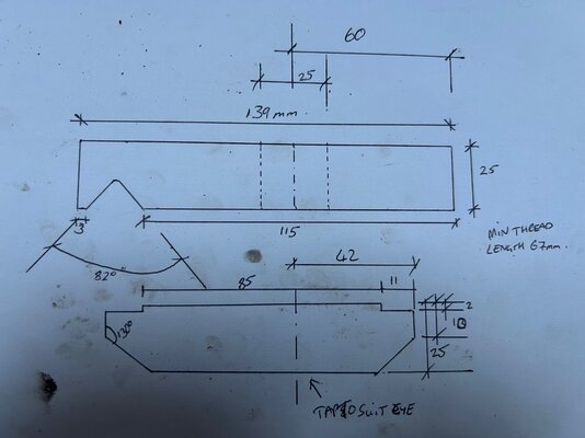

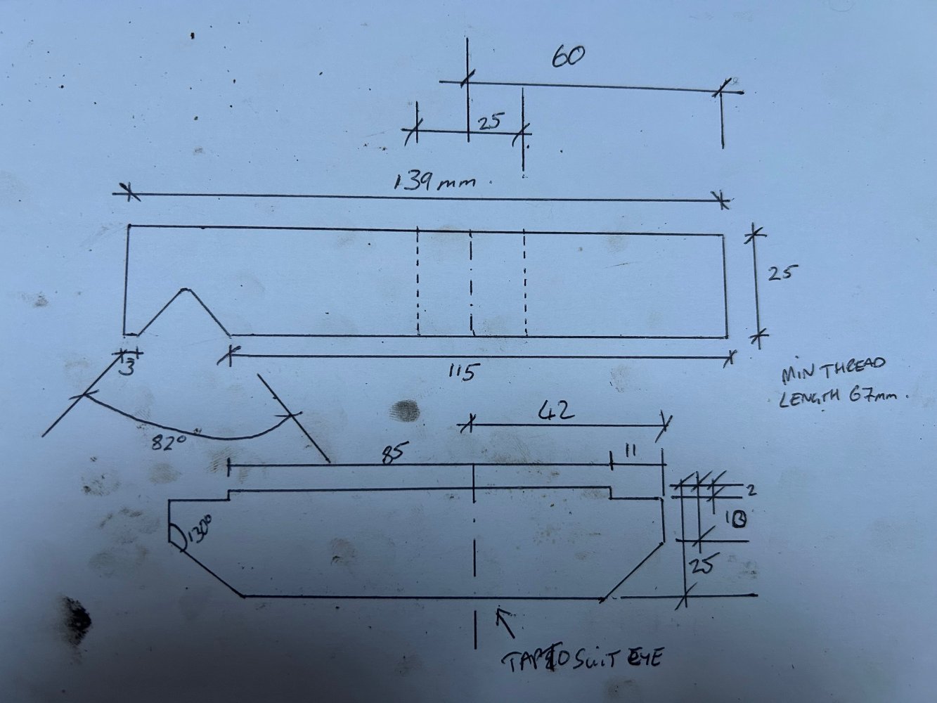

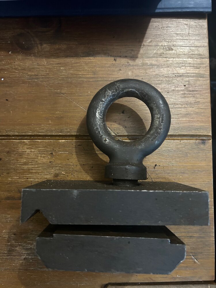

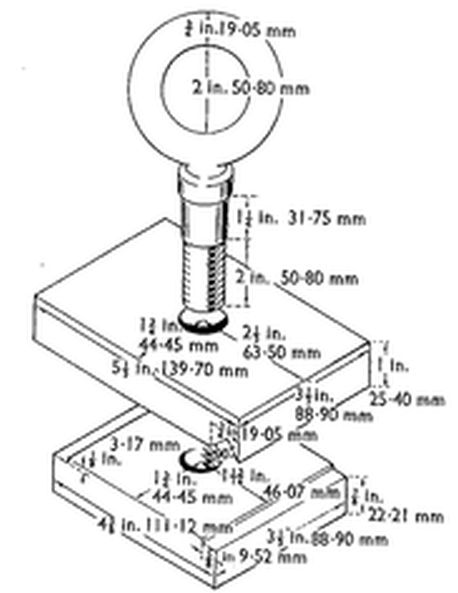

Hi, does anyone know if the drawing for the above lifting plate would also suit a Colchester Student 1800?
It is a very thin lead, but there is someone at the bottom of this thread that suggests they found the dimensions for a Student 1800 one online somewhere:
Just wondering if anyone has a Colchester Student 1800. As far as I am aware they do not have the tapped hole for lifting so require a lifting plate. If you have suck a lathe do you have the lifting plate?

If you can re-locate those dimensions, you can determine whether they are the same as or different to the ones above.
If you have access to the machine, make a plywood or cardboard version of the one above and try it. Easy to trim or extend before you commit to metal.
The lifting plate top and bottom would be virtually identical to the fixed steady underside and clamp.
