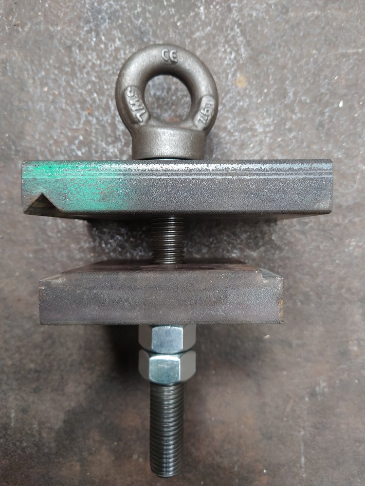

Thats a nice job you have made of that Dan. A lot better than strapping the head and will last you a life time!Well lifting plate machined today, I got 100x25 flat so it's wider than the drawing but that's just more surface to lift on so less chance of ballsing the ways... Went with an m20 long lifting eye bolt which is rated at 1600kg in use so 600kg more than the lathe.
Bottom plate is tapped M20 and the nuts are there as backup
Very nice indeed - let us know how well it works.Well lifting plate machined today, I got 100x25 flat so it's wider than the drawing but that's just more surface to lift on so less chance of ballsing the ways... Went with an m20 long lifting eye bolt which is rated at 1600kg in use so 600kg more than the lathe.
It really tested the (un) rigidity of my beaver milling machine. As charming and old as it is I'm glad it's going and a big Semco bridgeport copy is replacing it.Thats a nice job you have made of that Dan. A lot better than strapping the head and will last you a life time!
I've plenty of the 100x25 flat if you need some. It didn't seem that easy to get on ebay so I got an offcut from my steel supplier.Very nice indeed - let us know how well it works.
I am definitely going to make one.
And a very nice mill it isIt really tested the (un) rigidity of my beaver milling machine. As charming and old as it is I'm glad it's going and a big Semco bridgeport copy is replacing it.
That’s a really sturdy bit of kit you’ve made Dan. Can’t see that giving way in a hurry. Would probably rip the shears out before busting thatWell lifting plate machined today, I got 100x25 flat so it's wider than the drawing but that's just more surface to lift on so less chance of ballsing the ways... Went with an m20 long lifting eye bolt which is rated at 1600kg in use so 600kg more than the lathe.
Will you use some card or anything between that and the bed as protection or not worry about it?Its to the spec in the manual for the lathe tbh, just I bought 100mm wide stock not the 3.5" it specs. I'll probably put something between it and the ways but they're induction hardened so can't see mild steel harming them much...That’s a really sturdy bit of kit you’ve made Dan. Can’t see that giving way in a hurry. Would probably rip the shears out before busting thatWill you use some card or anything between that and the bed as protection or not worry about it?

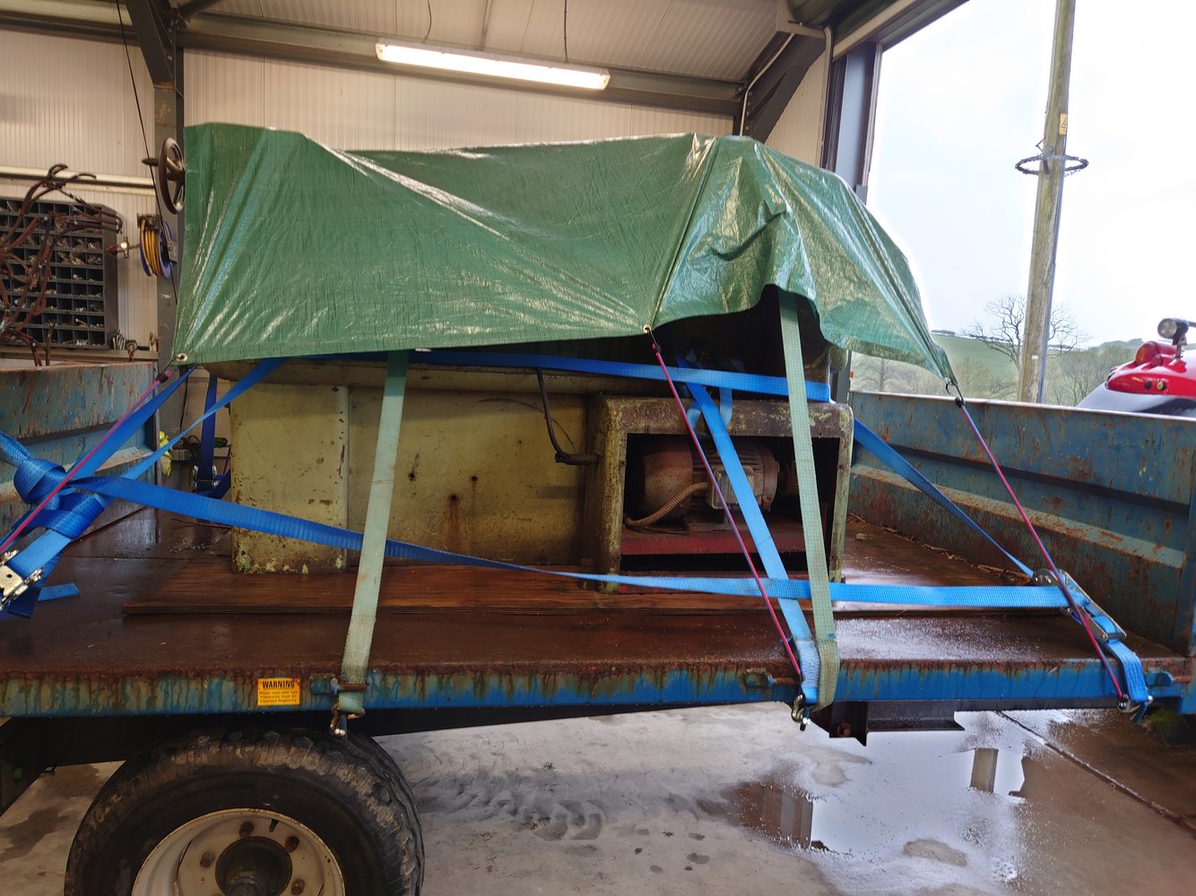

You're not wrong Phil. It was a nervous moment when the telehandler lifted it on the plate I'd made.It is one of those jobs that no matter how good your gear is, or how well organised you are, or how many times you have done it, you still breath a huge sigh of relief when it is finally on the deck and in position!!
